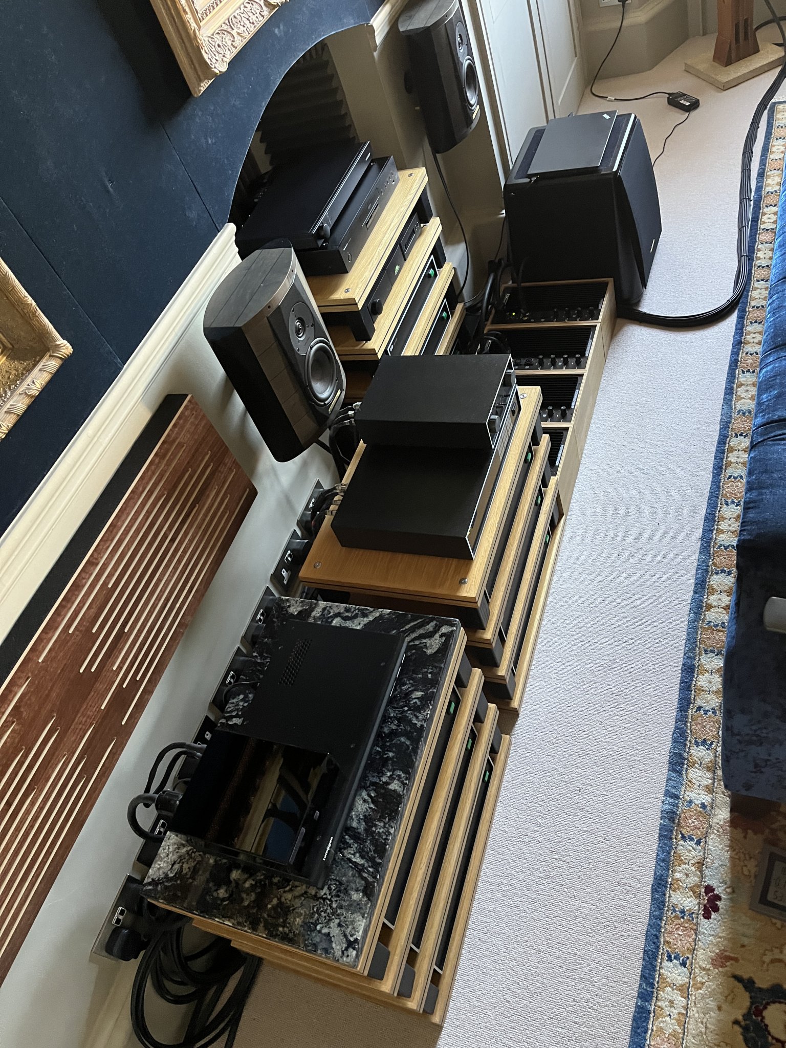

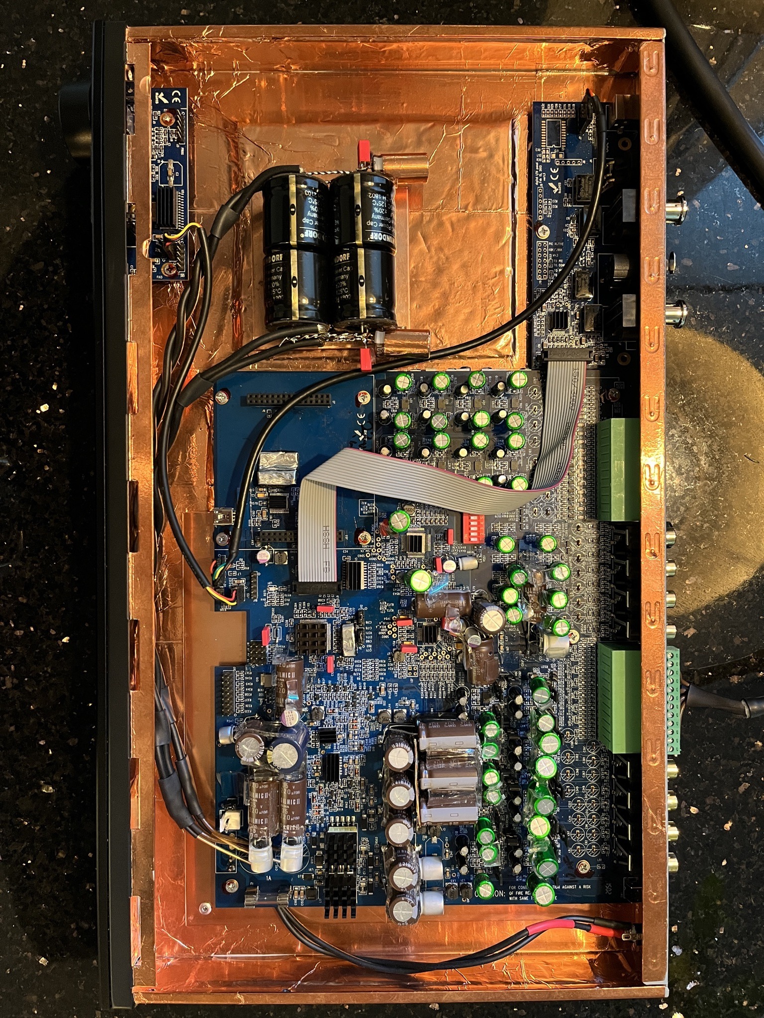

A modded 10x10 HD running 5 subs in a 7.5.0 set up

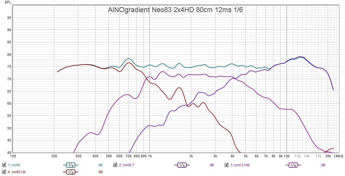

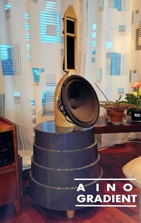

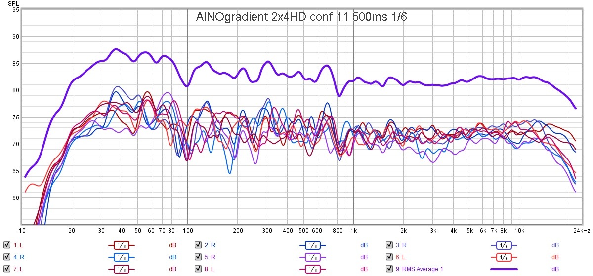

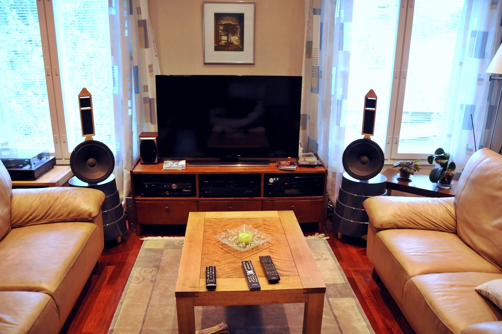

My AINOgradient 4-way active dipole speaker project was started in 2013 with Minidsp 4x10HD and ICEpower amps. Subwoofers are sealed and play to 150Hz. I changed upper mid and tweeters to planars and have been happy since then, and won "Best sound" award at a national diy event in 2014. Minidsp and amplifiers have had power on 24/7 almost without interruptions. In the spring 2023 the 4x10 broke (capacitor?) and I replaced it with a pair of Minisp 2x4HD. Speakers are connected to TV and AVR, they are a part of 5.0 HT set.
Thread https://www.diyaudio.com/community/threads/aino-gradient-a-collaborative-speaker-project.231353/
Link to a presentation pdf https://drive.google.com/file/d/1oYIIwYCYkIvvOfLuNnEgOpodKrd3kOkG/view?usp=drive_link
oh2.JPG ainogneo83 vx out 0-180 polar normaliz.jpg ainogneo83 2x4 conf2 all ind 12ms 16.jpg ainogneo83 2x4 conf11 MMM 500ms 16.jpg
