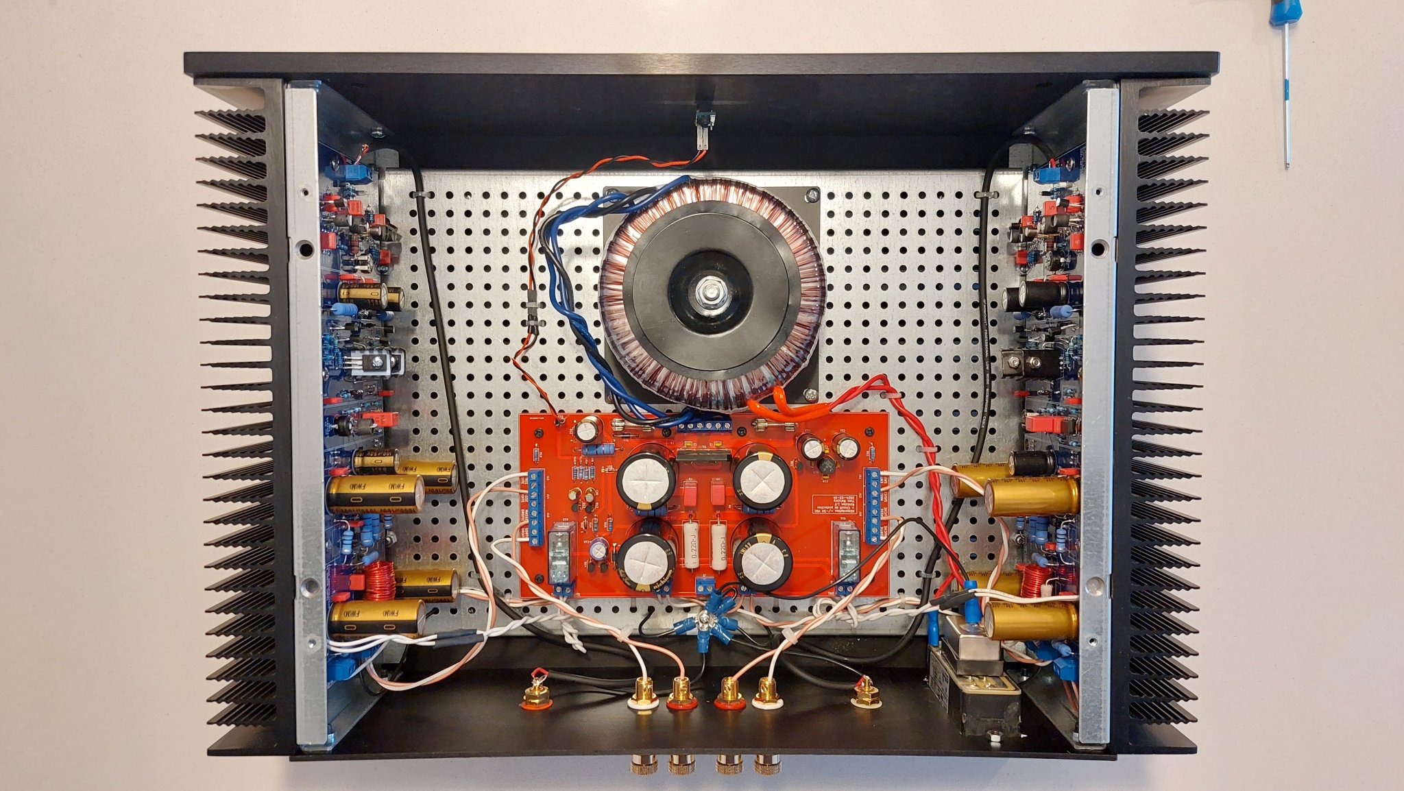

When noting is connected to the input connectors, I can hear a normal breath sound in the headphone. I used this setup to play with all the input cables and the AC cables of the toroidal transformer and also turn it from it's center to minimize the noises. Here is the final result:

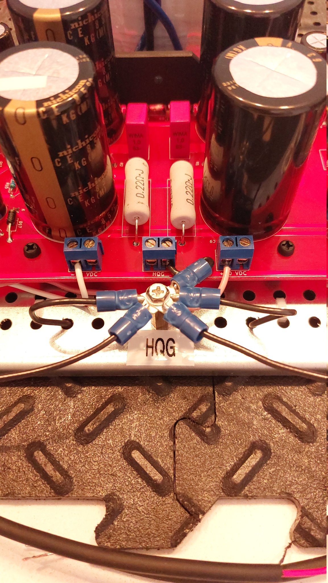

The input ground terminals and all the PCB HQG ground connectors are connected to one common HQG screw to the casing. (Not all connected yet in this picture).

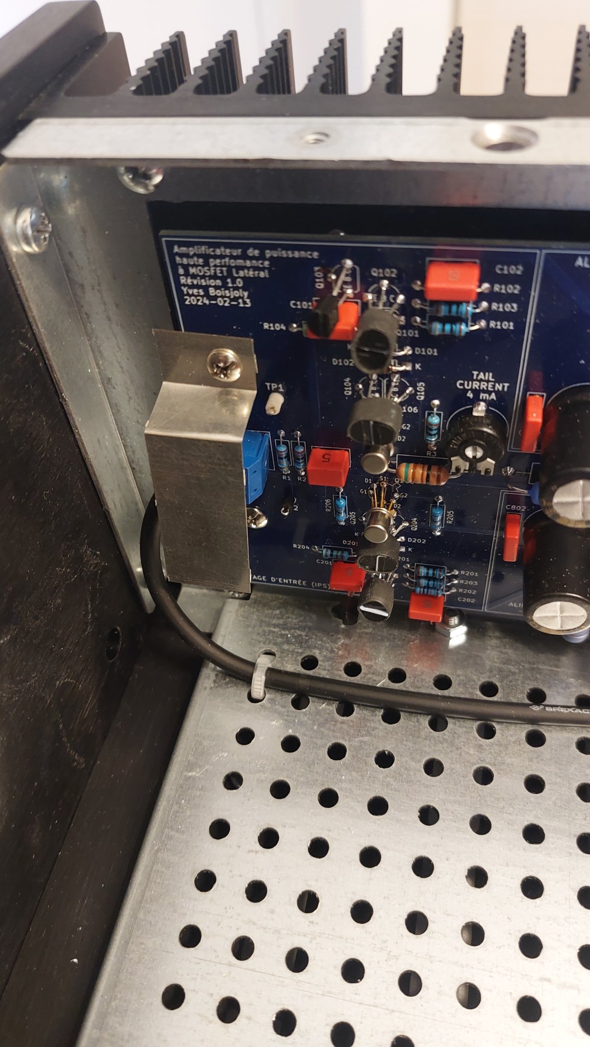

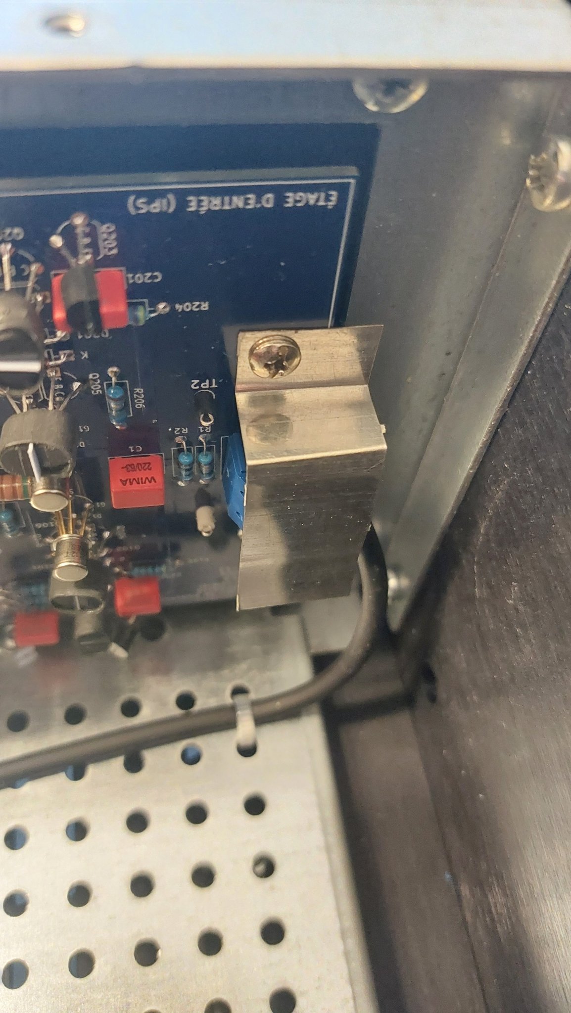

I even tried to shield the two inputs on the Amplifier board as below, with the shields connected to the ground from the screw.

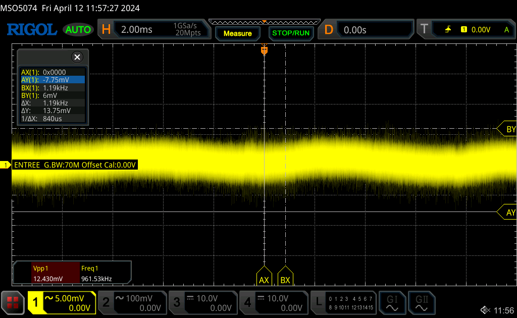

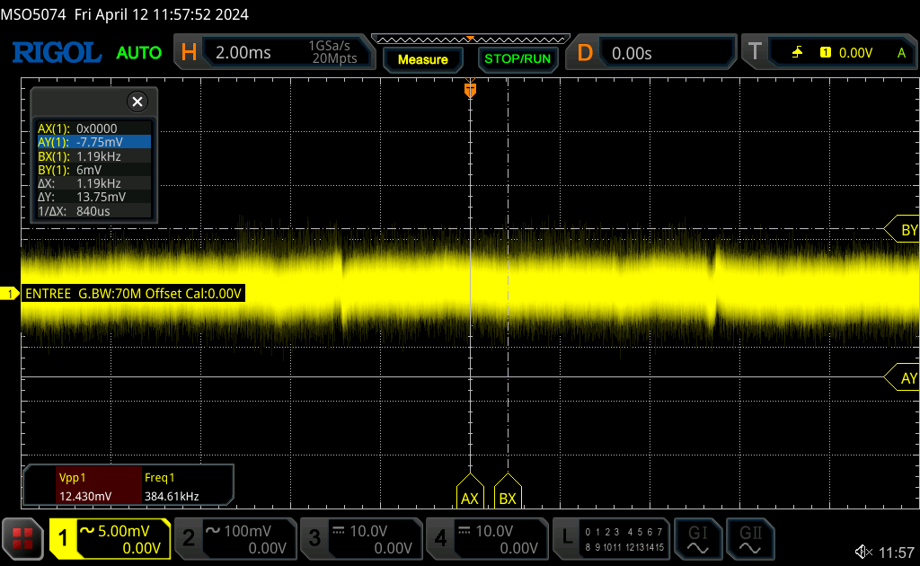

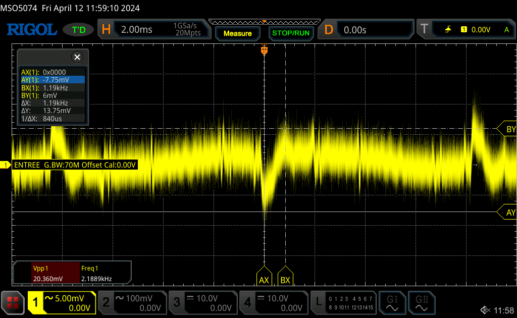

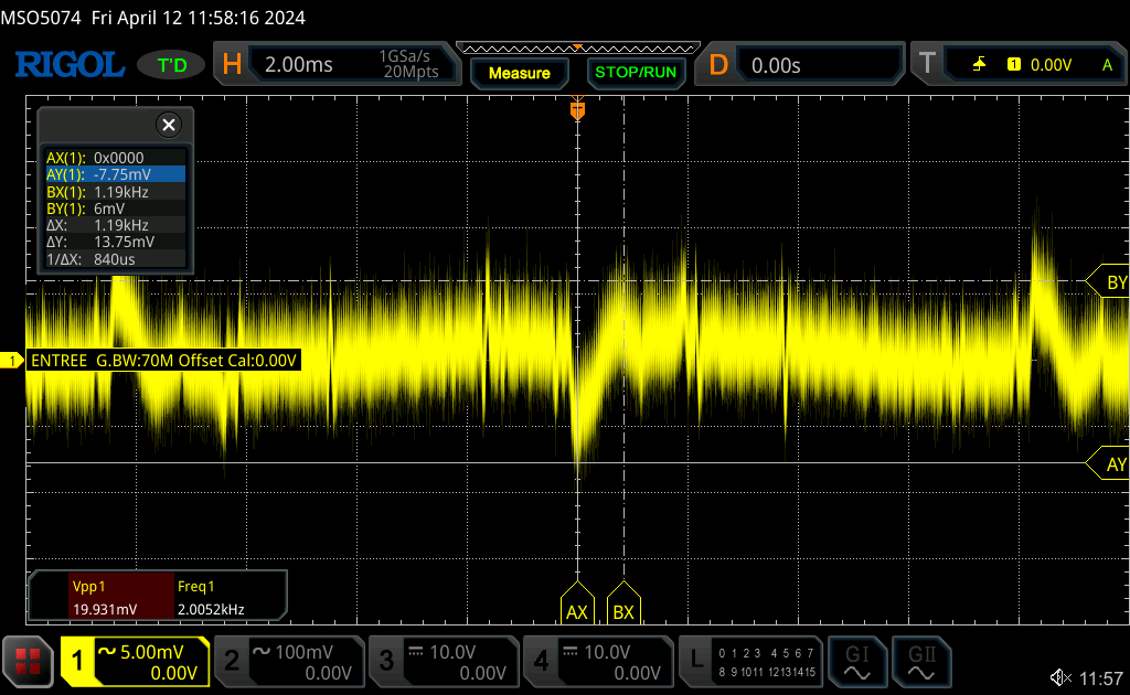

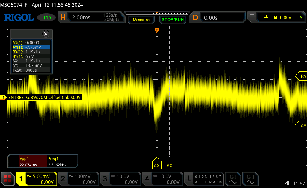

Here are some screen captures from my scope. The probe was connected at the Right Output Speaker terminal with both speakers connected.
Amplifier OFF with one end of RCA cables connected to the inputs and the others end floating:
Amplifier ON with one end of RCA cables connected to the inputs and the others end floating:
Amplifier On with one end of RCA cables connected to the inputs and the others end connected to the pre-amplifier output. Technics SU-9070 Pre-Amplifier AC plug UNPLUGGED:
Amplifier On with one end of RCA cables connected to the inputs and the others connected to the pre-amplifier output. Technics SU-9070 Pre-Amplifier AC plug Plugged but Power OFF:
Amplifier On with one end of RCA cables connected to the inputs and the others end connected to the pre-amplifier output. Technics SU-9070 Pre-Amplifier AC plug Plugged but Power ON:
Conclusion : The source of noise seem to come from the Amplifier Power Supply as soon as the others end of the RCA cable is plugged into an Output Source. I even try to use my Revox B750 in Pre-amplifier mode to source the Amplifier and even if the tone of the noise is a bit different, it is present as soon as I connect the RCA cables.

TBH it sounds like a subtle grounding issue, and I would strive to see that the grounds returning the current to the power transistors, have their own current path back to the transformer, independent of the current return paths powering anything else.
Also i'd not ground the chassis to the signal ground directly, but via the regular trick of a shorted diode bridge, 120ohm and 220uF X2 in parallel - apologies if this is already seperate.

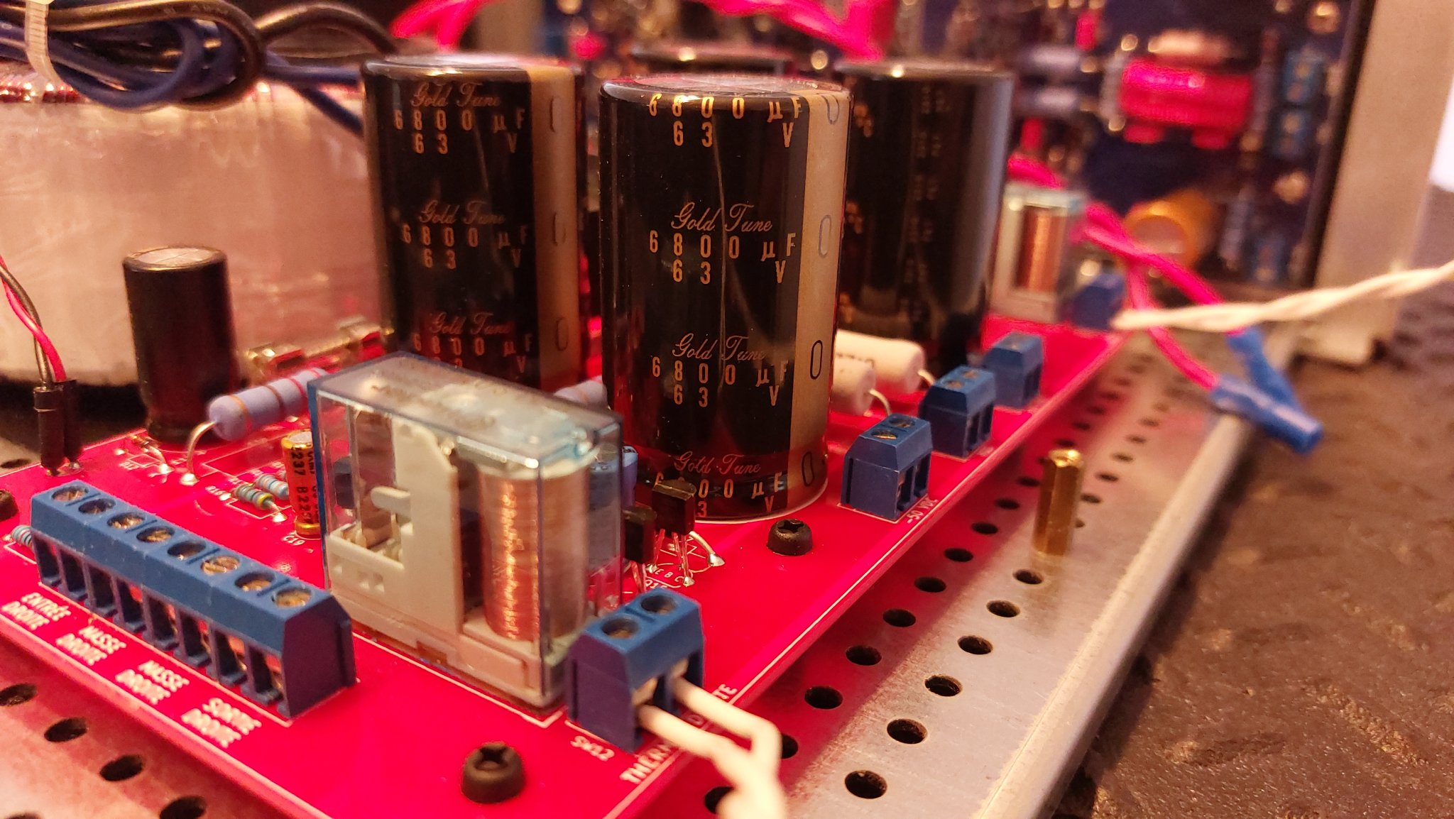

£5 says your large PSU caps are Chinese fakes, I bet they have high ESR and not much capacitance
Swap them out for Samwha HC's with a lot more uF
You'll also get a nice / further improvement by swapping the rectifier for one of the Avondale SMT Schottky items
£5 says your large PSU caps are a Chinese fakes, I bet they have very high ESR and not much capacitance
Those are Nichicon Gold Tune 6800 uF/63 V. I bought them from https://partsconnexion.com/ ! They are surely not Chinese fakes lol!

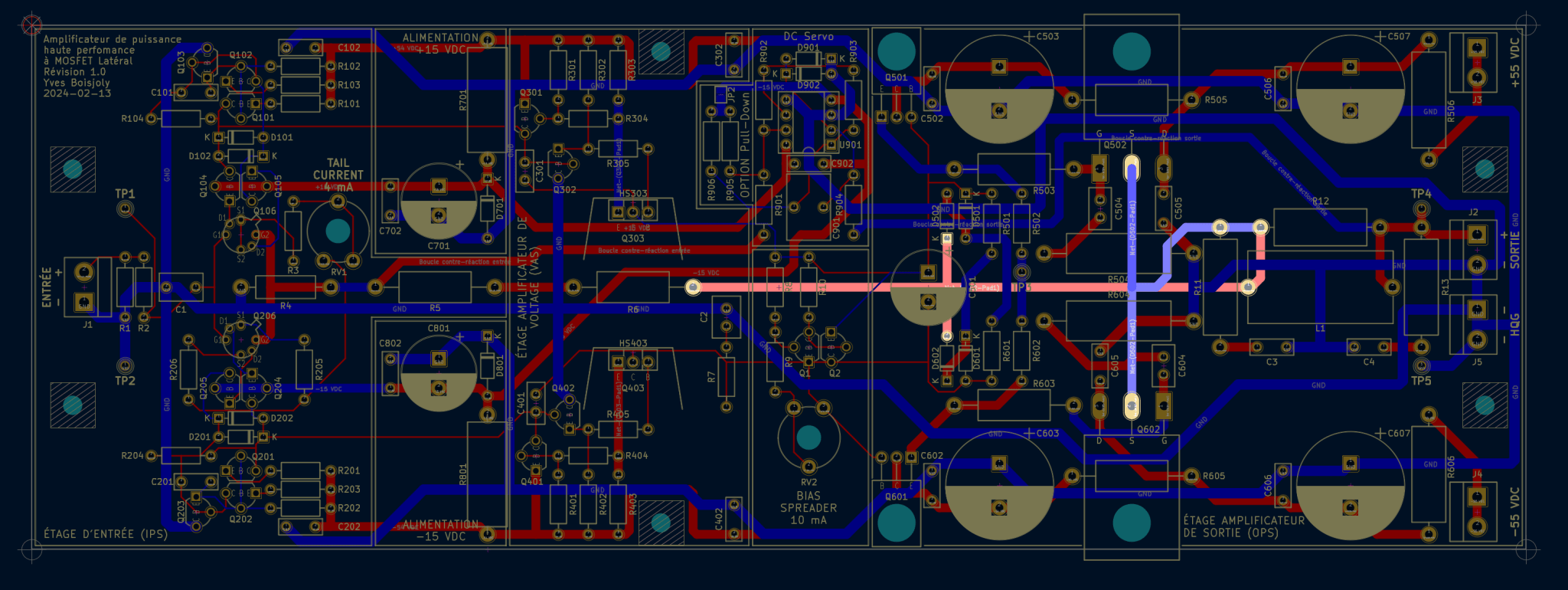

The answer is probably "No". If you look in post #6, the schematics of both the Amplifier board (they are two in the DIY box, one for each channel) and the Power Supply board are attached. The MOSFETs Power Transistors don't have a return to ground. They have a return to the L1 inductor that goes to the load and a return to the feedback circuit.
Here is the Amplifier PCB layout with the Power Transistors return highlighted. Notice that they are joined together on the top side (Blue) and continue to the R11 and R12 resistors. From there, the path change side and rejoin the L1 on the solder side (Red) and goes back to the two protection diodes D502 and D602 and reach the feedback resistor R6:
