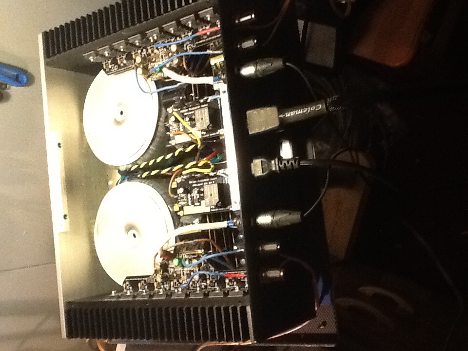

Here is my lates build. Stereo amp with 500R2
2x 1000VA 2x55 volt.
30pcs 2200uF 100 volt Roe for eatch channel (66000uF)
2xsoft start boards.
Dual mono with 2 iec power innlets.
Chassis from Along on Ebay.
Hi Leikis,
I planning to build a class AB amp. A quick question on your build configuration.
Why 36pcs of 2,200 uF cap & not 6pcs of 13,200 uF ?
Does the sound quality improve when using more of smaller cap instead of lesser bigger cap ?
Thanks in advance.
The use of several smal caps gives the psu extremly low inductance and it wil filter the power well. So ti wil be an very fast power supply. Very usefull when drivin low impedance speakers as my old Infinity speakers.
I have RS1 for the main stereo, for the the surround i have RS4000,RS3000, Kappa senter, in the living room Kappa 7.
As you mabye noticed Holton has the Psu Two with the same type of supply with many smal caps.
