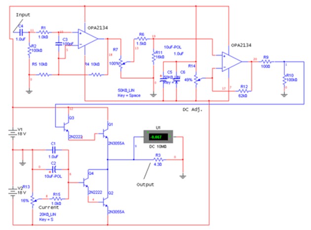

My new amp have a strange behave help!
Hi there!
Now I’m testing my project. It plays nice (the first impression ;-)) and the signal, both music
and the sinus wave looks find when I have the speaker hooked up.
As soon I replace the speaker with a resistor for 4 ohm I got a very hi frequency who is all over
the screen and the sinus is not there anymore.
The music signal is not there either but there is still music and it sounds still the same.
The DC offset seems to be effected and starts to rice.
Please can someone tell me what’s happen?
What can I do to solve the problem?
Regard
Progg70

You have RF oscillation. I'm afraid attempting to offer a cure for that over the Internet is very hard. There are so many things that could be causing it:
Input leads near output leads.
Poor power supply decoupling.
Missing/too small gate-stopper resistors on power FETs.
Poor earth layout.
I'm amazed no smoke has come out. Normally, RF oscillation is very brief and terminal. Assuming it's a transistor power amplifier, borrow a copy of the "Power Amplifier Handbook" 3rd Ed. by Douglas Self for construction tips.
Some things to try:
Add local decoupling to the power supply pins of the opamp to 0v.
Wire the output stage supplys back to the power supply separately using thick wire epecially for the 0v line.
Try removing C3. In many cases this can cause instability.
Add a small cap (22pF ish) between each opamp's output and inverting input.
Observations:
C2 may cause a large inrush of current at startup, and a DC bounce.
There is no control (servo mechanism) to correct for DC on the output.
The volume control will affect the DC on the output due to opamp offsets.
Conclusion:
I wouldn't connect this to a good speaker for fear of damage untill you have the instability and DC control sorted out - sorry...
It’s alive…
I don’t like signal feedbacks, OK you need one for the VAS stage but then they are more of the negative nature for a signal.
A DC feedback for the DC offset could be an option.
What do you mean with the “Then worry about isolating the power supply garbage.”?
How should I put the caps? Parallel with the resistors or to ground…?
I have now put the amp in a better chassis and better wiring so everything works now.
I have about 20 – 100 mV DC offset without any servo, so I’m pleased with that.
The sound I very nice and the thing get hot, nice. I have it in my room for 15 2M and the effect is enough.
