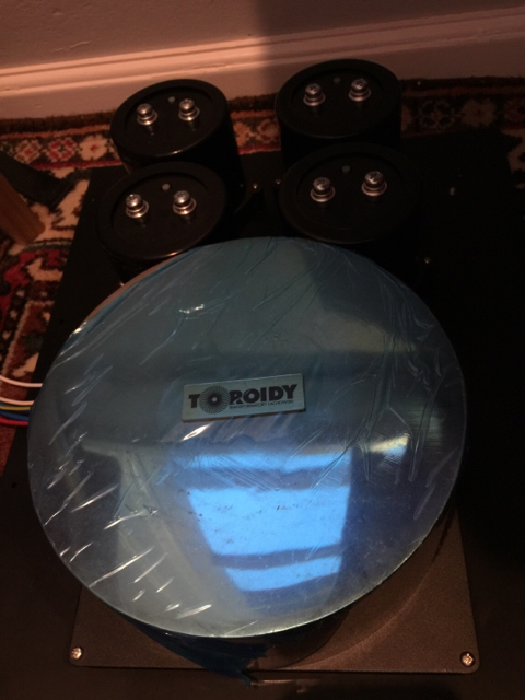

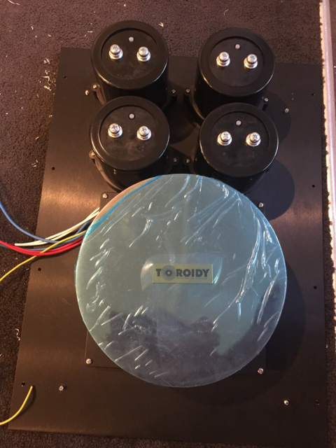

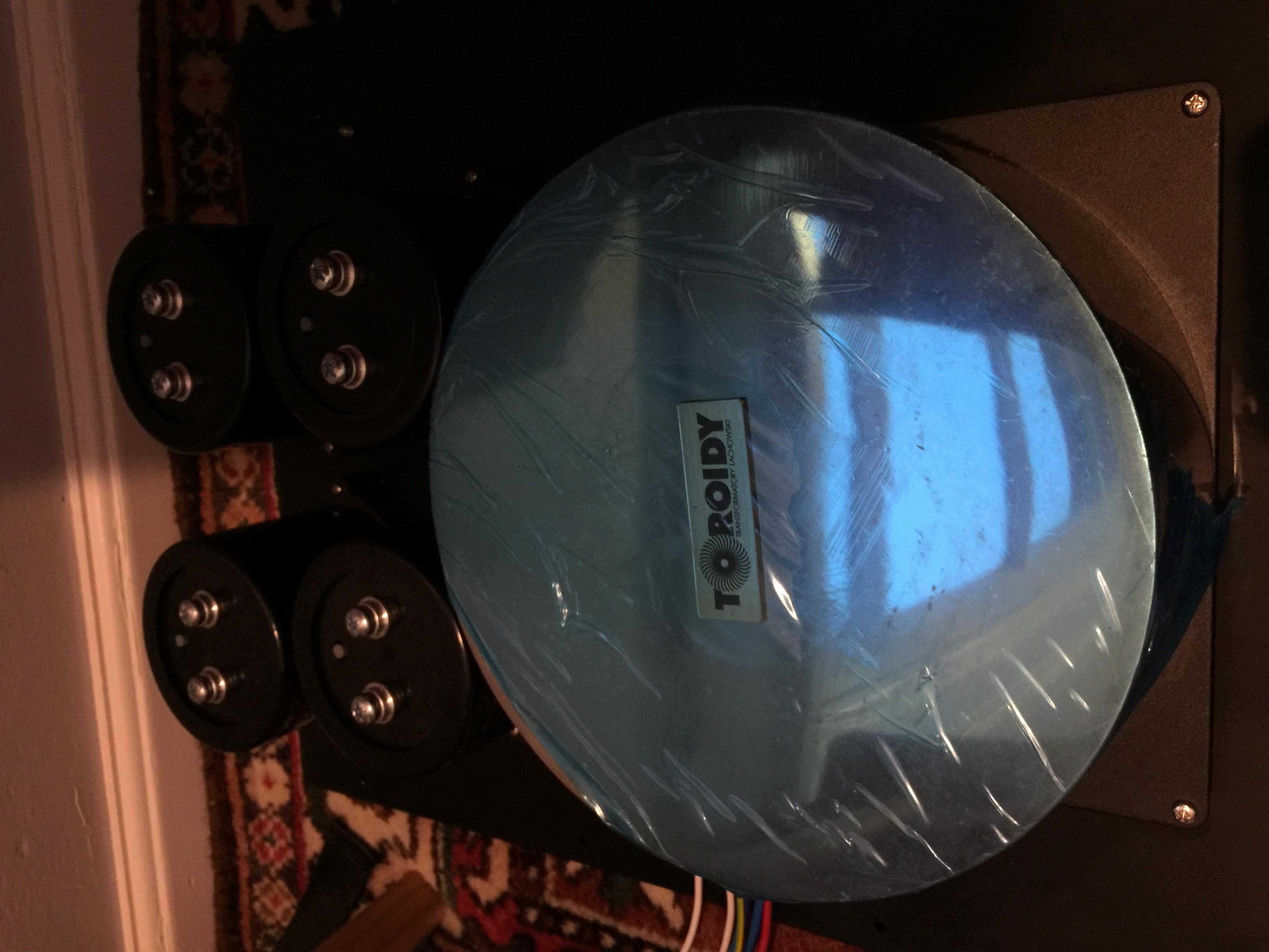

So the start of the build aim was to mount the transformer and caps, easy enough I thought?!!
Well the 1200VA Tranny from Toroidy is a dam beast! At 23cm, nearly 10inches and weighing probably on 45 pounds or so it isn't the lightest going around. It mounted to the plate with a large M10 bolt.
When I first mounted it I realised the logo was upside down. 'No one is going to see it what does it matter?'
The OCD in me took over and off it came to get the plate feed out hole the right way and bolt it back down :) Next to mounting the power caps. For huge caps they have impressively low ESR some Im hoping for a good result from these guys.
Note to one's self, it's always easier to mount feet on baseplate prior to mounting heavy objects on top! Theres my word of wisdom for the day! :scratch:
Already with just the caps and transformer mounted Im quickly running out of real estate!

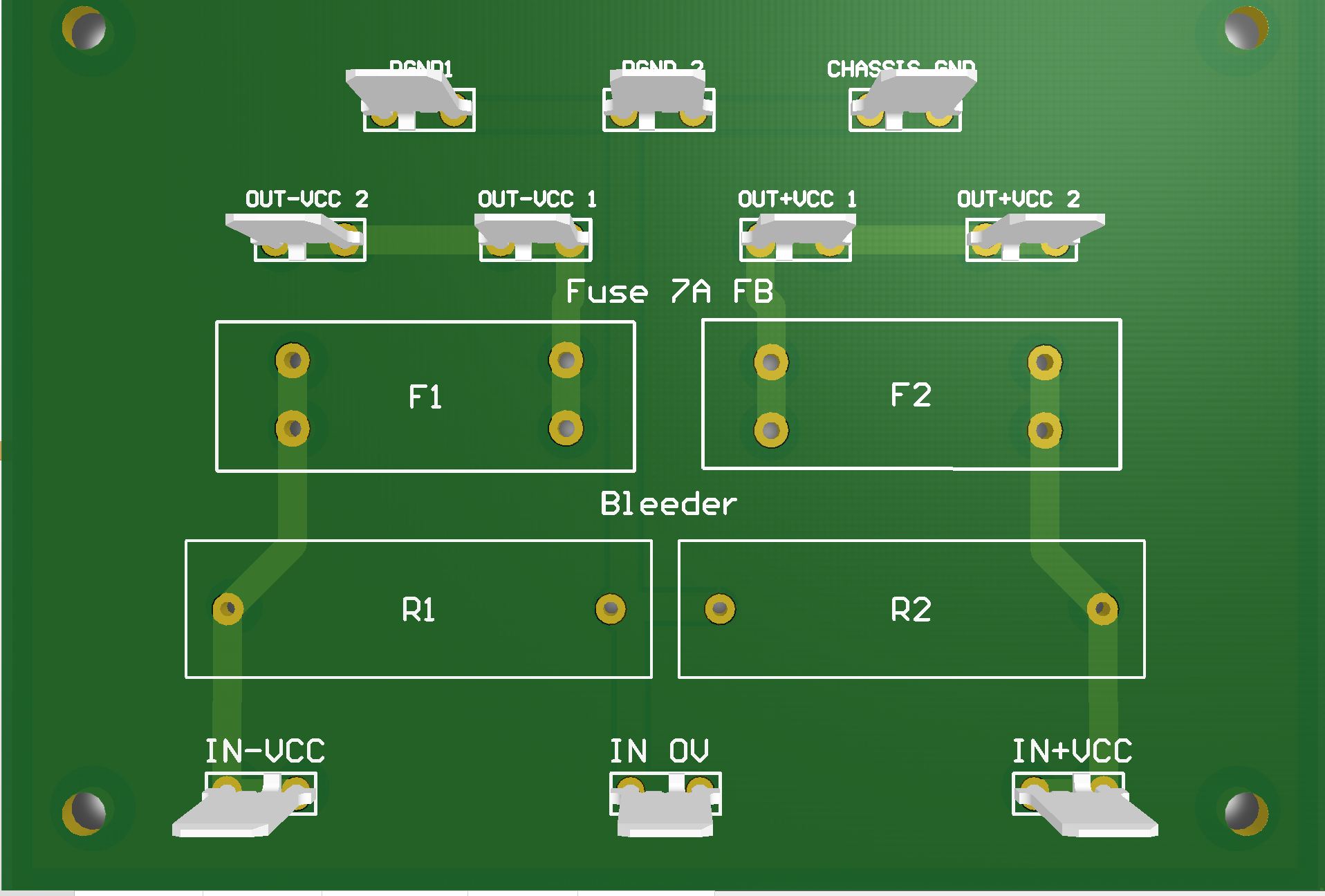

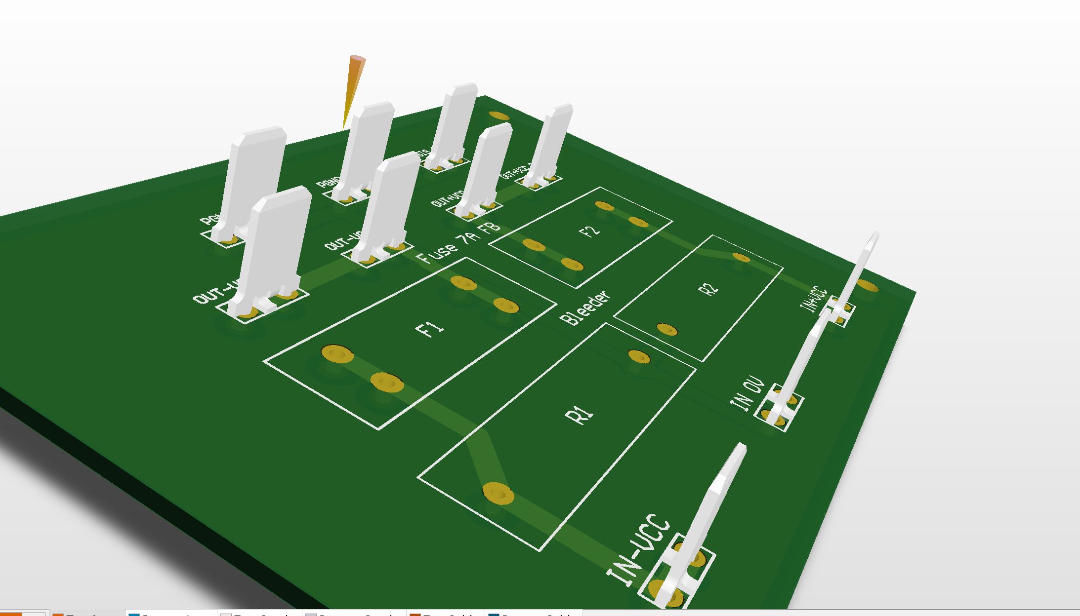

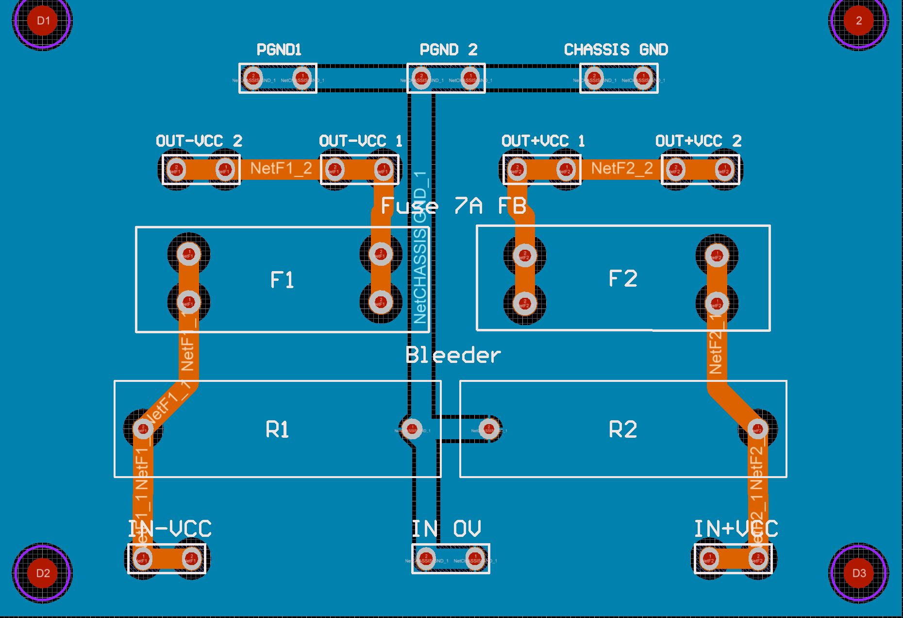

I've diy a small little PCB board to house the bleeder and fuses for post caps which should land tomorrow so come this weekend, it will be onto mounting the AC controller, wiring IEC, power supply and testing before moving onto the amps.
Here is a few pics of the progress thus far.. Its my first large amp build so be kind :)
