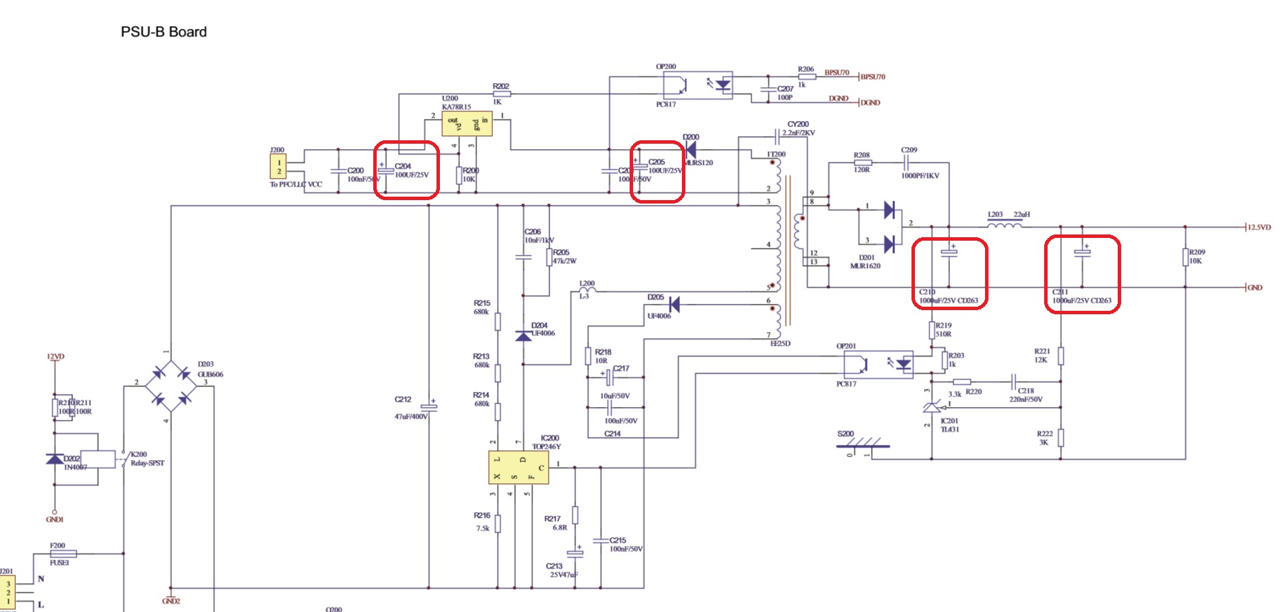

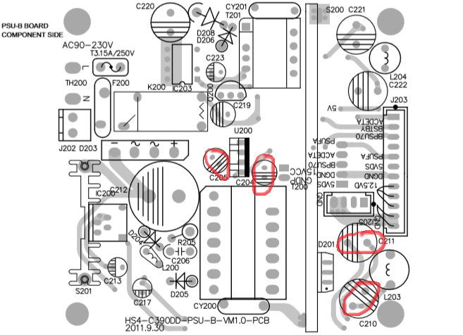

I was repairing a NAD C390DD for my friend and tough I'll post the solution here too as this type of problem is likely to happen on other units and I did not find it documented in web prior to this.
Symptoms before fix
A) When powering on from back panel power button the orange 'sleep LED' comes on
B) After push of the on/standby button on front panel 1 click of a relay can be heard and the orange led turns blue ... display will so no sign of life. Not other relay clicks follow. The unit does not switch on.

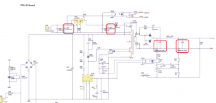

Problem appeared to be in secondary PSU which supplies the +5V and after switch on the +12.5V.
The +12.5V power line showed only +4.5V after the step B. So clearly something wrong. Anyhow, longish troubleshooting later it turned out to be a fault in following capacitors.
Hope this helps someone in future.

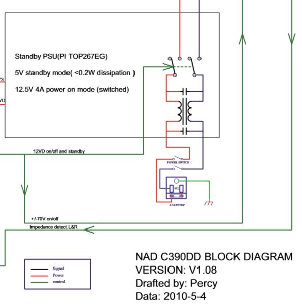

Have you or anyone got the power up sequencing of the various boards in the C390DD? I notice various power sensing signals that control the relays for 12.25V 5V & +/-70V supplies.
I ask because I'm looking at some experiments on better quality PSes but didn't want to get the sequencing wrong & damage/detroy boards

Particularly the bigger green capacitor C212 on PSU-B was bulging at the top on mine.
That is not one of the capacitors you changed so that would be an extra one to add to my list of ones to change.
