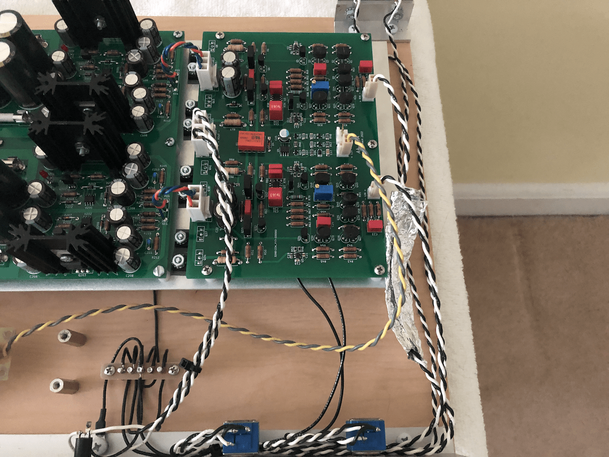

I think there may be a mild instability issue. I noted some variable hum at intermediate volume settings. Playing around, I found that if I touch the wires going from the potentiometers to the board inputs, the hum intensity changes, and if I hold them together, the hum stops, there is a little "pop", and the DC offset jumps. I wrapped the wires in foil and grounded it, which kills the hum. Now I can null the DC offset with my (yes) 20 Ohm trimpot and no noise rotating the volume knobs.
I've found that hum I can be a sign of instability. I need to investigate. I didn't see any signs of misbehavior on the scope when I had the amp on the bench.

I spent more time looking for instability last night but came up empty. I discovered that just shielding the one input pair going to the board is enough to get the amp to settle down. As I said, it's not a gradual thing, but a sharp transition from noise to quiet, with a jump in DC offset. Grounding the foil through a capacitor works, as does holding the foil with one hand while touching the chassis plate with a finger on the other hand. Or even just gripping the foil tightly without touching anything else. So I say to myself, "Why does a tiny amount of capacitance from the input leads have this on/off effect on the circuit noise?" It seems like something is oscillating, but I see no evidence of it.
The relay driver is electrically isolated from the rest of the circuit, but touching the ground pin on the (unconnected) LED output connector with a clip lead induces noise in the output. I tried unplugging the input and output connections to one channel to see if there's a ground loop and it made no difference. It's acting like something is floating that shouldn't be. I hooked a clip lead to ground and tried poking around at various points on the board (obviously, ones that are supposed to be grounded) with no consistent results. At one point, putting my finger on the side of the plastic headphone plug was making noise.
There's a lot of FM broadcast signal in the air here. I'm starting to think it's an external thing, but I'm not sure. The good news is the amplifier is well-behaved with the foil hack and sounds really good. The whole subjective review thing is such a can of worms that I hate to say anything, especially in comparison to the A3/HPA-1, for fear of inciting a riot.

I am cautiously optimistic that the amp will behave if I put it in a box, so that's the plan. With the connectors, I can easily swap out PC boards later if I decide to do another iteration. For now, I don't feel like binning $150 in parts so I will proceed as planned.

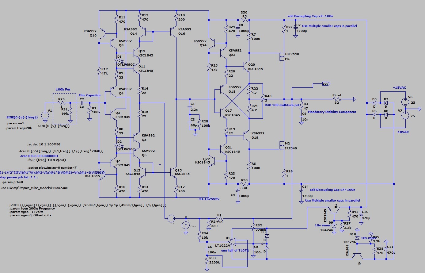

The beauty of it is that I don't take any words back and still think you were wrong on that because it is mathematically impossible to have 0V at the feedback nod once you have the feedback resistor divider ended in the same 0V ground point .The output was the one forcing the input to -0.7v as a diamond buffer input at the input trz base with no resistor added has identical voltage as the output at the output trz emitter and the most natural way way to fix it was to make rv1 higher in value giving a wider play range also allowing for smaller currents at both the output and input.Making r10 r11 in series with the same rv1 higher you gave a higher play for the emitter currents and let trz auto adjust their bias at a lower current as the output current being smaller the input of the buffer's current gets also smaller. Essentialy it was the same thing except having rv1higher I though you'd have allowed for a significantly higher play range...
As for the rest of it I think it's just your turn to discover the natural disasters resulting from having too many diamond buffers with their huge impedances at a bipolar EMI loving transistor.Not that it's not manageable just useless complication.
If the bases of the input pair were floating, then the whole first stage buffer would be floating and I agree the input would follow the output. But the input isn't floating. It's connected to ground through a 100K resistor. So, for instance, if the input bases float to 1.0V, then you have 1.0V / 100K Ohms = 10uA current flowing in that resistor, coming backwards out of the diamond buffer input. Assuming everything is perfectly matched and balanced, with a current gain of 250,000, that would correspond to 2.5A of output current. Conversely, you'd need to force 2.5A into the output of the buffer to get 10uA flowing in the input.
Ignoring possible issues with the way I implemented the circuit, here's what's actually happening. The diamond buffer current gains aren't matched. The base-emitter offsets aren't matched. The input pair are settling with a 7uV input offset current, which is producing the 700mV DC input offset across the 100K input resistor. The diamond buffer has a voltage gain close to unity, and is driving the feedback node to 700 mV. Without feedback, there'd be 700mV / 332 Ohms = 2.1mA output current flowing in feedback resistor Rg to ground. This is mirrored to the driver stage output. Multiplied by the 100K driver load resistor (Zo), this gives you 210V DC offset. Open loop gain is like 50dB, so the buffer would clip at the rail with 700mV input. With feedback connected, as the amplifier output voltage rises, current flows through Rf and into Rg until voltage across Rg equals just about 1.0V. In both VFAs and CFAs, the action of feedback is to reduce the voltage between the inverting and non-inverting inputs to near-zero. The feedback current will increase until it reaches 2.1mA, minus something like 21uA which is the CFA error current. This 21uA flows in Zo, giving 2.1V DC at the amplifier output.
This is just an engineering argument, nothing personal. I'm happy to hear your counter-arguments, but I can only rely on what I think I know and if you can't convince me, well, we're in a bind. In many debates, there is room for differences of opinion, but this seems like a matter of black-and-white circuit theory, so it should not be necessary to "agree to disagree."
I will also repeat what I said earlier, that I tried to validate what you said with a simplified SPICE model and the simulation did not exhibit the behavior you predict, not that I expected it to.
I don't agree with your analysis, sorry, but I do appreciate your having the interest to comment.

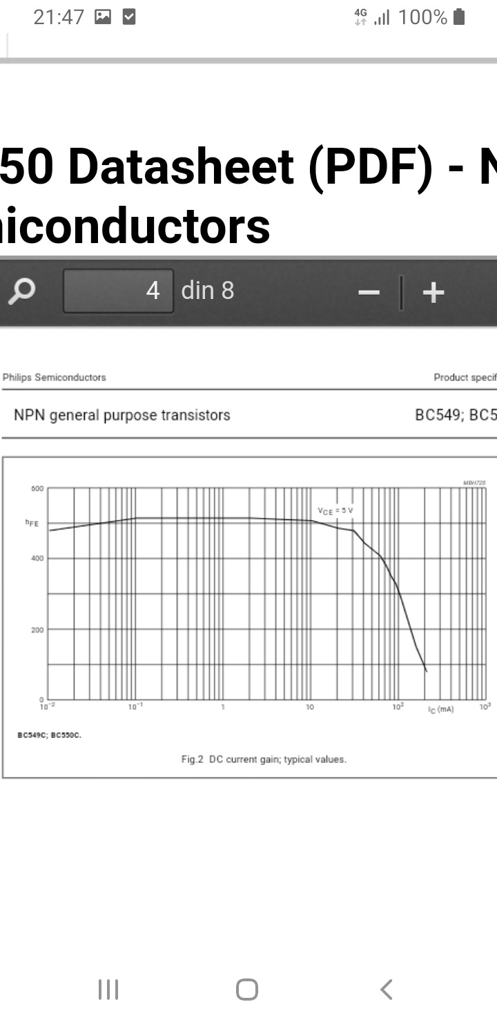

Assuming a 250 000 current gain would not be on the leash q3 and q21 will never be able to deliver 2.5 Amps...while approaching 100mA bc550 won't still have an hfe of 500...
It doesn't matter if the current gains aren't matched, the closed loop gain either current or voltage is the one setting the pace for bias.
So...I like your argumentation just refute the arguments.

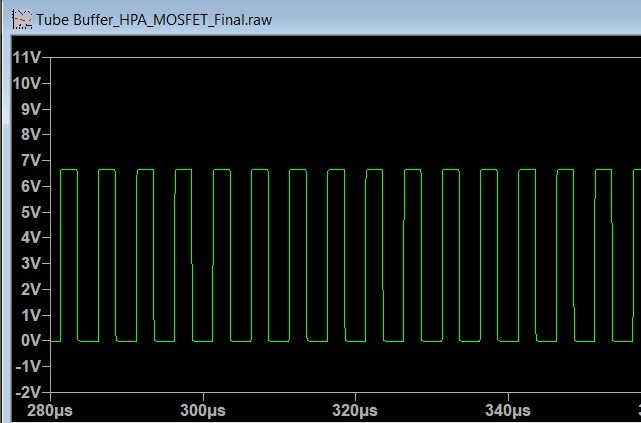

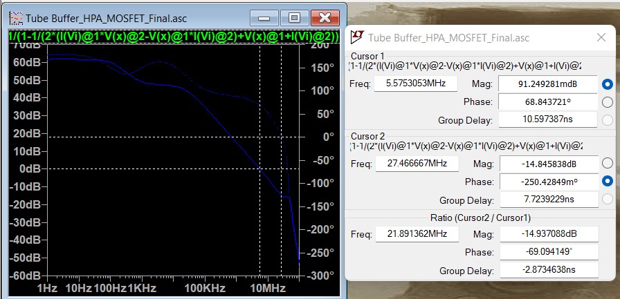

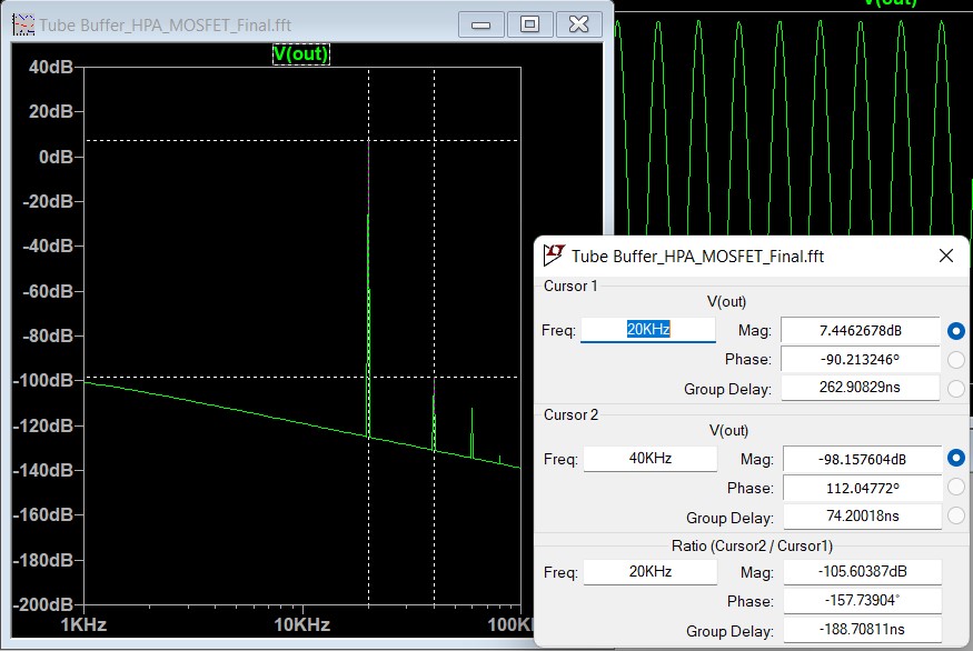

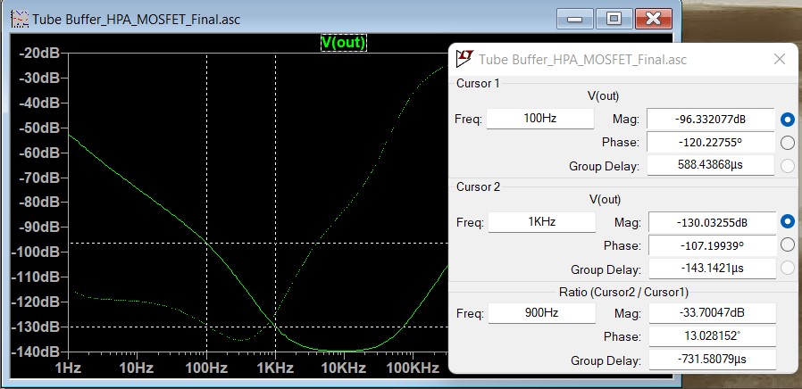

I am working on something similar with a MOSFET output, but not able to get the loopgain profile like yours. Can you take a look and comment..Please.
I guess my attempt at the Socratic method failed. FWIW, the loop gain in your circuit is determined by the values of the front-end load network (C1/C3/R28) and the feedback resistor (R1), plus whatever impedance the output buffer presents. I don't know the purpose of C1, but it increases the gain progressively below about 500 Hz. Do you need that extra feedback? And why is C3 so large? It's incredibly heavy compensation. What's your phase margin?
you are right, C3 is 82p missed that and corrected later, now reduced to 68p. C1 and R28 combination helps roll off the output at higher frequency, avoids oscillation from mosfets. C1 also introduces additional gain at lower frequency, not a bad thing to have. picked that trick from one of Apex audio designs.
  • Tube Buffer_HPA_MOSFET_Final.asc
Ok, that makes sense. I can't run your simulations directly because I don't have all the device models handy. I removed a bunch of stuff from your model before to make it work (don't need the servo and the cap multipliers to check out the loop response), but didn't save my work. Maybe you can just post the plots from your sim. I have enough work to keep me busy here, LOL.

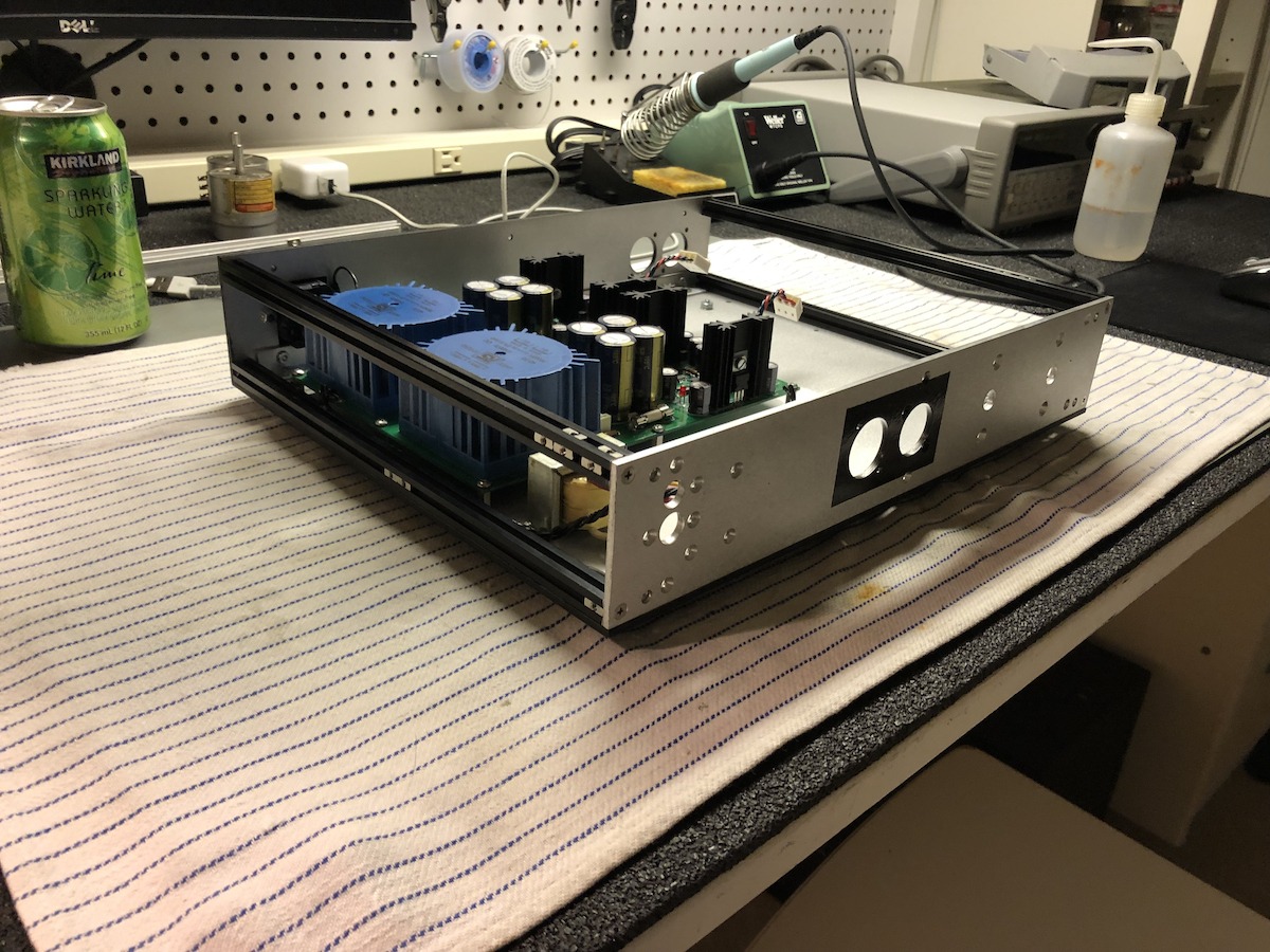

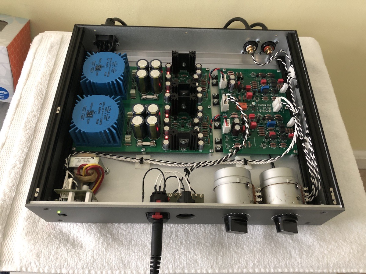

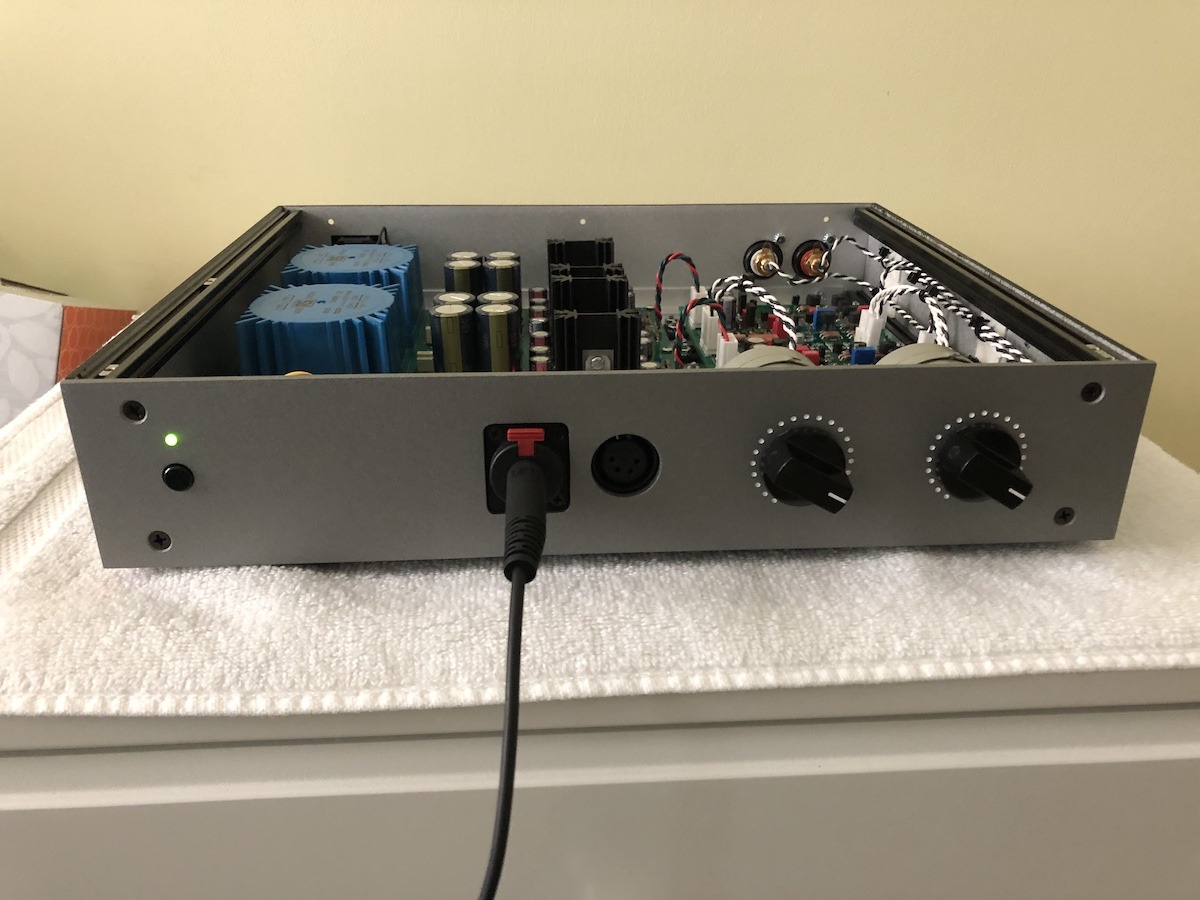

I got this running just now. The only thing left to do is a little chassis work.
The goal of this project was to keep the general character of the A3, but improve on it. I think I've succeeded. What that means to other people is a matter of interpretation.
