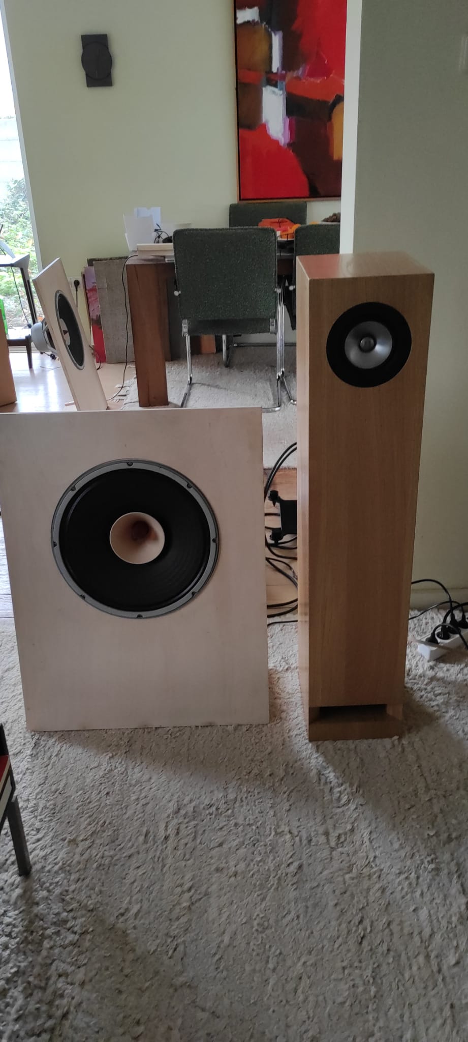

New Lii-Audio “Fast-15” - anyone hear these yet?
Here they are next to Sibelius SG.Another full range speaker.
They stand their ground.

Comparing them once more with my Maggies and solid state
Those F15' s are incredible at 450 euros.
But as a dipole speaker they need room at the back to breath just like the Maggies.
Maybe that explaines some of the bad reviews.

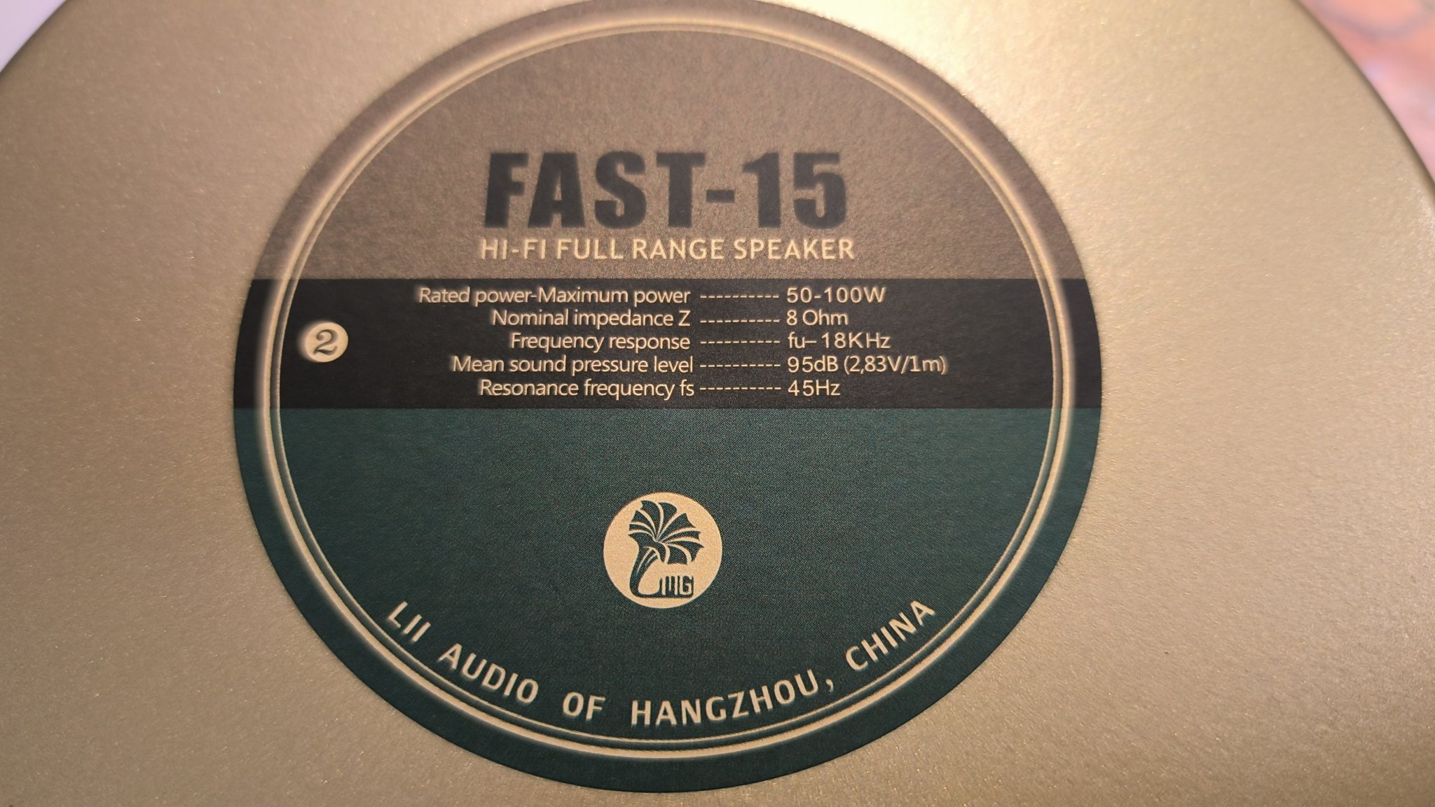

Could you please show the speaker driver's back & label so there would be no doubt which one it really is? Thanks.

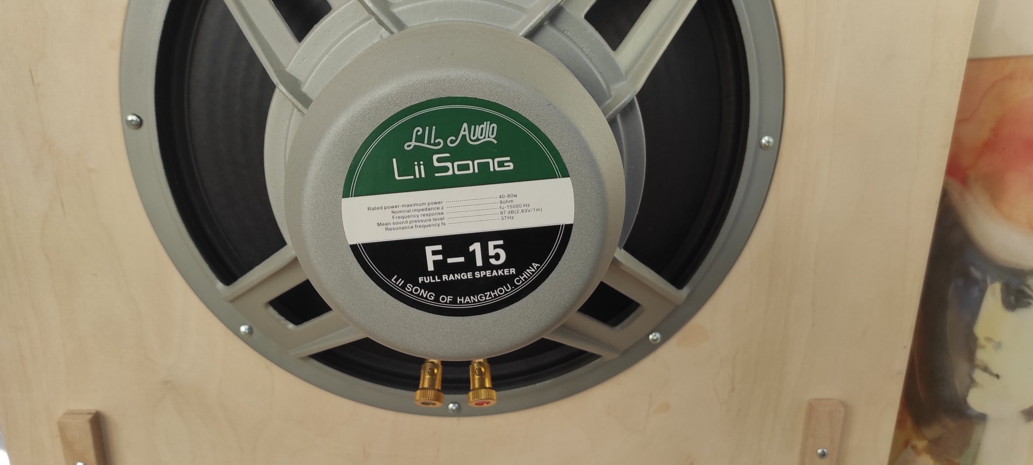

same color label as the ones I picked up through the Liiaudio website recently. (i passed on the fast 15 ) My baffles are taller w same width -the driver elevated to near ear level. This has been my introduction to full range & open baffle and I'm pleased 3 months out. midrange / vocals / strings / etc.. very nice. Bass is good to 70 hz. My only criticism is the sweet spot is narrow, which doesn't surprise me, but for $450 delivered, not to much to fault. Of course I will eventually want a proper 2 way dipole like what Perry Marshall designed & shared in the forum, but these will do for the time being...

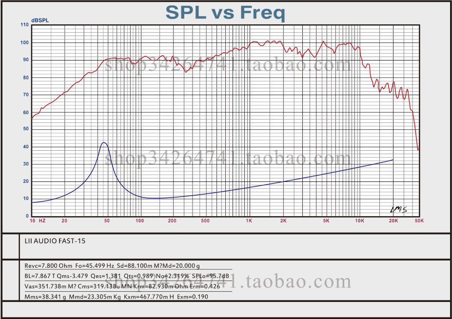

Well, the taobao Lii storefront has six buyer remarks dated 5/25-10/22, take them with a pinch of salt:
(Chinglish translation)
10/22 Even naked very good effect.
7/08 Washbasin-size, sound quality very good [vid snipet].
6/24 First-rate workmanship, good-looking, full and clean sound.
7/17 Sound delineated not thin and tight; balanced, after burn-in should be even looser extended; very satisfied long-time cooperation.
9/09 Have expectatons once in cabs.
5/25 DIY, listening before paper-barrels arrive, mid and HF excellent, even cab-less bass not bad.
According to the product description, Qts=0.99, requires less than 150L for bass, even naked has audible 90hz.

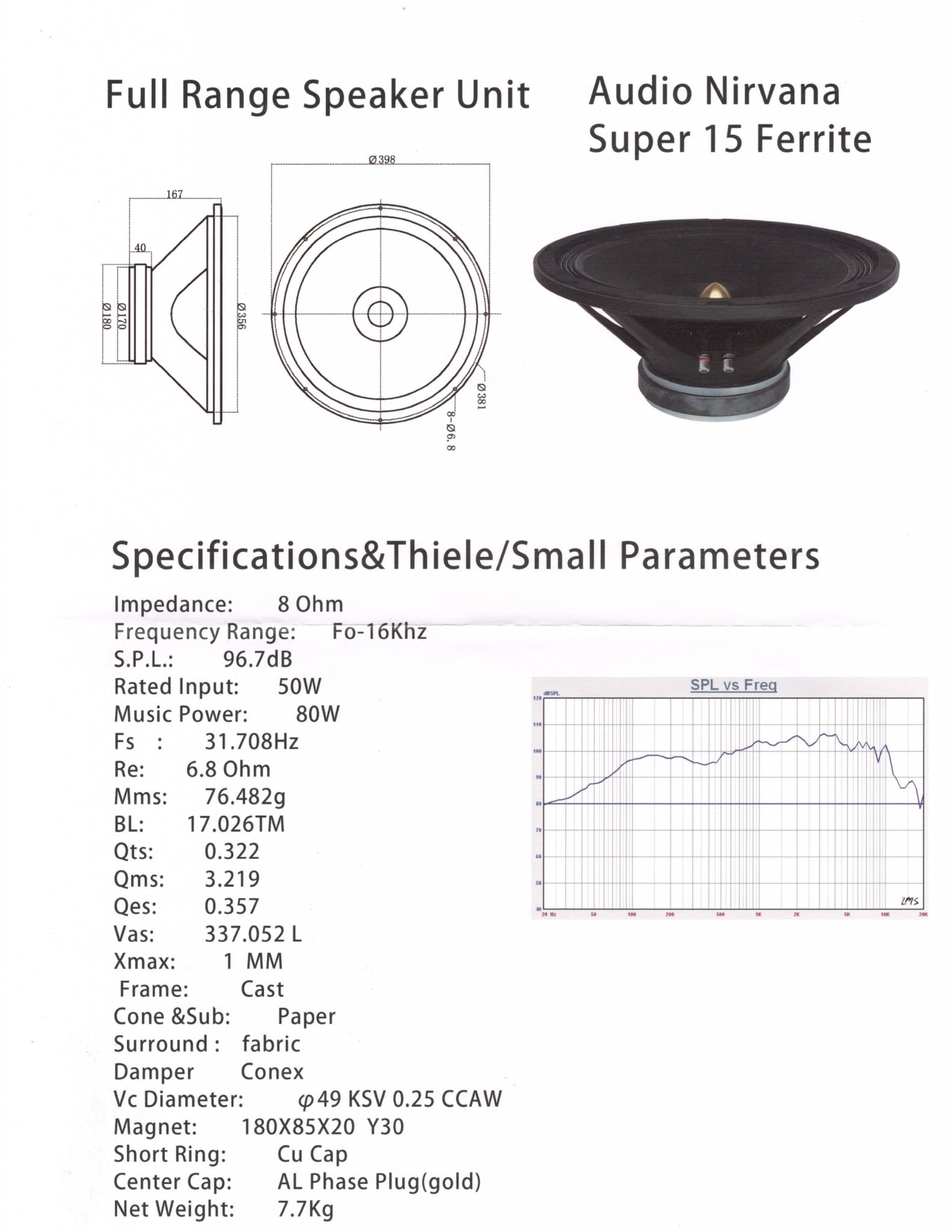

I have a driver very similar to this one, it's possibly produced at the same factory. I've attached the current data sheet. I've been VERY happy with the Audio Nirvana driver. I think this bodes well for the Chinese sourced driver.

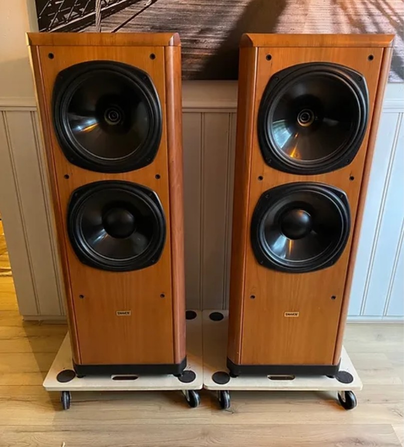

I' ve had Tannoy D900' s 10 inch coaxial with 10 iinch woofer.
I like my diy Lii F15' s a lot more.
