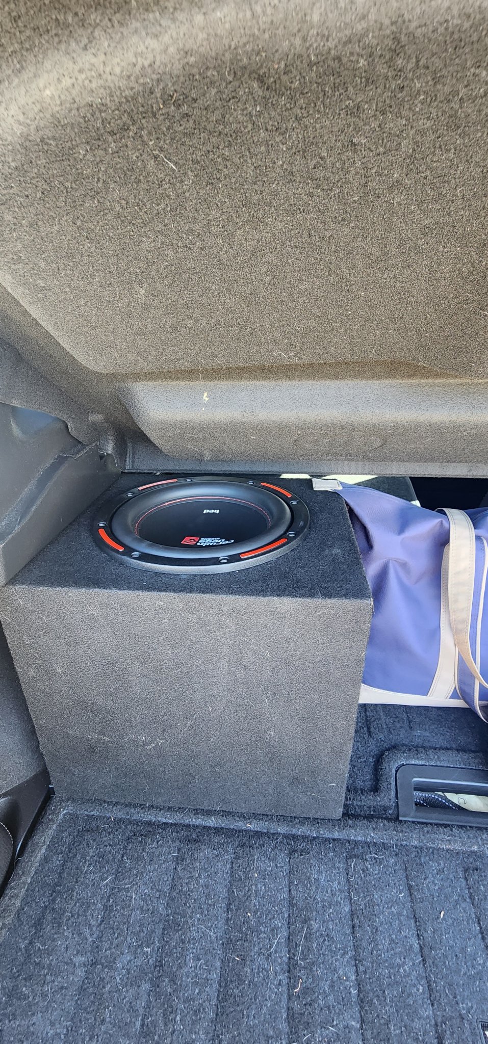

New to forum, just got first sub and amp installed: question about bottoming out

None of the subs you listed are likely to produce noticeably more bass. To get enough bass to make any changes worth the effort would take a significant change. To make the bass output significantly higher, you'd likely have to go to at least four 10s or two 12s and getting full power from the amp. It might be possible to get some gain with a really nice sub like an Alpine 12" Type R or something better. The Type R has been known to be a long time favorite. It's been replaced with a V2 but it's also likely equal. There are plenty of other good woofers by DD, JL, high-end Kicker and others but none are cheap.
It was dismissed but I suggested adding another 10 of the same model to your current enclosure and mounting them inverted. Wiring the amp to get full power and doubling the cone area will be the best bang for the buck. The inability to put groceries any place other than the trunk and the inability to remove the box when you go shopping limit your options.
So that double 10 in the same box was not dismissed. I was simply asking how that would work and y'all explained it to me! Could I do that same setup but instead of inverted, magnet to magnet?
Also, sorry if I missed this question, but I can put groceries in the backseat/floor. I'm not opposed to removing the box either.
Hell, if I absolutely needed to have some bass, I could get an 8 or even a 6.5 for grocery days/trips.
Will they fit magnet to magnet?
The available air space will be reduced (the woofers will 'see' a smaller enclosure) with a magnet to magnet configuration. This could work if the magnets don't hit each other.
Using two woofers will reduce the power to each one so they will be less likely to bottom out.
Did you go to the shop to see of you could get the same woofer to bottom out by pushing on the cone?
