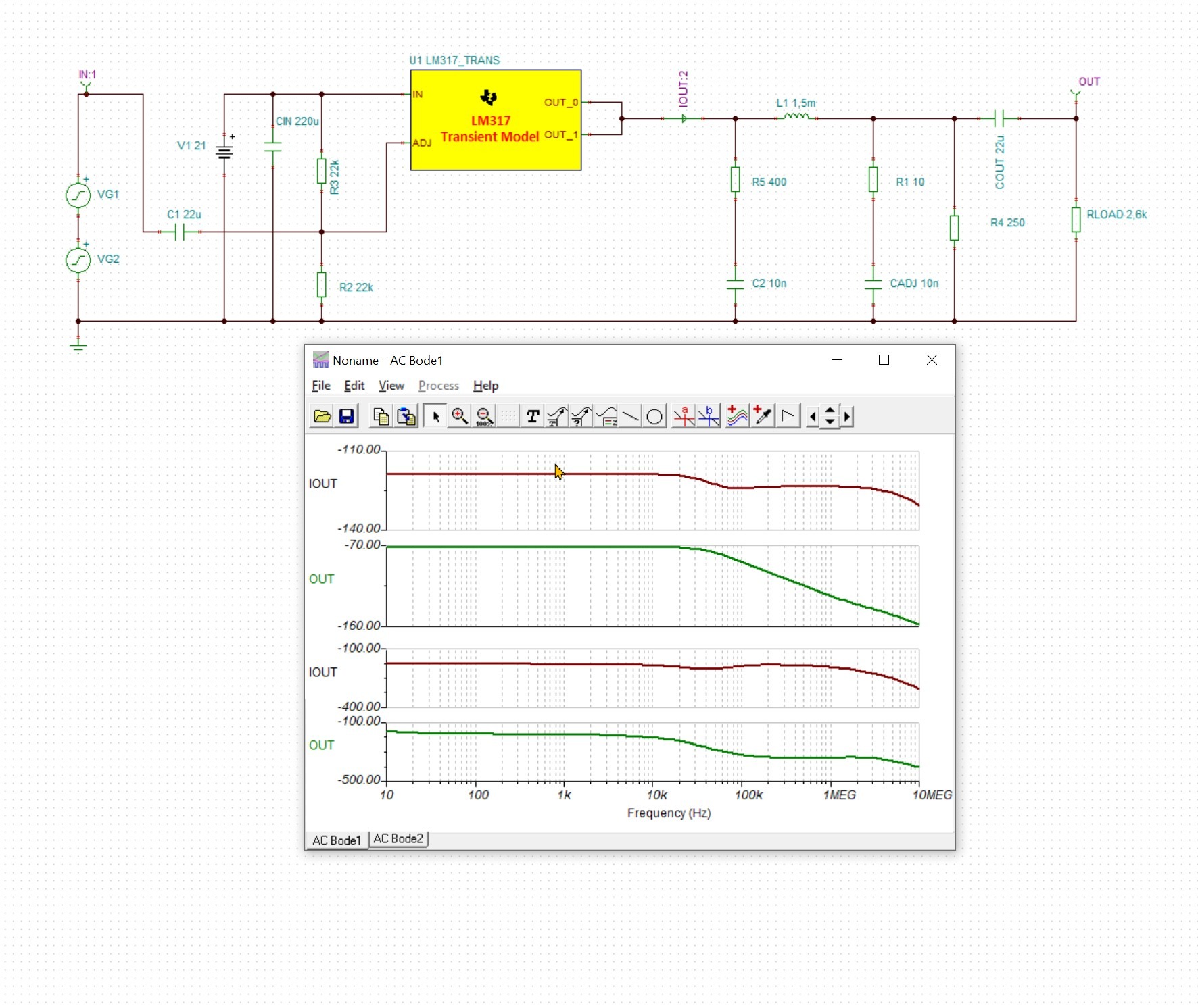

Is it any expected any noise improvement if I put a 1mH coil (ferrite core) on the output pin of 317?
That would be dangerous, since it could have weird and unexpected effects on stability.
In addition, to effectively remove some of the noise, the inductor will necessarily curtail the frequency response, which is not huge to begin with: a few tens of kHz, adequate for normal audio, but reducing it further could be problematic
Interestingly and confusing, with all BW and power details considered, the noise analysis simulation using Tina shows a reduced SNR (let's say at 20KHz) with adding the inductance! Maybe I did something wrong.
I will do the LT simulations, but not quite soon.
For now, the coil stays out.
More, the Tina simulations indicate a relevant and easily measurable change of performance at low bass and high treble if the Headphones (300 or even 600 Ohms) are set to Max. But in reality I cannot measure it. Pointless to say I cannot hear it (beyond my ears and my headphones too). However, I can hear it, more like distortions in the 1-10KHz. This is below the Max power of the headphones, and I know how they should behave at the SPL driven.
Dial the headphones down a bit, and the sound quality gets back to normal.

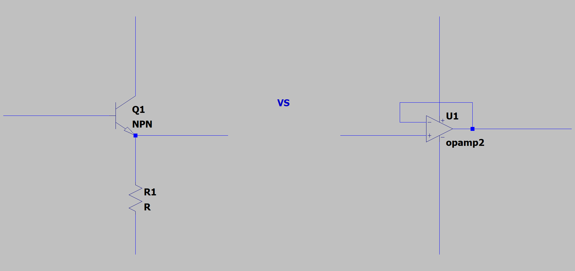

Ya, a CFP is logically the same as a "White Buffer", which uses two ~NPN or two vacuum tubes, but a CFP does not have the PSRR issue. A CFP can have stability issues and require a Zobel network. But I still think a single op-amp replacing the EF and the pull-down resistor, ie 4 wires is the best solution. For stereo, a dual op-amp replaces two transistors and two resistors.
