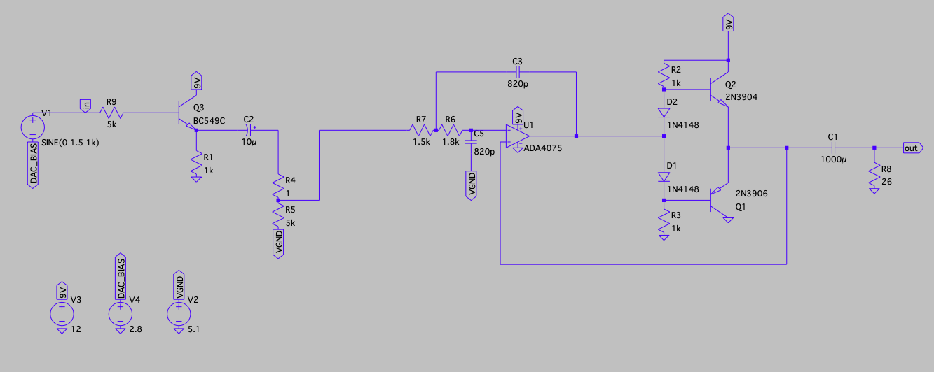

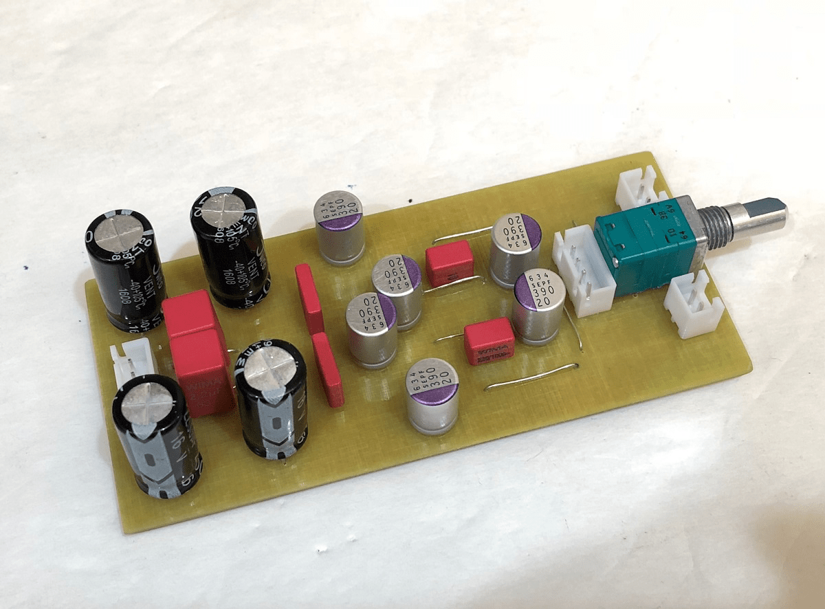

The point of C4 @Mark Johnson is to avoid interaction of the pot with the reconstruction filter–so that the cutoff fq of the filter doesn't decrease with volume decrease. But actually the shift shouldn't be that much if I use a 5K pot... I could then eliminate C4 and R10 too, if I ground the pot to VGND :) Then replace C2 for a bipolar or at least reverse it to block the VGND voltage higher that the DAC's–buffer bias.
Like this,

I also need C2 to decouple the DAC-bias (2.85-0.69V) from VGND (5.1V) @Mark Johnson .
It's more the output cap that makes me uncomfortable, since it cannot be oversized much in voltage rate for physical dimensions and it interacts directly with the phones. I've been researching for discrete ways to lift the phones ground to VGND voltage for a capacitor-less solution, but without much success.

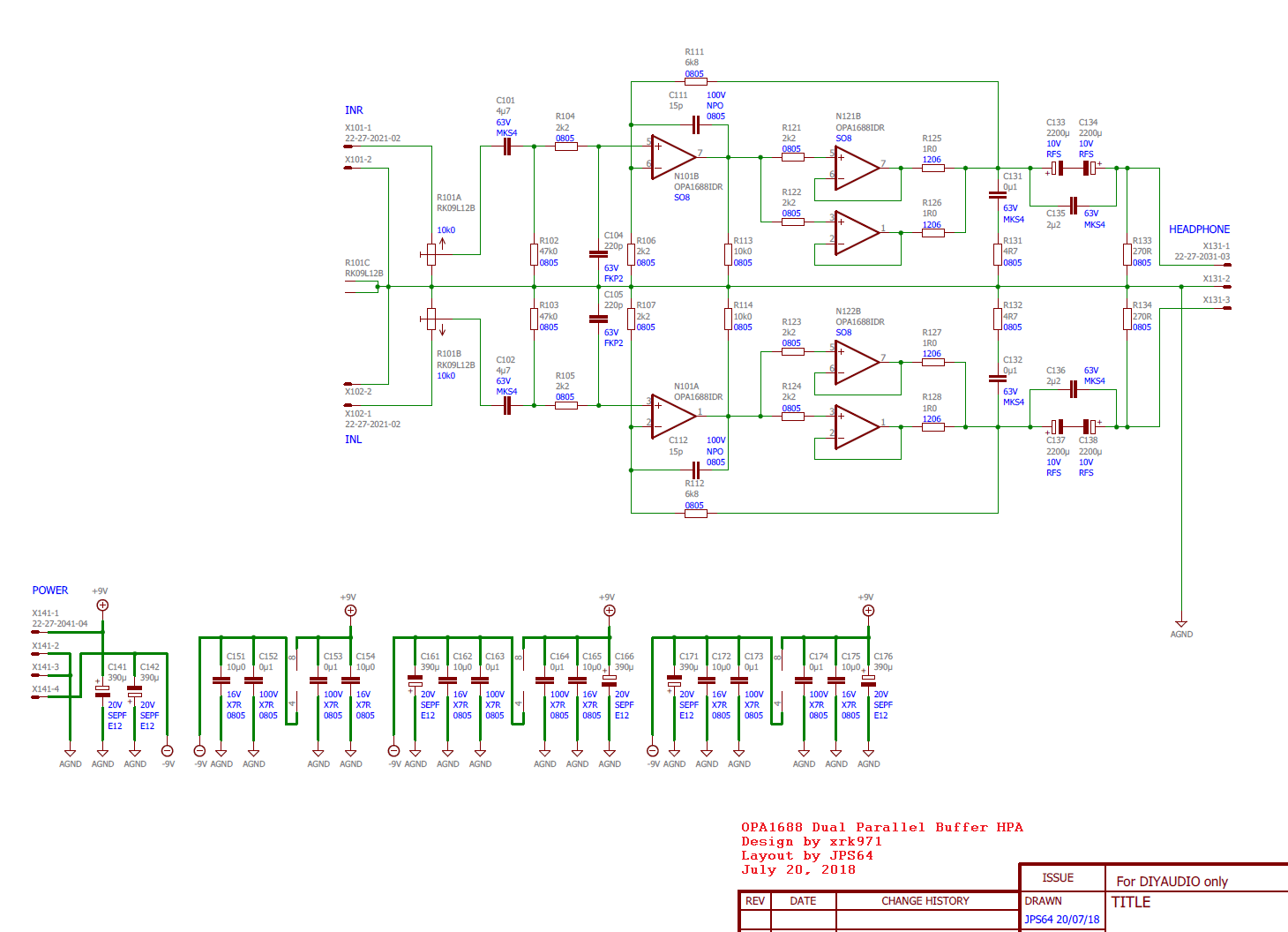

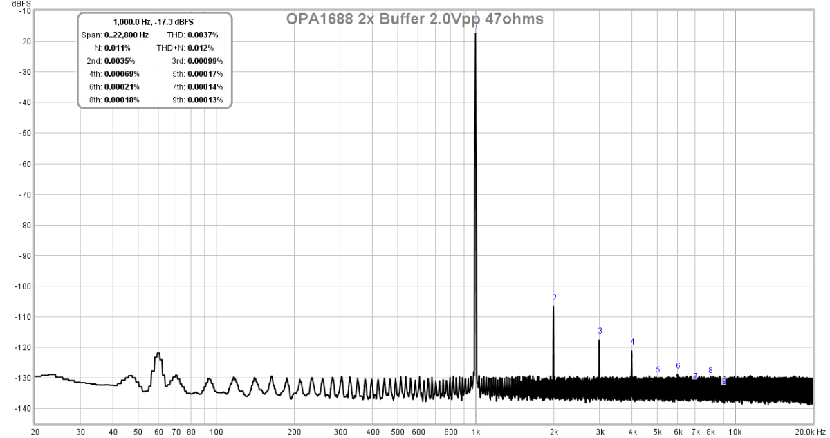

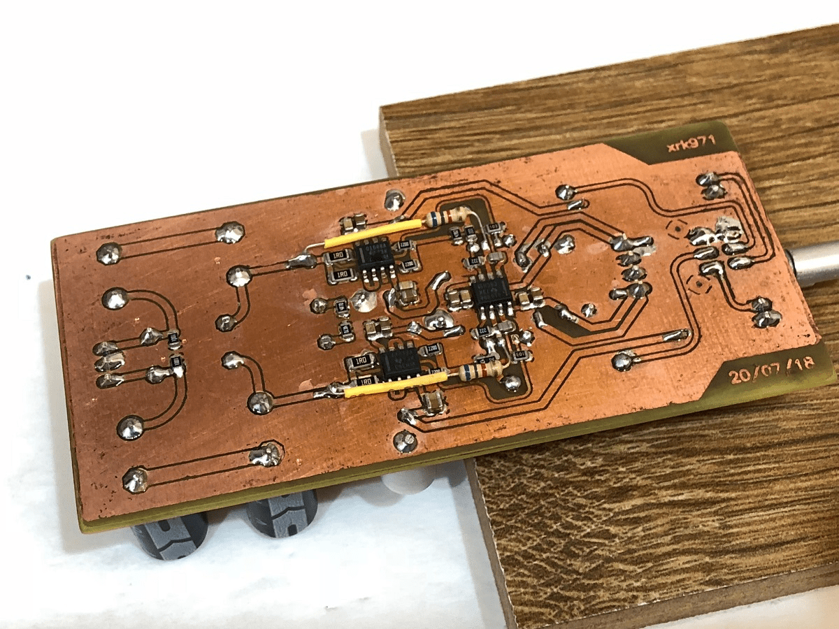

I built a dual parallel opamp output buffer HPA using OPA1688’s but I think OPA1656’s would work even better. You can do a homemade etch PCB if you like. Files and data are all here:
https://www.diyaudio.com/community/...pa1688-low-thd-muscle-amp.324931/post-5494197
I have used it with 16ohm 115dB/mW IEM’s and it works great. You can skip the output coupling caps if you use a DC protection circuit (separate).
2Vpp into 47ohm load

Why do you use a trimmer instead of a 330R resistor? Would it be to find a sweet spot, how do you determine it?
And a bit extra related but taking the chance that I've got your attention: My case space is quite limited for big output caps, but I also don't want to lose any hearable bass. I found some 1000uF 6.3V Panasonic FK-V caps that are about the max. size I can afford (8x10mm). Would you have a say on that?
You could use a fixed resistor. It would of course be smaller and it would actually be more reliable since trimmers can fail. But unless the devices in the left and right channels are matched, you might need different resistors in each to get the same bias current in both sides. You can determine the values on a breadboard with the actual transistors you will use before soldering. If you don't care whether the two channels have the same bias then you can just pick a reasonable value and run with it.
I'm guessing the output cap is fine, as long as it will not be seeing more than 6.3V across it. A 1000uF cap makes a 6 Hz corner frequency w/ 26 Ohm phones so you will be down less than 0.5 dB at 20 Hz. Given how little content most music has that low I suspect you wouldn't notice the difference, but your mileage may vary. This is something you can play with on the breadboard. When making compact designs I have sometimes used 680uF output caps with 32 Ohm phones and it has been fine for me.

Thanks again Jason,
My doubts on 6.3V caps with ca.5V bias comes from a good old article:
“For the lowest possible distortion when DC blocking/signal coupling, I suggest the 16 volt pair is only used with negligible DC bias, the 35 volt pair be used to say 6 volt bias and the 63 volt pair to say 12 - 15 volts bias.”
That refers to back to back elcos. But I’ll anyways fit what I can.

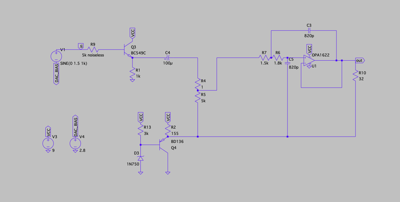

I came up with the following experiment to "lift up" the ground with a high current PNP transistor, so headphones can be grounded on the lift and use no capacitor. The solution works and sounds actually good, but consumes quite a lot of current.
No need for transistor.
Should be 2 channels in opamp.
Use opamp for dac input.
Circuit looks like 1622 has input right to Vcc used as Vref or Vg ( virtual ground )
needs cap.
for no output cap can also use bridged opamps.
use 2 channels of 1622 for similar circuit.
