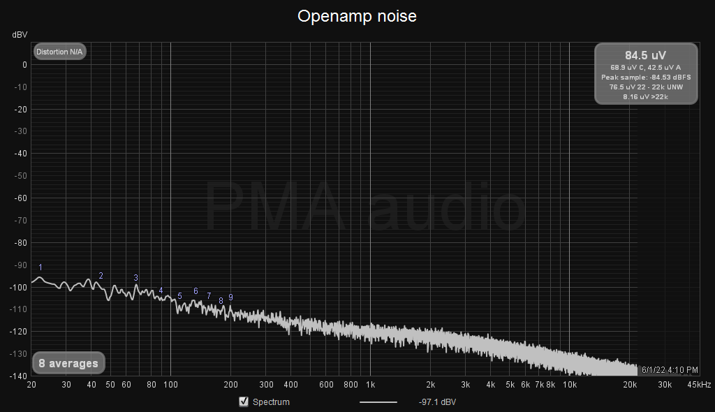

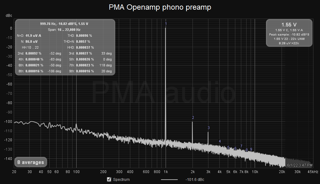

I have some new measurements -
THD 1kHz
and noise with input 50ohm
Reactions: 1 user

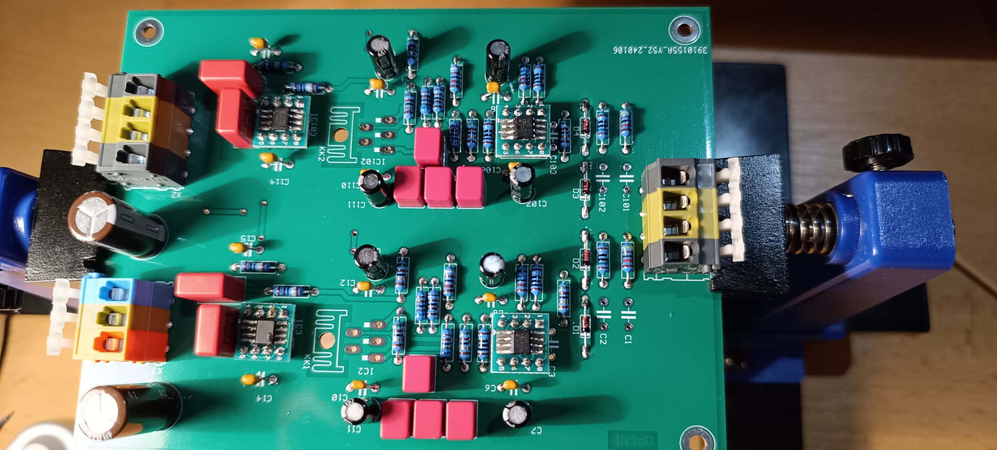

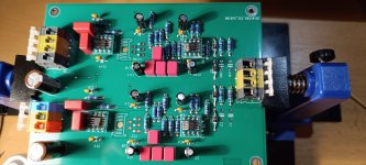

Well almost done, I was a bit scared of smd soldering but in the end it turned out pretty good. On the first position I used the excellent ADA4610-1 and the servo is in charge of the OP177GPZ. I'm just waiting for the LT1010 and it will be done.
Capacitors and resistors which are responsible for the RIAA curve I tried to select within 1% tolerance.
The OPENAMP1 power supply is finally taken care of by a shunt regulator from Dadod. PCB shunt regulator in smd version are on their way. ;)
