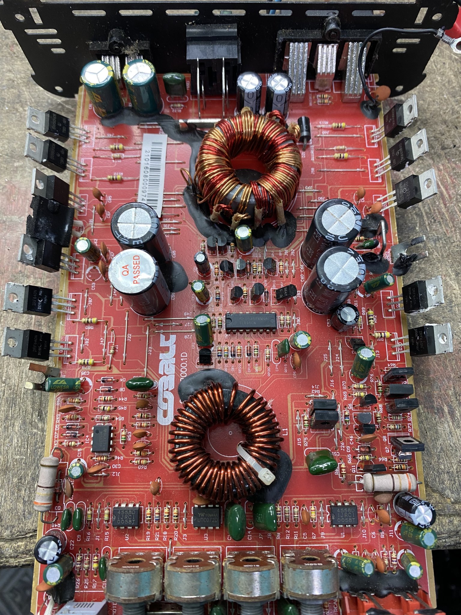

Orion CBT2000.1D

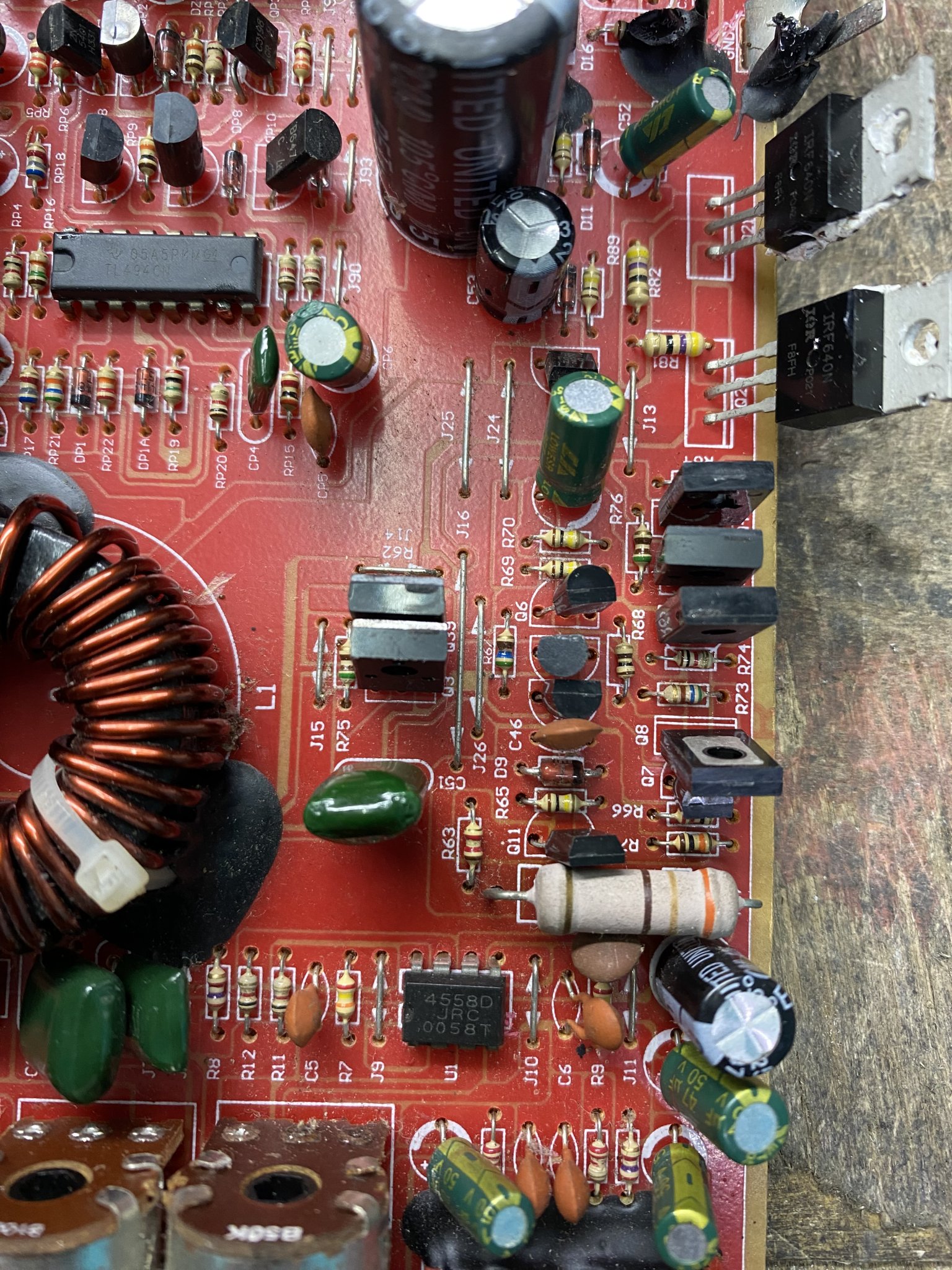

This amp doesn’t produce output.There is no drive signal going the the output FETs.Rail and Reg voltages look ok.There is 5532 op-amp and some transistors for drive circuit but I don’t no how it is supposed to creat the drive siganl.
I see audio on all three op-amp in the pre amp circuit.
Any suggestions?
With no references, I don't know what to suggest other than checking each transistor and resistor. If you go through the circuit and mark the diagram I sent with the corresponding parts in your circuit, I'll try to make suggestions.
In other circuits, Q47 switches on and delivers voltage to the rest of the circuit. This is muting in other amps.
