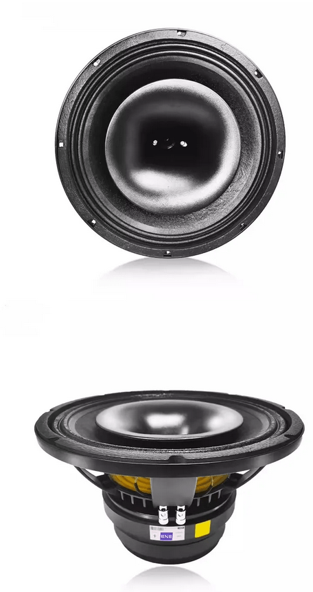

Here is a new one for me. What looks like a whizzer is not part of the woofer section. It doesn't move and forms a guide for the tweeter. I am aware of those older type large woofers with rectangular horn over the coax tweeters. This driver seems to differ a bit by trying to balance woofer cone depth and guide height by taking a flatter approach. Could this be the approach to explore for the community development? I want to investigate this approach in detail by combining an extended range subwoofer/woofer and a FR or tweeter that can go low. The donor woofer would have a large enough dust cap that can be removed to mount a custom throat that can retain the higher frequency driver and the woofer vent large enough to run a line to a volume mounted behind the woofer magnet. If we can find the right donor woofer and HF driver, then we can place a custom foam overlay on the woofer cone to change its dish to a flatter one while matching a waveguide to the HF unit that will ensure zero interference with the woofer cone surface. I have a feeling this can work with enough development effort. The overlay can be made easily with DIY jigs, and I am able to demonstrate that. At some point I will attach some FreeCAD files that we can pull and tweak for the guide and HF throat, line and volume and this can be printed at home

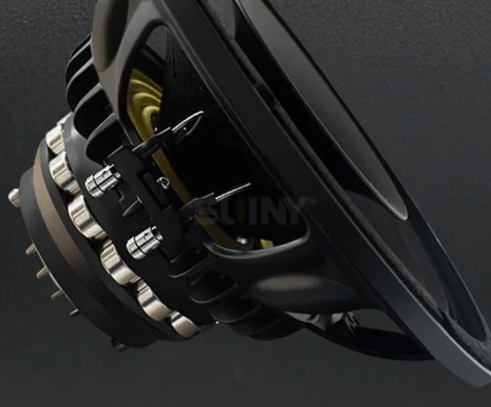

Should be fairly easy to model up a basket like this using off the shelf magnets, spiders and surrounds. Would love to see some community interest in developing a DIY 12" coax like this. Would a 4" dia VC work in a circle of mangets like that? It will make it possible to design a very good chamber and WG for the HF system
