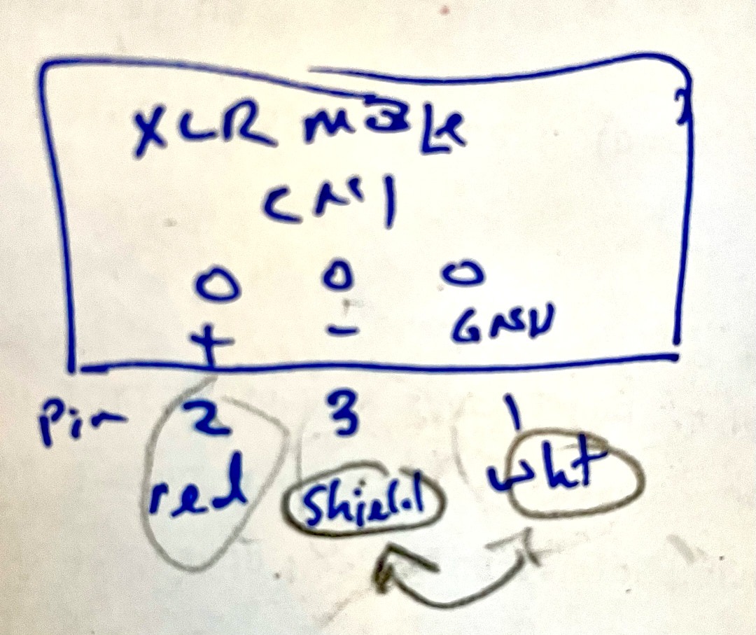

The balanced output connectors (CN1) aren't labeled, so I had to (gasp) squint at the circuit diagram to figure out how they're wired up. (It's V+/V-/Ground, or pin 2/3/1, FWIW).
@mhenschel confirming your observation that my little diagram is wrong -- the signal identiification and pin numbers are correct, but I had indeed switched "shield" and "white".
The corrected summary: V+/V-/Ground -- pin 2/3/1 -- red/white/shield.
Thanks again for catching this, and I'm very glad I didn't connect it to my preamp this way!

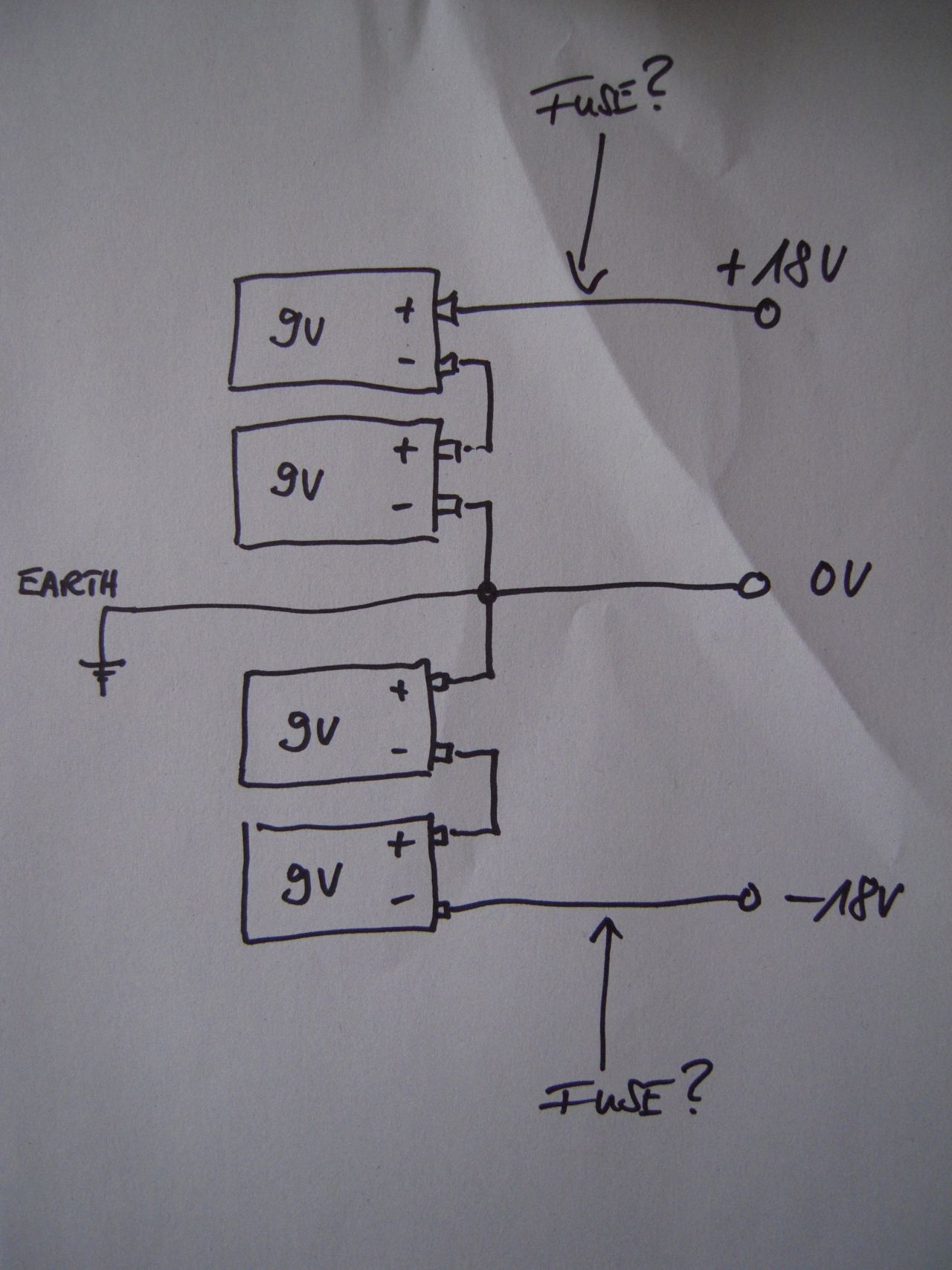

Hello sagittariusx,
sure, you can use batteries to drive the PEARL 3. But you have to arrange them, that you get a symmetrical
voltage out of your batteries (easy).
From your voltage reference (0 V / ground) 2x 9V batteries in series (=+18 V DC) for the positive voltage and 2x9V batteries in series (= -18 v DC) for the negative voltage. The voltage regulators on the PEARL 3 boards do the rest.
I have done this a few times with phono-pres with very good (silent) results...
Cheers
Dirk
It's an easy experiment, try it yourself and listen for differences.

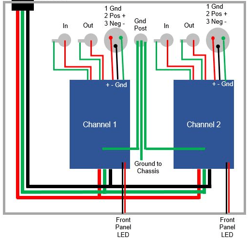

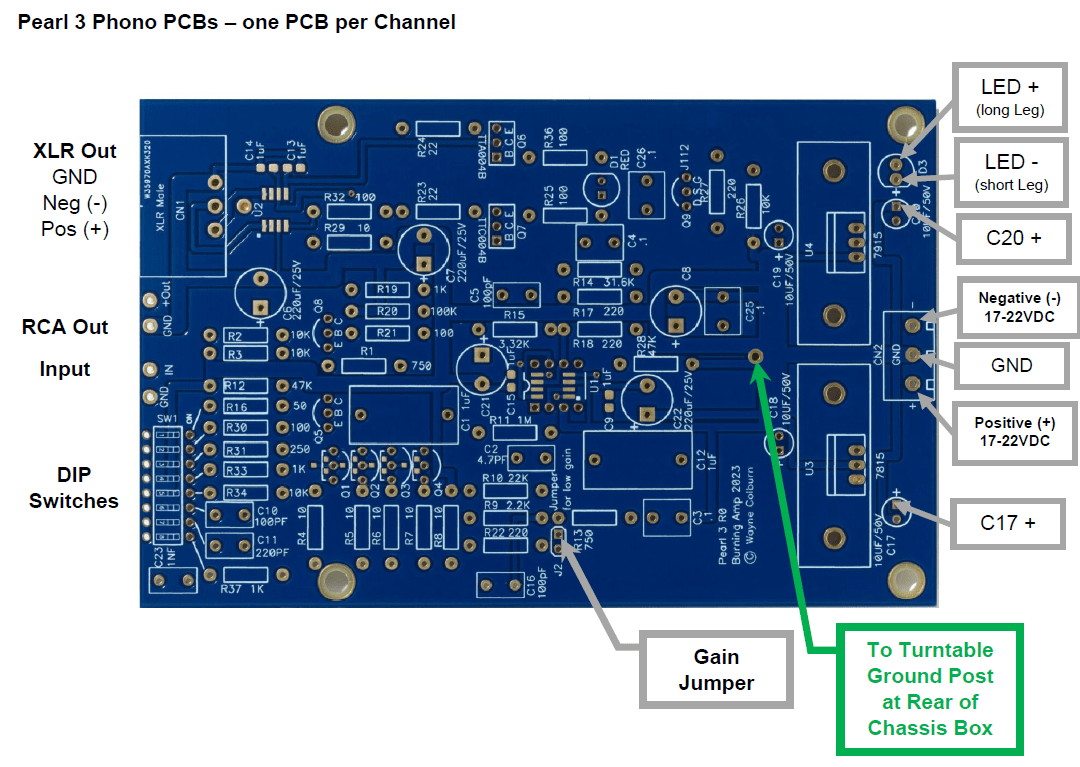

Actually, while you're rewiring... I'm also unconvinced about the correctness of wiring pin 1 to the signal ground on the board... theoretically it should connect to the chassis directly and by a short conductor.
In practice -- according to all reports -- grounding seems to be as much "art" as science. Conventional wisdom is to try different schemes and use the one that works best in your particular situation.
Let us know what works for you
Excellent point. I ended up running shielded twisted pair from the pads to the connector; shield floating at board, but wired to pin 1 & case of connector; and connector pin 1/case wired to rear panel grounding post. I also wired the power connector shield to the rear panel binding post to eliminate mains hum.
As an aside, I was relieved to confirm that that the differential line driver chips survived being shorted to signal ground for a couple of hours.
