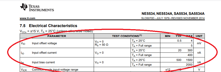

In the same situation NE5534A would give equiv of 12.5nV/√Hz at 10kHz, 18dB less hiss... It has a true 0.4pA/√Hz current noise spec.
Basically for MM use either NE5534A (or other genuinely low current noise bipolar opamp) or a FET input opamp.

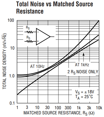

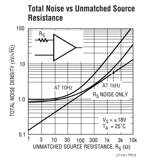

This is the more realistic graph, as in reality you never have the exact same impedance driving the positive and negative inputs.
Regarding the "RS noise only" line, keep in mind that for a given impedance, a largely inductive source that only generates thermal noise would produce less noise than a resistor. This applies to a cartridge not playing any record. Then again, it would be higher for a cartridge playing a dusty record.
Anyway, the conclusion remains that it is pretty good for MC, but not for MM.
Shockingly high for MM input in fact, giving the equivalent of >100nV/√Hz at 10kHz for a 500mH cartridge, making a complete mockery of its 0.9nV/√Hz voltage noise spec. LT1115 is for MC only, not MM!!
Note the current noise for the LT1115 is quoted lower than 3.4pA, but that's because the datasheet value assumes symmetrical input impedances and the chip has bias-current cancellation circuitry, often the bain of the low noise designer. If you ever seen bias current for a bipolar-input opamp quoted as +/- some value, this means cancellation circuitry and the current noise will be much worse than advertized in practice in a single-ended preamp.

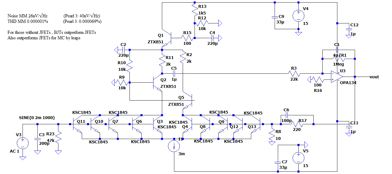

Don't quite see the similarities with the Pearl designs by Wayne or why use the Pearl-name in the first place.
As far as I know, all Pearl designs are two stage, yours is three. The Pearl-3 run U1A at high gain and has feedback to R4-R1 junction.

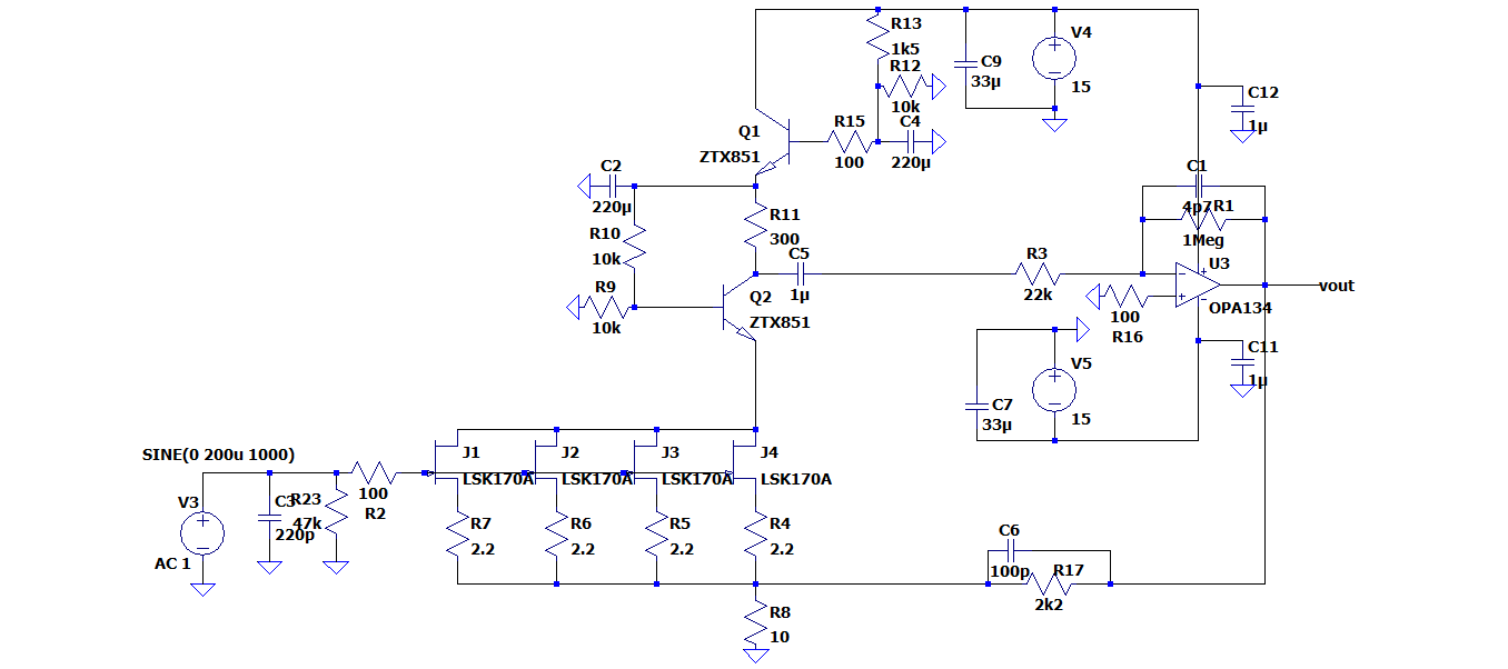

Your design with two cascaded linear amp (JFET without NFB and the first op-amp) would have a rather high gain. Have you verified that you actually have the required headroom for MM signals?
What are your design improvements over the Pearl 1, 2 and/or 3 designs in the first place and why do you have R4 there if you have no feedback to this junction?
Also your choice of input JFETs would have a rather high input capacitance for a MM stage (since the input stage is running without feedback). I would look towards the LSK489 in this case.
@MarcelvdG: The input stage is is a cascoded JFET without feedback, the op-amp is the second linear gain stage. Why would opamp-input current noise and cartridge impedance matter much towards noise contribution in this case? would that not be defined by the JFET input stage? Not that I know how to calculate voltage or current noise for this stage in the first case....
The second gain stage is the inverting op-amp, It would be feed by the cascode output independence amp series resistor of 499 ohm (vs Wayne's design where this is actually a 22K ohm resistor in the middle of the feedback loop)

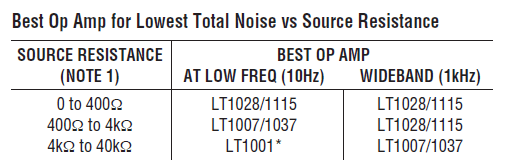

As you point out Marcel, that circuit from the Linear Tech appnote has high current noise. In my opinion it should best be used with MC or possibly HOMC pickups.
Although no mention is made of pickup impedance / inductance in the appnote, there is a section called "application information" that explains current vs voltage noise rather well. By the way, this section has been updated in the LT1028 datasheet, including a section on paralleling of amps to reduce voltage noise.
For a typical MM pickup like Ortofon 2M series the appnote recommendation would be LT1037, although I'm still not convicted for RIAA duties due to the input current cancelation network used.
For universal MM my choice of LT family op-amps would be the LT1113 that sports JFET input for negligible current noise and voltage noise only 1dB above the now obsolete NR5534.
