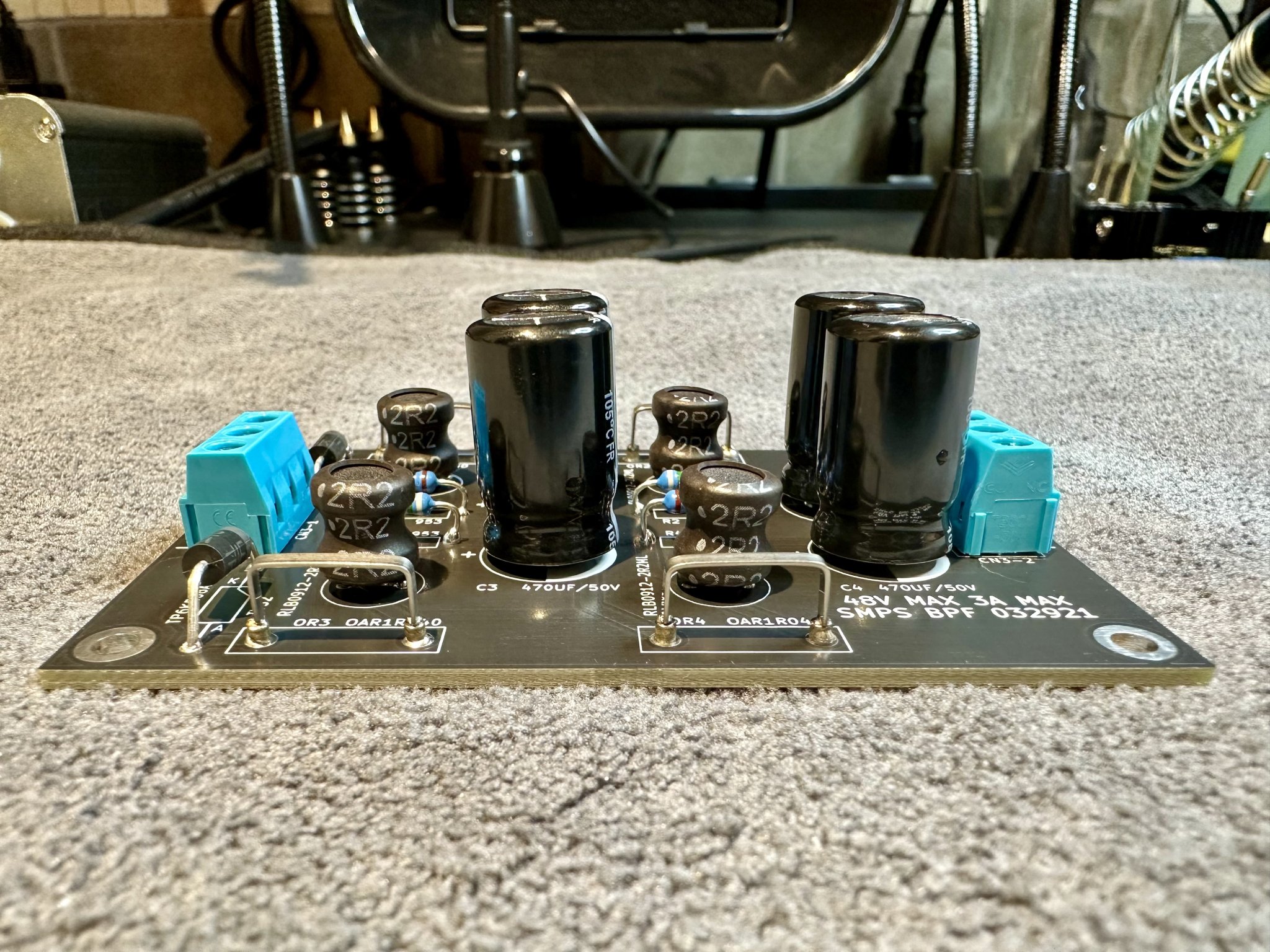

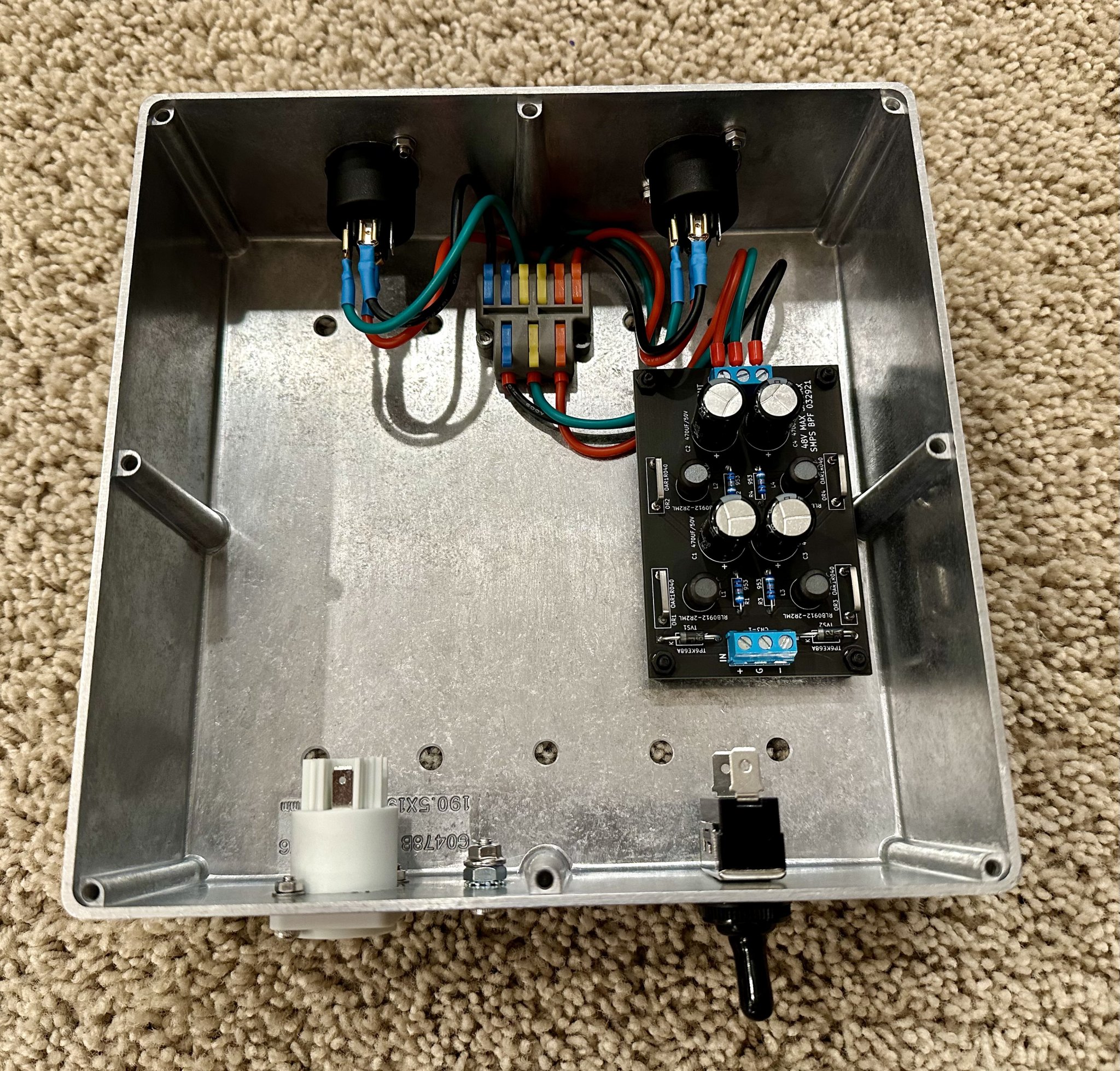

Here's a bipolar PCB layout. Boards are still on their way to me, so I have not verified the layout with actual parts yet. Caps are Panasonic EEU-FR1H471B
EEU-FR1H471B Panasonic | Mouser
There is room to lay them down to save 7.5mm in height if desired.
Boards are 57mm X 86mm. You can get a 5 pc. order for under $9 delivered, if you are willing to wait 2 - 3 weeks for standard freight. Double that price if you want them in just a few days.

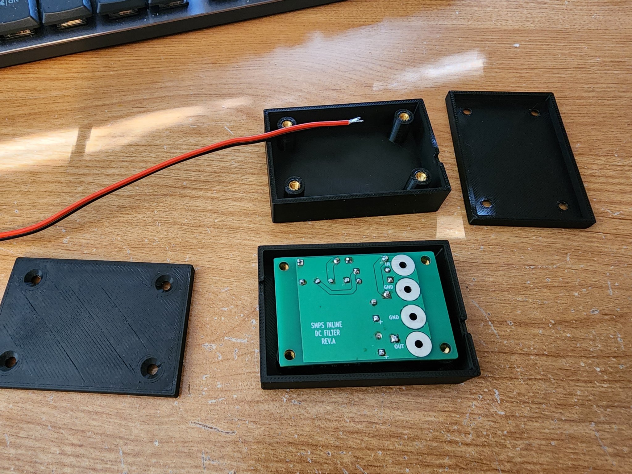

I put together this today:
Thanks to @Mark Johnson and you for your service to the community!

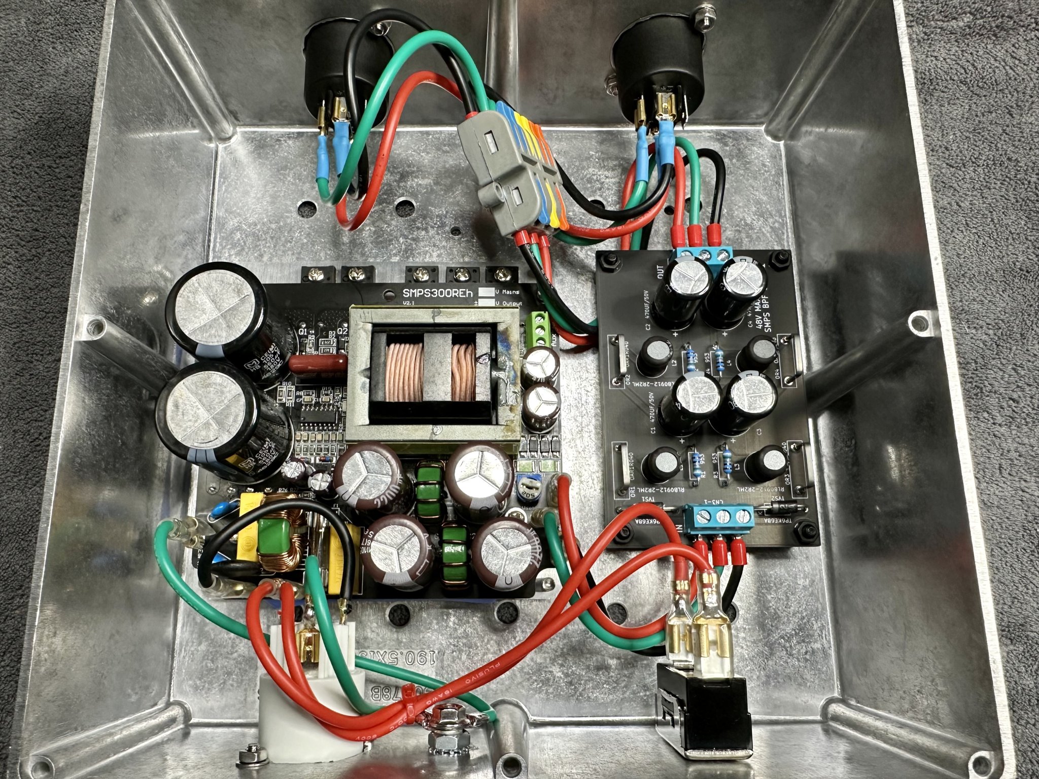

I am going to use it with a Connex SMPS300REh +/-30V SMPS.
It’ll be the first time I use a SMPS for audio.

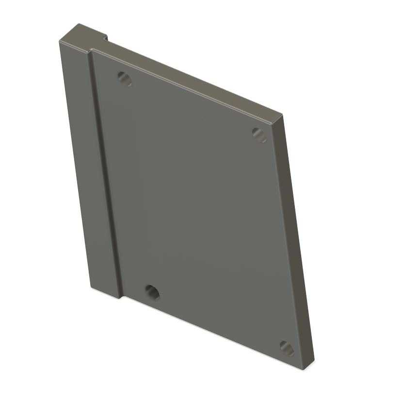

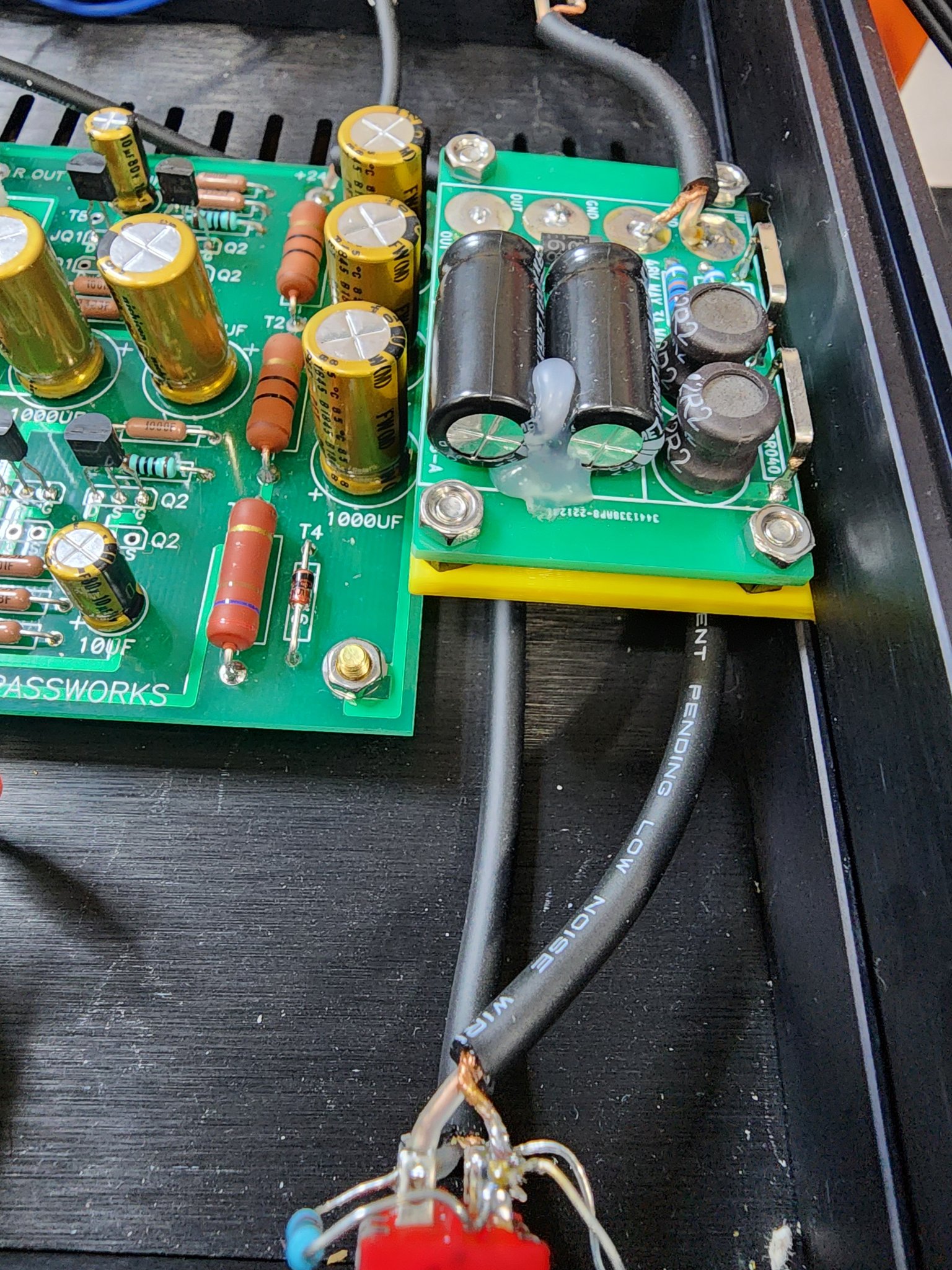

This is a zip file test to see if I can upload a 3D print file (*.3mf) for mounting the SMPS filter into a Modushop chassis. This is only a test (however, if it works, then great). Free for anyone to use and share. The picture shows the SMPS mounted in a Korg B1 chassis from the store. It simply slides down the middle slot and is held in place friction tight.
  • Korg Chassis SMPS Filter Mount v6.zip
