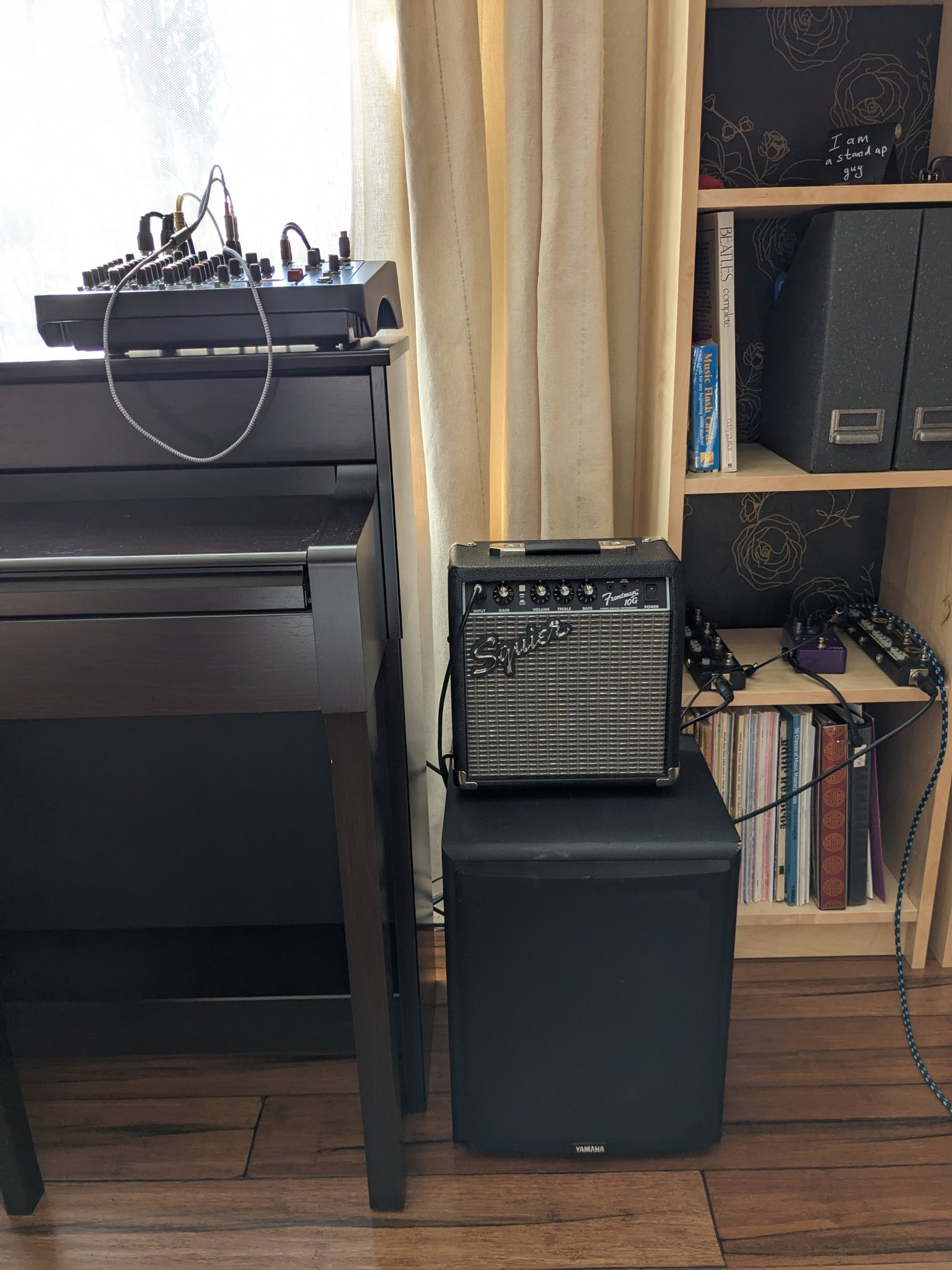

This is the current "speaker", in case anyone is curious. :)

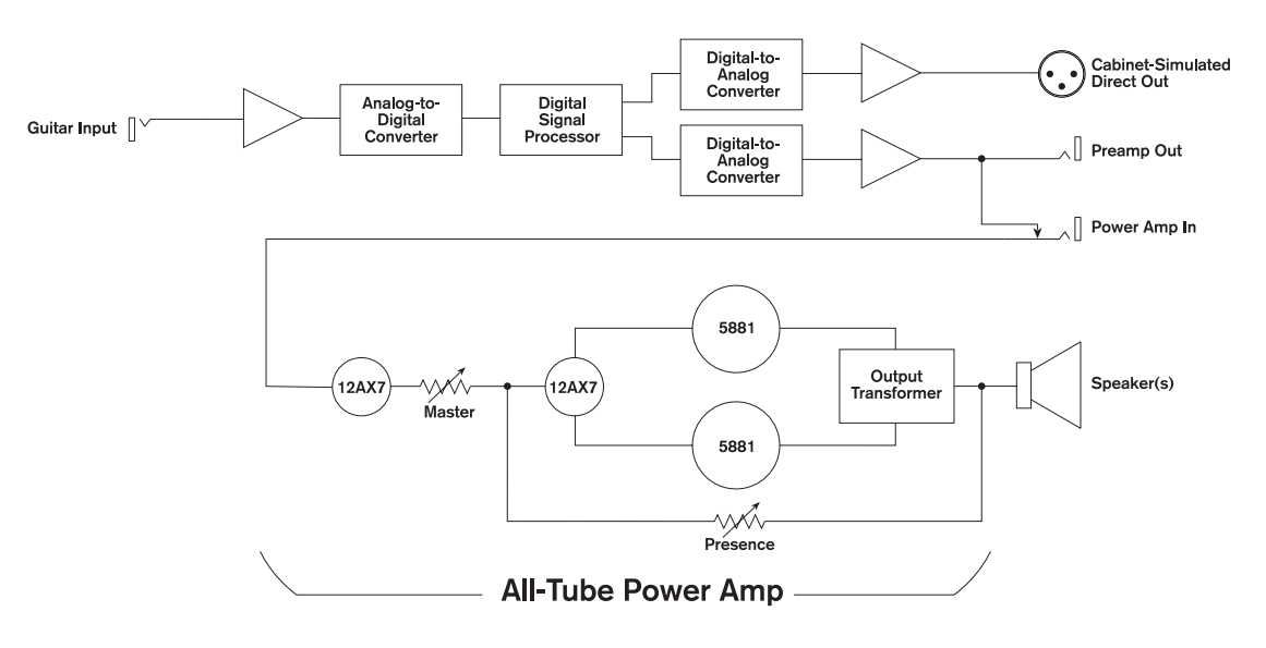

Bear with me for a moment. I AM actually on the same page with your question.
Consider a Line 6 Spider Valve 112 combo. Line 6 gets a bad rap, and so they sell for your price range. (Here's one for $250.)
Line 6 has come a long way from their beginnings.
But here's the cool thing about this amp. Use the "Power Amp" in jack, and you have an all tube, 40-watt Bogner amp, complete with a bonafide Celestion G12-Vintage 30 speaker. It's a Bogner "Power Engine." (With apologies to Tech21 for borrowing their trademark.)
I use mine almost exclusively with either a Seymour Duncan Palladium, or all-tube Twin Tube Classic, or a BBE AcoustiMax preamp. I rarely use the Line 6 modeling preamp. Although, there's nothing really wrong with that.
Just a thought.
