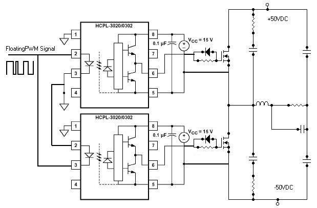

Project : Practical Class-D PWM Subwoofer Amplifiers with optocoupled Gate Drivers

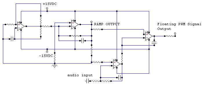

schematic of ramp and comparator

You mean propagation delay in the opto devices?
As long as the delay is the same for both devices and for rising and falling signals I don´t see any problem. It will just result in a total delay, but not affect the signal.
You just cannot add any NFB as it would be out of time.
You may of course apply feedback as long as the delay is distinctively lower than the clock period.
Feedback is mainly affected by the switching frequency. The unity gain point shouldn't be higher than half the switching frequency.
