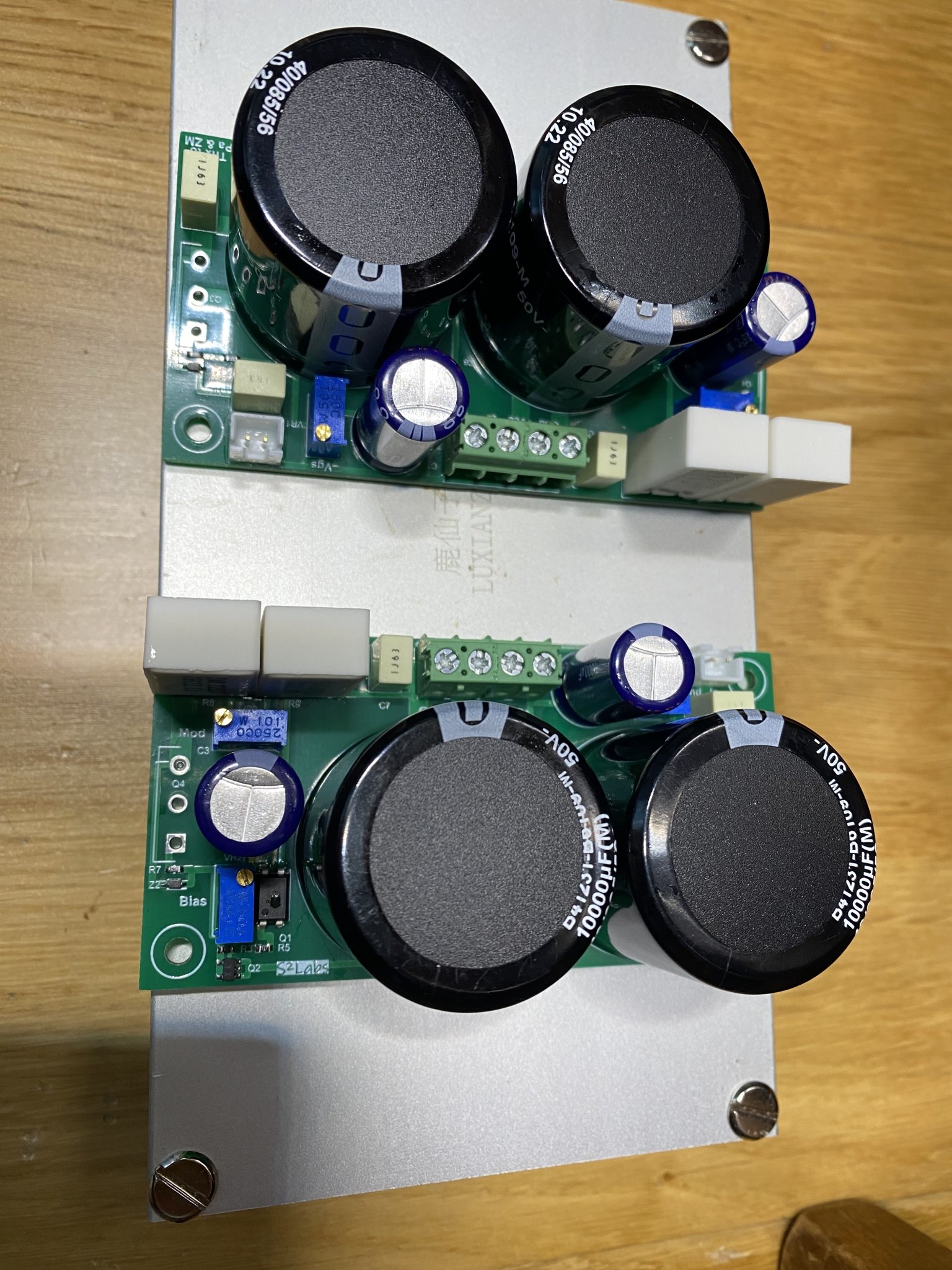

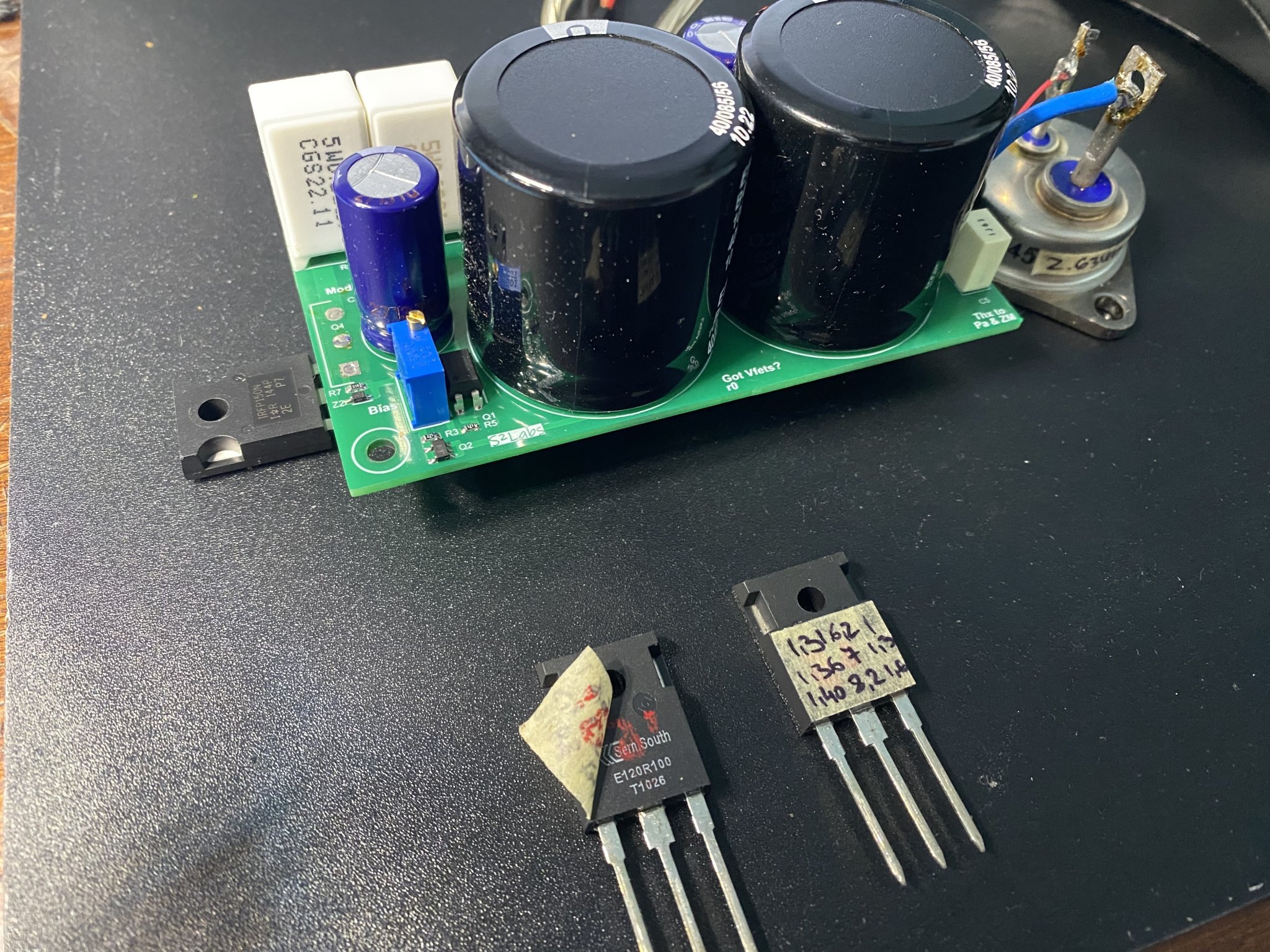

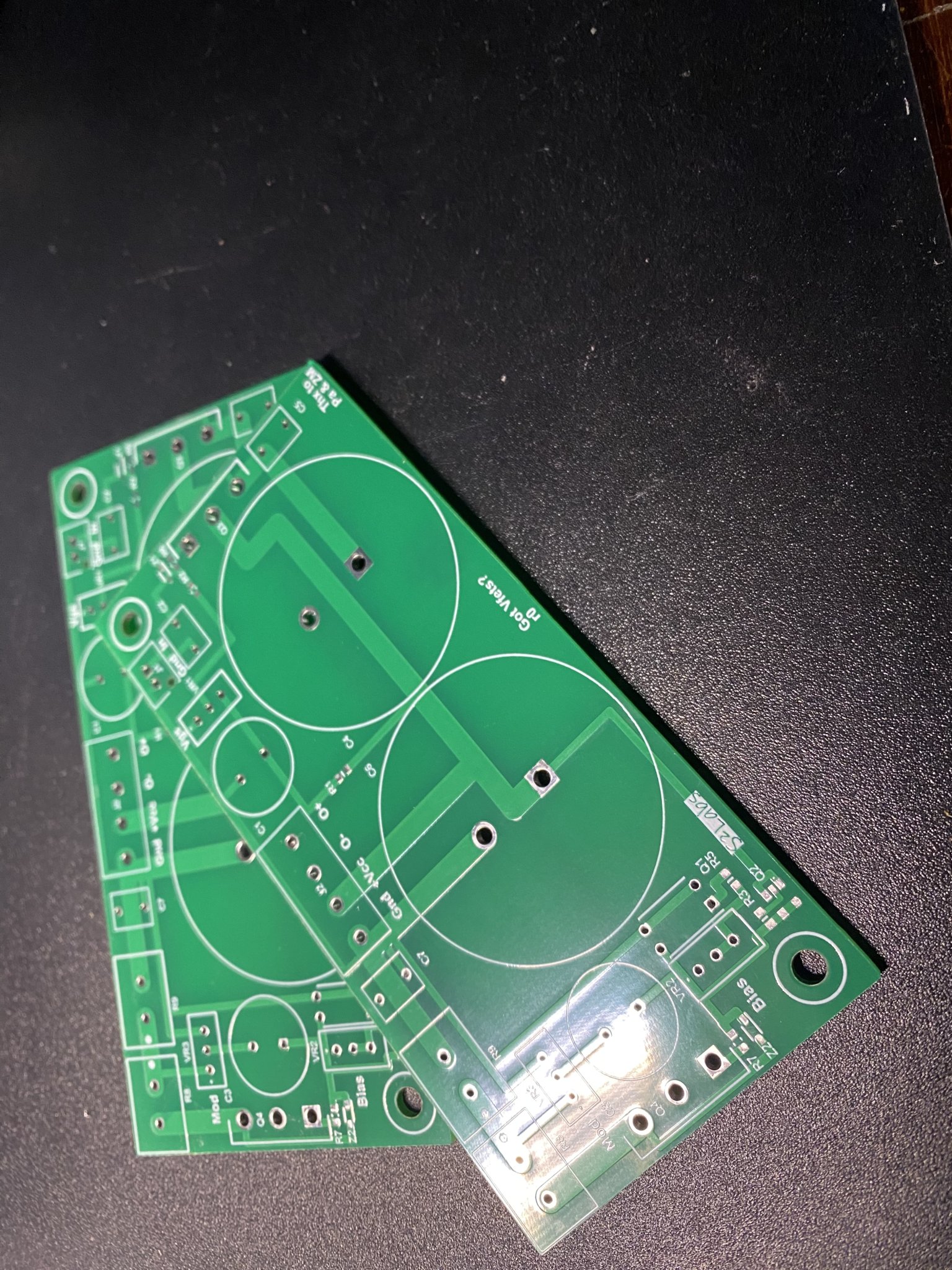

After a long time that I stashed some 2sk182es sits I decided to use them. So the last year I did a small prototype pcb following Pa`s Got Vfets? schematic and it looked like this
The sound was nice so I decided to draw a pcb.

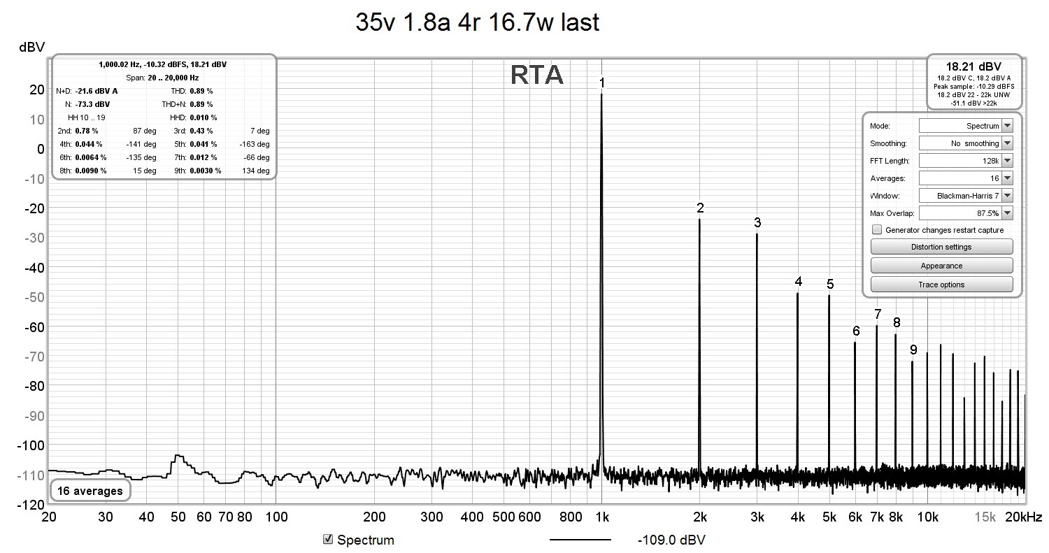

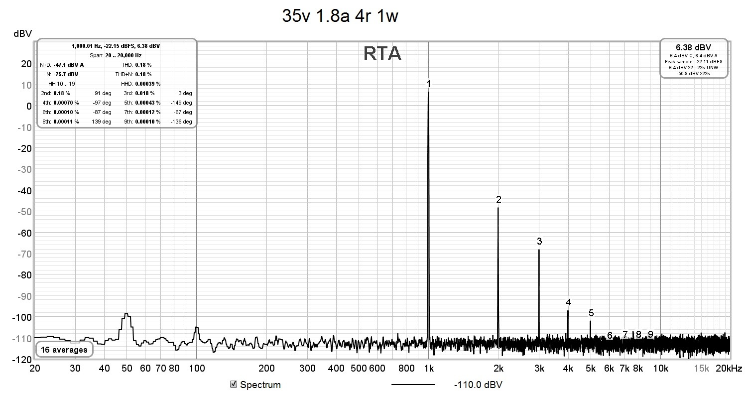

The Sit sounds nice and measures nice too

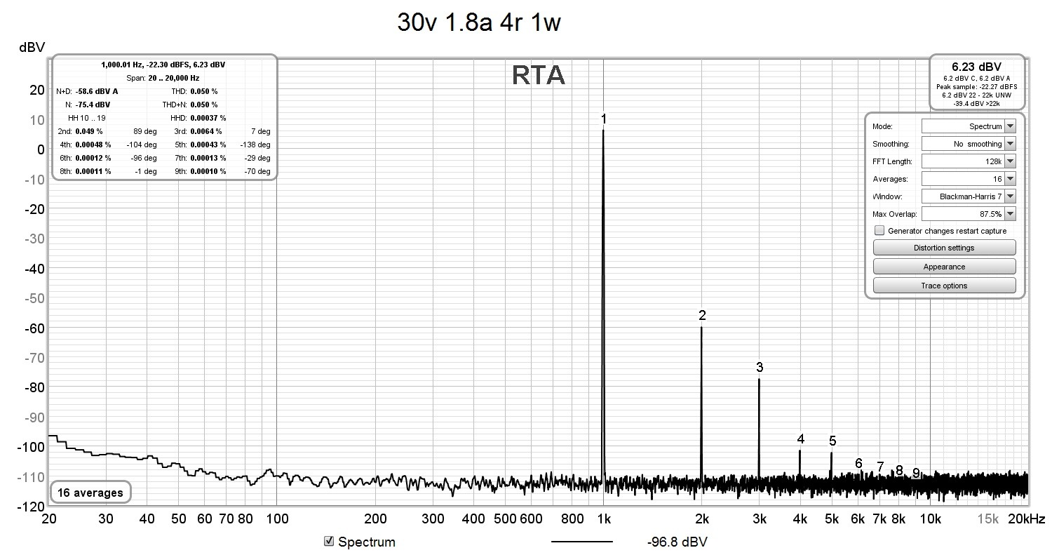

So after a while of playing with the Sit I replaced it with a power jfet(Sjep120r100) and the irfp150 mosfet in the ccs was replaced by 2sk3497.
The sound was very similar but I liked it a bit more. It is measuring a bit better too.

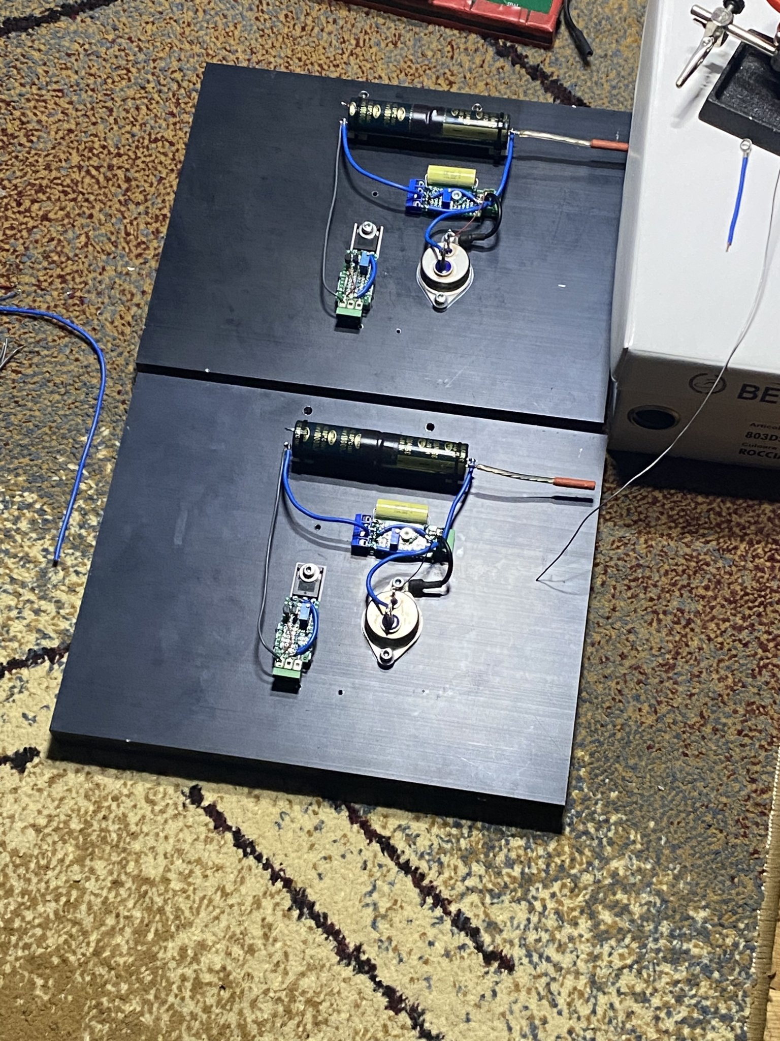

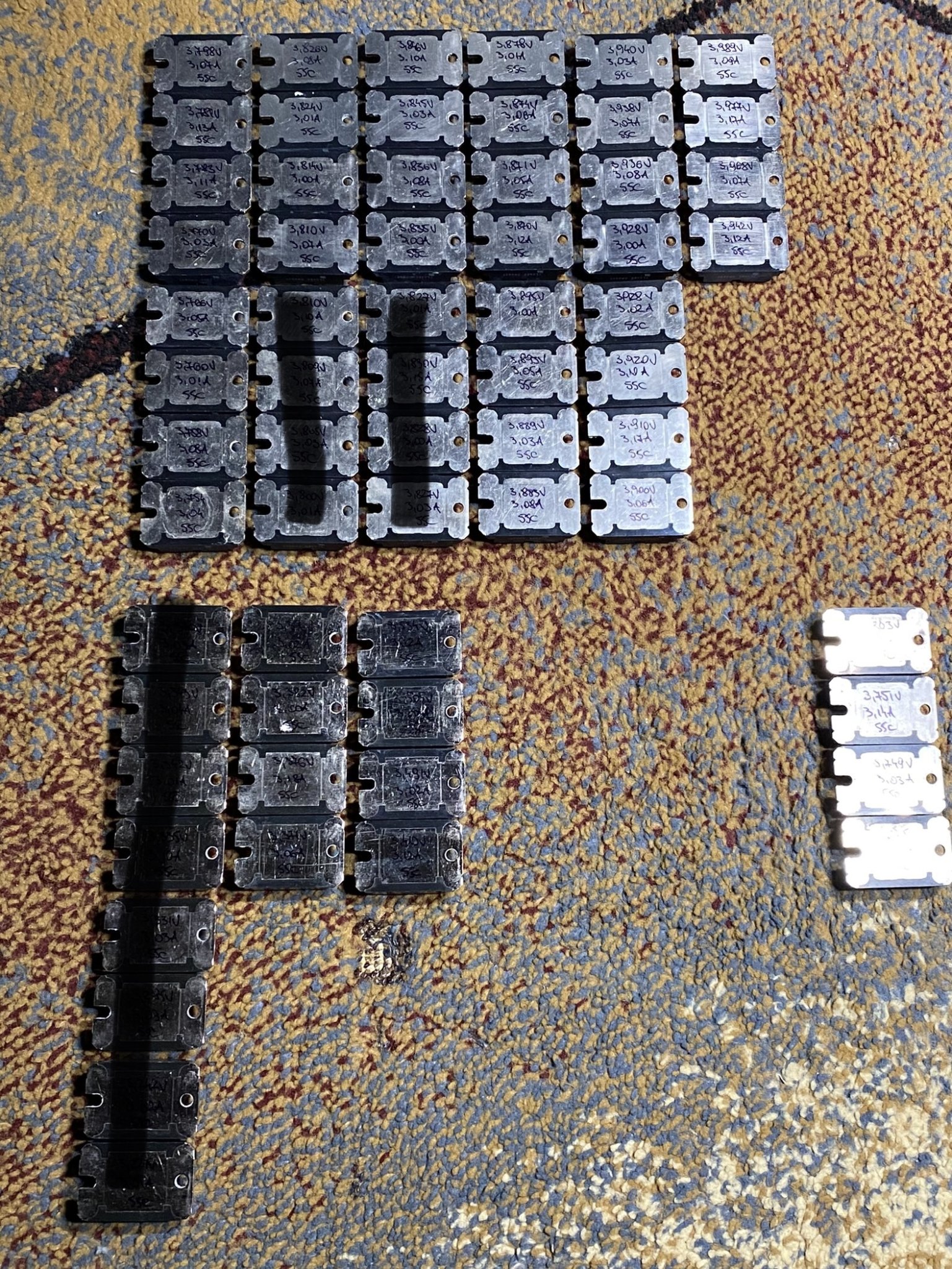

And the jfet/mos combo played music for quite a while. At the end of the last year I found some puck mosfets that I had unused from another project and wanted to try them.
So I checked all of them for vgs @3A and heated to 55C.

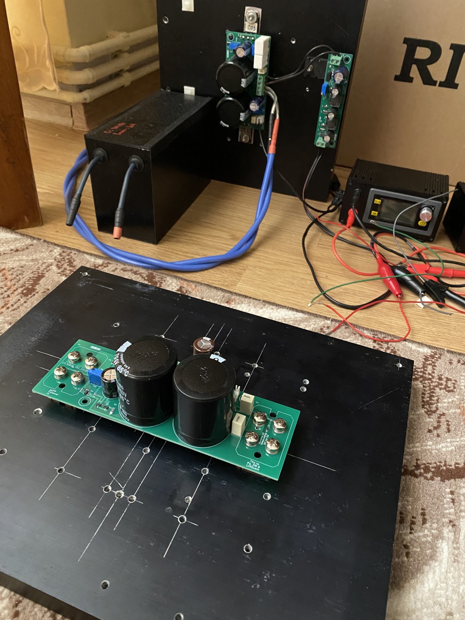

Initially I replaced the power jfet on one pcb with a puck mosfet and did some measurements. It was nothing spectacular but I decided to draw a new pcb to use them. So I drew the pcb but unfortunately didn`t have the funds until now to proceed with the components order.

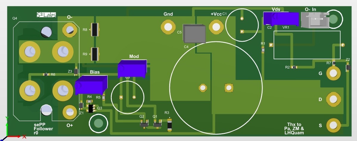

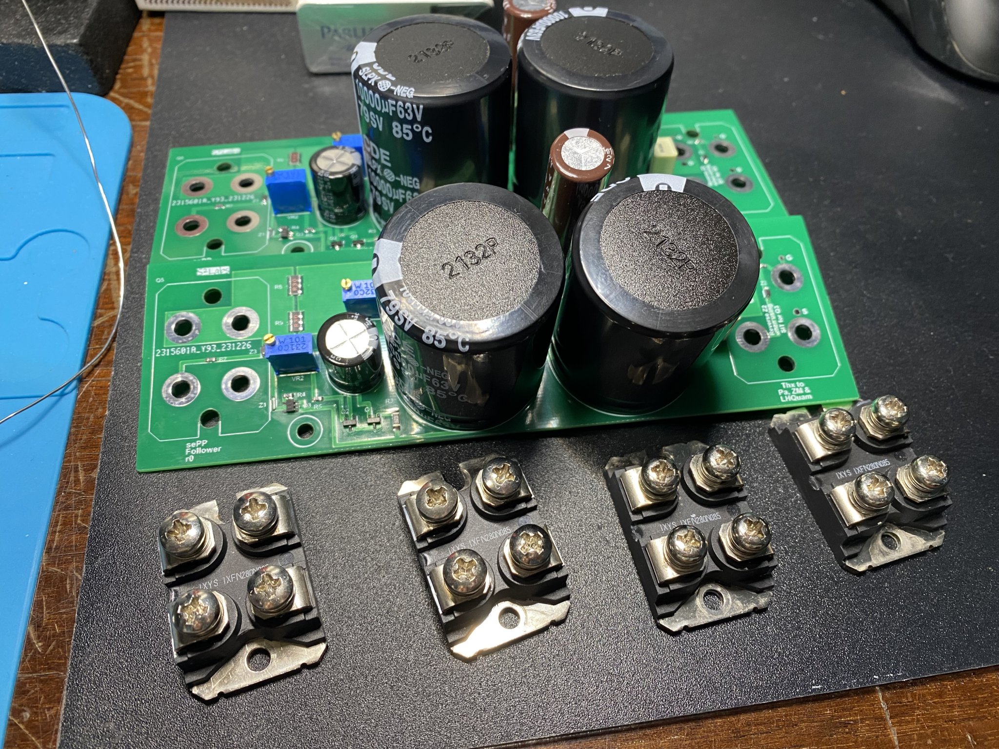

So now that the sun went up and the components jumped from all over the places :) it was the time to build the puck version.
This version doesn`t use Pa`s optocoupler to regulate the bias instead it uses lhquam idea of using a bjt comparator.

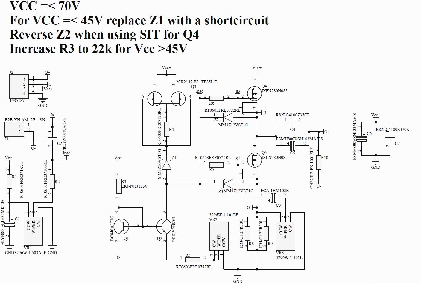

So here is what I come up with:

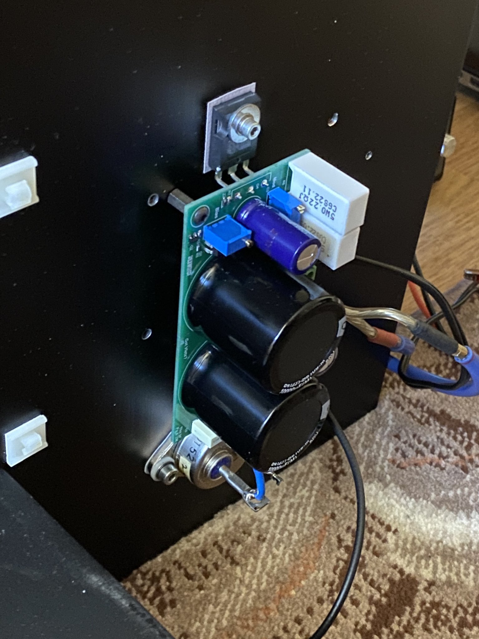

All good until here and even better from now on.

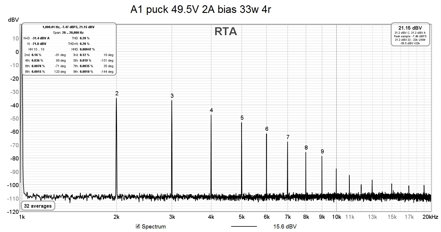

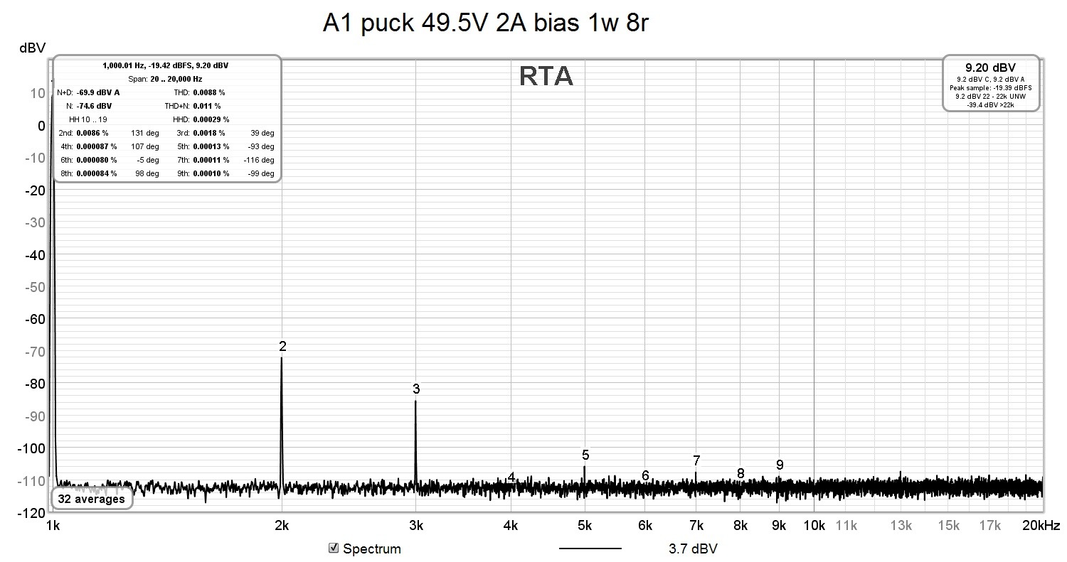

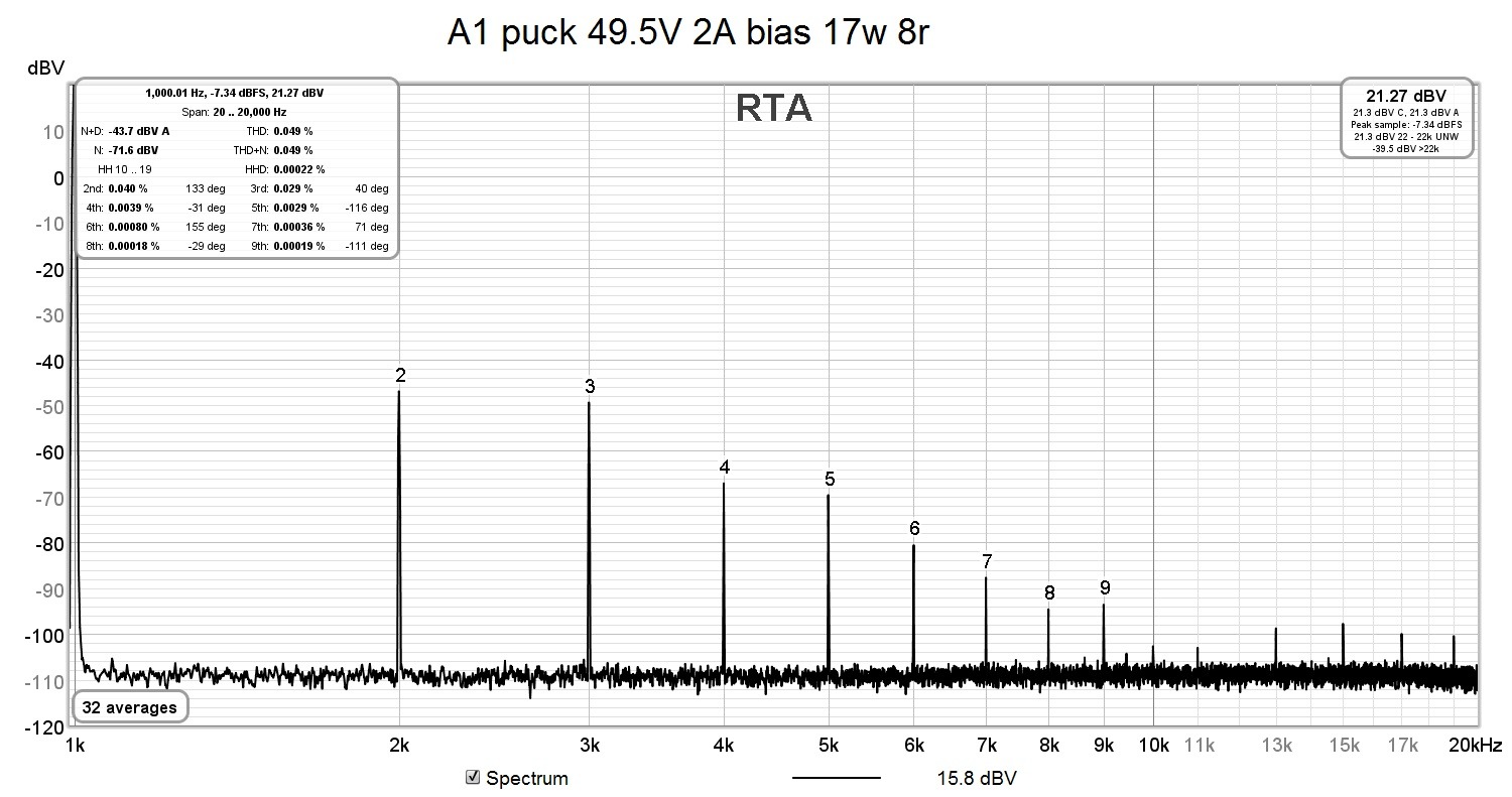

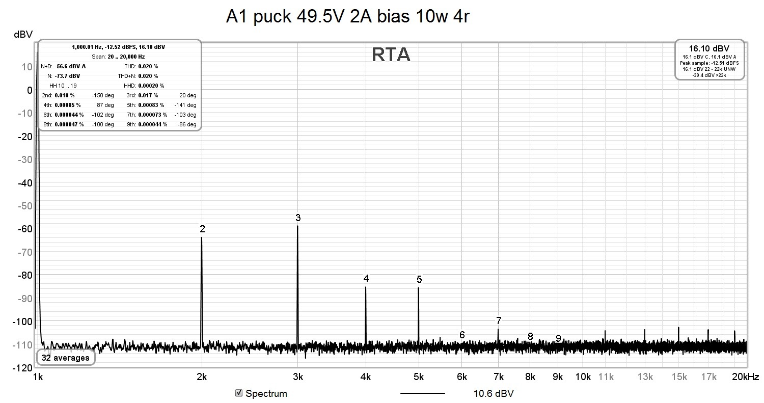

I had the pleasant surprise to find out that these pucks are doing better than the sjep120r100 and 2sk3497 combo. Beside that these(sjep120r100 and 2sk3497) are very hard to source and are very expensive too.

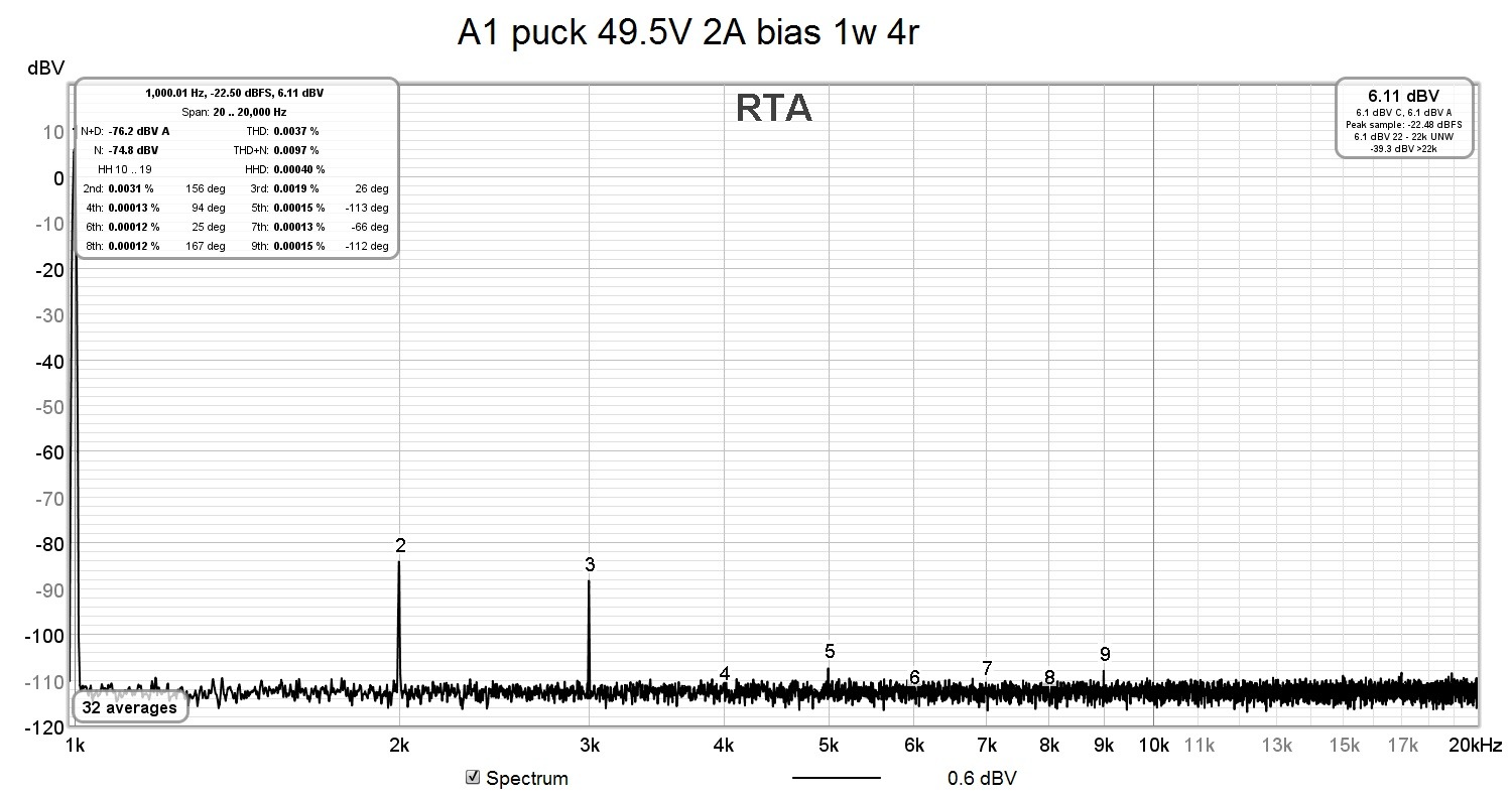

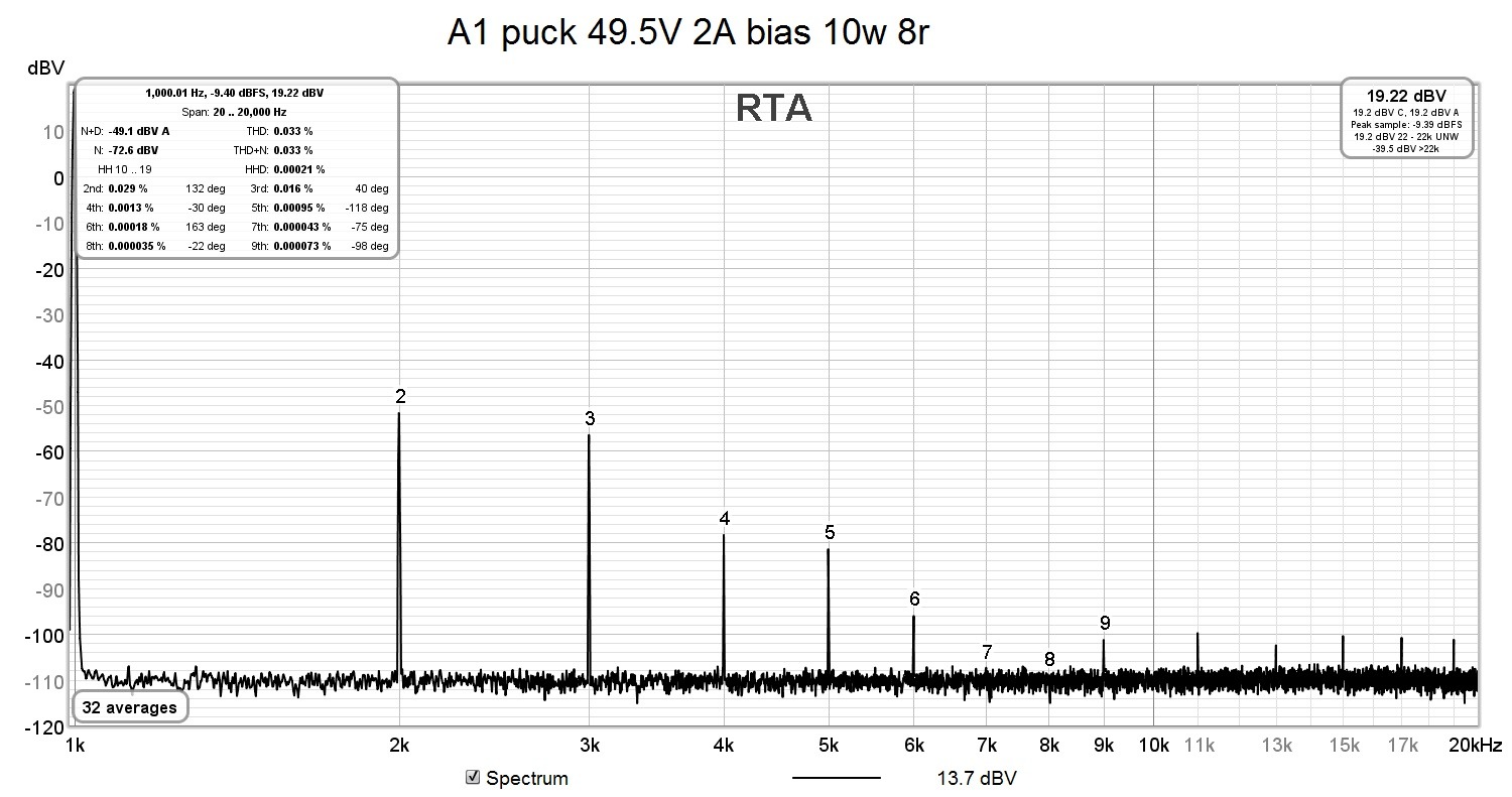

Here some measurements
I call it sePP because there is an onboard trimmer that lets you adjust how you want the amp to work, se or pp.
If there is somebody interested about this I still have some pucks to sell together with the pcbs.
The actual pcb can be used with sits too, I will test this someday...when time comes.
I drew also a smaller pcb that doesn`t host the upper mosfet and the output coupling cap being specially designed(for a friend) to be used with sits. Unfortunately I didn`t order this one and I am not sure I will ever order it.

It is definitely good to see the schematic. It answers a few important questions.

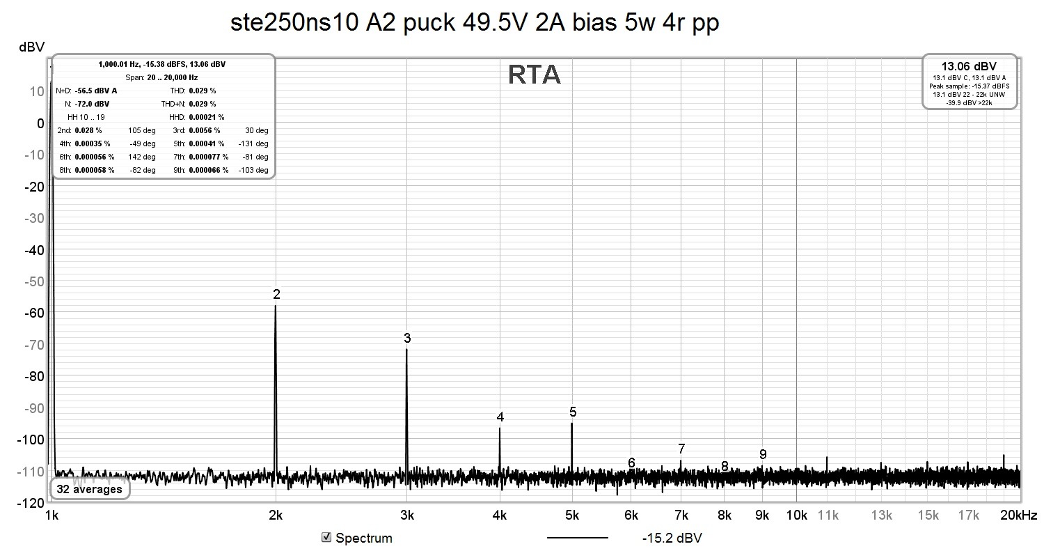

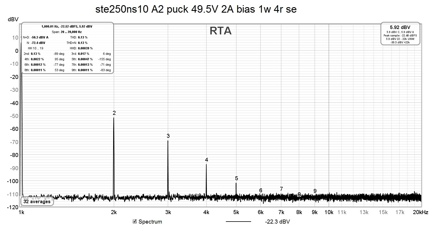

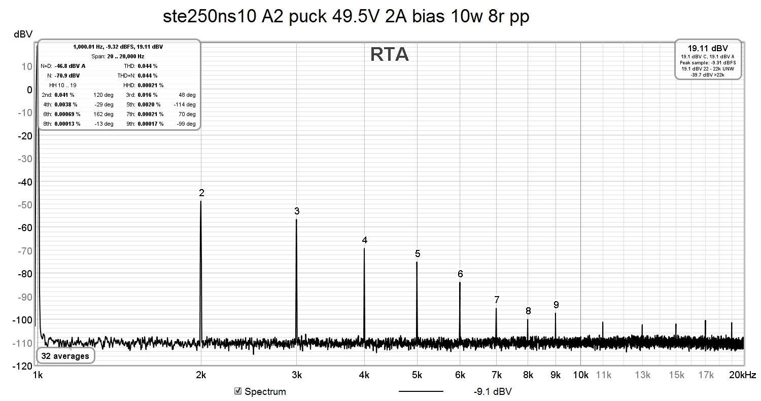

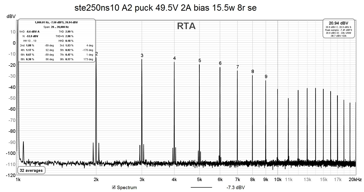

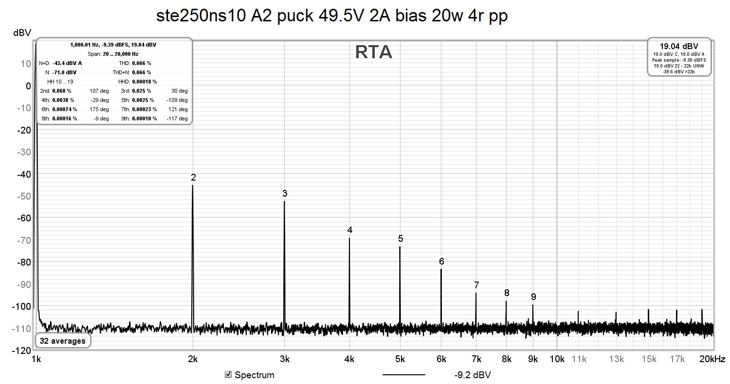

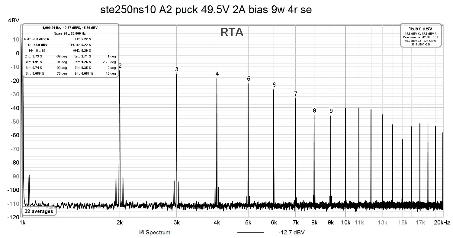

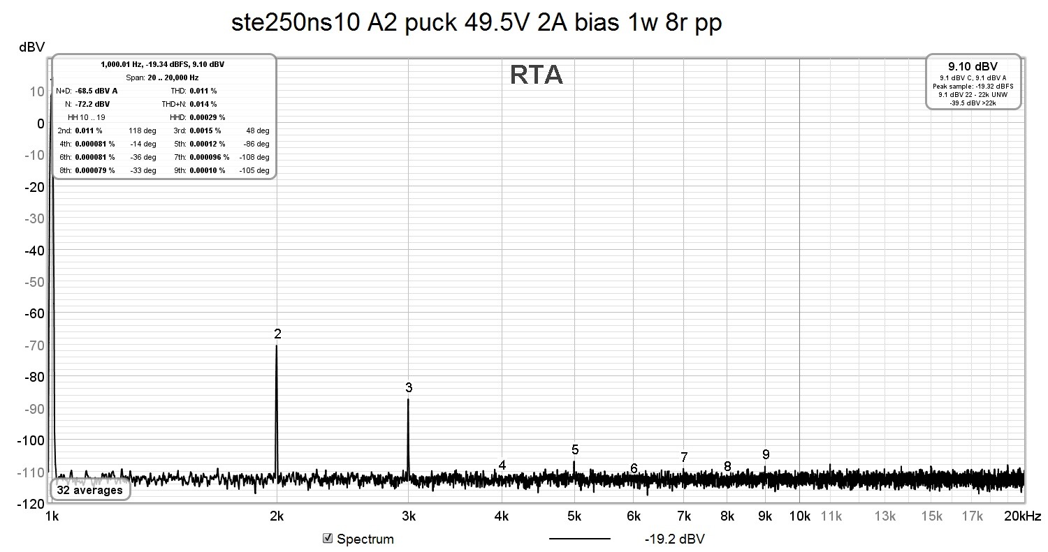

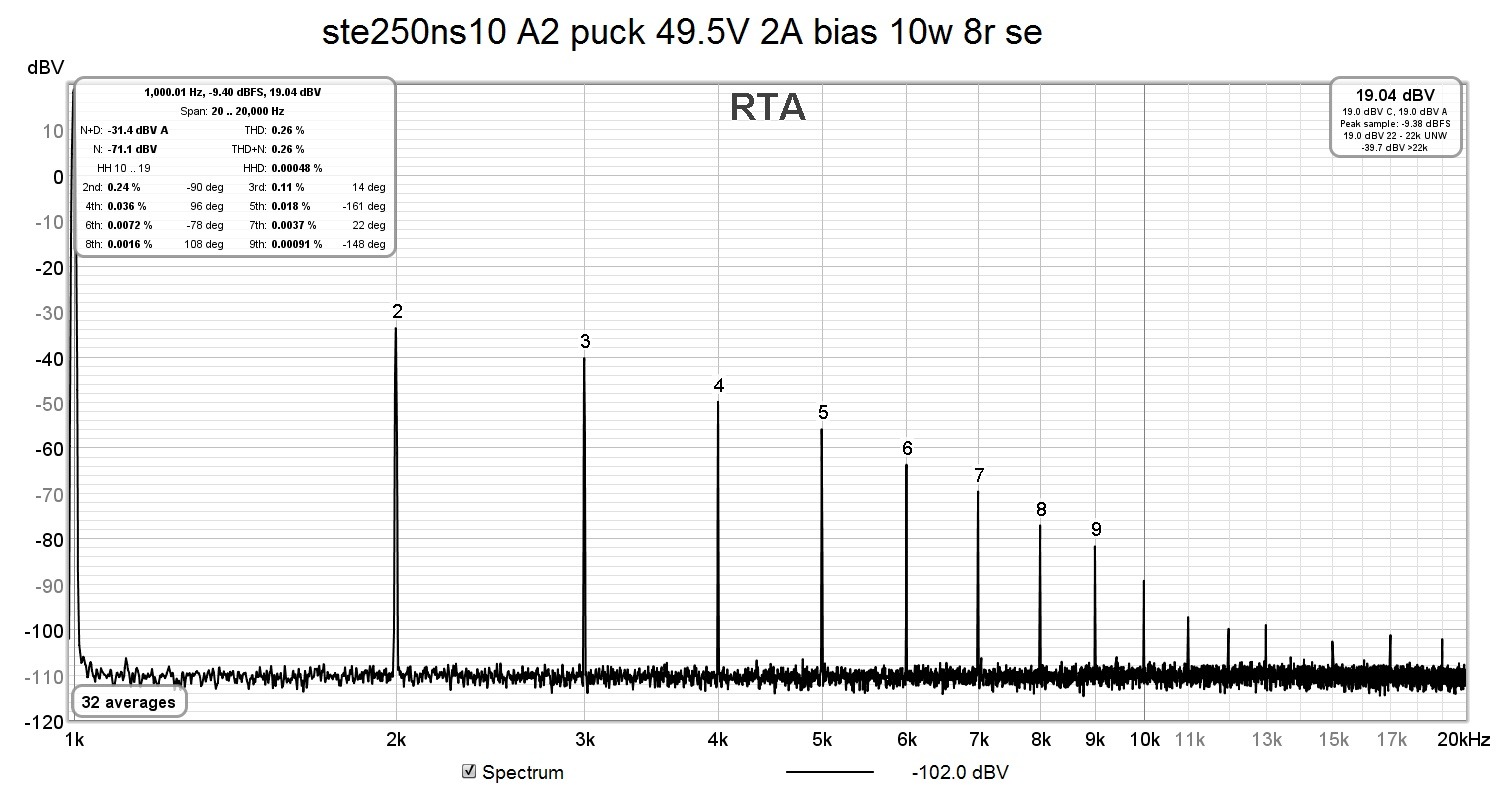

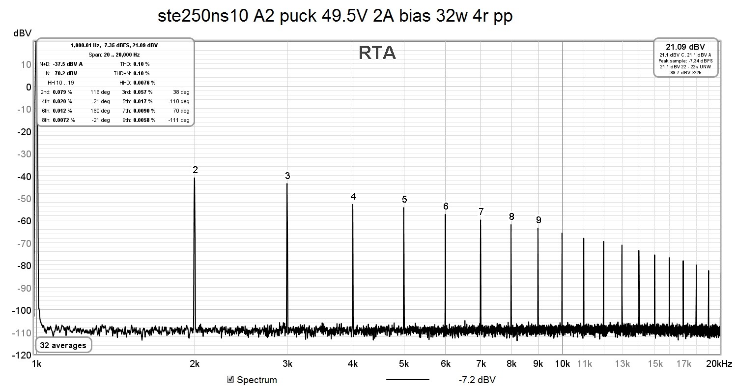

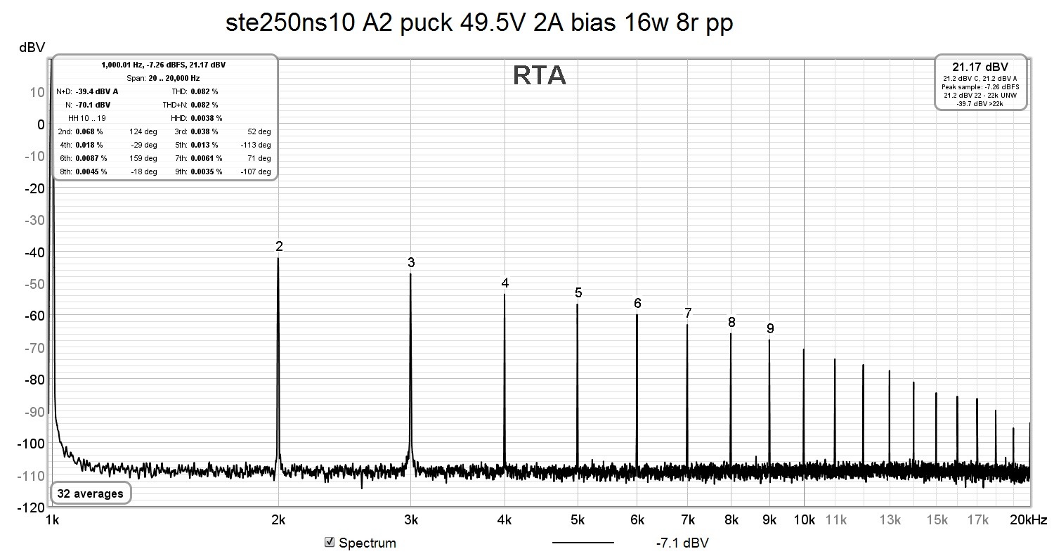

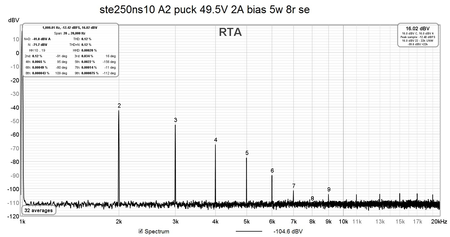

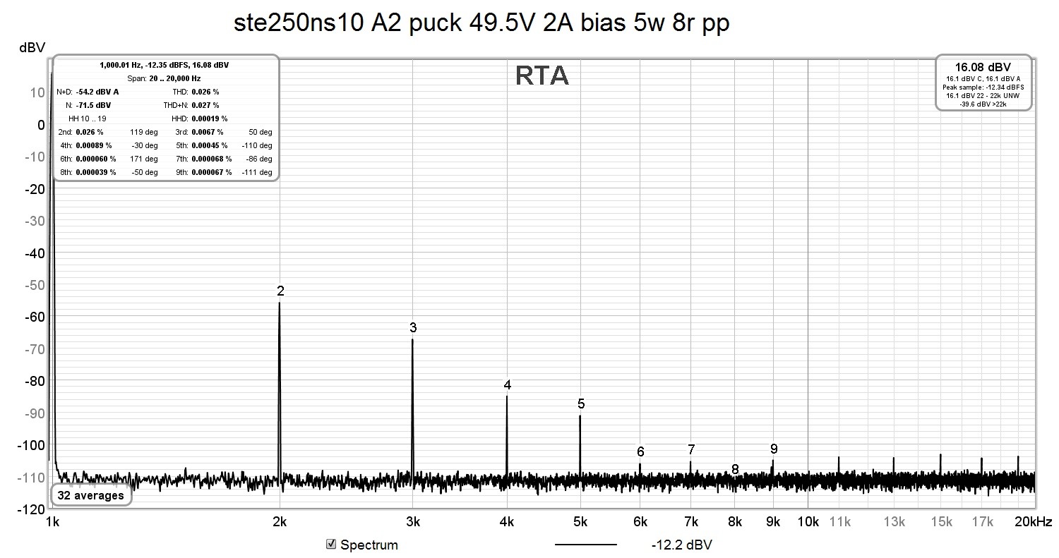

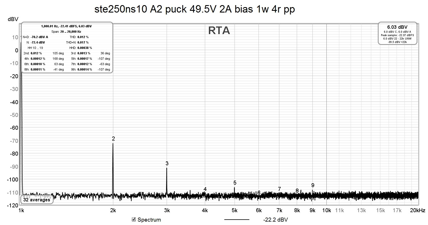

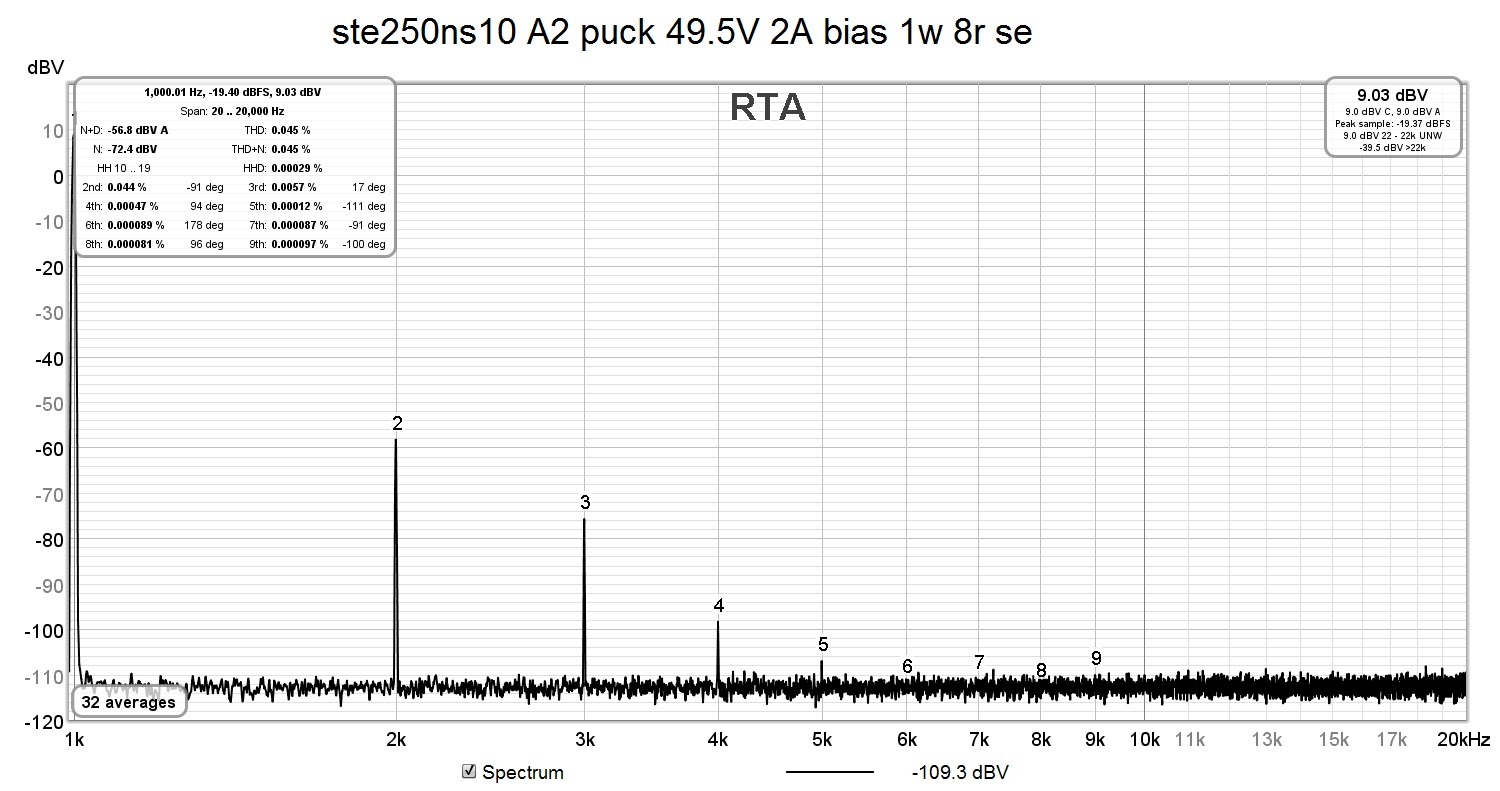

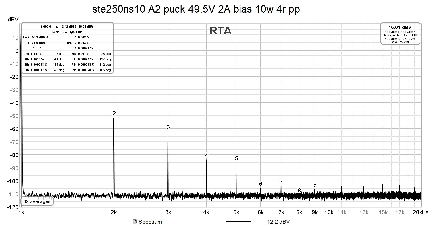

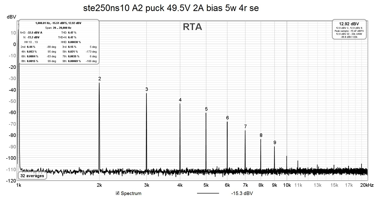

Yesterday I replaced the IXFN280N085 mosfets with STE250NS10.
With the last one I get a bit more 2nd hd and less 3rd hd this because of the higher capacitance and higher transconductance.
At low power the thd is a bit worse if you want to look at it that way but at higher power levels it looks better when driving 4ohm loads. Into 8ohm it performs a bit worse.
When using 8r loads the modulation doesn`t change things very much as it does for 4r.
So depending on your speakers impedance and also on what you like you can set it as a single ended or as a push pull. When set as single ended it gives a bit worse performance but it gives negative 2nd.
The graphs that end with pp mean that the amp was set as push pull and the graphs that end with se mean that the amp was set as single ended.
The tests that I had published for the earlier versions of this amp had it configured as push pull.
As for the sound...it sound nice configured as se as well as pp though I don`t know why but I seem to like it more configured as se. As pp the soundstage seems more focused and as se seems wider.

I have simulated the circuit and I noticed the same behavior. It`s due to R3 being too big. If I power on with 50V, I get 10% increase in the bias.
If I power on with 19V I get close to 2x the bias.
If I start my power supplies setup for 50V they go into cc protection. So I have to start them at 20V and then ramp up the voltage.
Now I got it from where the 2x bias.
