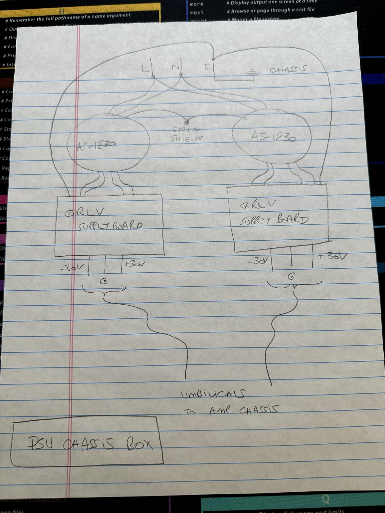

The supply is in fact 2 X GRLV supplies with each its own transformer.
This weekend, I connected the ground of each supply board to PE in order to get rid of a bit of hum. It did that, but maybe I opened the door to that instability, as now both boards share a common ground via PE.

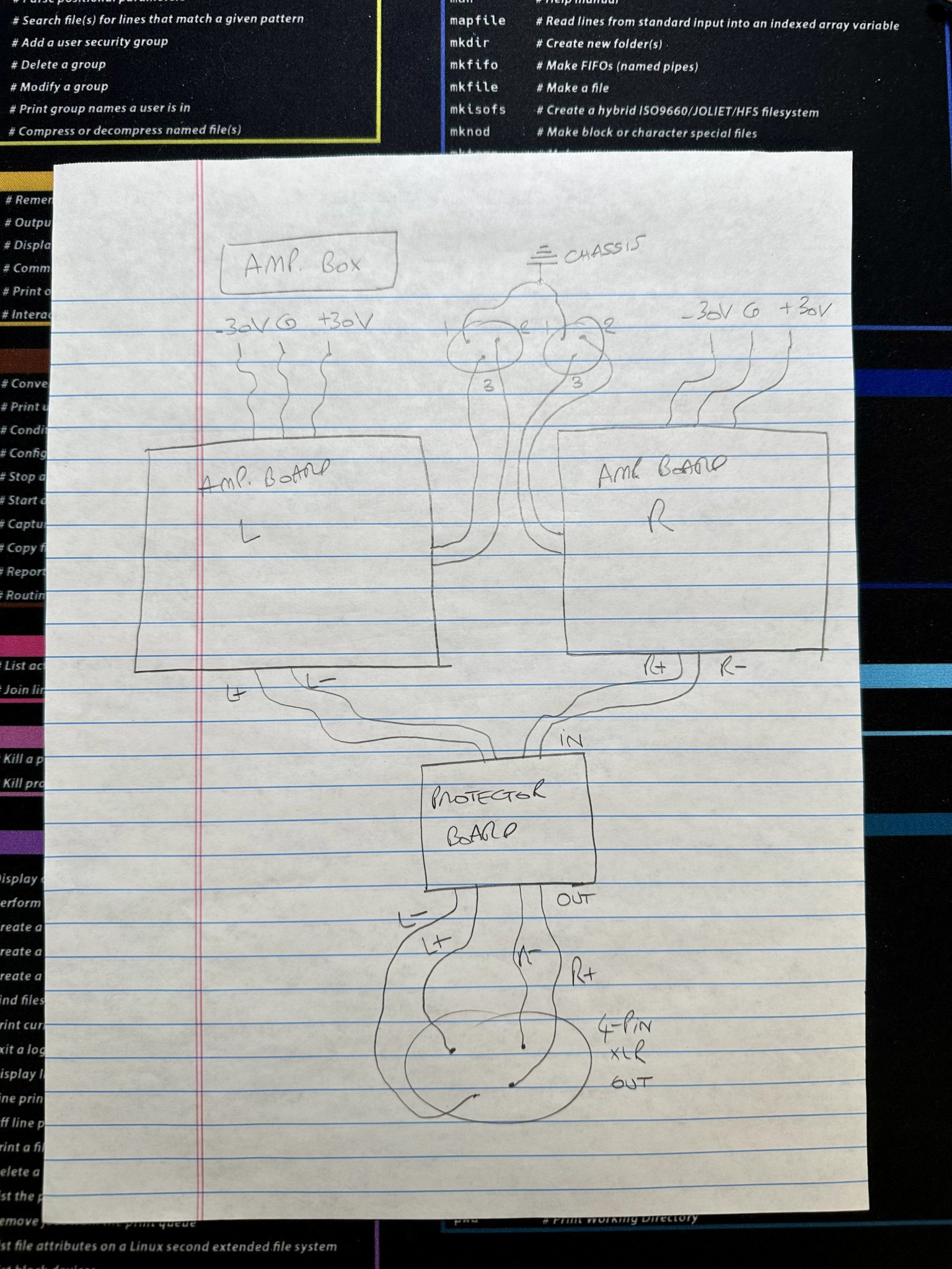

Since, it's not OK, I might as well revisit my grounding scheme for this build.
Here are 2 amazing pictures I made with my own hands. (I am the Picasso of wiring diagrams, am I not?
It's not quite as ordinary as some people will want.
So, I need to explain some things.
1) It's a 2-chassis set-up.
2) At the DAC, pin 1 of the 3-pin XLRs connects to earth, and I connect pin 1 to the chassis of the amp box at inlet. So, both PSU and amp chassis are earthed at a common point via the power strip both the PSU and the DAC are connected to.
3) Inside the amp box, I use shielded cabling between 3-pin XLRs and amp board inputs. The shield is connected to pin 1 on the inlet side only.
4) Inside the amp box, I used shielded cabling between the amp board outputs and the the protector board. The shield is connected to circuit ground on the amp boards' side only.
5) The cable between protector board and 4-pin XLR is not shielded, but very short.

As for my grounding scheme, it relies on the incoming pin 1s to be grounded on the preamp side, which is the case here and the noise floor is very low.
So, I decided to leave that alone.
