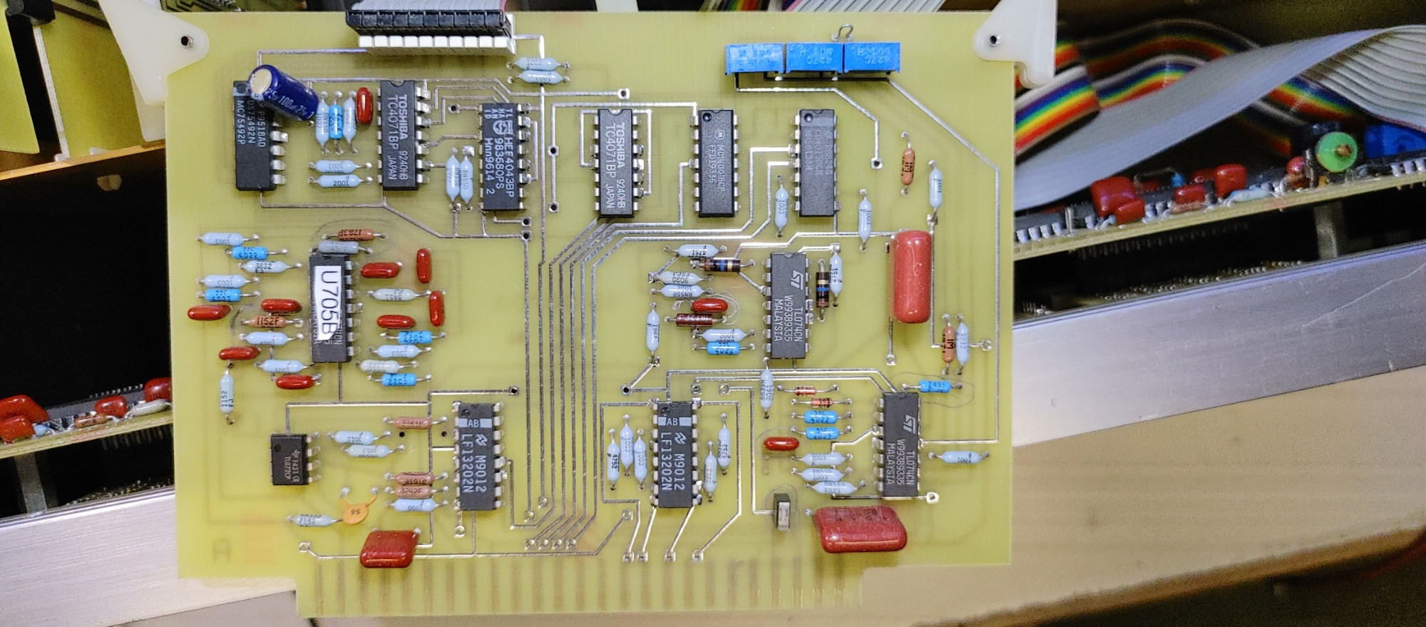

Hi, I am in the same predicament. I work at Microchip in Lawrence MA. We have a Quan-tech 5173 that has some type of issue, it stopped working and was giving bad results. My calibration department looked at it and could not resolve the issue. I was asked to look at it. I replaced all of the aluminum electrolytic capacitors as previously suggested. I started going thru the control unit calibration section to align all of the filters and I am stuck on the 1KHz channel, the op amp goes to the rail. I replaced it and still the same. Can anyone troubleshoot and calibrate this system? The last time that this unit was officially calibrated by the factory was 2001.

I'm working on my 5th 5173. I have gotten better and know what to look for usually. They are a PITA to work on. I have not seen the electrolytic caps as an issue except in one case. It sounds like you are doing the DC trim on the active rectifier. The offset should be adjusted to not drift much and then push the switch (lower right) back in.
A lot of the repairs I have done were to fix "botched" repairs. The documentation is very inadequate really. Its not a surprise that techs get lost. I'm convinced they were trying to prevent Japanese copies since that was a common worry when it was designed. The unit is a collection of nested feedback loops that can be daunting to sort through.
I have two versions of the service manual now that have small differences which have helped me figure out how to get these running.

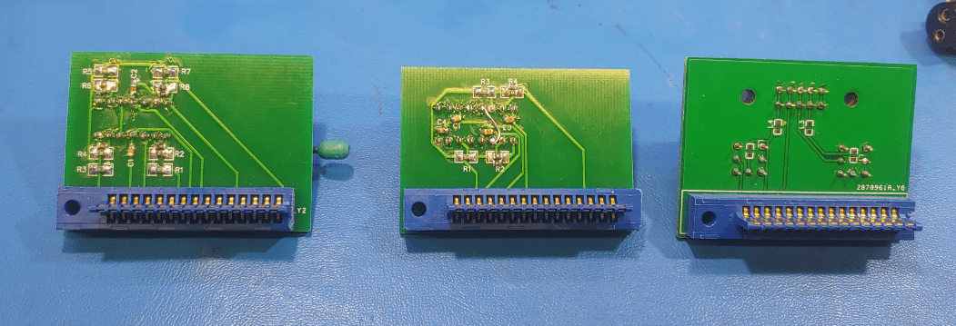

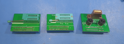

I have also designed a much improved test adapter board. I can provide or supply directions to make your own. The transistor sockets are the real challenge. Most I have found are almost completely unreliable.
None of these cards have the IC numbers and switches labeled and I have no layouts. The manual says to monitor U705B pin 7 and open S702 and adjust R734 for minimum DC drift. I thought U705B was in the lower right corner. You have U705B labeled in the left middle row. Am I looking at the wrong IC output?
Joined 2004
This is an example of why no one seems to be able to service these. The label is on the wrong chip. I did not put the label there. The documentation is minimal and is missing any info on the layout. And there is zero documentation on the adapters. I'm still poking around looking for advice. The transistor adapter can be prone to oscillation. But really no info on how best to suppress it.
