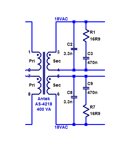

Antek 400VA, 18v
Cx 10nF
Cs 150nF
Rs 18.3Ω
Jeff,
I've tested two Antek AS-4218, and one AN-4218 using the same Cx=10nf, and Cs=150nf. I'm coming up with a way different Rs values than you have posted, but consistent between the three transformers tested. How confident can we be that the values posted in this thread are accurate? I get what you're trying to do here, but I'm encouraging others to build their own Quasimodo/Cheapomodo and verify for themselves.

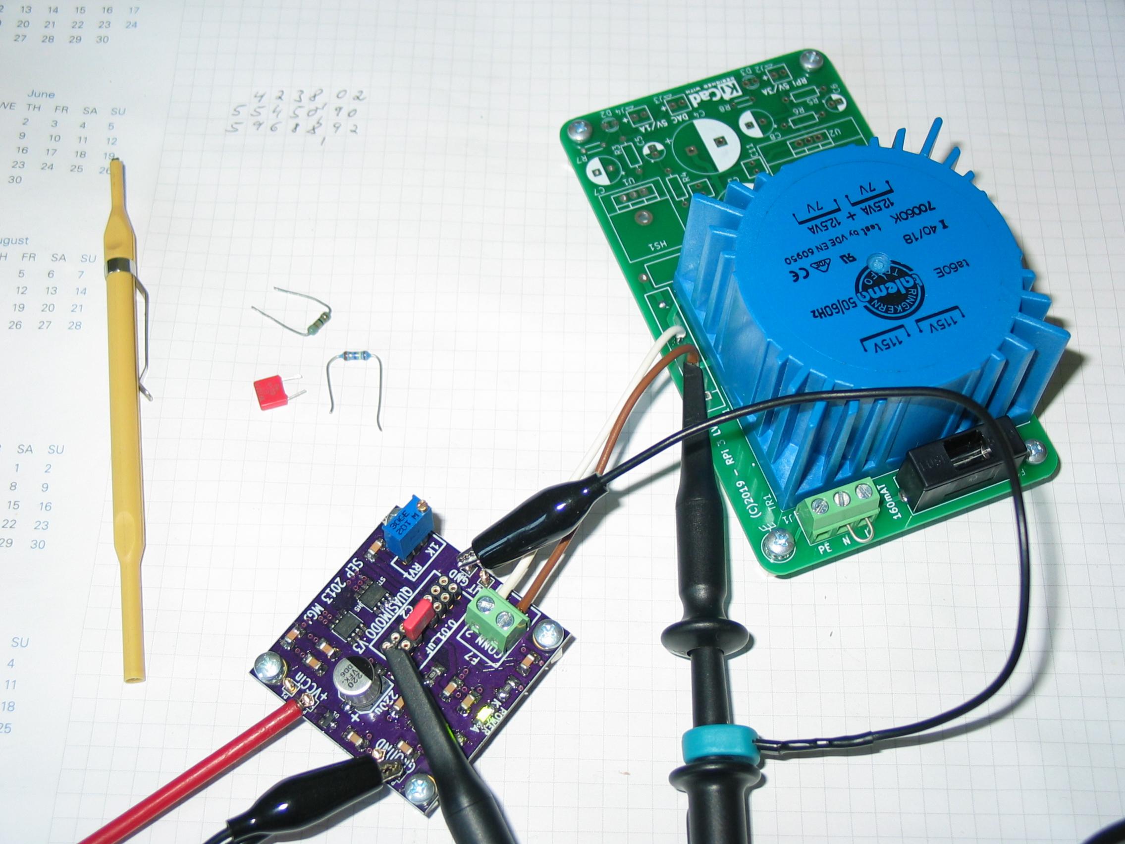

Talema 2x115V, 2x7V, 2x12,5VA
Primaries in series for 230V operation and shorted (for snubbing)
Secondaries in parallel
Cs=150nF, Cx=10nF -> fosc ~ 625kHz(!)
Snubbing this small print torodial transformer I get values for Rs ~ 12Ohm.
Are such low values for Rs reasonable?
Joined 2011
Audiomusica, since you doubt your experimental results from No-Math Quasimodo, you have no other choice than to use math for verification.
Your numerical values of fosc (6.25E+5) and Cx (1.0E-8) indicate that the secondary self inductance L is about (6.5E-6) Henrys. We calculate L using the LC resonance equation.
The LC resonance equation: 2 * Pi * fosc = 1 / sqrt(L * C)​
Plugging this value for L into equation (A.11) of the Quasimodo design note, we find
R < 12.7 ohms​
Which seems to be in broad agreement with your experimental results. You were wrong to doubt them.
