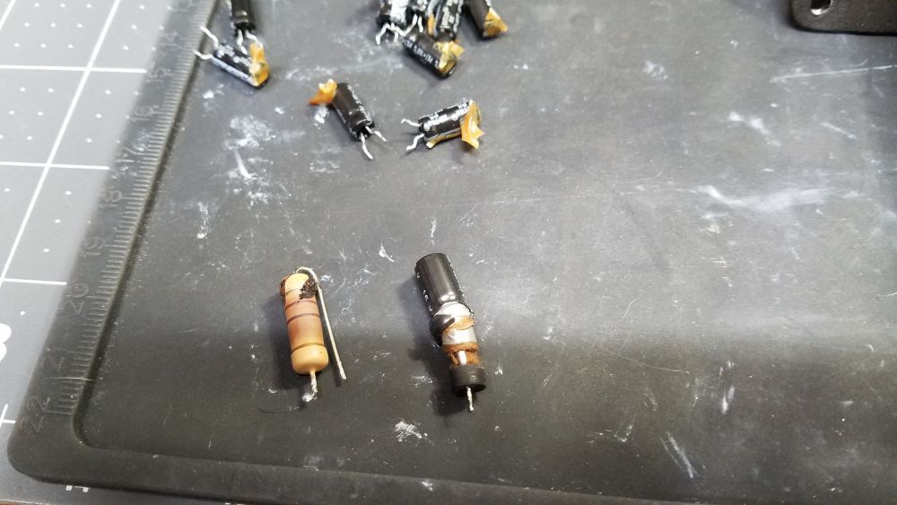

R-115SW plate serial number LK162600399
On this amp the power would not stay on. There were some burned components and one of the capacitors almost achieved liftoff. I would guess it went with a bang and at a minimum scarred the hell out of the cat. All of the Ketuo (how do you even say that?) caps were removed and promptly launched into the garbage bin. The resistor achieved meltdown and was replaced with a flameproof safety resistor and spaced as far as possible from the new caps. The fet was also replaced and spaced higher off the board to help with cooling.
This is a classic case of subwoofer left powered on 24/7. 5W of power at idle is 5W of heat inside a closed chamber with no air movement. Turn your equipment off when not in use or if you MUST be lazy, install a smart outlet that at least powers off when you are sleeping and working. Some silicone to secure the parts and this one is completed.

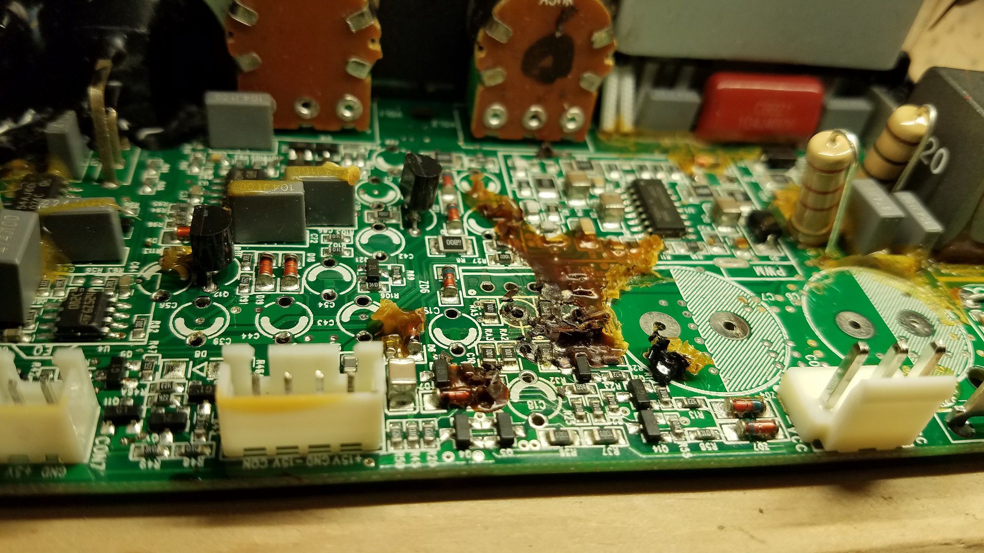

R-112SW plate serial number LH150400882
Had some time tonight to complete another one of these. Repair and full recap. R39 had a meltdown and dried up a few caps and killed the PWM controller power supply. I gooped it pretty good with silicone to dampen the stress on the solder joints so I can let the hot parts breathe a little.

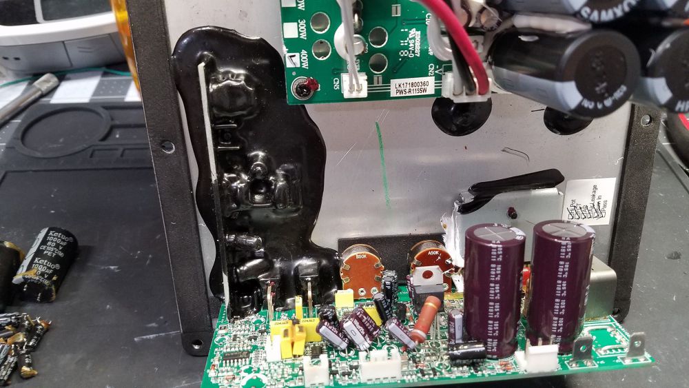

R-115SW #LK171800360
I can't seem to achieve liftoff. This one was close but it couldn't seem to make it into low woofer orbit. Replaced everything burnt and blown and a full recap and this one is ready to **** off the neighbors again.
