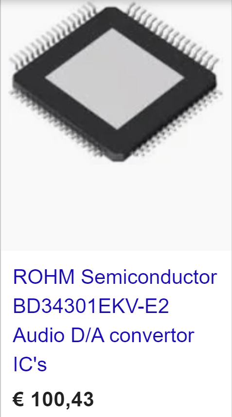

In general, I'm not too fond of the Chinese 'SINAD-champ DACs', but the D300 offers a lot of value, considering the price of a single Rohm chip:

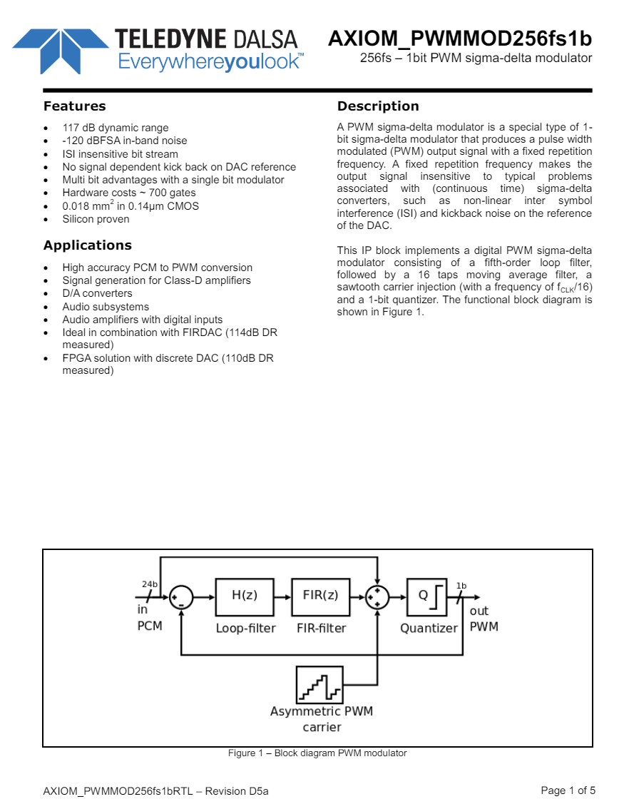

Eventually I abandoned dac chips and went to discrete resistor DSD dacs with hardware and or software conversion of PCM to DSD. IMHO that's future of good dacs at least for the next while. Its basically how Bruno Putzeys's Mola dacs work, and how high end dacs from Luxman and Marantz are made today.
In my understanding, Bruno's DAC doesn't use DSD, rather PWM clocked at 100MHz. The FIR output filter is still part of the design though.
From Mola Mola's site :
The converter is a two board stack that fits into one of the option slots in the preamp. On the first board, all incoming digital audio is upsampled to 3.125MHz/32 bits and converted to noise shaped PWM. On the other board are two mono DACs, in which a discrete 32- stage FIR DAC and a single-stage 4th order filtering I/V converter, convert the PWM into analogue with a breathtaking 130dB SNR.
https://www.mola-mola.nl/dac.php
We call noise-shaped PWM by various names. Quasi-multibit DSD is one. MarcelvdG has talked about how it works. Its an approach to DSD that doesn't need RTZ to avoid ISI (inter-sample interference). HQ Player has such a modulator too, AMSDM 512+fs, which can only be quasi-multibit to work with a DSD dac.
Something like this:
