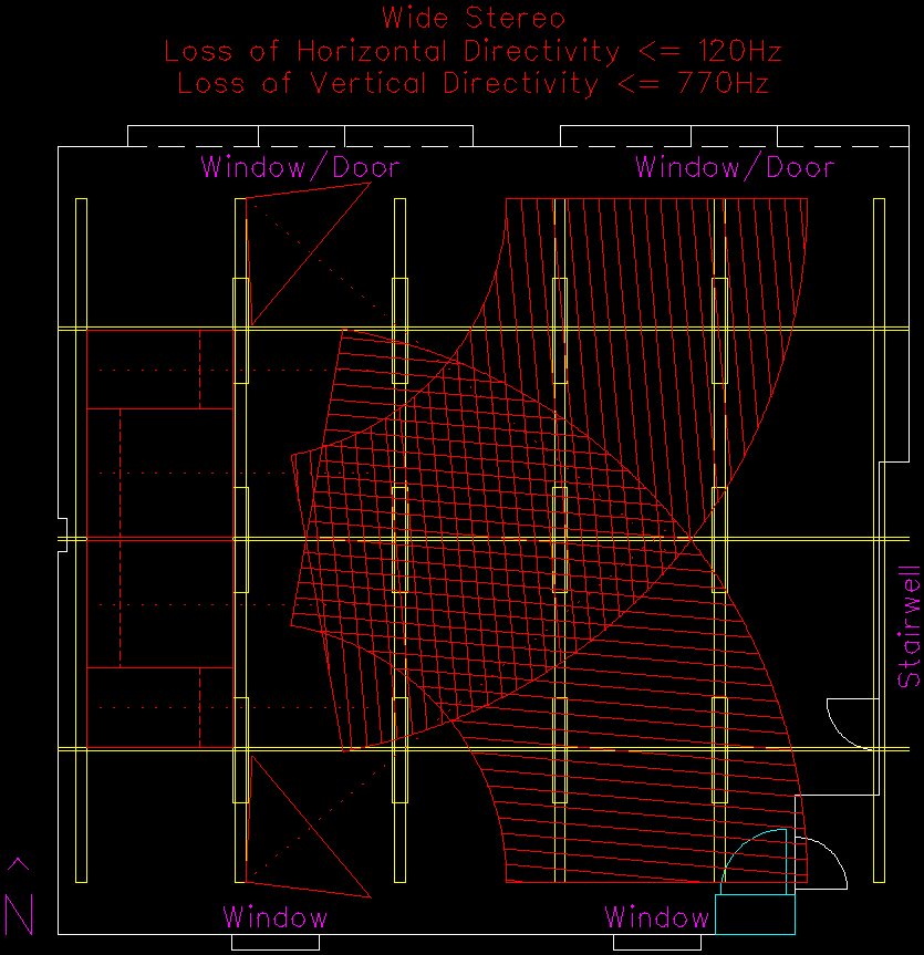

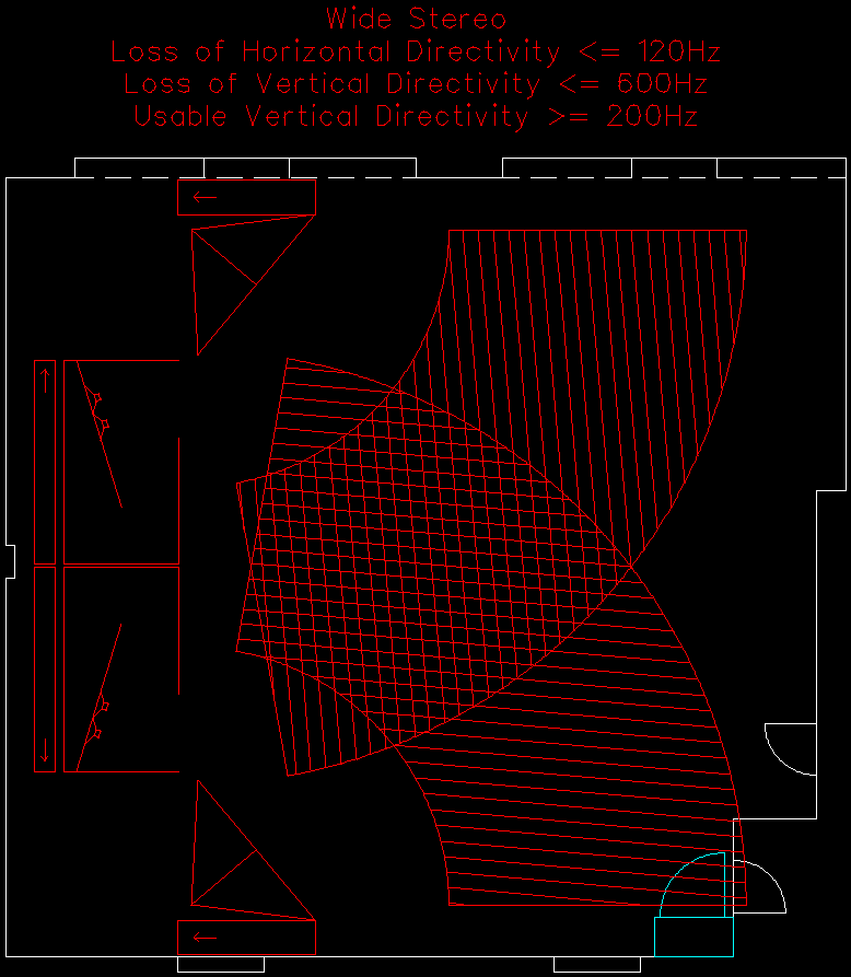

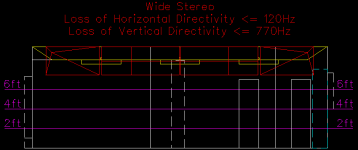

My church was donated a small building a few months ago. Used to be a lawn & garden store, owned by the father of one of our members. We've been getting by in that space with a "cinder-block"-style powered mixer, and some old wedges on chairs as mains. (still way too low, but at least they're not on the floor) I'm working on getting a Behringer XR18 as a Front-of-House mixer like I did for our other location, and I've been thinking about a serious PA as well. We have spoken word, of course, and dreams of a full band. (so far, it's acoustic guitar, cajon, and a vocal or two, all plugged in) So here's what I've come up with so far.
736580d1550273022-sanity-check-custom-installed-pa-wide-stereo_03_plan-png
White is the room outline - approx. 32 feet East-West by 30 feet North-South, with a restroom at the lower-right.
Yellow is the steel-truss rafters and fluorescent lights mounted to them.
Blue is a free-standing closet.
Red is the speaker locations and estimated -3dB coverage pattern.
The tops, set wide and angled in, are from Bill Waslo's SynergyCalc spreadsheet, found here:
https://www.diyaudio.com/forums/members/bwaslo.html
80degH, 30degV, keep H to 120Hz - basically, maximum size to fit in the space with a 3-foot height allowance down from the 10.3-foot ceiling
The MidBass and Subs are two tapped-horns each, configured as a gradient array to try and keep them off of the stage directly beneath them.
Do-It-Yourself Cardioid Sub
Yes, I know the wide-set and angle-in means comb-filtering for center-panned stuff, but there are lots of other compromises going on here too (no space for a center channel, and how to manage it anyway?), and I do want to keep a stereo image for most of the audience. I doubt that most people would notice anyway. Hi-Fi enthusiast audiophiles, probably, but most people aren't that.

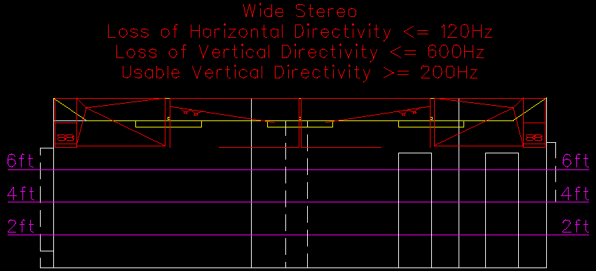

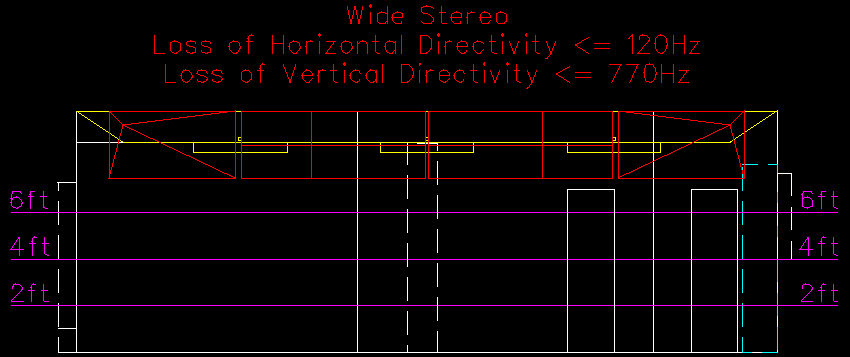

Here's a side-view:
736581d1550273022-sanity-check-custom-installed-pa-wide-stereo_02_elevation_south-png
Note: The tops in this view are not aimed correctly in the horizontal plane. I left them straight to make it easier to estimate the coverage distance at 4 feet off the floor. (estimated sitting height)
The top of the coverage pattern is parallel to the corrugated steel ceiling in an attempt to approximate an array of two in free space.
I also understand that this is firing the tops through the truss, which is also a no-no for absolute best quality, but there's really no other place to put something this size. I hope they're far enough away to not matter too much?

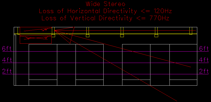

For reference, here's another view through the wall behind the stage:
736582d1550273022-sanity-check-custom-installed-pa-wide-stereo_01_elevation_west-png
So, for those of you that made it all the way down here :), are there any glaring errors or omissions? I haven't designed any more detail than what's shown here, like the selection and placement of drivers, the internal geometry of the TH's, exact crossover freqs and slopes, amp sizes, etc. I'd rather not waste time on that if even the top-level idea doesn't work.

Hi Volunteer,
Sorry, but I think this would be way too much PA for a 960 ft^2 room, especially with the 10.3 ft ceiling. That's only just under 10,000 ft^3 and probably the only absorption in the space is the patrons -- or maybe them and some all-weather carpet.
I think you could achieve excellent coverage and intelligibility with a pair of Yamaha S115V's (or similar) and a couple hundred watts/side. Then at some future point when you add drums and bass guitar (and so have fundamentals below 150 Hz to render), consider adding a powered sub on each side. Excess volume will be a bigger challenge than not enough power.
Regarding the TH subs in a cardioid arrangement -- I admire your ambition (and budget!). But unless you plan to show THX movies or play the 1812 Overture, but there's really nothing for them to do! There are no signals that low; if there were, and you got even a fraction of those subs' potential out of them, it would be significantly more than churchgoers would find pleasing.
Stereo image, comb filtering, and -3 dB points can be disregarded. Unless you're playing material recorded in stereo, there is no stereo image. And unless the room is packed solid with people, the diffuse field will start about 8 ft from each main and it'll fill in the notches.
With a corrugated sheet steel and very low ceiling, open truss joists, and minimal absorption throughout, a distributed system might be a still better solution. Definitely better for spoken word; somewhat less satisfying for music. 12 to 16 smallish full-range drivers would give good coverage, and if you had a couple extra amp channels, put a little digital reverb on the last two rows of speakers to help the music.
This sure is some fine work you've presented; it'd be great in a much larger room -- and maybe one with no ceiling or back wall behind the stage.
And hey, if your Kansas City is the same as mine, maybe I could help directly -- I'm in the book.

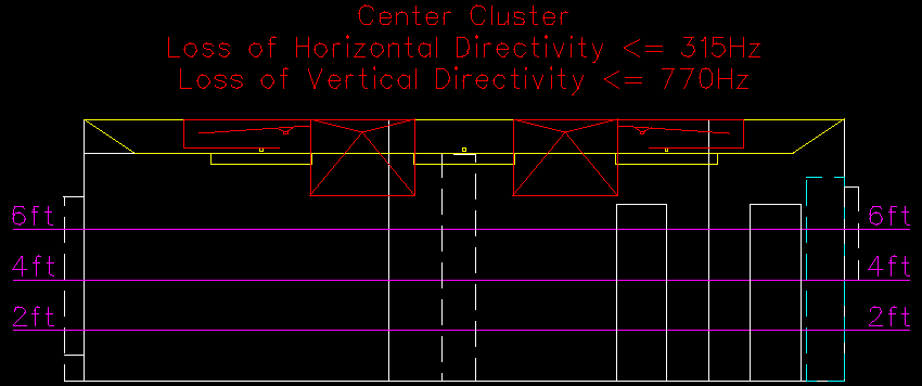

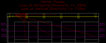

Anyway, I thought about it some more, and of course, I found some problems, mostly in the sub arrays:
1. The upper sub array (60-120Hz) was actually aimed *up* towards the ceiling, not out towards the audience. That's going to reflect off the ceiling and wrap around the lower front corner, not cancelled, and get on stage anyway. So I have to rethink that.
2. The distance between elements in both arrays was wrong. Ideally, it needs to be 1/4-wave at the upper crossover, with a 1/4-wave delay for the rear element, and the overall efficiency drops from there at about 6dB/octave as the phase angles become more equal and opposite polarity. (an octave above that - 1/2-wave spacing with 1/2-wave delay and polarity flip - becomes toroid, with the rear null copied to the front) Specifically, I need to shrink both arrays to make them closer together, while keeping the elements themselves large enough to stay at least somewhat efficient on their own.
3. I looked some more at TH design, and of course, my estimations for that were way off as well. Horns typically work best at 1/2-wave or longer, but the TH design helps to smooth out that bottom octave so that a 1/4-wave horn can still be good. So now I need to figure out how to get a 1/4-wave 30Hz horn in there...
4. I had completely forgotten about a drain pipe for the roof that runs all the way across the stage, right where I wanted to put the subs! I'm okay with moving the electrical conduit and maybe some light fixtures (but only if I have to), but that drain should probably stay where it is!
(it's not leaking at the moment, and I don't want it to start; plus it already looks like the minimum grade to ensure drainage, and anything I do will only reduce it)

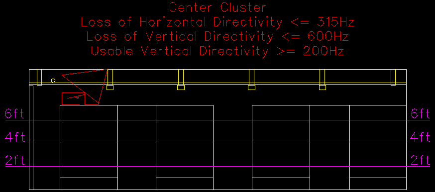

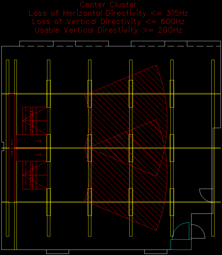

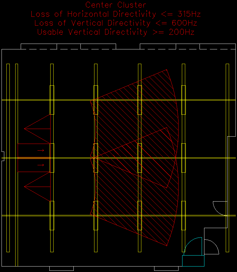

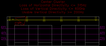

So I went back to a previous design, which had two tops aimed straight back about center-ish over the stage, then put some (still guesswork, but closer than before) upper subs just outboard from them. Crossover around 200Hz because of the tops' 36" vertical mouth. (tops are aimed down about 15deg, and I really want to cross over before the physically-mandated widening-out reaches absolute vertical) Cardioid array again, but closer to each other and more in-line with the intended firing direction. Not sure whether to aim the front one out towards the audience and use its side wall as the distance between elements, or to aim them both down. (with a mouth that is itself comparable to 1/4-wave, how is that distance measured anyway? centers? near edges?)
attachment.php
attachment.php
I haven't figured out what to do with the lower subs yet. The best I've come up with so far is a complex folded TH (just to make it fit) firing towards the audience, filling the space inboard of the tops, and a mostly-straight TH (one 180-deg bend like the upper subs) behind everything to complete the cardioid array.
attachment.php
What I don't like about this is that the lower crossover point also reaches across an unrelated driver. Maybe that doesn't matter as much as I think it does (looking at roughly 60Hz or so, with a 50" horn mouth in between that does practically nothing at that frequency), but I really like the previous concept of having every crossover step between immediately adjacent sources.
I could invert the previous design entirely, having the tops exactly in the center and step outwards at lower frequencies, but the position shown here is dictated by the existing light fixtures, and not having the tops fire through one. Again, I might be able to move the lights (replace that center one with two attached to the lower edges of the subs?), but I'd rather not if I don't have to. And of course, there's still the problem of making everything fit around each other and the building.

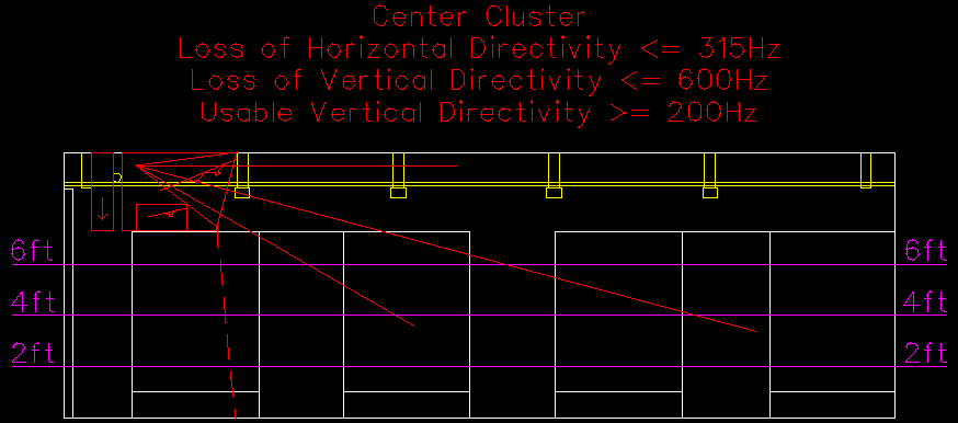

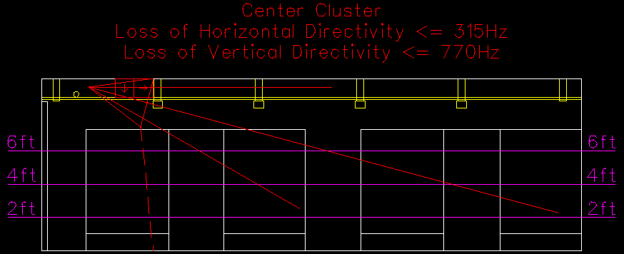

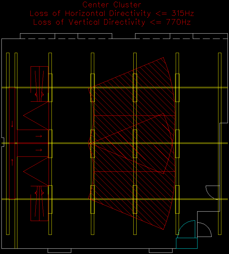

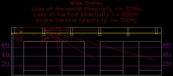

Okay, here's a slight paradigm shift. Relaxing the requirement that the two elements in a cardioid array must be identical, allows this:
attachment.php
Rafters and drain pipe omitted for clarity. You've seen them before, and they haven't moved.
That's the same Synergy tops as the first time, in the same locations, but allowed to play down to about 80Hz or so, knowing that they'll become practically toroidal at that point. (vertical omni already, and horizontal getting there) So what used to be my MidBass array is now just the rear element, that fades in as the Synergies' pattern widens out to hit the stage. (~55" between centers) Thus, I'm only constrained by one mouth instead of two, and that allows me to put them completely out of the way of anything else. An ideal cardioid would require that mouth to be directly behind the main horn, and a single-fold TH just happens to fit exactly right there, between the tops and the side walls.

Other views:
Detail of the MidBass:
attachment.php
And in context:
attachment.php
Like at first, the tops are not aimed correctly in this view. I left them straight to better estimate the floor coverage.
The red dashed line is the vertical pattern at 200Hz from a 36" mouth.
attachment.php
Only the rear elements of the sub array are shown here. They're 10" wide to fit between the drain and the near rafter, but the mouth is still 36" the other way to match the front elements, which themselves have 36" square mouths to match the height of the tops.
(something tells me I might have over-subbed it compared to the tops...)
Any other problems?
Is it workable to have two differently-designed elements in a cardioid array? Or will the inherent differences in response cause problems that can't be solved with relative EQ and such?
Is it workable to have not only different drivers, but a much wider frequency range for the front one? The front is designed to be directional on its own, and the rear is only to catch the spill below the controllable frequency.
Are the overall dimensions of each driver okay? I haven't designed the internal geometry yet; I'm mostly concerned now with overall fit between boxes and architectural features. If it's *possible* to get a smooth full-range sound in the audience from the arrangement shown, including a much quieter stage at all frequencies, then I'll lock down the external design and start looking at internal, but if the external doesn't even work, then there's not much point in looking at the details.
Of course, there will also be some acoustic treatment. I just haven't gotten to that point yet. I'd like to keep as much sound off the walls as I can in the first place, and *then* fuzz them. In fact, there are several places where (I think) I'm actually using a hard surface to my advantage. (all against the ceiling, for example)

Okay, I think I got it now...or at least the overall idea. It's amazing how far off you get when you can't see the space that you're designing for. Sunday morning came and I got to see it again...ohh.
So here's something a little more sensible. Not that the other designs wouldn't have worked, but...anyway, here it is:
attachment.php
That's just the audience-facing speakers. Two Synergy clones between existing light fixtures, crossed over to a pair of TH subs around 80Hz or so. The TH's continue down to 30Hz minimum to cover the bottom fundamental of a 5-string bass.
The top horns are 50"H x 36"V x 44"D for a coverage pattern of 45degH x 30degV, and angled 15deg down to set the top of the pattern parallel to the hard ceiling.
The subs are inboard of that, as two units because of the rafter stabilizer in the center, but they'll sum to mono anyway, being closer than 1/4-wave to each other. 22"H x 36"V x 54"D maximum for each.
The estimated coverage pattern is at sitting level, and excludes the front row or two. That's okay because they'll hear a spoken word directly and don't need reinforcement. Standing for music will cover the center of the front rows, but I might need to add some corner fills. But since I'm thinking of them as add-ons anyway, I figure I can build this and then measure what's still needed over there.
Here's all of it:
attachment.php
Cardioid subwoofers as before, but they don't need to be as big as I've had them before. The rear elements of that array have the entire space to themselves behind the drain pipe.
The top horns are designed for 45degH x 30degV and angled down about 15deg, but of course that doesn't help the natural widening-out at lower frequencies. So I tucked a small TH under each to fade into a cardioid array at the lower end. (I'll probably end up with fewer larger drivers in it, but whatever. It's just a quick conceptual drawing.) Here's a side view that shows the arrangement between them and the top horns:
attachment.php
Detail of the small cardioid supplement (left) and the main sub (right):
attachment.php
attachment.php
The lip in front of the small TH is a closed baffle to meet the mouth of the main horn. That distance on its own is about 15", or 1/4-wave around 230Hz or so. According to Keele's Constant, the main horn approaches absolute vertical around 200Hz, so I think I have a little bit of wiggle room...if I've measured the spacing correctly. Including half of the 6" mouth of the small TH brings the 1/4-wave frequency down to about 190Hz. Including half of the 36" tall main horn as well, brings it down to about 95Hz.
The mouth of the main sub is angled down 15deg to match the top horns, and I'm wondering about flipping it vertically so that the final centerline points downish instead of up as shown here. Like before, I haven't done a whole lot of work yet on the internal geometry.
I'm also thinking to create a false ceiling and a front wall to cover the entire volume over the stage so that:
- The rear cardioid elements are simply openings in that ceiling.
- The front elements are openings in the 15deg front wall of that box.
Complete side view:
attachment.php
So the front few rows for music (standing) are going to be louder than the rest, with a fade down from there towards the back. Oh well. It's a difficult room, and I think I'll cause more problems than I solve if I try to fix that.
Besides, I've seen churches publish their measured coverage pattern so that those who want it loud can sit where it's loud, those who want it quiet can sit where it's quiet, and those who complain can be told to sit "over there" instead. So this not-completely-even coverage might actually be used to our advantage.
Anyone care to comment before I spend a ton of time designing internal stuff?
