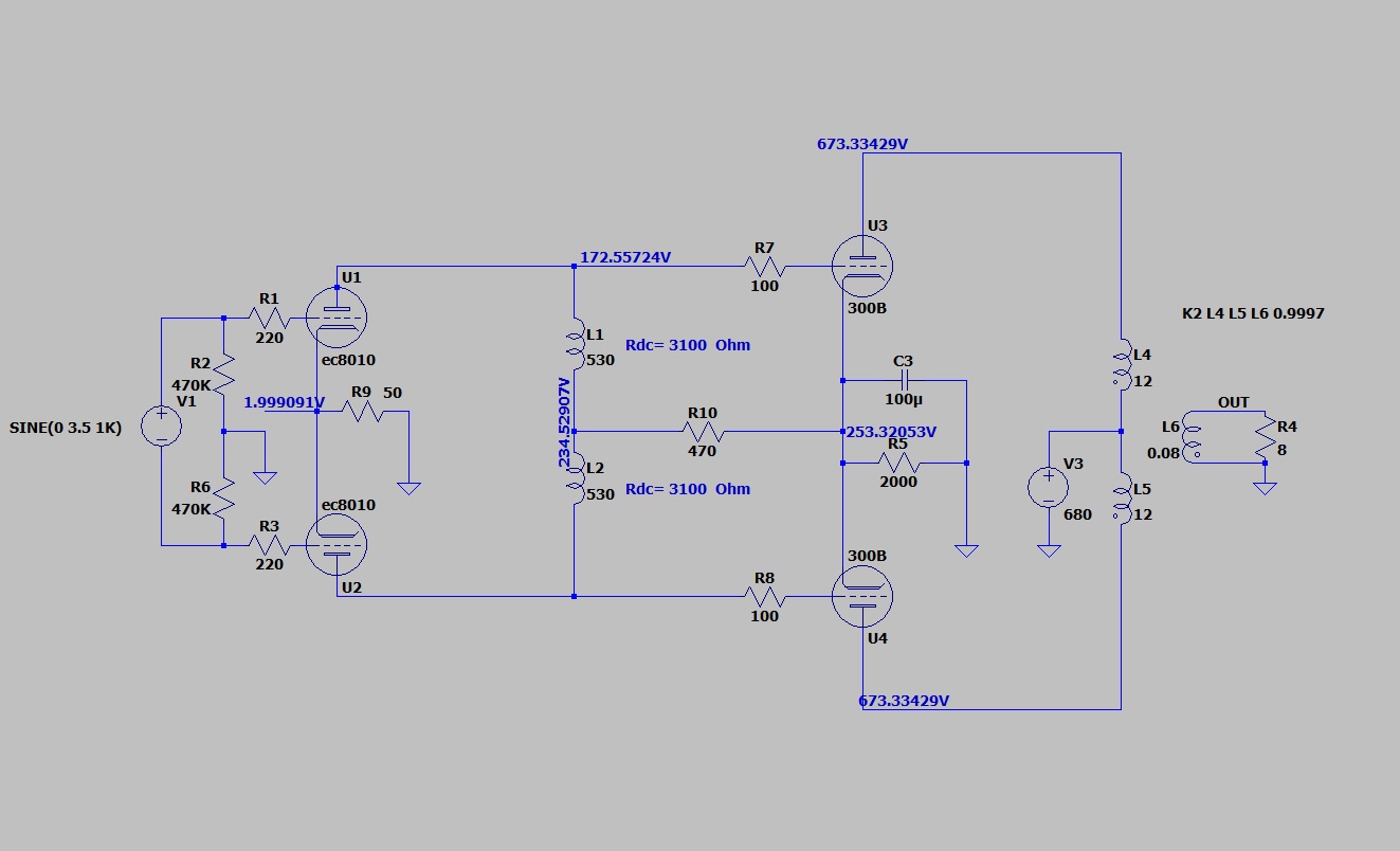

Here is a first pass that does DC couple to the PP output tubes. It is not optimized, could be improved. Needs more gain, a 6SL7 Diff stage on the front end would cure that. The +ve & -ve PSs are not a problem, all can be got from a single CT HV wdg.:)
Optomized for PP 300Bs
A little more detail in this Sim. 19.5 Watts at clipping. All of the required voltages with the exception of the 300B heaters are easily produced using a common CT HV audio electronics PT. The VR tubes could be replaced by their miniature equivalents or Zener Diodes.:)
The Hammond 300B would be OK for this version if choke input filter was used. With Cap input the B+ is too high.:(

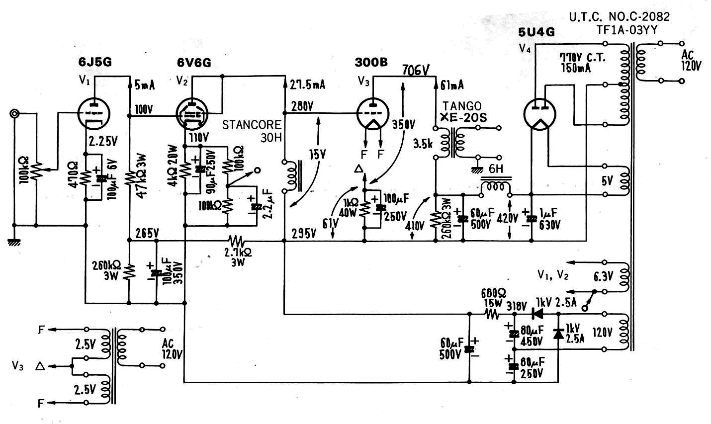

The problem always is if the driver tube is accidentally missing/burnt - you lose the valuable 300 one too, a big turn off.
Ref the Komuro 300B SE cct. If you pull the 6V6 driver, no problem because the 300B has voltage potential of ~295V at the grid, and ~350V at the filament (so the tube is still biased and does not become a loss, valuable or otherwise).

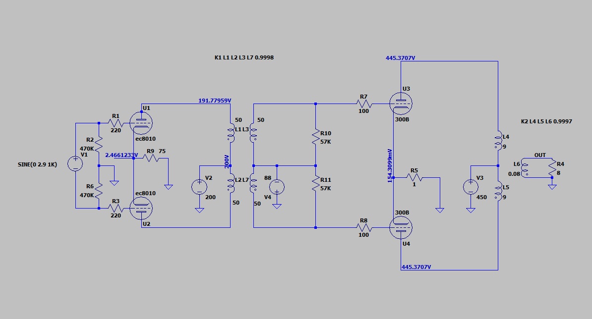

I toyed around conceptually with this circuit making it DC coupled and push-pull through out with input transformer. The floating paraphase splitter is now not needed. I kept all the voltage relationships the same as original. I had to change the feedback mechanism so it's PP from the 300B plates because now the input tubes' cathodes have high negative voltage. Obviously the output transformer is outside of the feedback loop a la Western Electric 118. It requires two supply rails, one positive +399V and one negative -266V. Similar style power supply can be seen here. The advantage of this over single supply or stacked supply is that if the 6AN8 input tubes were pulled there's no harm to the 300Bs because it would have -266V on their grids to bias them into cut off and no danger of red-plating at all. I just need to figure out a way to individually adjust negative voltage on 300B grids (It's much harder without blocking caps!) without affecting the input tubes operation points in case you don't have matching 300B tubes or due to aging and drifting. Really tricky to do! Fun exercise!
