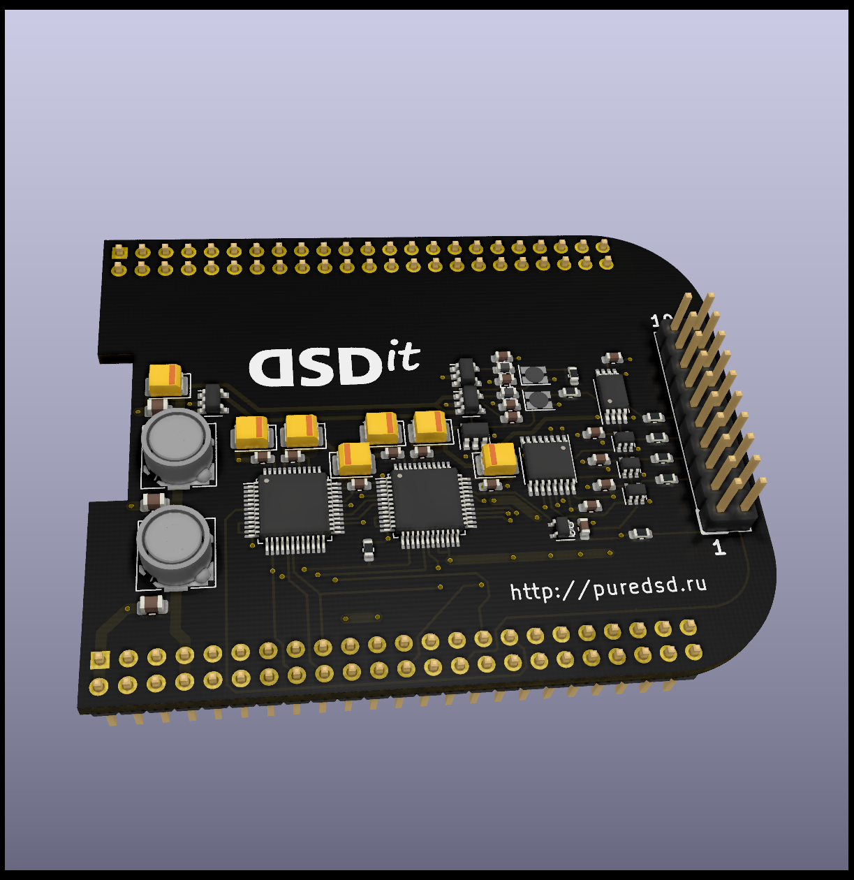

I propose for discussion a new project SRC on dual AK4137. The first AK4137 upsumpling PCM to 176/192, the second converts to DSD256.
Dual AK4137 allows you to convert to DSD256 without significant loss in quality.
This cape cannot claim to be HQPlayer's conversion quality, but it can compete with Roon software conversion.
The firmware for the BeagleBone will be published later. After I debug her work.
The project is open. I will be happy to hear your wishes for further development.

Hi ppy
probably would be better to add +1 flip flpo at the recklocking output.
- avoided metastability
- using one double Flip-Flop standard package per line will decrease intermodulation between lines.
- separate decoupling of FF ic will decrease ground bounce and improve signal integrity
- in case of cascaded Flip flop recklocking You wil have exact one MCK delay of all sygnals, when in case of one F-F used delay is 1/2 of MCK and there is the difference in terms of rising edges strat then in the input...
Another thing is designig for signal integrity that is sort of simple: between every IC interconnection put one R and trim each value to eliminate ringing at the edges. That will tremendously decreased noise coming from ground bouces when sygnal at the edges are higher then power suply value...
In that direction simple shunt regulator for each IC or segment of ICs are helping more.
Because of closing current consumption loops slose to the power pins of ICs.
These few things have huge impact to th final sound result i tried it.
cheers
Thanks Zoran!
PPY's recklocer similarly designed and stable. But if I see with an oscilloscope that the AK4137 signal falls into the metastability zone, then I will definitely correct the problem. But can it be more convenient to do this not by adding three flip-flops, but by shifting the MCLK signal by 3-4ns through one Schmitt trigger? The 74AUP2G79 has a metastability window of only 1ns.
Double Flip-Flop does not allow placing on the PCB as close as possible to the Amanero standard output connector.
Yes, I will do it in the second version. I have already ordered PCB fabrication.
Between every IC interconnection 3-7mm. At these distances, there are no reflections that the series resistor can correct.
P.S. My English is very bad. Maybe I misunderstood you.

Hi ppy i have take a look at the sch You linked.
The goal is to keep separate I2S lines all of the transition lines.
Not to merge all I2S lines into single IC. and multiple times.
The lines are from different frequency and for my opp should not be interfered in the small space die-s in ICs...
I have good results with single digital isolator ADuM1100
I think that You don't need buffer from the amanero outputs?
You can go direct to the isolators. BUT if You want enable function before isolators You can use single high speed buffer with enable function for EACH I2S line. That is much simply-er internal structure circuit.
Actually ou did some signal integrity treatmant with Resistors anthe linked sch, but only in one interconnection place. Should be between each IC. And walue of 33ohms is small and insufficiant. That should be checked by the measurements with osciloscope and trimer pot at each point. From my measurements these the values are higher round to 100ohms.And it depends of frequency. Simply, You dont nedd the spikes beyound the pover voltage upply at EACH 1/2 sygnal,
and with all of ICs used. Anyway the logic levels are smaller than powr supply value and we dont nedd at all that multiplied, constant glitch energy in the device.
That comes from the tipicaly powerful drivers that drives low capacitance inputs of the next gates, mainly. These outputs are designed to drive about 15 gates, and in most digital audio devices they drive just a single gate... So it is not mainly about reflections.
The issue abot flip flop. When You clock some data in the flip flop then the data will be at the output "delayed" by the 1/2 of in our case MCK. So the MCK in relation with all lines will be at the oposite rising/falling edge of the signals we recklock. When You add just one F-F after first one in series, clocked with same MCK, the signals will be "delayed" by the full one cycle of MCK and all of the lines will be in the same rising.falling edges LIKE it was in the input of the recklocker.
You cant measure positively meta-stability with conventional equipment I think?
No need for that because in every scholar literature stated that it was measured and the recommendation is to serialize the F-F.
Off course for max sampling rate input frequency You need minimum 2 times higher F for MCK. For instance at the 384KHz SR BCK is high F and Yu need 47.xxxMHz MCK to achieve recklocking. For up to 192KHz SR 27.xxxMHz is minimum.
Dont get me wrong about suggestions, I like Your work and just want to share my expiriene and informations :)
cheers

Thanks to Zoran for the advice. I will try to take your advice. But I would like to keep the balance between device cost and efficiency. This reclocker should be several times cheaper than the cost of HQPlayer. I consider HQP to be the benchmark for sound quality. And if this device will approach the cost of HQP, then apparently there is no point in developing it.
A separate shunt regulator for each chip seems redundant. The device from the topic will be assembled to debug the software and evaluate the effectiveness of such a solution. If the result is good, then your advice will also help me a lot. I don't consider myself a good circuit engineer. Therefore, I am ready to learn.
By the way, metastability is measured quite well by an oscilloscope - https://www.siue.edu/~gengel/GALSproject/MeasuringMetastability.pdf
