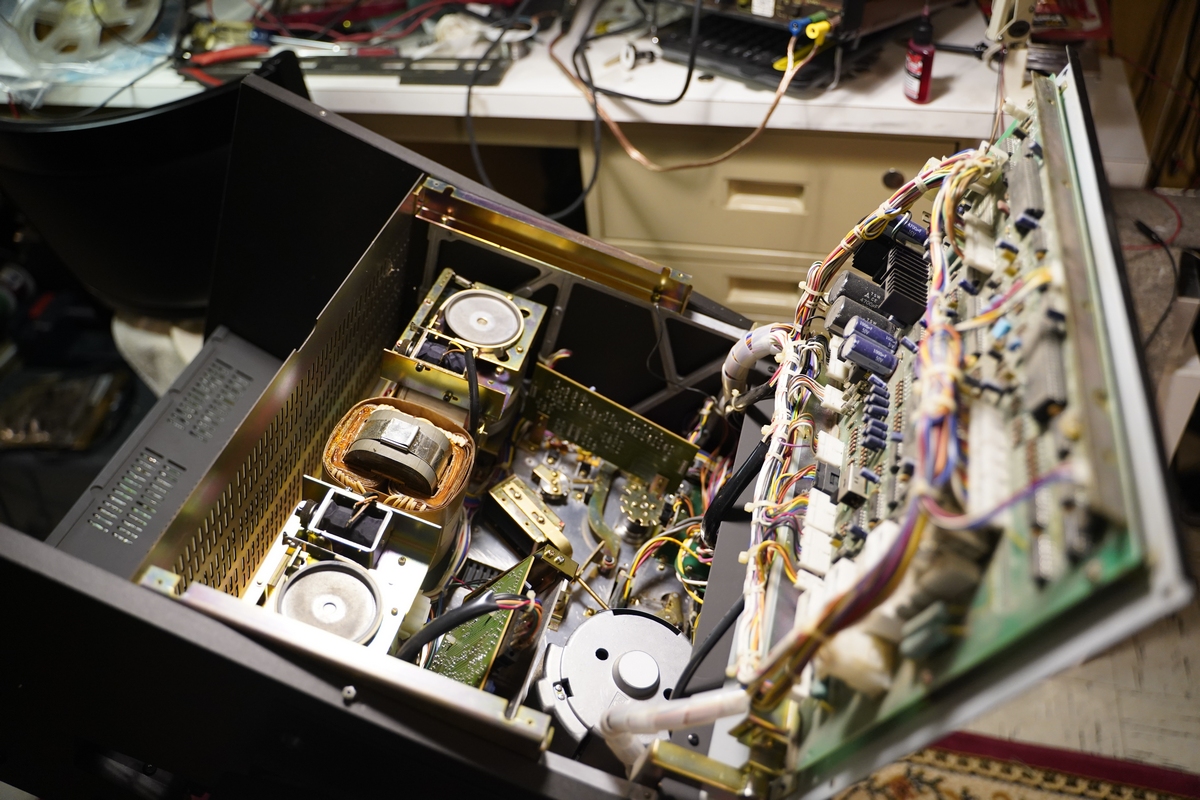

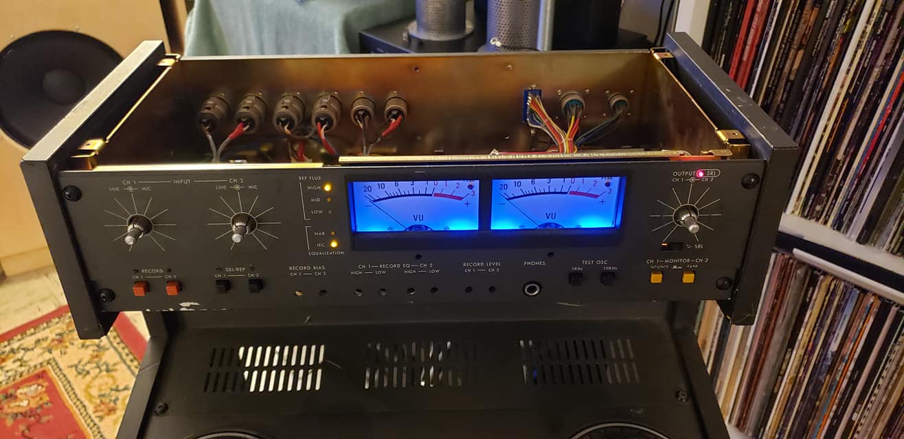

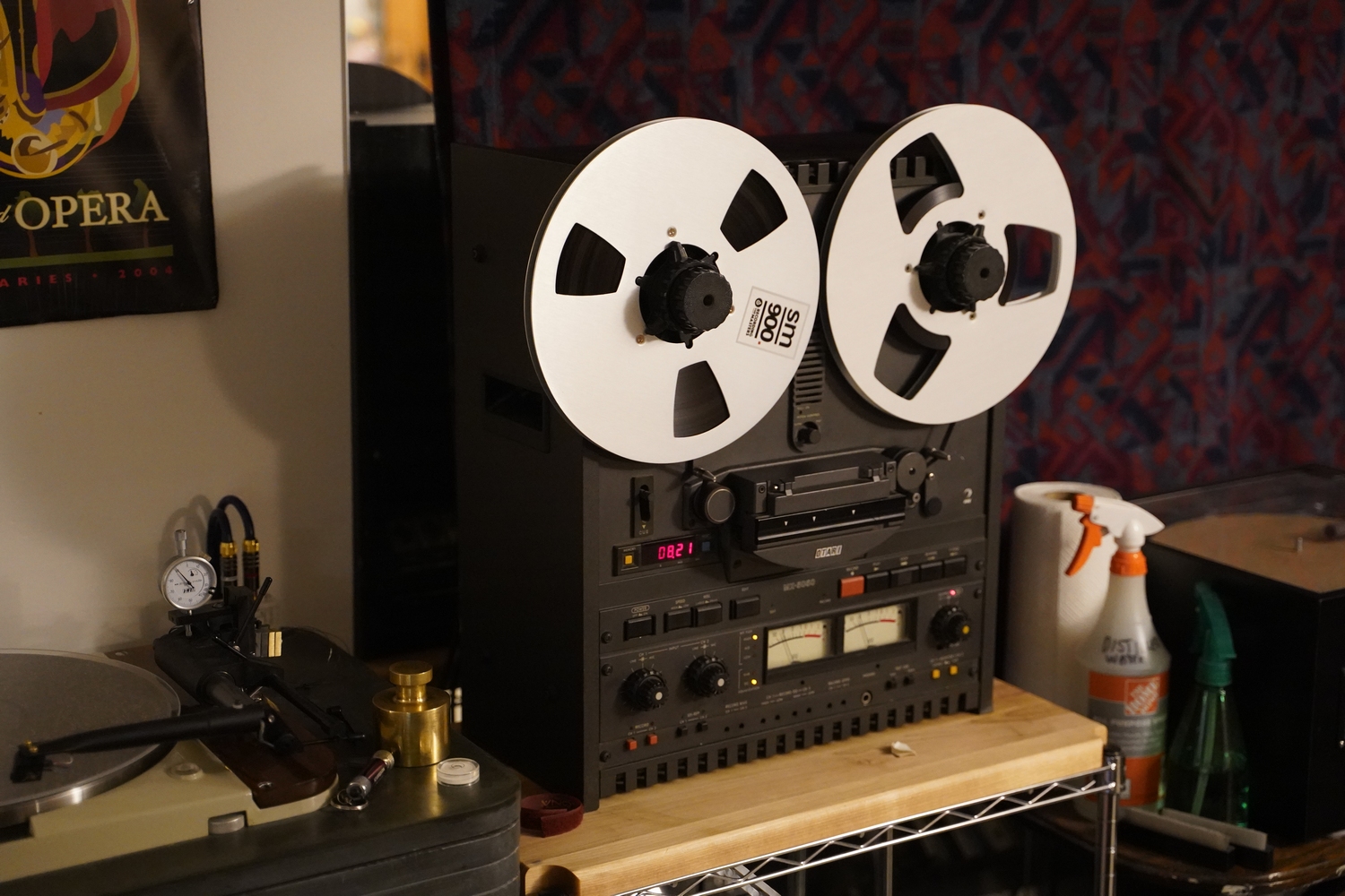

A few months ago one of my best friends decided I needed a new audio affliction™ and gave the first of my current two OTARI tape recorders.

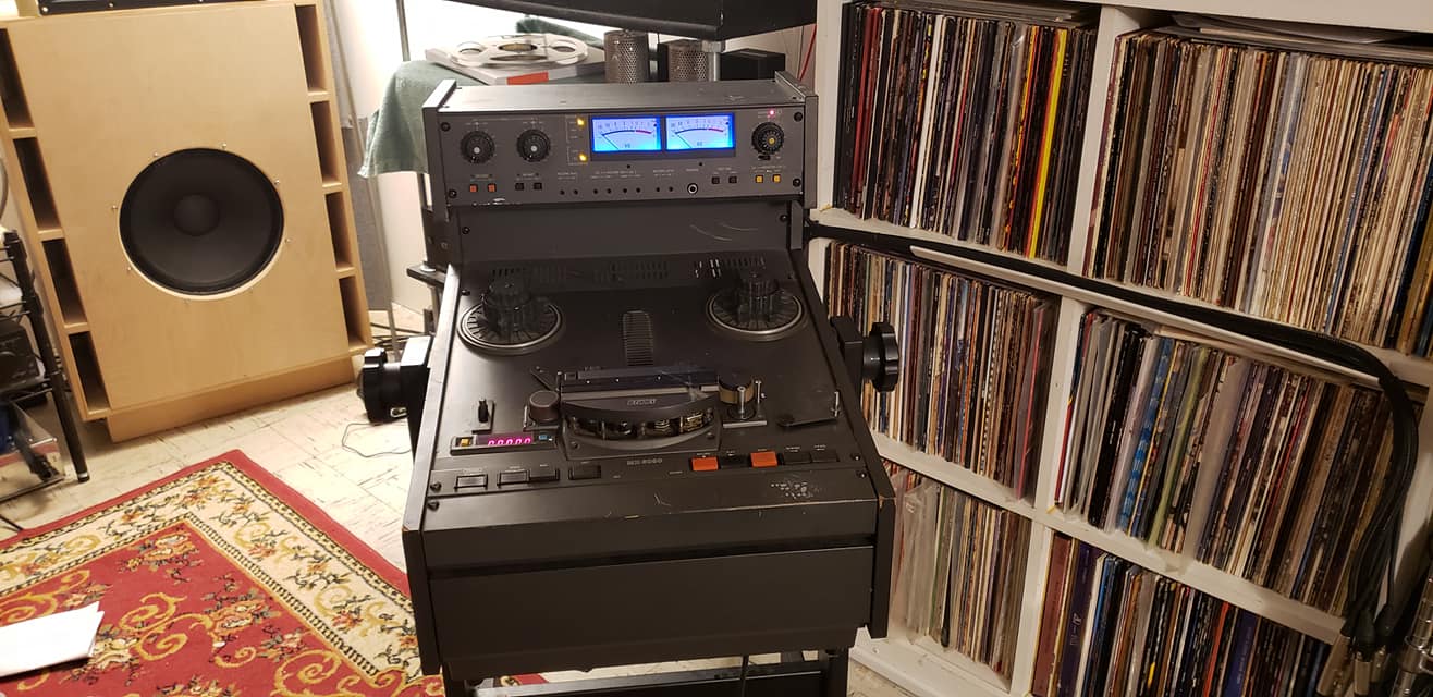

Today I am the proud owner of two ancient Otari's;
A 1983 vintage MX-5050BII-2 which arrived here sometime in late January if memory serves.
And in late March I came home from the Montreal hifi show after a detour to the deep woods of NH with a rather challenged example of a 1984 vintage MX-5050MKIII-2 with its cart. This is a bridge style recorder which is a dream to work on by virtue of the cart. I don't recommend buying one without as the form factor is otherwise brutally awkward to deal with.
Neither of these decks were in running condition when I got them..
This then is the story of one fool's mission to save them from the scrap heap.
The machines now both run, record and sound surprisingly decent recording test dubs from a digital source here.
The whole point in the long term is put together a couple of good, and not too expensive machines to play those hideously expensive commercial tapes on.

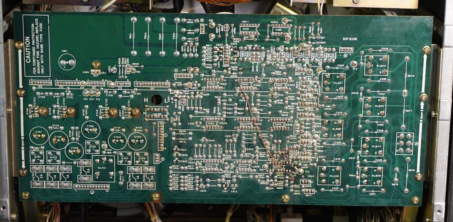

There are a fair number of myths circulating about the Otari decks. My observations should apply generally to models other than the two referenced in the opening post.
Each successive generation has improvements in the electronics.
BII, MKIII, and BIII series machines are similar with the BIII being the most evolved. The BIII is the first series to use improved switches in the transport, they also tend to be somewhat more expensive than the older models.
Surprisingly dead machines are often not too hard to bring back to life if you are patient and can use a scope and do basic trouble-shooting, should that not be the case I recommend you not consider buying a non-functional deck as they are quite complex.
Things to look at are the condition of the heads, guides and pinch roller. Probably a good idea to avoid machines with bad heads - they will be expensive to replace.
Heads that are worn to the depth of 1 mil (the thickness of the tape generally used) or so can generally be relapped at considerable expense by an outfit like JRF.
Replacing the heads on the head block is possible for a skilled diy'er, but doing a good alignment probably isn't.

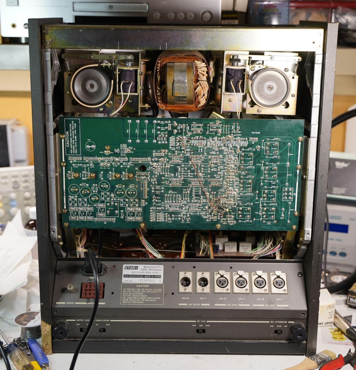

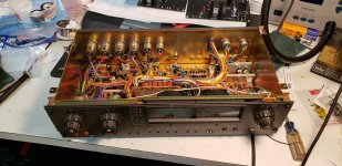

My BII had some corrosion damage due to the foam pad on the back panel that disintegrated into a corrosive goo. This resulted in an open trace that cause some very odd problems preventing the capstan from engaging.
The MKIII had some bad switches and a capstan motor that liked to seize up.
One of the myths circulating about these machines surrounds the Nichicon capacitors used in these machines not ever needing to be replaced. Otari was extremely conservative and they almost never fail, but that does not mean that they are still doing the job effectively.
After a recap (provided you don't break something in the process) the machine will run and sound better.

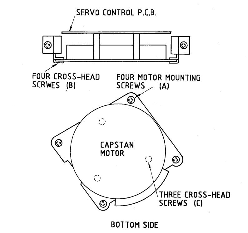

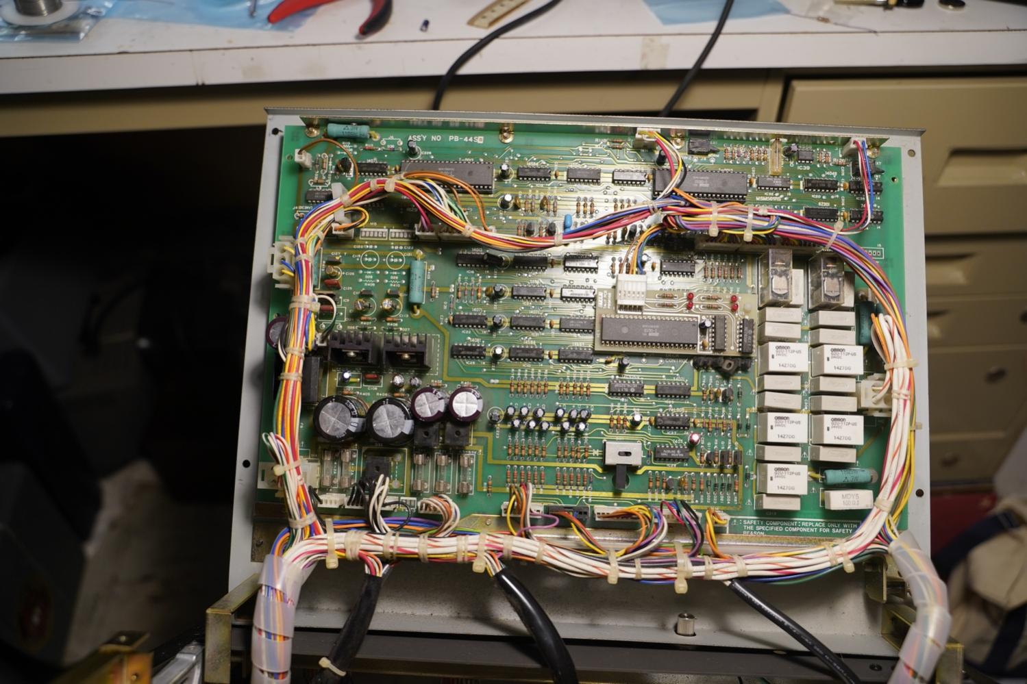

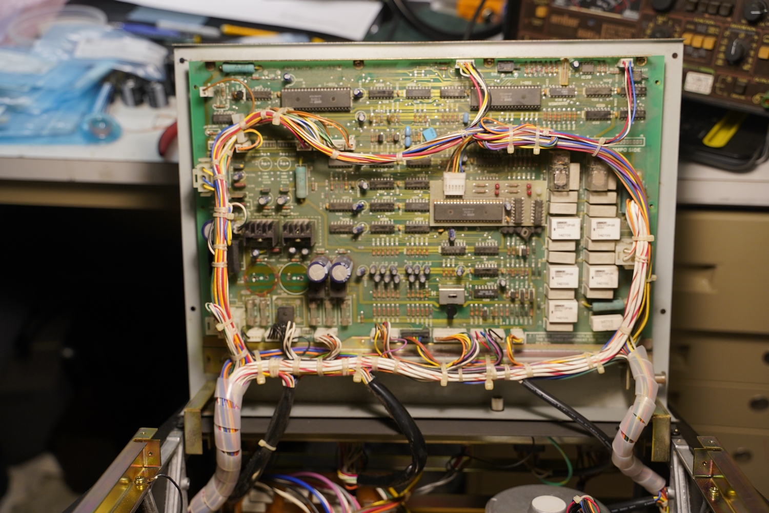

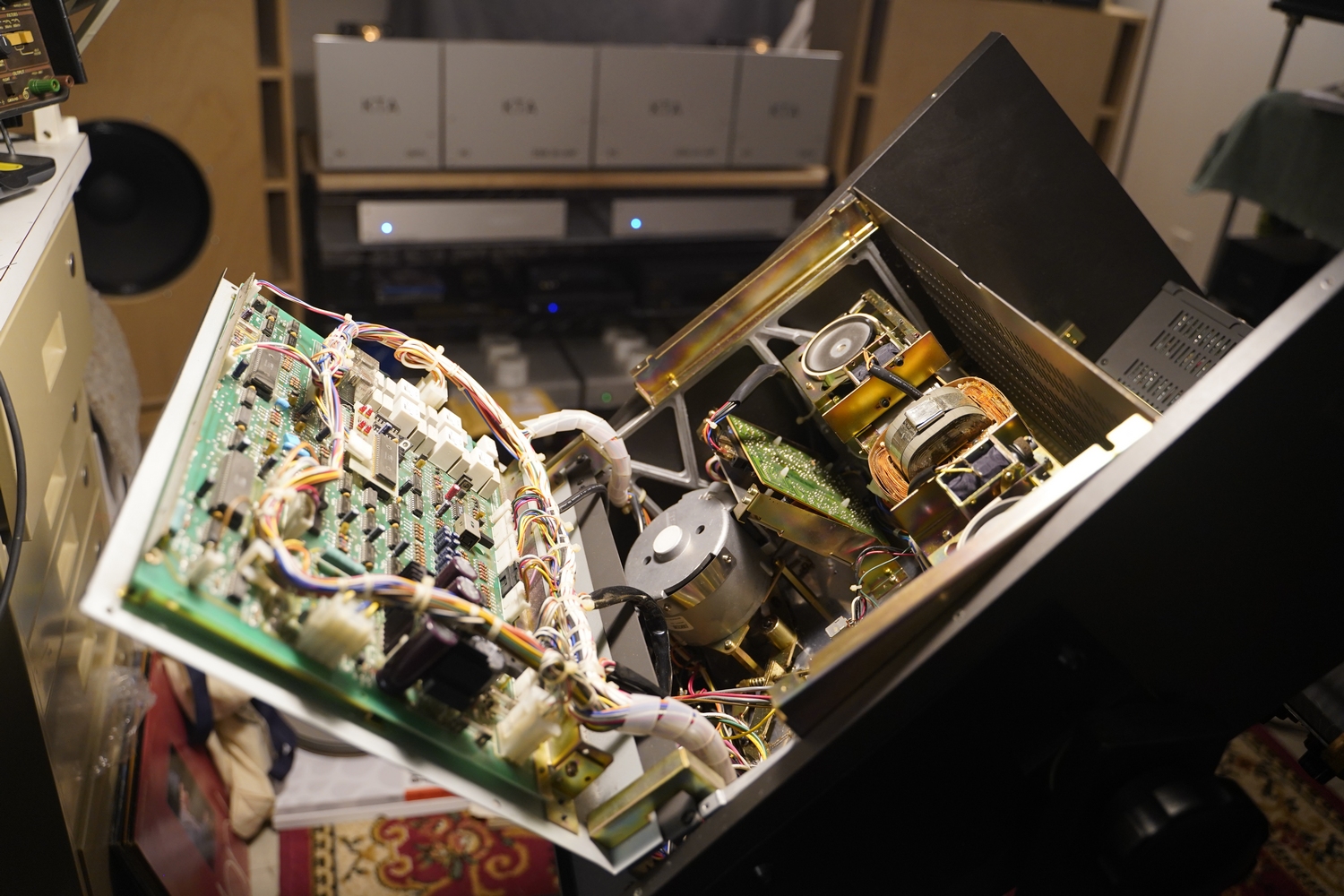

Capstan Motors
Before lubricating the capstan motor bearing you need to remove the bearing dust cap, to do so remove the pinch roller, noting location of all washers as you remove it.
Make sure the well is clean before adding lubricant, any accumulated debris in there due to neglect and lack of service will get washed down into the bearing and likely cause the motor to seize.
Use only the proper lubricant which is Anderol 431 or the Athan branded equivalent. These machines have an oilite bearing.
The capstan motors in these decks are often neglected, but very easy to remove and disassemble. This applies only to the later servo capstan motor decks. I've not worked on an older deck with the AC motor and belt drive.
You need to remove the pinch roller, and may at worst have to remove the head cover, and the rear trim piece if you cannot remove the capstan dust cap. If you can actually remove it you only need to remove the pinch roller.
In a BII you must remove the screws that retain the logic board to the rear frame rails and move it out of the way.
In a MKIII you will need to remove a bunch of screws and carefully remove the front trim and move the logic board out of the way.
There are 4 screws that secure the servo PCB, there is a tie wrap to one of the frame rails that you will need to cut (carefully) and 4 screws that secure the motor to the chassis that you need to remove. The whole assembly then lifts out.
See illustration shamelessly lifted from one of the many scans of Otari service manuals on line.
There are 3 screws that retain the motor to the mounting plate - I remove them and the plate.
There will be a tie wrap or two snug up against the body of the motor, carefully snip this and remove. Failure to remove tie wrap could result in an expensive mistake as you attempt to separate the motor halves.
There are 3 screws that secure the case halves, remove these and pull straight up.
Check that the 3 sensor coils in the top half have remained in place. (If broken Athan can repair) Secure them with a dab of high viscosity superglue on the bottom if necessary. (I took pictures but cannot find them.
Clean the bearing bore in the top half of the housing. Polish the shaft if there is an scoring with very fine sand paper (320 grit) until any sharp edges are removed.
Clean everything!
Apply a small amount of the anderol and reassemble. Add a couple of drops in the well.
Reinstall. Should run quietly and maintain speed.

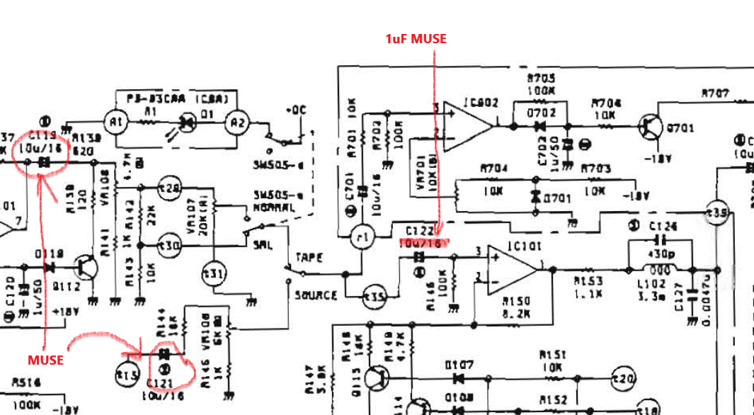

I think maybe you might want to discuss the tape head amplifier and line level circuit modifications. The electronics are of the early 80's and were not made to be extremely good, just good enough. With our parts today, and some of the circuitry we now use, those machines could be given a real boost in performance. Additionally, if you look at improved turntable EQ amps, they would easily adapt to a tape head application. The very low noise Salas phono preamp would drop the noise floor a lot and may possibly really wake that machine up.
From what I see there, the Otari was similar to some of the Tascam machines in build except no bridge. So electronic improvements to the Otari would also apply to the Tascam and maybe even Revox and Studer. That encompasses pretty much every member who is interested in tape.

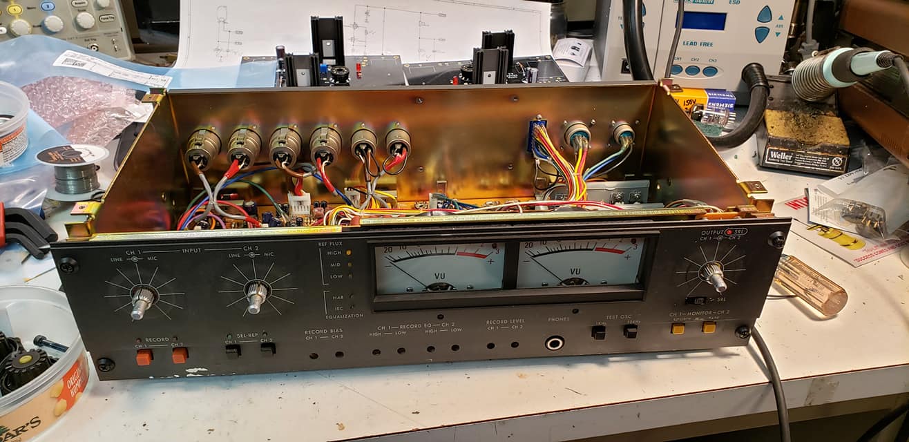

I have done a number of modifications to the MKIII-2 which basically removed the selsync/sound on sound option which I will never use. The significant change is removing the switching FETs directly in the head signal path. The same circuitry in the record path is jumpered.
Given the wholesale replacement of caps in the signal path plus the Saki heads it is hard to attribute the improvement just the mods, it's the sum of the changes to date.
In the stock, and tired machine the Saki heads made a very small difference.
Calibrating a deck to tape used for recording is sort of important, these machines can only be calibrated to one formulation at a time, whereas some of the late Studers like the A-810 can be calibrated to 2 different types.

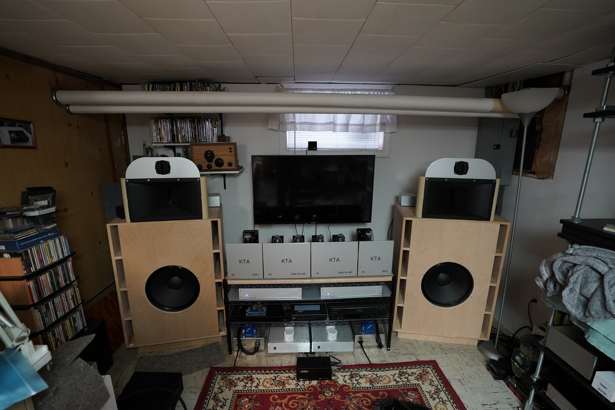

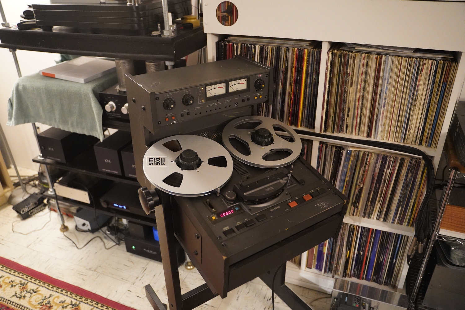

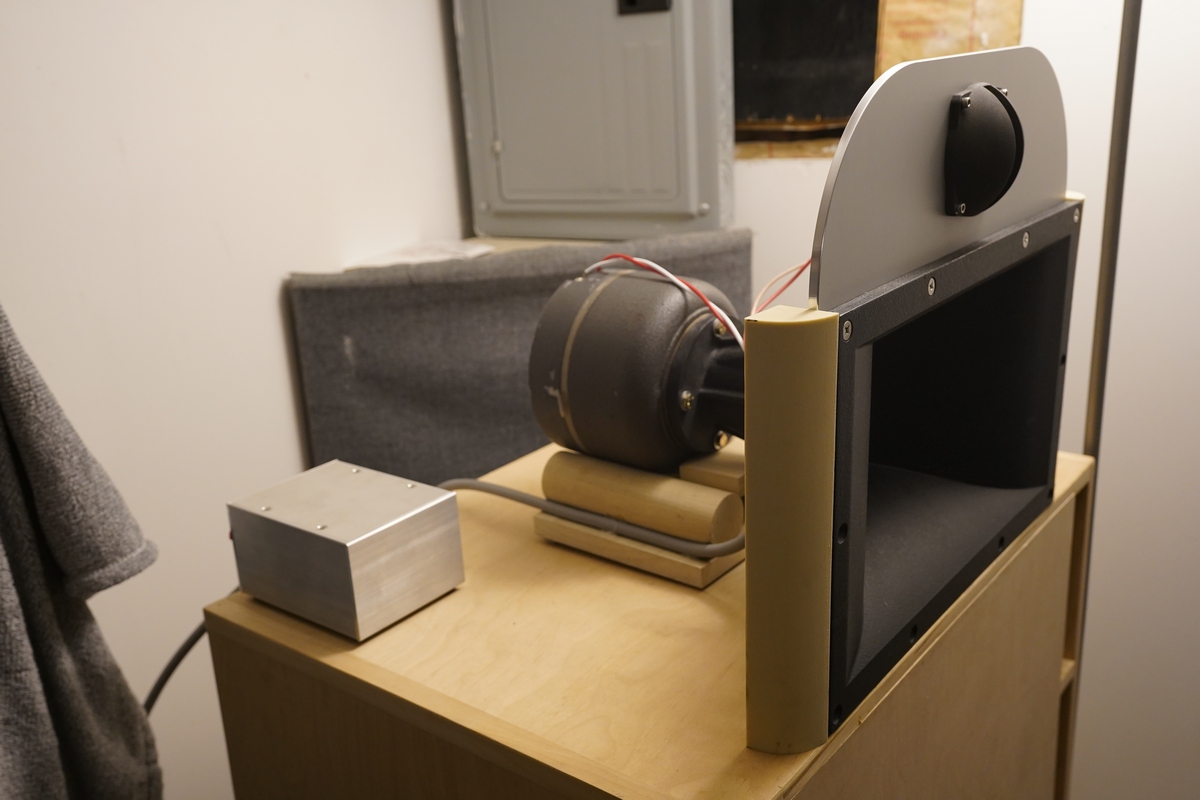

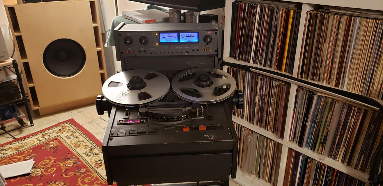

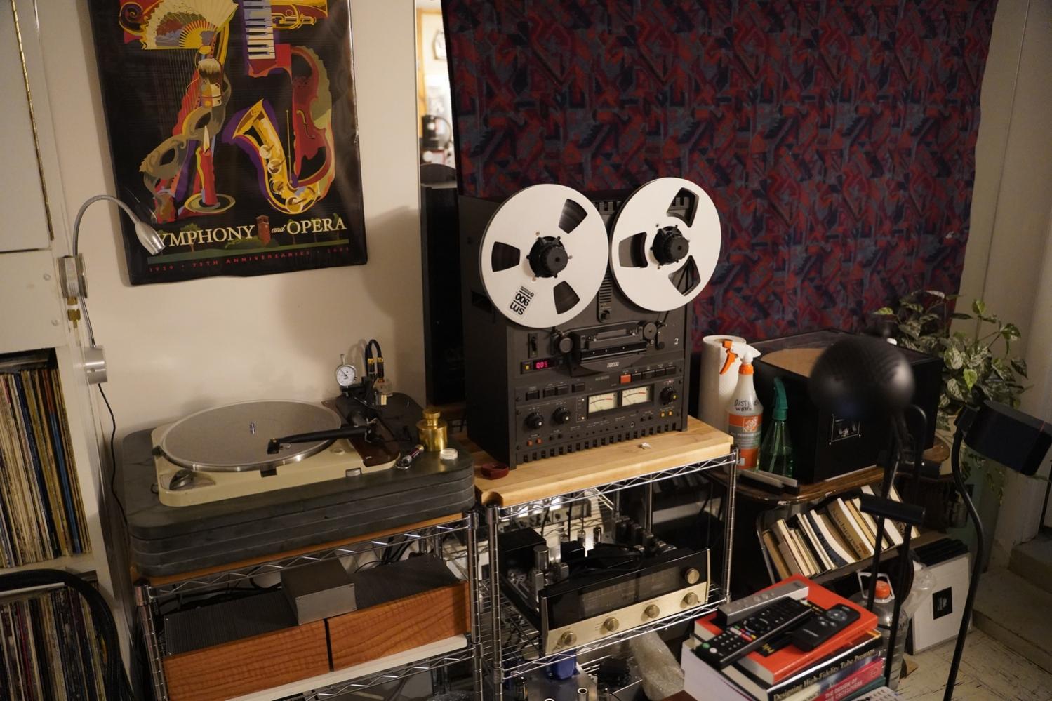

I assume you were asking me about my speakers? The system pictures are very out of date. There have never been Tannoys in this system, the bass bins are Onken diy cabinets with 16 inch Iconic 165-8G (AKA Altec 515-8G), mids are JBL 2440 on 2380A horns, and the highs are Fostex T825. Amps are of my own design and there is six channels of amplification, 3 way LR4 (24dB) electronic crossovers (also mine), room EQ is provided by a MiniDSP SHD. Signal interconnects are all balanced from the transformer coupled line stage (again one of mine..lol)
Tape is all on balanced I/O both for play and record.

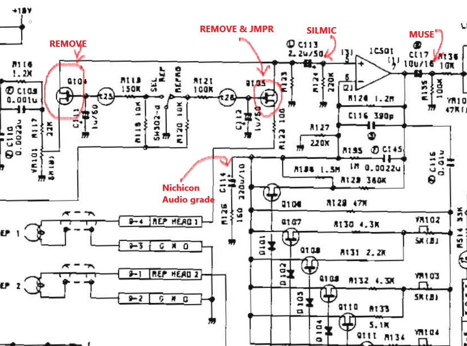

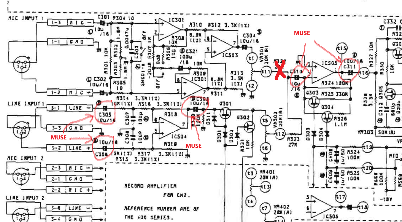

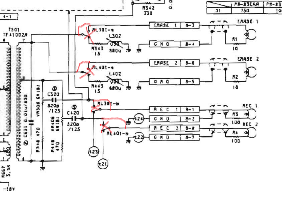

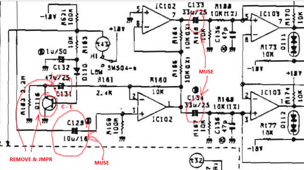

MKIII-2 Audio path mods
Chris asked me to share the mods I have done to date. In addition to the mods shown all of the electrolytics in the audio path plus supply bypass caps at minimum should be replaced. (Including ones not shown in my redlines.)
Basically this removes the SEL REP (sound on sound, etc.) feature. I would recommend removing the switch as well to prevent the possibility of it getting into the wrong position and preventing recording. (I jumpered mine)
The high/low output option can be deleted. I recommend the low option for most applications, if high is desired jumper across C-E Q116/Q216 once removed. (I prefer the high output option.)
These mods are not for the inexperienced, the PCB quality leaves something to be desired and lifted traces are possible if care is not exercised. Things are pretty tight.
Jumper Q105/Q205 outer pins (middle is the gate).
Note C131/C231 can and should be jumpered if Q116/Q216 are removed. (Gain is now fixed in the high output mode.)
The schematics for the MKIII-2 are widely available online.
