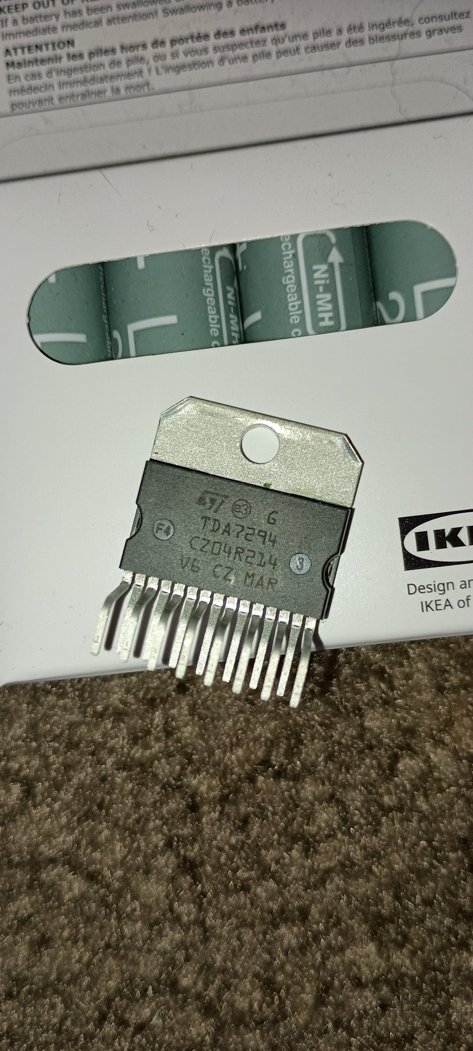

I bought a bunch of TDA7294 last year and give those pins supply + (24Vdc) and they do not blow. First time I built one up I did not include the 10k/22k resistors and they still worked. I later added those resistors.
My experience.
