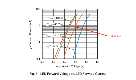

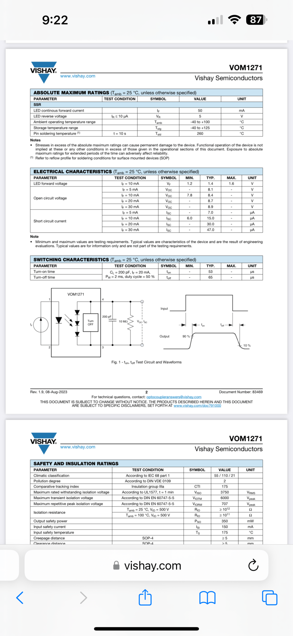

Yes, I saw that on the pcb but don't understand what it means. I'm looking for actual guidance on how to take the appropriate measurements.
Scott
since R15 and optos are in series, the current remains same thro all of them. so just measure voltage across R15. since it comes with 12VDC regulator, so 470 would be fine.

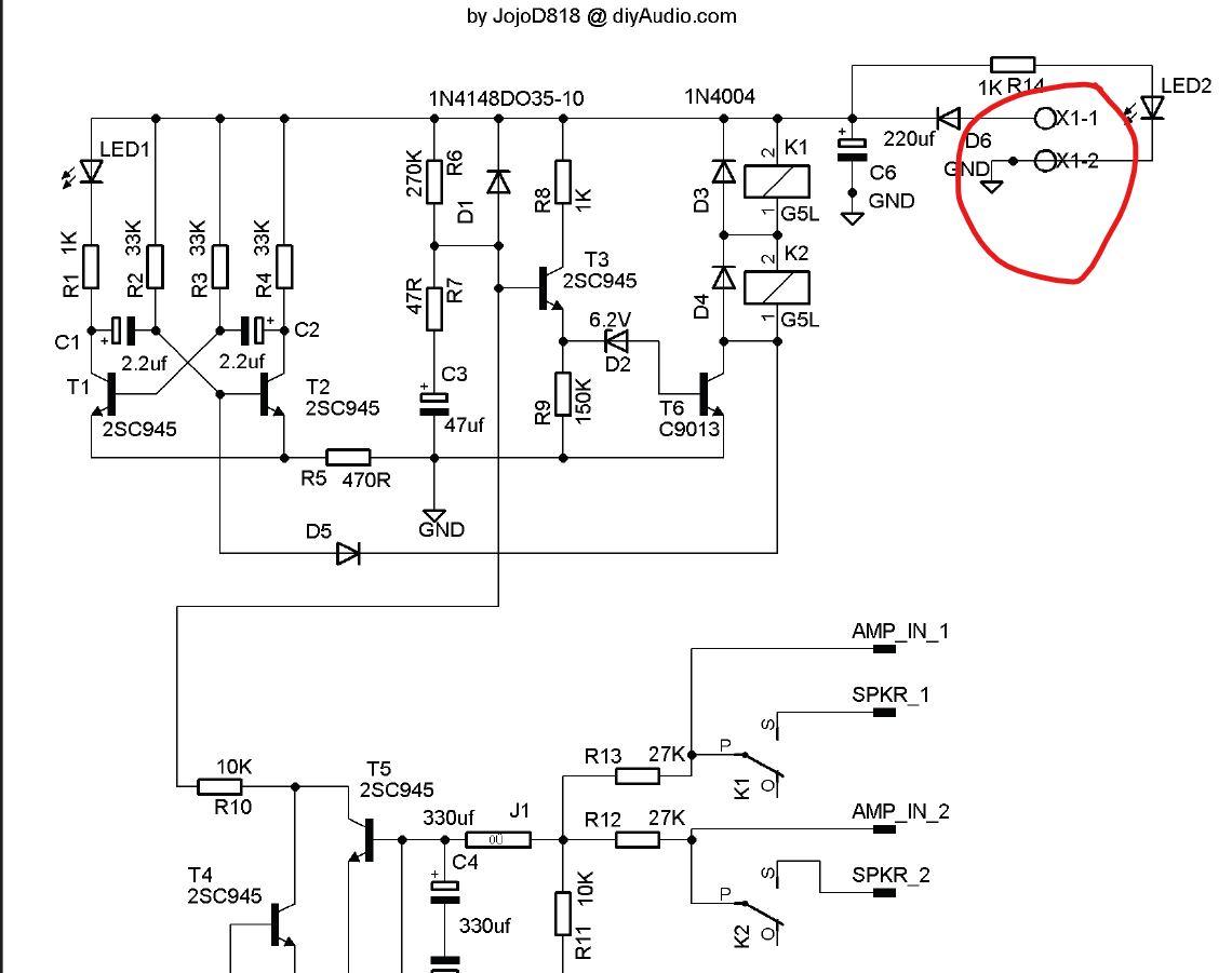

These questions relate to wiring up the V3 speaker protection board. I'm sure the answer is obvious to many, but as someone fairly new to this hobby, AC power still confuses me at times. I perused the current thread as well as the V2 thread but couldn't find a concrete explanation.
I have a dedicated antek transformer with dual secondaries for powering the V3 board. Because my mains voltage is 110 vac I have wired the primaries in parallel. I have also wired the secondaries in parallel.
The toroid is an Antek AN-0107 with 7 volts of output. The V3 has 5 volt coils installed.
1. Does my transformer have sufficient voltage for this application?
2. If I connect U1.1 to the PSU ground and one secondary of the Antek to U1.2; what do I do with the unused secondary of the Antek output?
Thanks in advance to anyone who has time to respond.
You need to measure the actual secondary voltage because at light loading it may well be higher. 7 volts AC will not really give enough rectified DC to operate the board and relays correctly. It would typically only generate around 9 volts DC.
So measure your actual secondary voltage to see what you are dealing with. Small transformers have very poor regulation and that works in your favour because lightly loaded the voltage could 10% or more higher.
Replacing the diode in the power supply with a low drop Schottky can also gain you a few hundred millivolts more... it all adds up.
If you have the secondaries in parallel then I am not following the 'unused secondary' part :)

Hi Mooly,
Thanks a bunch for your quick reply. I tested the outputs of the transformer earlier and was getting about 8.4 vac unloaded. I have no problem purchasing a transformer if necessary, I want to make sure I do this properly.
As far as the secondaries, there are two blue leads and two green leads. I have paired the blues and paired the greens. If I run the two blue leads to U1.2 what do I do with the two green leads? (My question was vague, sorry). U1.1 gets connected to PSU ground correct?
Administrator
Joined 2007
8.4 volts could be workable. If you use a Schottky rectifier you can expect around 11 volt DC as the main supply rail. That should work.
The circuit details I have show the X1-1 and X1-2 as the transformer input. It does not matter which way around you connect the transformer so lets say green to X1-1 and blue to X1-2. Doing that will power the board and the board and its power supply is now 'self contained' but at this point 'floating' and not referenced to the main amplifier.
Gnd which is X1-2 in the diagram connects to the main amplifier power supply ground. Doing that 'references' all voltages on the delay board to the main amp.
