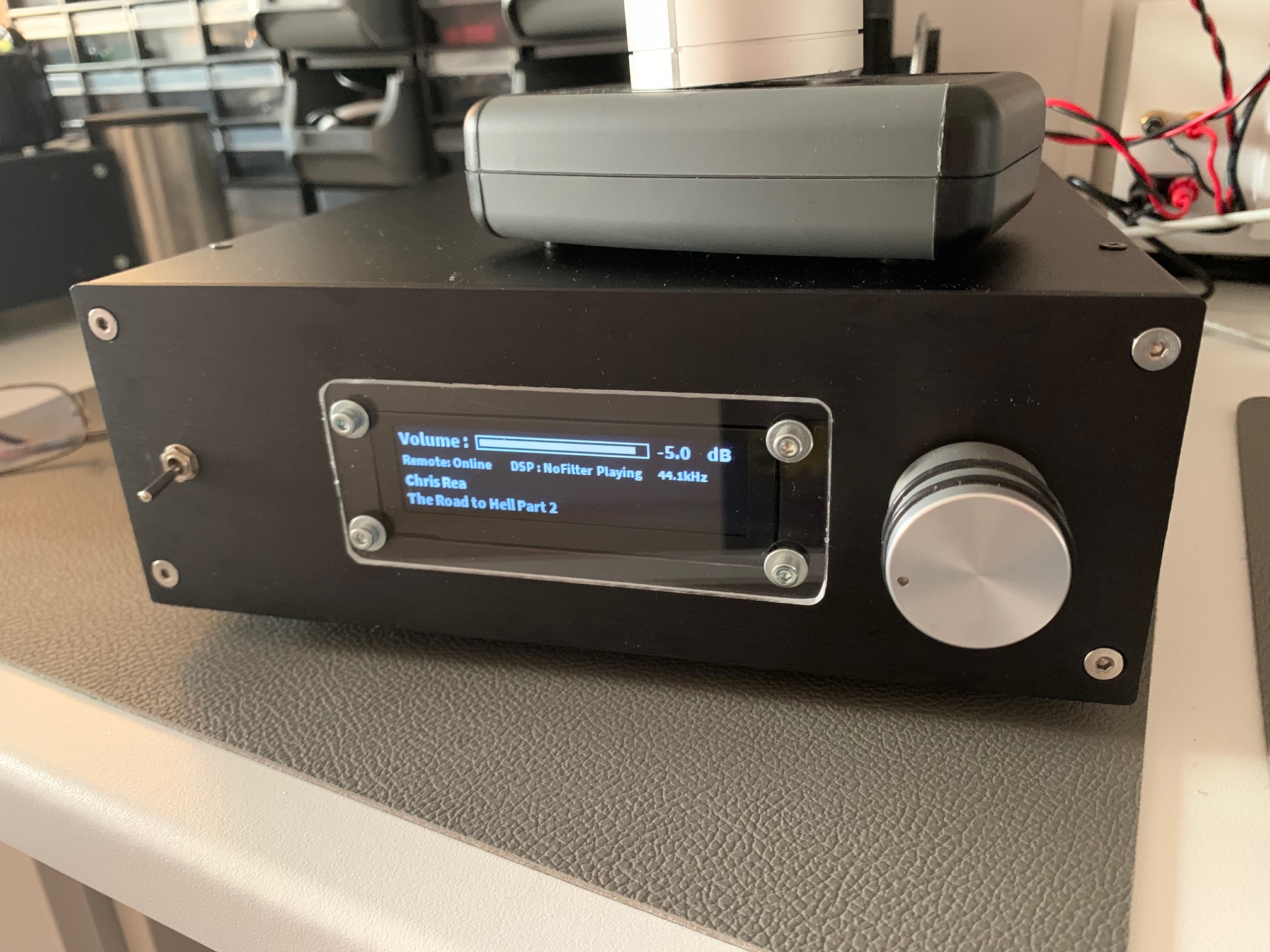

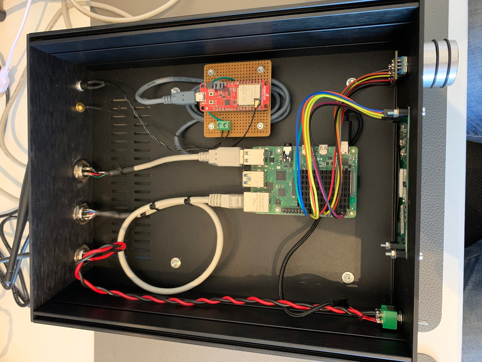

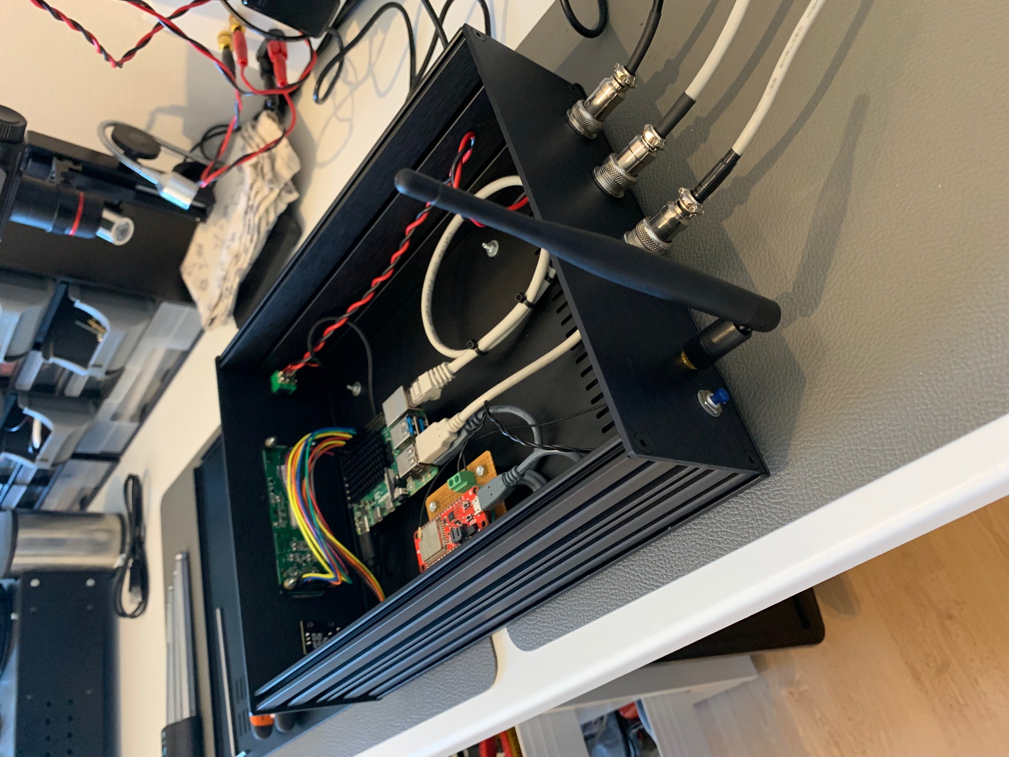

Hi here...
This thread is thank's to @TNT is also about the use of an remotecontroller (BLE / Bluetooth Low Energy)
I did have a lot of fun inventing this one.
If there are some interest, let me know.
A little "flashy" video of the use ;) SuperPlayer Remote Box - YouTube
Good weekend out there!
Jesper.

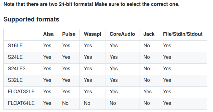

Depending on the DAC you use which is the playback device aka' "sound_out", try to adjust the "sound_out" format.
This can be tricky, as it's depending on the DAC hardware!
E.g. i use this for a little Chineese streamer i have
device: "sound_out"
format: S24LE3
devices:
samplerate: <<sample_rate>>
chunksize: <<chunk_size>>
queuelimit: 1
capture:
type: File
channels: 2
filename: "/dev/stdin"
format: S32LE
playback:
type: ALSA
channels: 2
device: "sound_out"
format: S32LE
There are a lot of options for output setting see here : Link!
