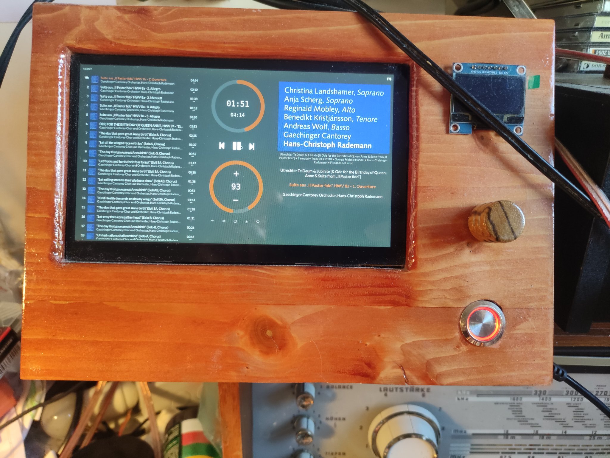

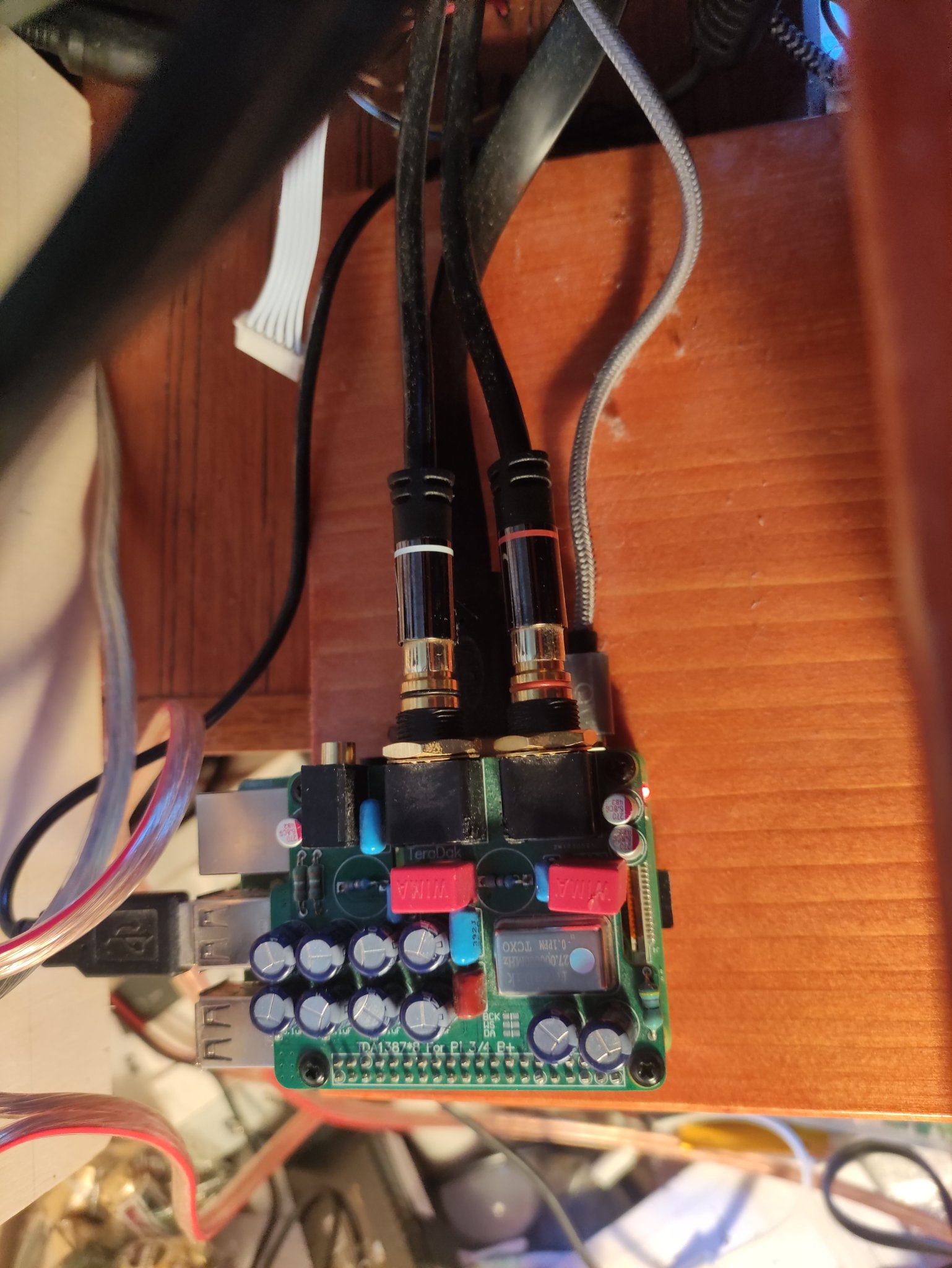

Had time to experiment a little.
With resistors in place of inductors, the hiss is really really better. Measured R of inductors, ca. 28 Ohm, so used 22R.
Some hiss remains, however is more than tolerable.
It is only on right channel, which output is right above the rasp power in.
It looks like in picture attached:
It's tremendous, I know, I need some shielding, but how to fit in this "chassis"?
