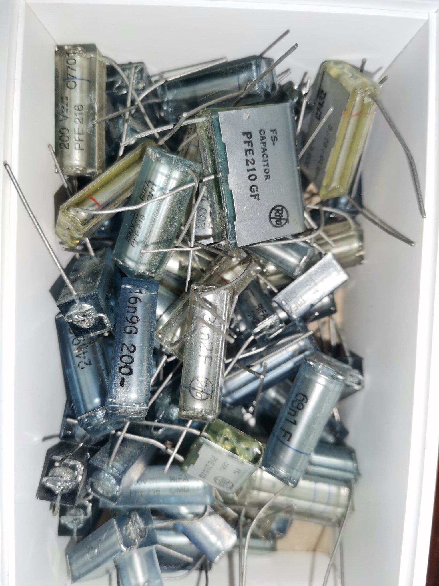

Teflon caps for RIAA?
What value and properties does your RIAA circuit actually require for this position?
Addendum: That thing is going to serve as an antenna in an RIAA network's feedback loop. Try to stick to flat stacked types and keep leads short.
Reactions: 1 user
That's huge, larger caps can pick up more hum/noise from the surroundings. Its also a pretty large value for an RIAA network, usually the values come out somewhere in the 3 to 30nF range for the main poles and zeroes - I've done it with 3n3 and 12n for instance, 330nF seems a suboptimal choice to me, that feels more like a value for a rumble filter where the poles are around 15Hz... Beware of self-inductance too as the RIAA network needs to work nicely upto 20kHz, even for the 50Hz components.
I am currently using a 22nF Russian teflon and want to experiment with larger values to get the impedances down. The 2122 Hz pole uses a 680pF Russian teflon, replacing a polystyrene type. The teflon sounded significantly more detailed and cleaner IMO. I haven't necessarily decided on the 0.33uF, rather perhaps the 0.1 or the 0.22uF value (cost doesn't reduce significantly though). Any thoughts by anyone on using COG/NPO capacitors?
The hum/noise issue hasn't been completely worked out yet. The moving coil head amp is an enclosed battery powered unit with slightly more noise, with the phono network adding a slight amount of hum. This is currently an open air breadboarded thingy with poor power supplies as of yet. This is being tested feeding a Topping PA-5 class D amplifier fairly well reviewed by ASR.

put them on a good analyzer and see that they stop acting like good caps at a much lower frquency than same value polystyrene....
... which is what i'd recommend that you use instead. spend that money on some hard to get JFETs or something!
the rel cap that wntrmute2 mentions is a good one to use and it's much cheaper.
Reactions: 1 user
Rifa Pfe 1% polystyrene, if you can find them I believe they will not disappoint you for Riaa or any other signal filter job.
Reactions: 1 user
I have used all manner of caps, though no Rel-Cap RTE's or COG/NPO's. The caps used in the past (over the past 30 years or so) included Wima FKP's and MKP's, Rifa polystyrene's and a host of others I can't remember. The Russian teflon's were the most analytic, though being to a large degree sterile sounding. My suspicion is that they reveal circuit issues as opposed to mitigating them, hence can require voicing the network as a whole. IMO there is nothing wrong with this as that is my plan in the end (by whatever means) anyway.

Find some styrene caps 1/100th of the price and 99% as good, probably better due to compact size and ability to cherry pick matching values.
You can also use a value that's a bit too small in a capacitor's position and then trim it up to spec by paralleling smaller ones, since the caps come in lots of pF sizes suitable for use in trimming.
