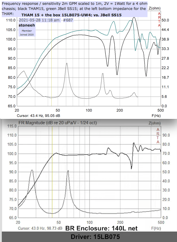

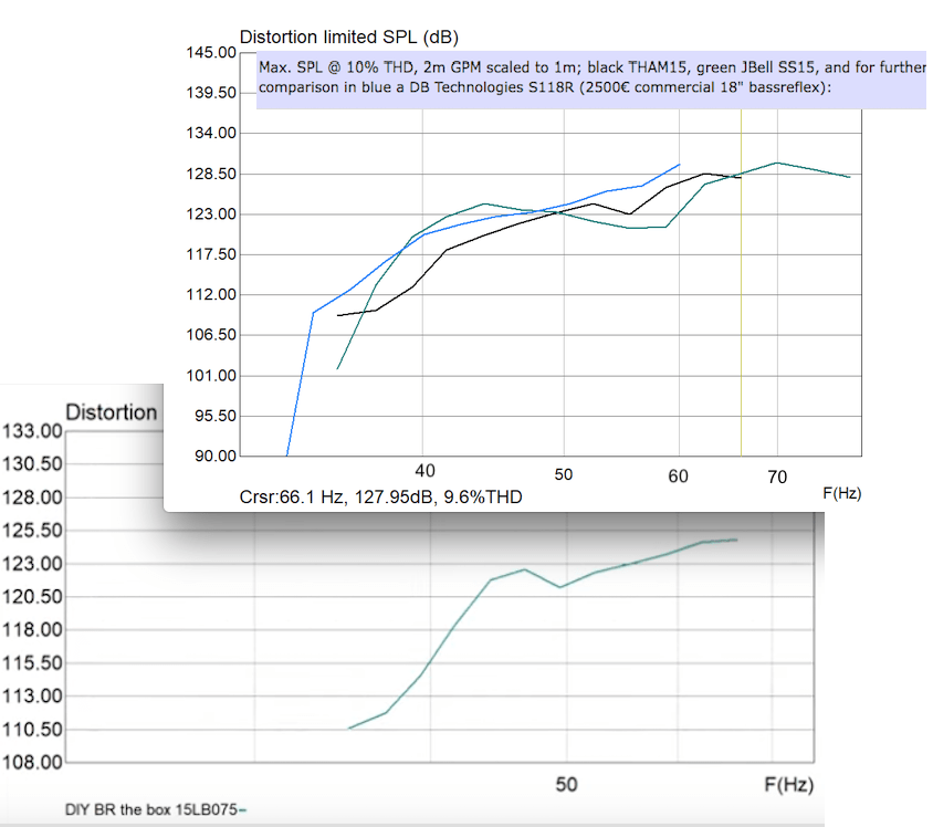

Stoneeh's tests using the same driver (15LB075) in a 140L net bass reflex box with the same Fb (43Hz) as the Tham show the BR sensitivity almost +4dB @ 43Hz, the Tham only+2dB at 100Hz.
The larger JBell SS15 is the same sensitivity as the BR at 43Hz, and about +5dB at 100Hz.
10% distortion limited output for the BR, Tham and SS15 are similar, the SS15 ahead by +3-4dB other than 50-66Hz range:
The 15LB075 driver Xmax is only 4mm, so one could expect more output from a driver with more linear excursion, but that would apply to all the different cabinet types.

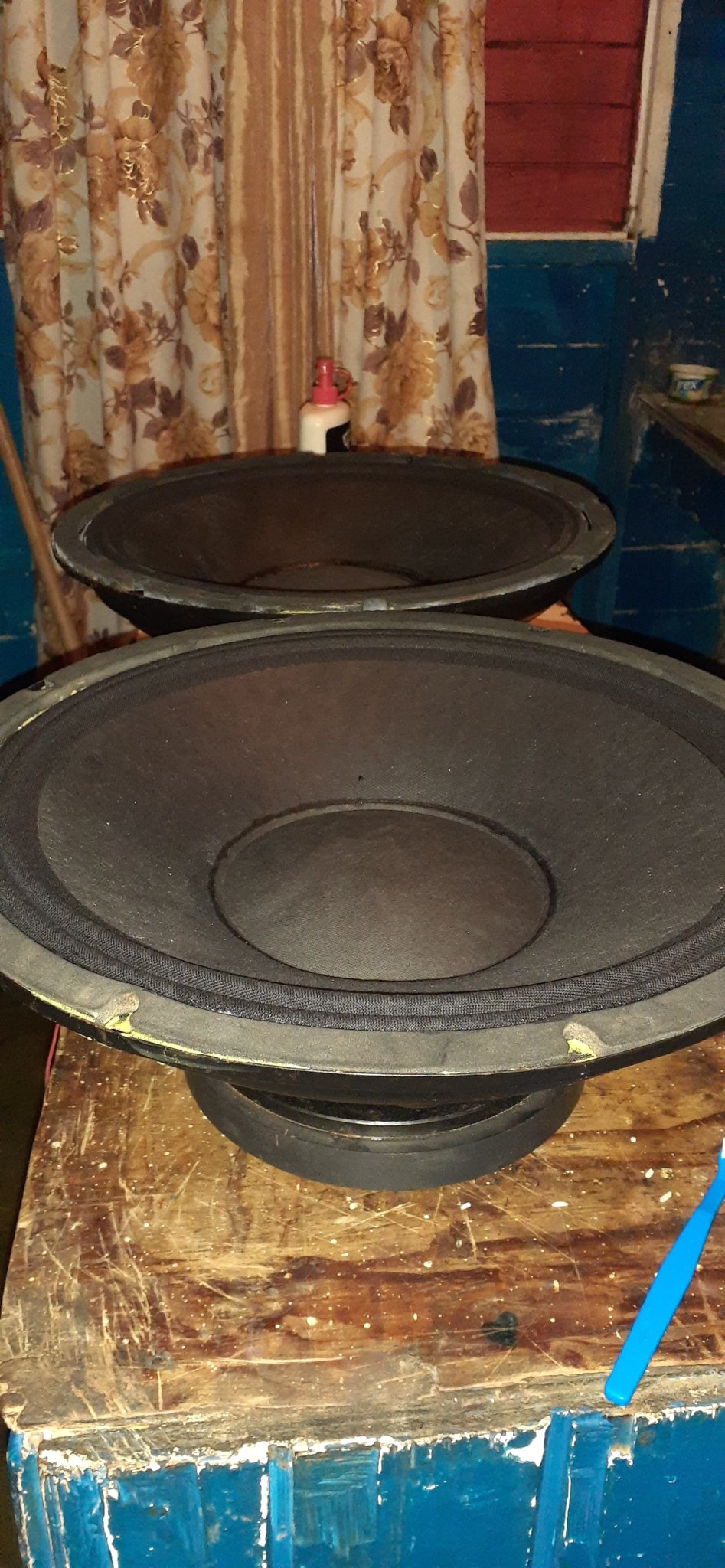

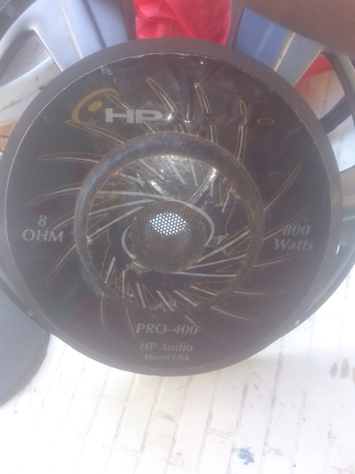

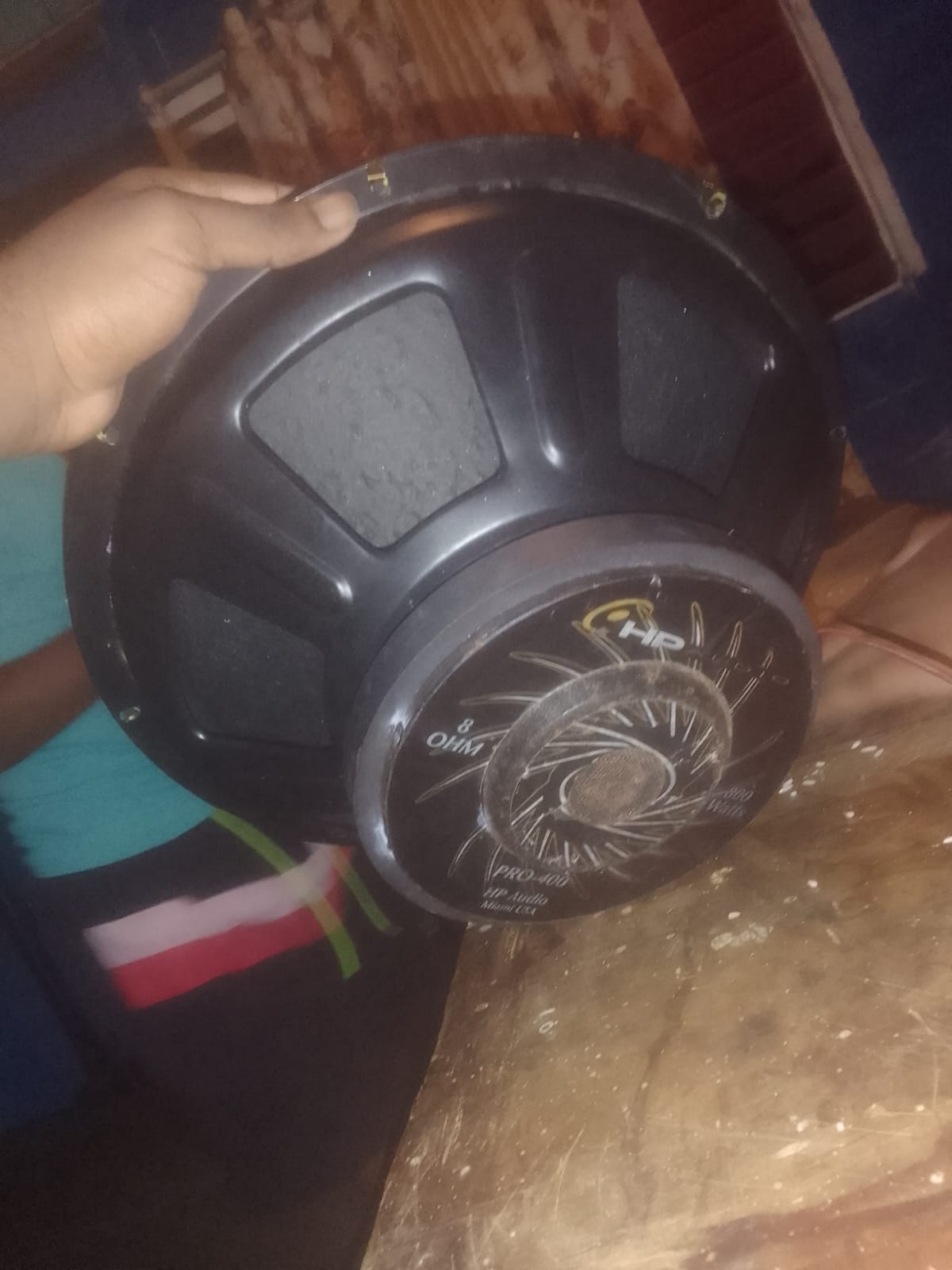

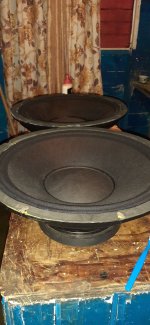

Hey guys I took a pic of the back of my subs when I was reconing them today.

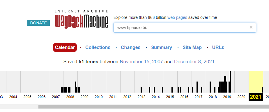

I had a quick look, and found this trail of breadcrumbs...
Product catalogue excerpt, that references hpaudio.biz: https://literature.puertoricosupplier.com/039/PC39057.pdf
Using the Wayback machine that shows the site was last maintained in 2008 - later entries are just the domain listed for sale: https://web.archive.org/web/20211101000000*/www.hpaudio.biz
Doesn't look like there's much info out there...

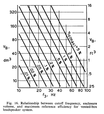

Coincidentally I was playing in HornResp last night, modelling the THAM15 and larger variants (pushing dimensions to 50w x 60d x 75h to better suit my needs), and thought it'd be an idea to do some "due diligence" and model a reflex box of similar to sense check my ideas. This is all anecdotal since I didn't save the files or capture screenshots.
The THAM15 and resized variants were very sensitive to driver inputs, as expected the design wants a specific range of T/S specs to perform optimally.
I'd selected an "ideal" 15" driver to reference in the resized THAM, and compared a fairly affordable 18" driver in the reflex of same volume, and found there wasn't much difference in the plotted outputs for the same power input, with both of them tracking low frequency response within a few dB - very surprising!
Of course it's not quite like-for-like given the larger driver in reflex, but also note the 18" driver is cheaper and lighter than the "ideal" 15" driver to suit THAM and reflex is a simpler build with more tolerance for variance in T/S specs.
Something to consider, that follows what weltersys was suggesting - perhaps a redesigned reflex box will give you more output from your current drivers.
It'll be a safer bet than putting an unknown quantity in a tapped horn design that wants a driver of a specific spec.
Not really, box size sets low corner limit. ;)
