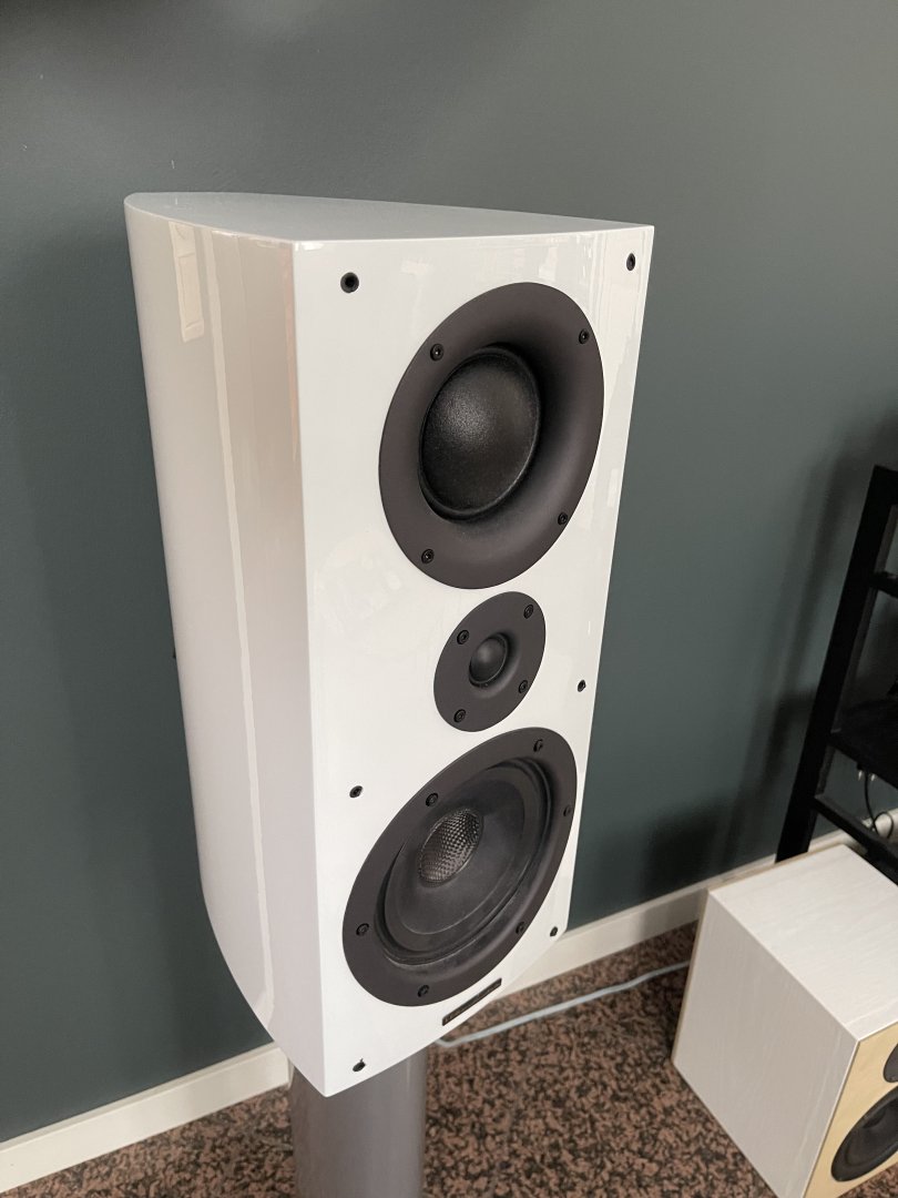

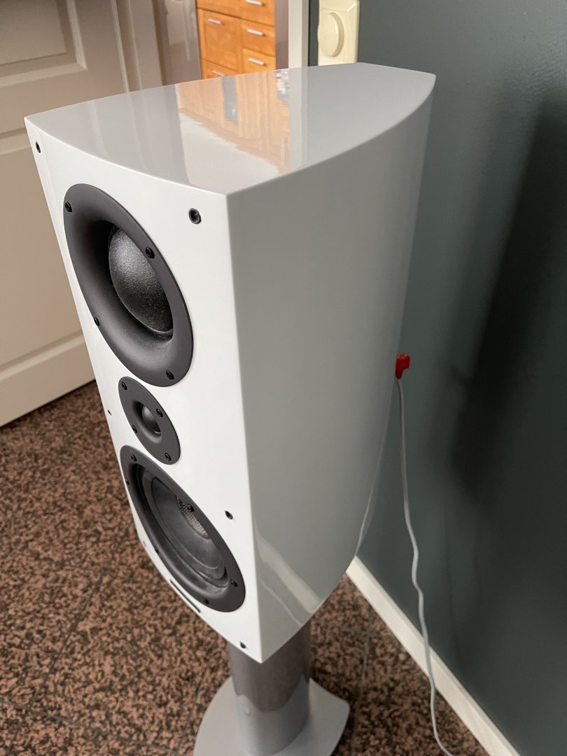

Question: Wharfedale opus M 1
I have change to get this quite cheap locally, so:
Thing is, what is that middome? Vifa? Scanspeak?
Does Wharfedale make their own drivers completely or source some of those outside?

Application note changes a lot, thanks. Interesting option for a pricey 3 way :LOL:
The behaviour of M142 is very typical for drivers without back chamber. The speaker designer has to take care - as with some AMTs, Vifa 3" or when you remove back chamber of MD60N. You have to take care about the rear SPL.
On the other side - I find the backside frequency response quite interesting! Starts at 95dBSpl and rises, very wide sound distribution up to about 1,5-1,8kHz. Combined with a T34 ... and a few 12" ... You could probably even use it as horn driver ...
