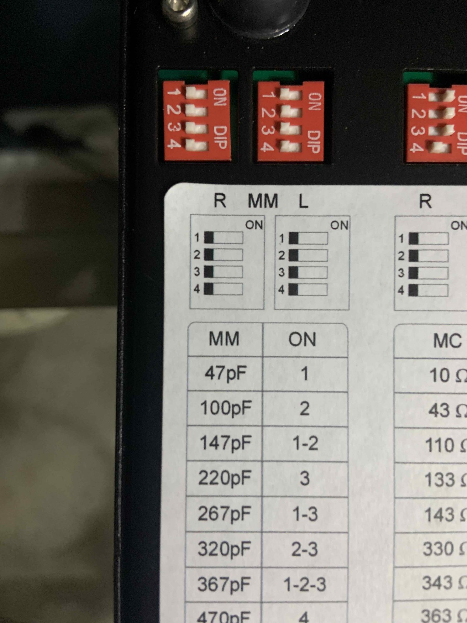

Everything seems quite straight forward apart from the (DIN?) switches at the bottom which adjusts the capacitance and is a bit confusing to my simple mind.
There are various MM settings suitable for my Goldring E3 cart which has a load capacitance of 100 - 200pf (according to the website). The phono stage offers either 100 or 147pf in that range and then many more both higher or lower.
Which of these settings do you think is better and if I was to go for a higher / lower capacitance on the phone stage, what would the effects (sonically or otherwise)be?
Hope you can help?
Thanks (again)! So what I don't get is that there are 2 sets of Din switches and the grid says '2'.
Does that mean I have to put both switches to 2? Is one for each channel or something else (and why would you need to be able to have each channel set differently anyway?!)

Yes, there's one column of switches per channel.
So try switching on either 47pF (1) or 100pF (2) in each channel,
using whichever setting you prefer the sound of.
Unless you have a capacitance meter to measure the turntable leads,
just adjust by listening preference.
These small switches are only made as SPST types, which can only make or break one contact.
So you need one switch per channel.
