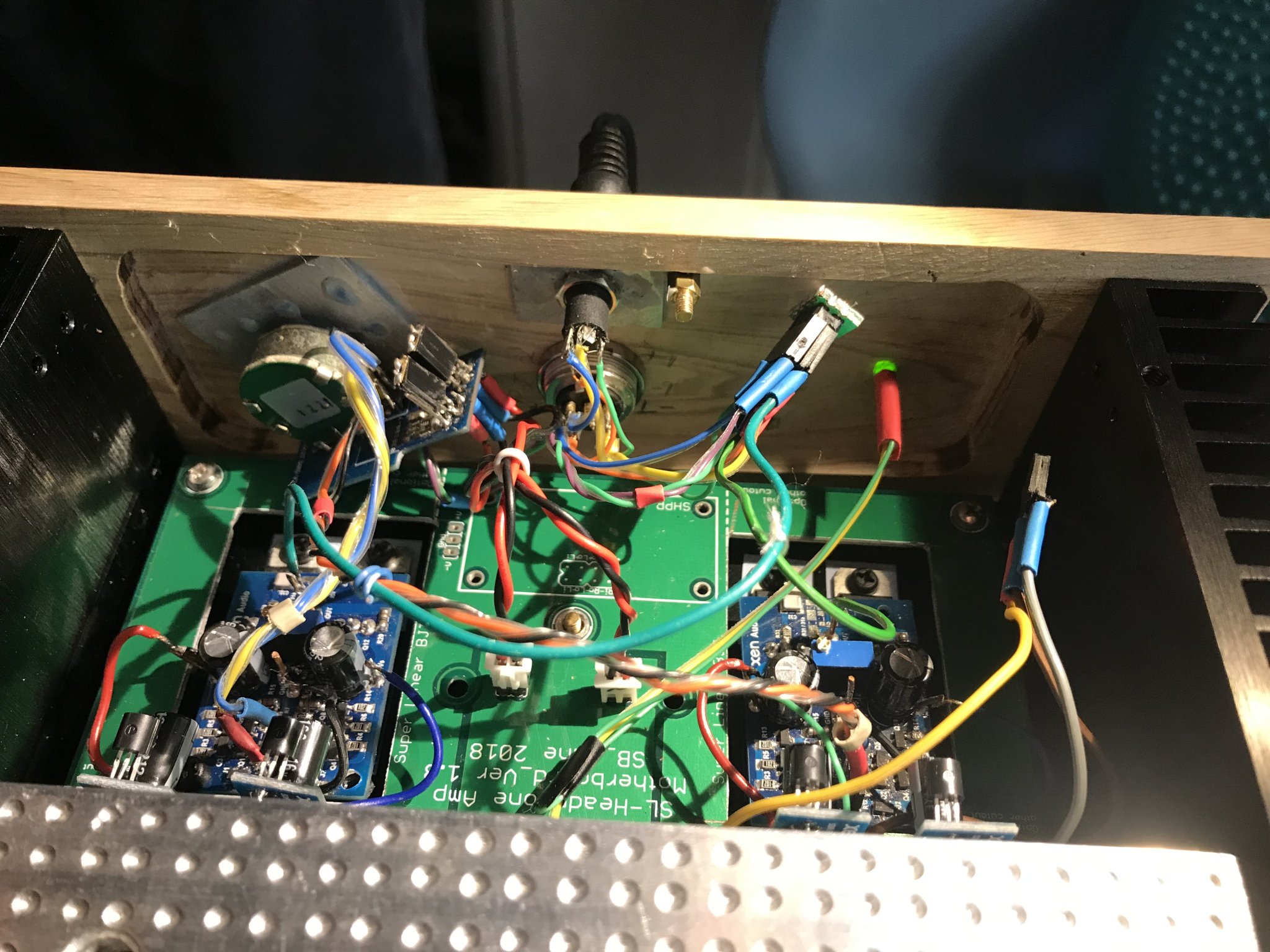

Replaced C2 with 10uF (can I leave X7R there or is it much better to reorder the original Panasonic - you had it there for a reason I suppose) for the time being and inserted 5k trimmer (this is what I had in my drawer, I had 10k originally but it was not multiturn, this thing is very delicate so I wanted to use multiturn after all)

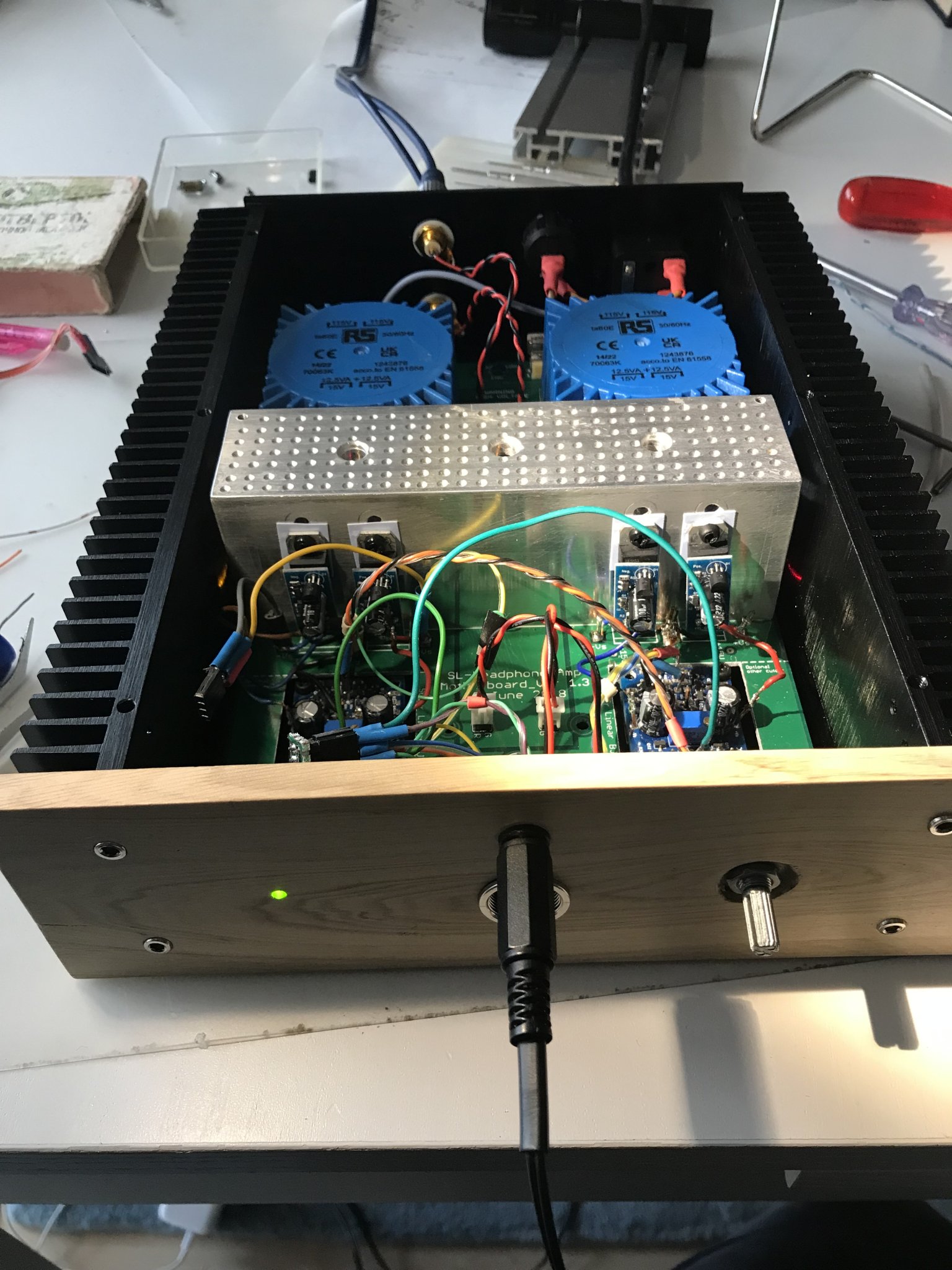

I can now turn on the output stage and control the current.
I have set it up at 160mA, I see 35mV offset at the output. (my build does not have servo yet- hopefully never; I forgot to remove servo from the LSpice simulation - for a moment I could not reconcile spice with my build...)
I am pretty sure Patrick has already given up on me regarding SLHPA.
I bought PCBs from Patrick before Covid. To my excuse I can say that the DigiKey parcel with all component arrived at my office one day after I started working from home in the first lockdown.
Meanwhile I have built UTHAiM so I kept myself busy and less motivated given how nice UTHAiM.

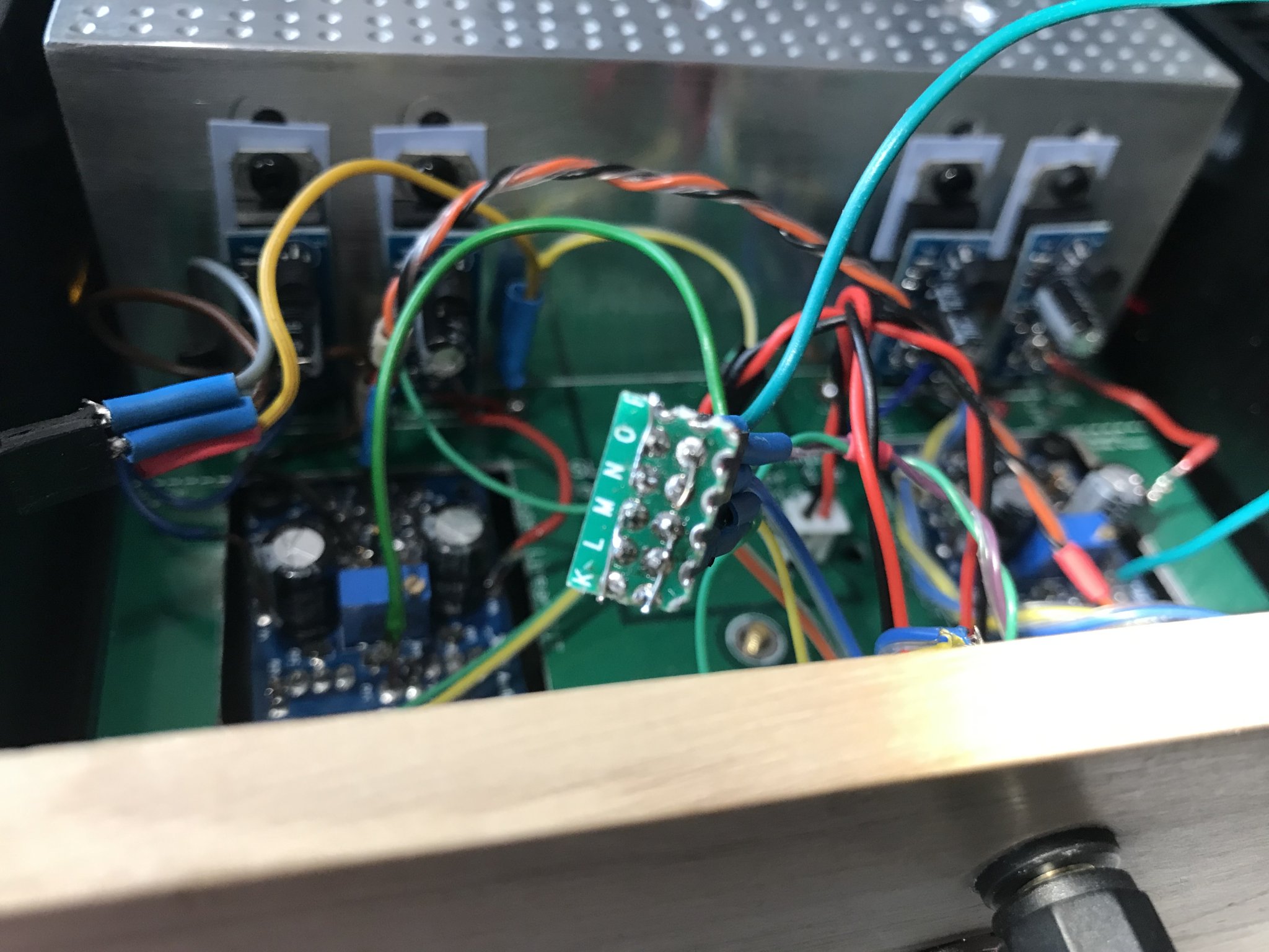

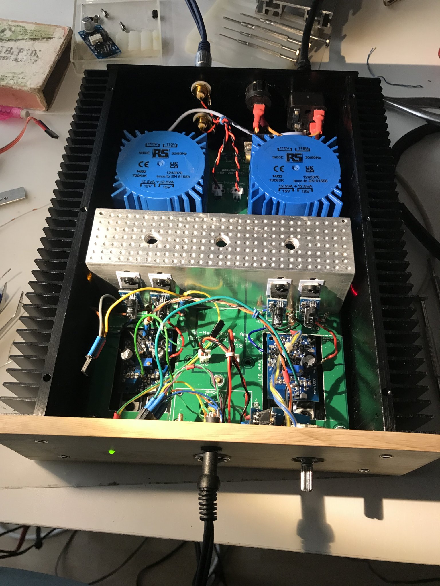

Anyway here it is (one problem - I've blown the protection circuit in the final assembly - I connected the power supply to the protection circuit in reverse - I was very careful during the whole build, checked and rechecked everything, bought a dual lab PS with current limit to test (it saved my life a few times) and then it takes just one brain fart and puff - I guess the op amp is gone and maybe other things)
So, no protection for some time. The offset in one channel is 2-4mV and 10-12mV in the other (I need to look at this channel again, but I can live with 10-12mV offset for now).

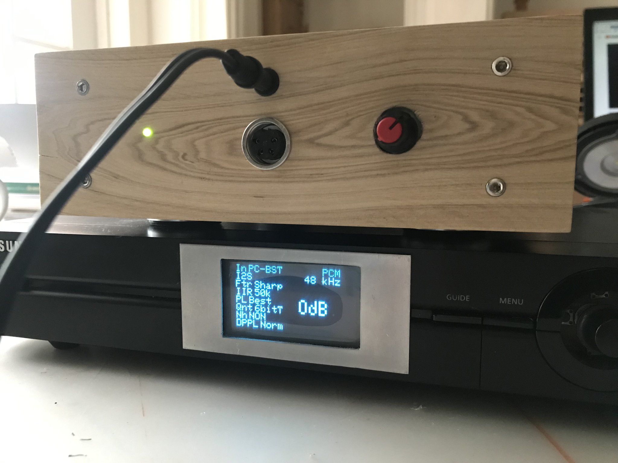

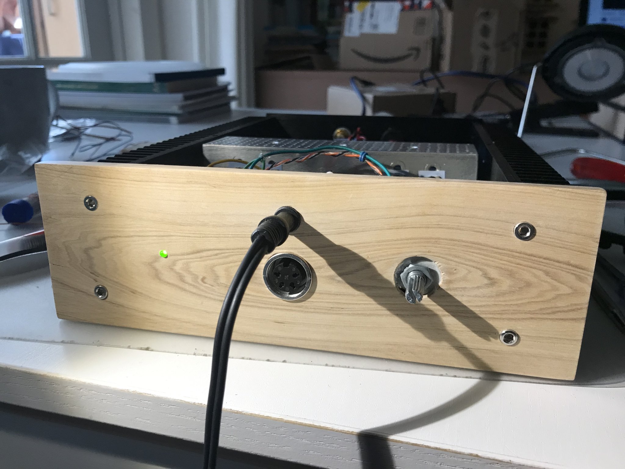

(please do not comment on the volume knob - can't remember where I put the one I actually want to use).

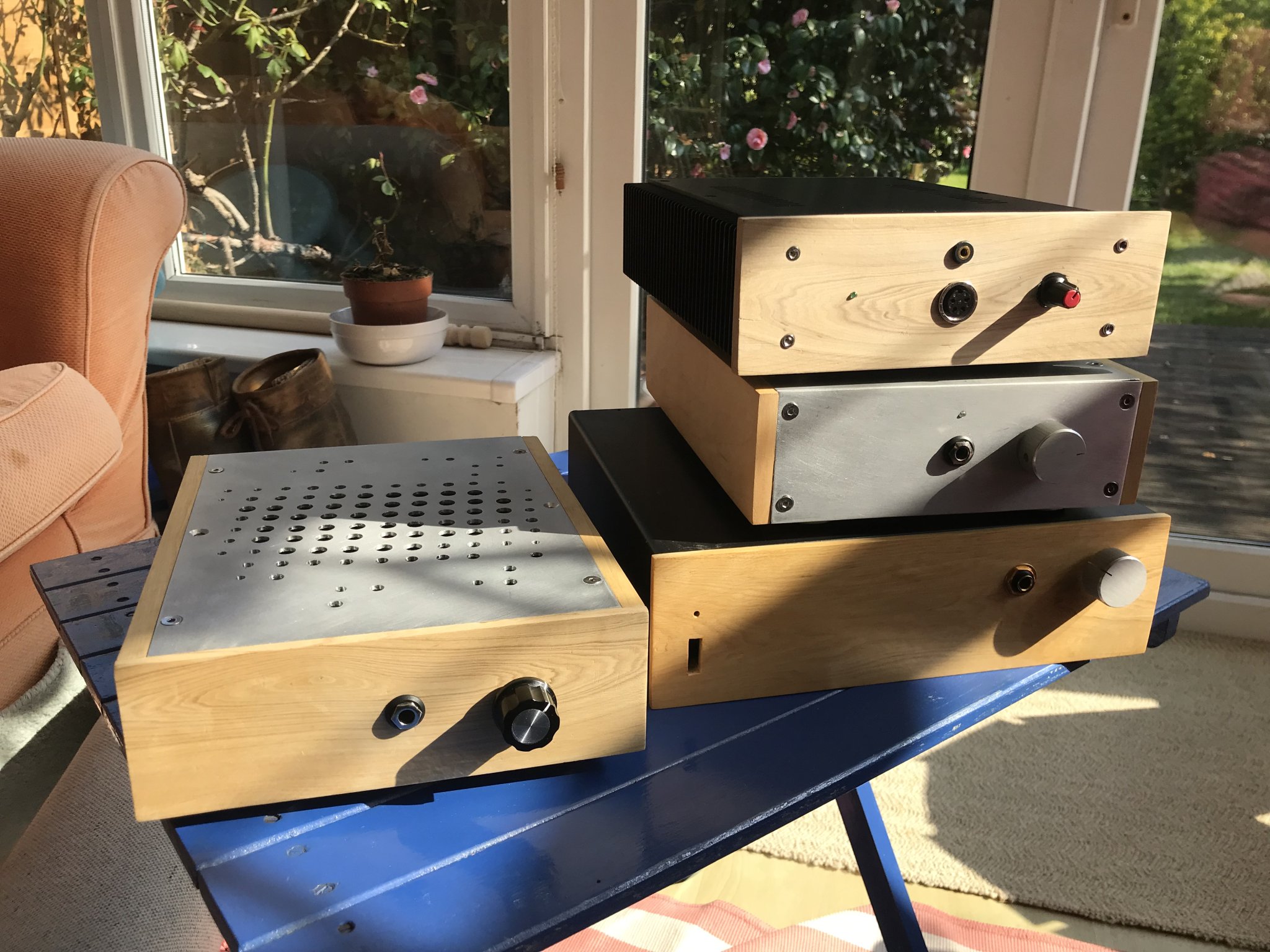

I replaced the alu front panel with the wooden one - it was meant to be a prototype before I drill the one supplied with the chassis. But in fact I like it this way.

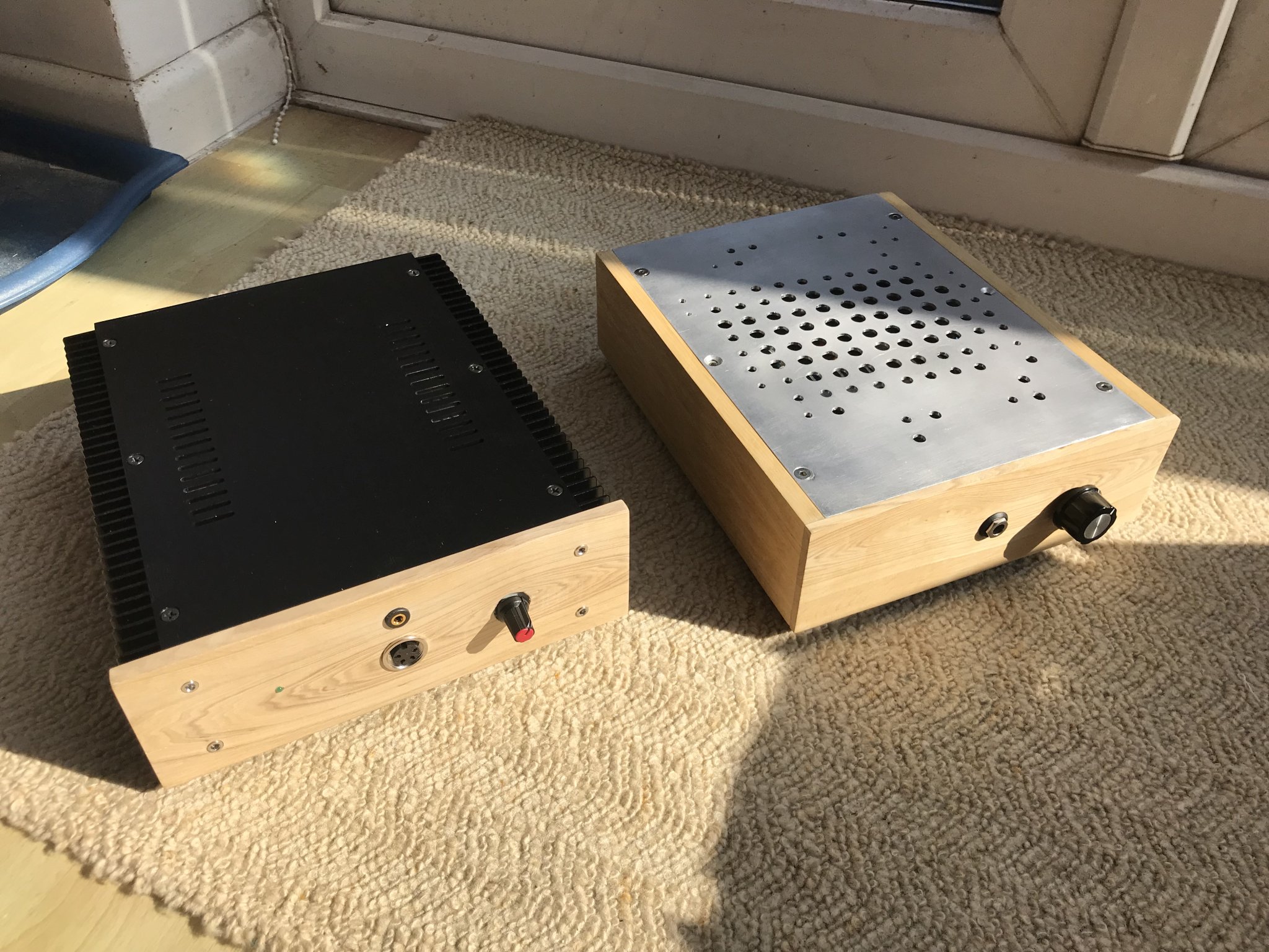

Regarding SLHPA and UTHAiM they sound similar and great. In my case probably the diff comes from different xfeed in each of them. I like they xfeed with values in the SLHPA doc so I will make a copy for UTHAiM and compare more. Also SLHPA is dual mono with Patrick's regulators. My UTHAiM has one transformer and dual PSs down the line with capacitance multipliers.
Did I say SLHPA sounds great? Yes it does! Thanks Patrick!

I am sure you can improve the wiring. :geek:
See photos of my build.
For temporary protection, just use an output coupling cap.
e.g. Panasonic ECE-A1EN102U // WIMA MKS2 10µ

I am not happy with the wiring myself, but I am struggling as too short wires make it difficult to assemble disassemble in the early stages.
Also I see that your motherboard has lots of paths which make wiring easier or redundant.
