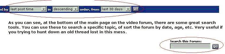

The number one rule to this forum?
Search First, Then Post!
Nearly every idea people think up has been talked about before on the boards! Simply by searching the forum with a key word using the search box at the bottom of the main video topic page will give you tons of specific threads on the topic. One of the contributing factors as to why this forum is so jumbled is because it is very crowded with repeat posts. I would kill to have the opportunity to go through this entire board and organize everything into sub categories and delete the trash sort of speak.

Remember! Search the forum first!
