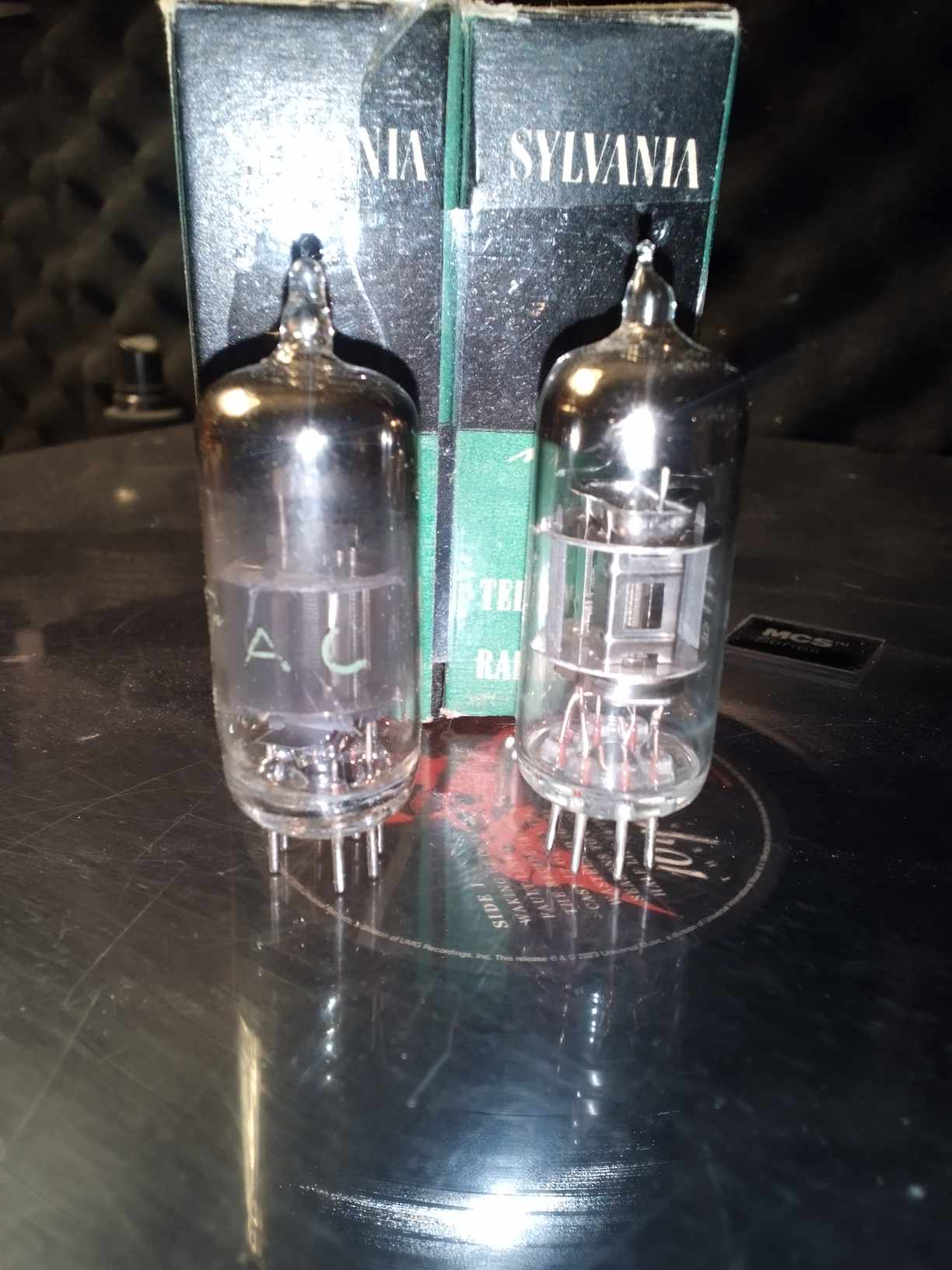

The green/blk box sylvania 6ag5 with the dark carbonized glass are absolute gems in a line stage. Every time i compare it to other 6ag5, or really any other kind of tubes i have now they re-blow me away. I've been combing ebay for them for a bit now, have bought several matched pairs now too, and they are all in an entirely different league then anything else i have when it comes to soundstage presentation. even my 12ax7 circuits feel flat and dull to me now that ive gotten used to these little TV tubes. Im only running barely over 100v across the plates. They no joke feel twice as big in every direction as any other tubes i have. Some of you older tube and radio guys may have em lying around too maybe. Thats how i got my first box em them. Wish it had more of these one's though lol.
As triode > pentode as well for audio. More gain (if you need it), less THD, and a sounstagier soundstage (lol)

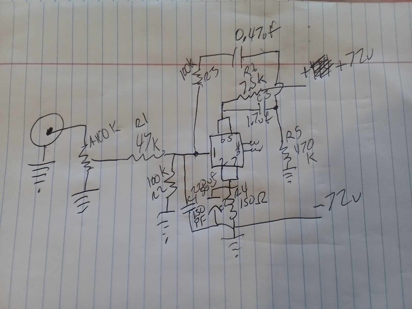

The linestage design im using is attached because why not. Forgot to draw the output off the coupling cap, but whatever lol.
Tube pic just to show what i mean by dark glass. They arent used. All the old green/blk box sylvania 6ag5 tv/radio tubes look like this. All have carbonized glass, but some have black plates some dont. They all sound unreal though. Some of the yellow box sylvania 6ag5 have crbonized glass, some dont, i havent tried any of them yet but have some on the way.

Only my view; Generally, I found Syvania video line tubes often rather noisy; partition noise in pentode & microphonic for audio. Currently, I am using the 12BY7/HG7 (have loads of them) as audio diff drivers and had to spend several evenings sorting out to get reasonably matched pairs (best set up as triodes, nice with 25dB gain). After much sorting found the Philips ECG version the most consistent performers. GE did also well, but RCA and other brands were rather noisy and microphonic. But makers for these didn´t stipulate these types to be used for audio, so didn´t strive for min noise & mictrophony in the 1950´´sand 60´s TV market, unlike the later ECC8xx series specifically for the audio market end product.. What I have found that tubes for TV (often having larger cathodes) are best run at somewhat higher currents than other types, as after several days stabilizes the characteristics.

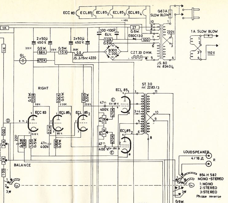

On the subject of TV triode/pentodes, I just bought a B&O 608 amplifier and it uses ECL85 (6GV8) as the driver/output tubes and it sounds great! I can't see any problem switching to PCL85 (18GV8), or even E/PCL805, and they are all cheap and readily available here....
My thought was to build a nice full featured practice amp using nothing but 6KR8’s. And call it the “Crate”. Not a single IC amp to be found, though. For hi-fi, though go the the 6KV8 because of the pretty triode. Same price, still loads to be had. I’m using those in a hi-fi preamp in development, with the KV8’s being the output balanced low-z drivers. ...
If there weren't this unconvenient (at least for the biggest part of the whole wide world ) 10 pin base and the lack of JEDEC equivalents, I'd also recommend the E/PCL200: Triode absolutely the same as EC92 or half a 12AT7, power pentode comparable with EL95, but with ultra high (~22 mA/V) transconductance. Designed to drive CRT cathodes directly (= video output pentode). Could be seen as a triplet in European colour TV's up to the 1960ies end.
Best regards!
Btw: Absolutely cool B&O 608 design above! Now we should know the OT's turns ratios... And correct, especially the PCL805 is a very rugged tube!
