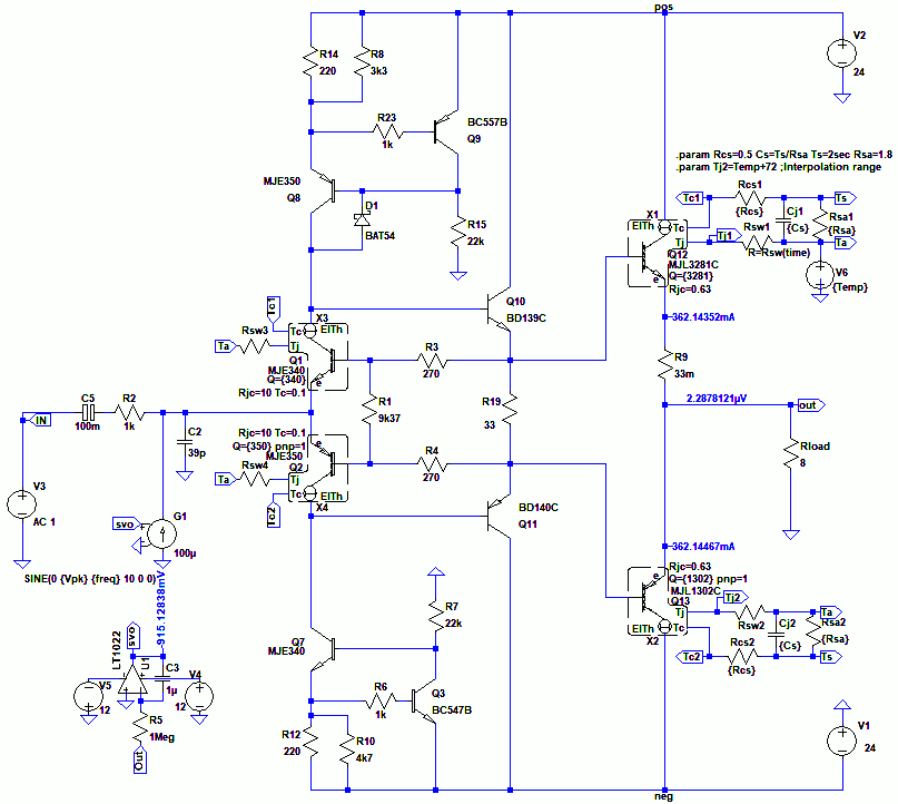

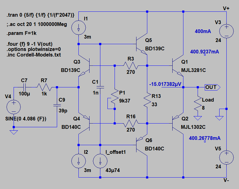

Hi Ian,
On Bipolar output, it seems we can also directly use Vbe of the power transistor as feedback to the spreader.
Hi indra1,
Yes, that is about the simplest that works well as long as Q3 is thermally coupled to Q1 (and Q4 to Q2).
And it works without emitter degeneration resistors. I did not try that option in my earlier ramblings. Thanks for suggesting it.
I found the optimum thermal attenuation is 0.7 which means Q3 and Q4 at the case temperature of Q1 and Q2.
This can be achieved using spreader plates under Q1 and Q2 with Q3 and Q4 on the plates with their thermal washers and then large area custom thermal washers under the thermal plates to the heatsink.
At high frequencies the crossover current falls away above 500kHz at full output which is ideal to stop cross-conduction (which can overheat and destroy an amp if it continues long enough). The slew rate limits at about 30V/us allowing safe operation to 200kHz. Clip recovery is improved with a Schottky in the top rail CCS (see attached). Also I added a servo to null out the input offset (it would normally inject to the input stage -- I assume you will add one sometime).
  • indra1-Simple-BJT-servo-MJL3281.zip

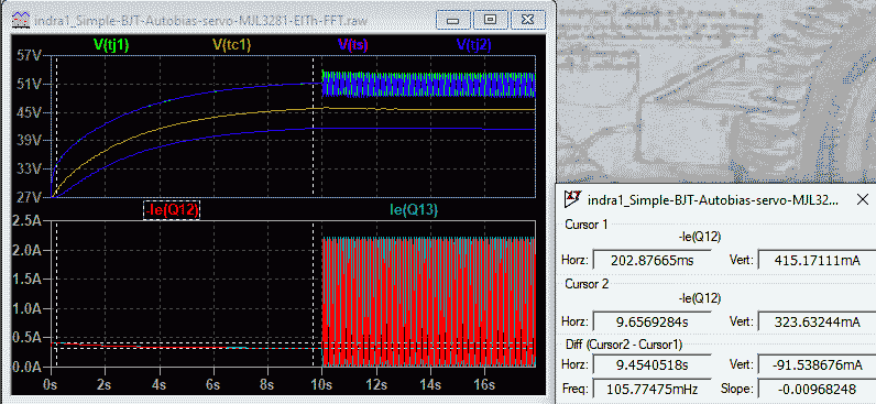

Hi indra1,
Here's the electrothermal sim. With Q3 thermally coupled to Q1 (and Q4 to Q2) via Tc1 (and Tc2) respectively using spreader plates. The Idle current starts at 360mA cold, peaks at 420mA after a short delay and then falls to 330mA warmed up (plot below). So this shows over-compensation but is OK. If Q3 and Q4 are on the heatsink (no spreader plate) then start is the same, peaks at 460mA, falls to 407mA warmed up at idle. So this is undercompensated but still OK by me.
For the sake of accelerating the sims I have compressed the heatsink time scale by a factor of about 1000.
BTW I used MJE340 and MJE350 models for the bias transistors Q3, Q4. The BD139C and BD140C models seem to need better temp. co. parameters for my electrothermal subcircuits, but seem OK for ordinary fixed temperature sims.
  • indra1_Simple-BJT-Autobias-servo-MJL3281-ElTh.zip

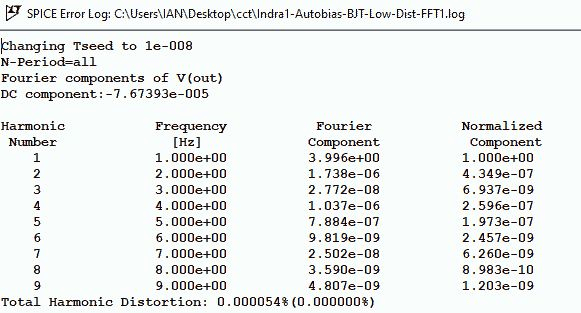

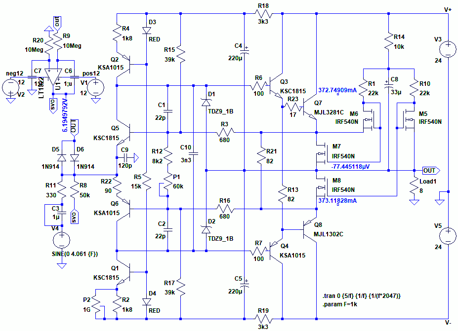

Hi Indra1,
Nice.
Here's your circuit with a BJT driver -- inadequate TO-92 I know, just to show it works (you can add an appropriate driver).
To trim the 2nd harmonic I added R22 and R23. The servo makes it easier to keep the output centred to aid finding optimum bias.
With a BJT driver the optimum current is reduced from 530mA to 373mA. A BJT driver costs than laterals. THD at 1W is about the same.
Strange, when I ran it on LT-IV I got lower THD null (below). Not sure why.
BTW the bias setting is sensitive to rail voltage changes. CCS's for R15 and R17 should help.
Otherwise it's looking very promising.
  • Autobias BJT-Low Dist.asc

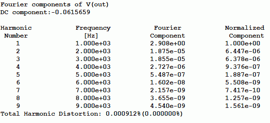

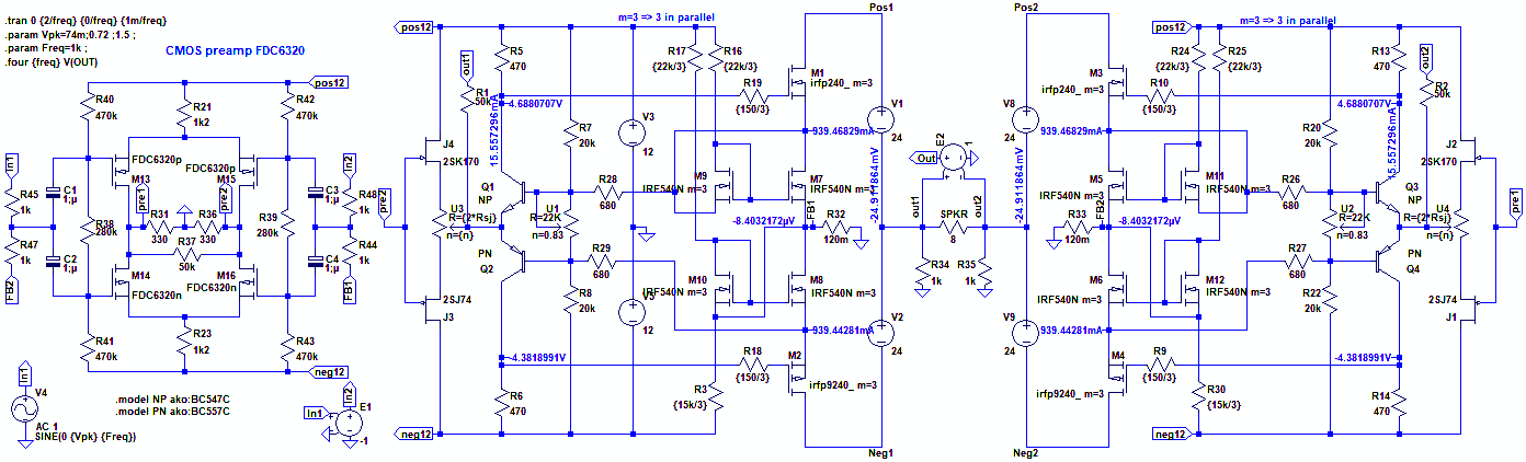

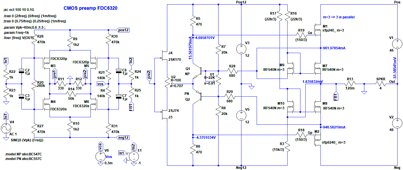

Hi Indra1,
Now the Pass F4 Class-A buffer with autobias can be done with minimal extra parts. And it is still "wideband" (OK to 100kHz).
There are actually 3 pairs of IRFP240/9240's. I use model area scale factor "m=3".
No source resistors are used giving high internal gm of 25A/V and 40dB of local nfb.
Using a bootstrapped +/-12V 1W converter keeps dissipation of the input buffer low and gives high PSRR with no electrolytics.
Idle current is 1A total and 46V rails give 200W of true Class-A into 4 ohms at 0.07% at 1kHz and 0.002% at 1W. Nice.
Even nicer is the idle power dissipation of 90W for 200W in Class-A, thanks to cube-law like currents.
(Recall standard push-pull Class-A needs biasing at 5A giving about 400W of power dissipation for 200W into 4 ohms.)
One question that can be answered using electrothermal models is whether three IRFP240's in parallel will be stable over temperature and with some mismatch of threshold voltages. The electrothermal simulation is included in the attached file.
It appears one bias pair (Q1,Q2) sensing voltage does not lead to current hogging. To check for hogging compare the current (Ix7-Ix1) at idle/crossover 1) at the start, then 2) at the end when hot. If (Ix7-Ix1) decreases then there is no current hogging.

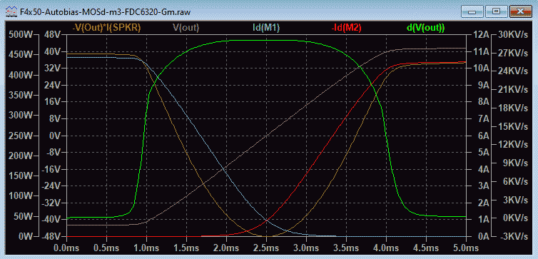

Now the F4 Class-A autobias with transconductance gain by using floating power supplies. Then I add soft-clipping with some feedback from a 120m ohm current sensing resistor (R13).
THD is low until soft-clip starts to kick in at about 50W or half the output voltage swing. Voltage gain into 4 ohms is x50.
Trimpot U2 trims 2nd harmonic and the bias current trims 3rd harmonic. Vos then nulls the output DC. R4, R20, R21 trim start of the soft-clip. The FDC6320 is EOL, the FDC6321 can be used instead, (otherwise some makes of 74HCU04 but scale R9,10,11,12 by x5). Inputs are differential but can be single ended by floating 'In2' and remove R23.
BTW there is not much negative feedback used in this variant. THD is very low up to 10W because the input stage provides inverse type error correction for the output stage.
  • F4x50-Autobias-MOSd-m3-FDC6320-Gm.zip

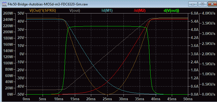

And a bridged F4 Class-A autobias with transconductance gain by using 2 split floating power supplies. 100W into 8 ohms. Soft clip starts at around 50W or 3/4 full swing.
Differential feedback is via the current sensing resistors. Output voltage centring is mainly via trimpots U3 and U4 but some common mode feedback is via R1 and R2 (to reduce thermal drift). Grounding 'In2' allows single-ended input but needs twice the input swing.
The use of 2 floating supplies has been bench tested on another amplifier and 2 split supplies can be reduced to 2 floating supplies (not split supplies) using electrolytic capacitors rail-to-rail to feed the speaker. This conveniently provides speaker protection against DC. Since this is a current output amp electrolytic capacitor nonlinearity does not affect the speaker current so it doesn't affect THD :cool:.
  • F4x50-Bridge-Autobias-MOSd-m3-FDC6320-Gm.zip

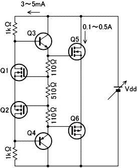

Hi Patrick,
Thanks for mentioning that design. I hadn't seen it before this.
The K3497/J618 are not lateral MOSFETs (their Gm of 10A/V is way too high for lateral technology) so I'd also expect that they have a problematic positive tempco at normal Class-AB bias current levels (0.1A).
Yet, with no source resistors between them the idle current falls as the heatsink warms up. And it is interesting that using laterals 2SK1058/2SK160, the idle current also falls in a similar way to the K3497/J618 pair.:confused:
Strange, but the basic bias generator circuit does not seem to imply inherent thermal stability - because there is no sensing of source currents in the K3497/J618 pair.
So I'm at a loss to explain how it can be so stable over the heatsink temperature change. The only thing I can think is the bias generators MOSFETs Q1,Q2 warm up slightly with the heatsink due to air inside the enclosure. Unfortunately the datasheet doesn't have any tempco info to make a model, so I can't try electrothermal modelling for this biasing circuit. Maybe someone can kindly provide suitable models with reasonably realistic tempcos.
Another issue would be whether this bias idea allows paralleling (or not) assuming we want to omit source resistors?
Otherwise the amps performance is impressive - wideband, low THD at 20kHz and very clean clip recovery.
