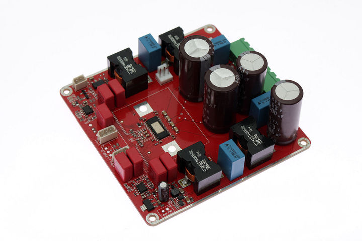

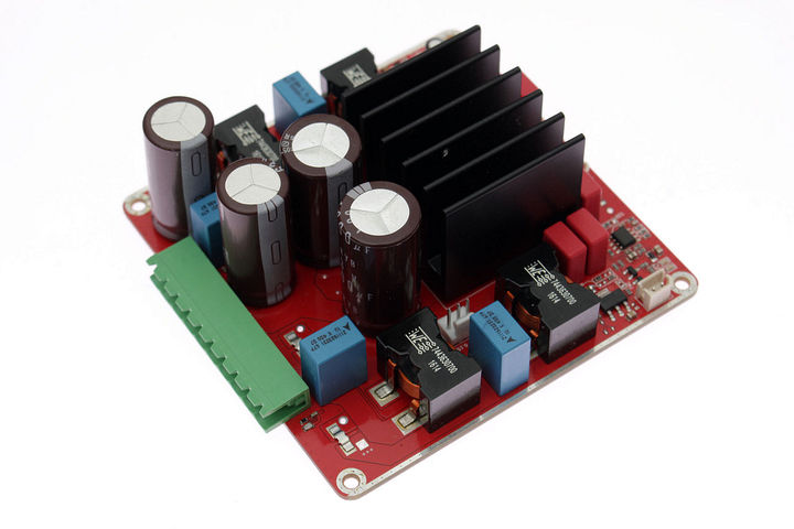

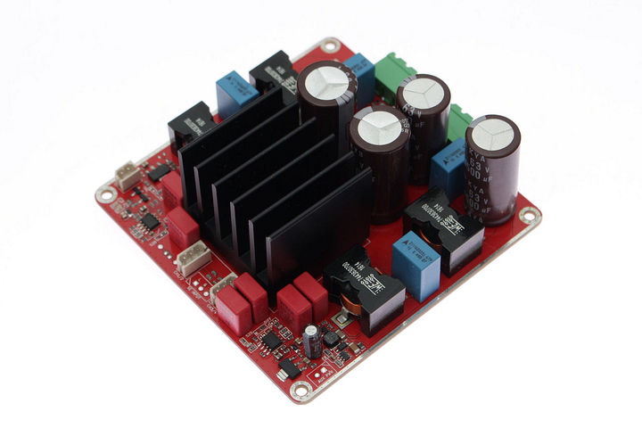

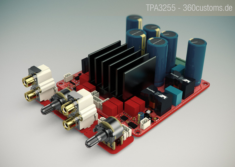

Up and running in 2.1 configuration.
attachment.php
attachment.php
attachment.php
Having some PCBs available, just drop me a mail.
Regards.

Yes, the 2.1 config is for the bike setup, giving a little more "ompf" for the bass. The board can also be configured as 1.0 PBTL, 2.0 BTL, 2.1 BTL+2SE or 4.0 SE.

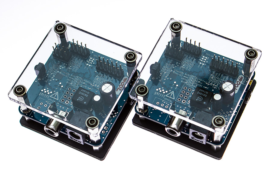

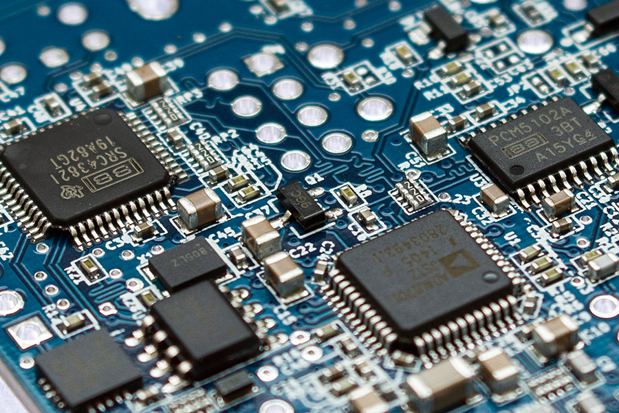

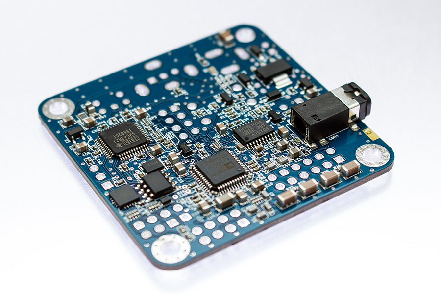

I was at you webpage where i see that you have been working on a module using SRC4392,ADAU1701 and PCM5102A.
Now i work with the ADAU as well. But why do you not skip the ADAU1701 and replace the DAC by PCM5242? It has a build in MiniDSP which also has biquad filters taps. Enough for doing a crossover in the digital domain.
BR
Sonny
When i made the ADAU1701 boards, the PCM5242 wasn't an option. (It's quite new - 2014)
Beside this, getting the TI miniDSP software isn't as easy as getting SigmaStudio from AD. (If i remember correctly, you'd have to apply for a license.)
Did i ever showed pictures of the finished board?
