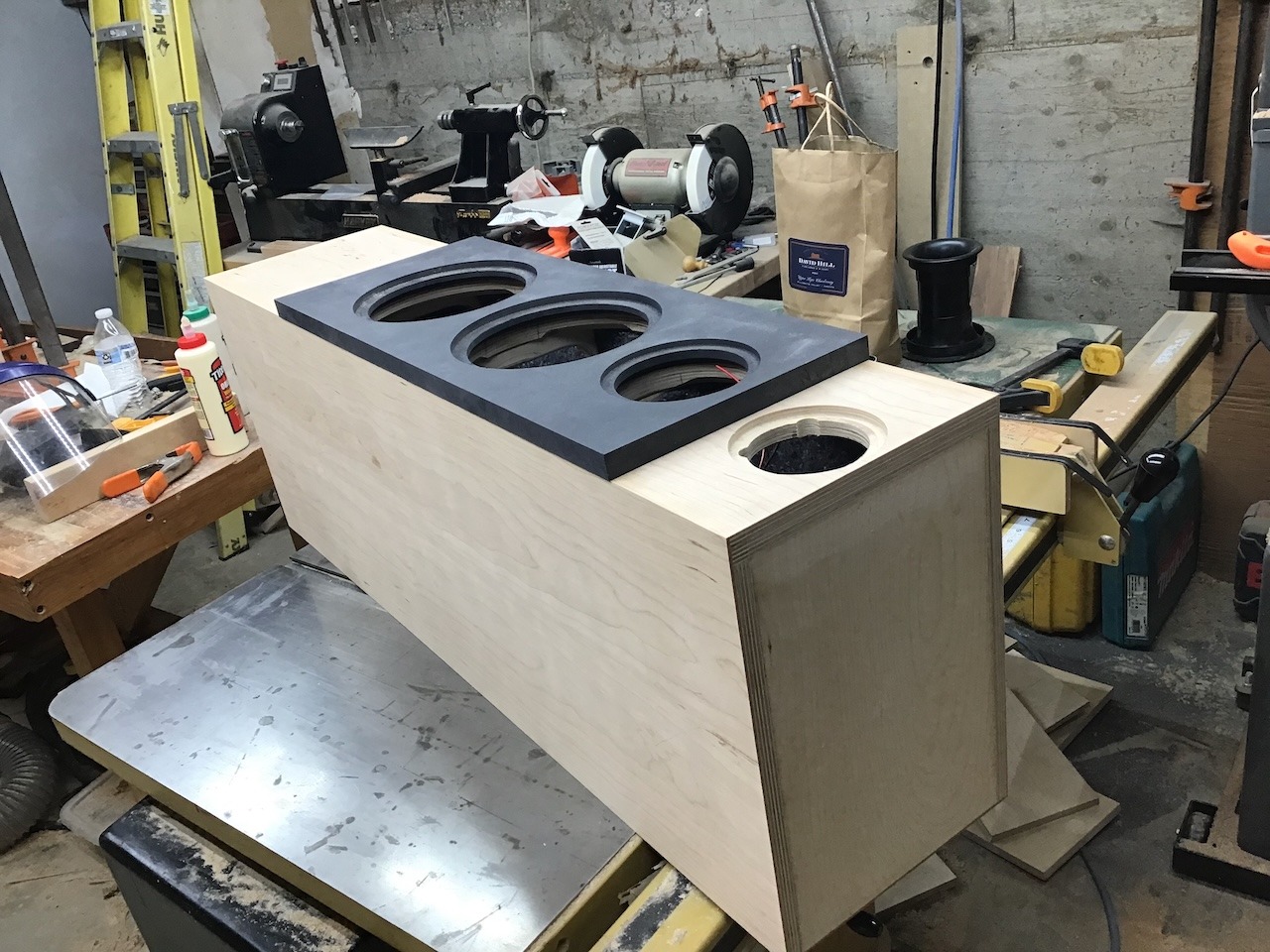

Here is what I have so far.

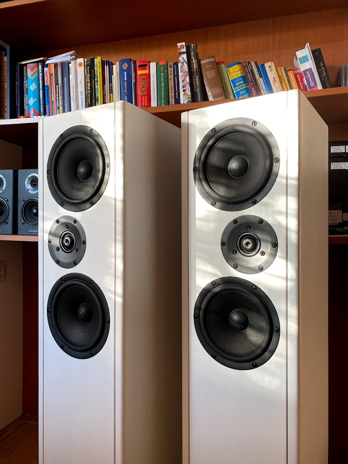

Nice project, I think this could be a real gem. Drivers are absolute and if Troels did a good crossover, and it seems that he did, you could be very surprised.
I did his MTM16 with Satori drivers and it sounds really amazing. Music is disconnected from the box with very nice and deep soundstage.
Two illuminator bass drivers and 3 way should do even more in all aspects.

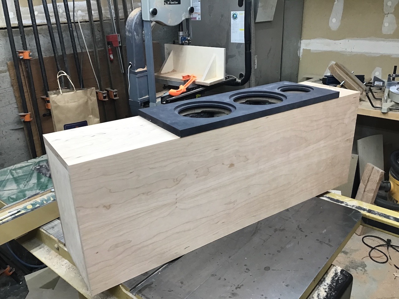

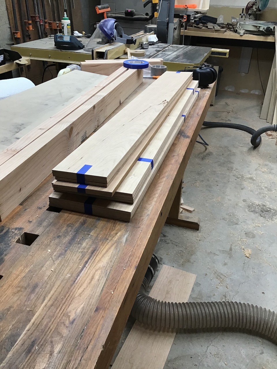

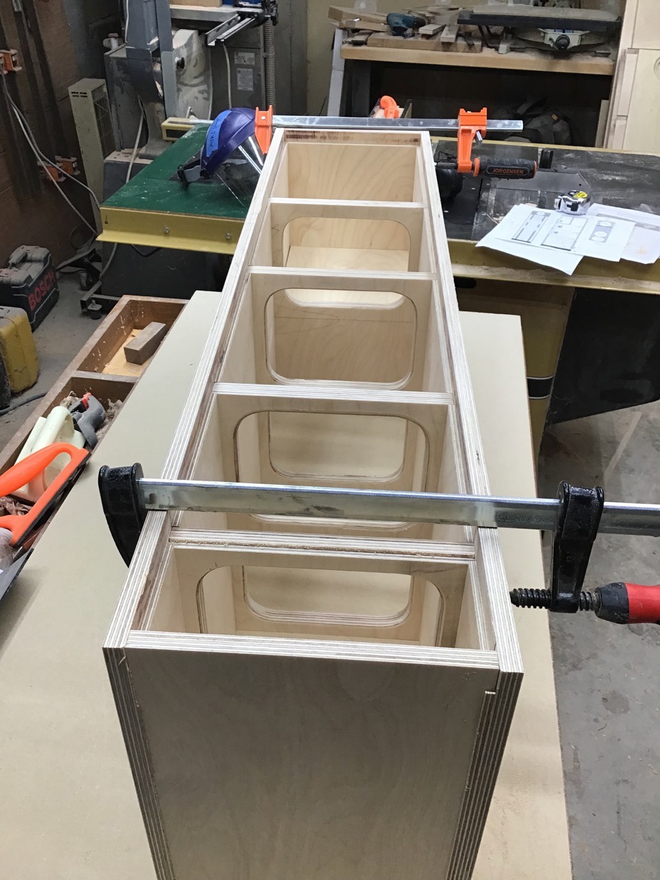

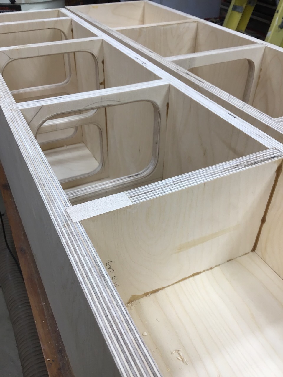

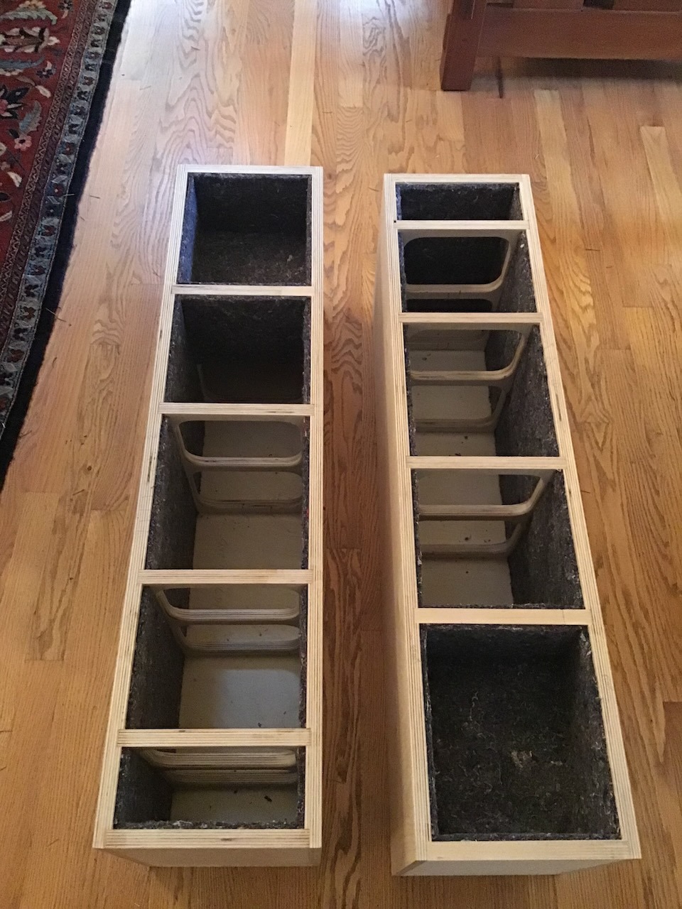

Update: The raw cabinets are just about done. I'm adjusting the baffle glue surface of the cabinets to make sure it's a good fit. Later today I'm heading over to the lumber store to get some 8/4" cherry for shop cut veneer. The baltic birch plywood that I'm using does not have a "good" face so it needs to be veneered. I would rather go that route instead of mitering angles. Troels Gavensen is an excellent cabinet maker and makes that part look easy. It's not.
Update

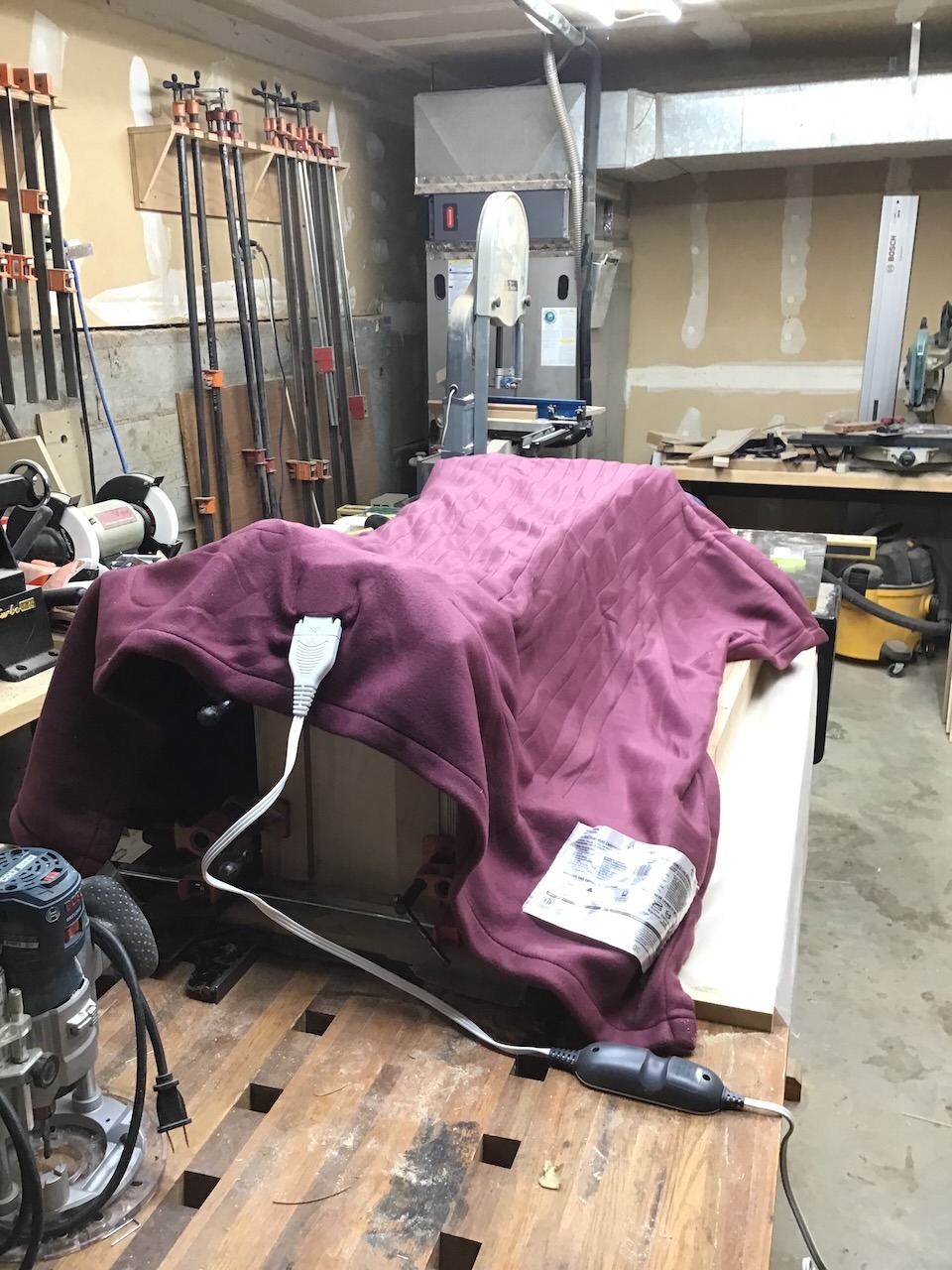

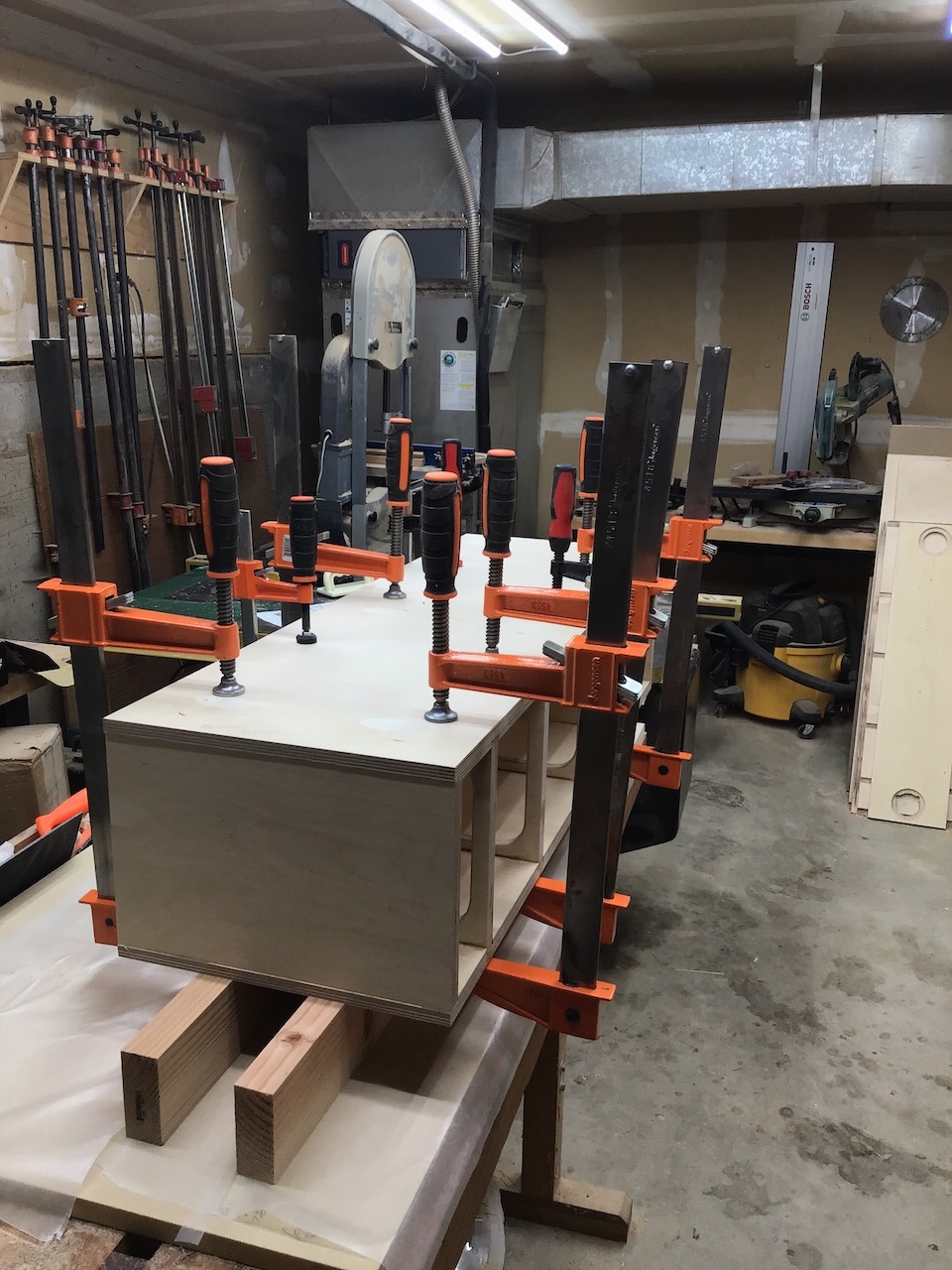

  • Glued sides, back and braces. Used a heating blanket to keep glue above 50F in order to cure
  • Leveled out a few braces to ensure seal in mid-cabinet.
  • Lined cabinets with wool felt
  • Shop cut veneer 1/8" thick (cherry)
  • Inner front baffle veneered and driver holes routed in both inner and outer baffle.
  • Lots of little problems, no major set backs.

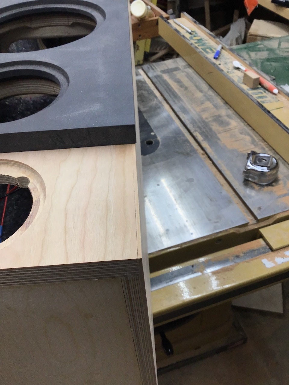

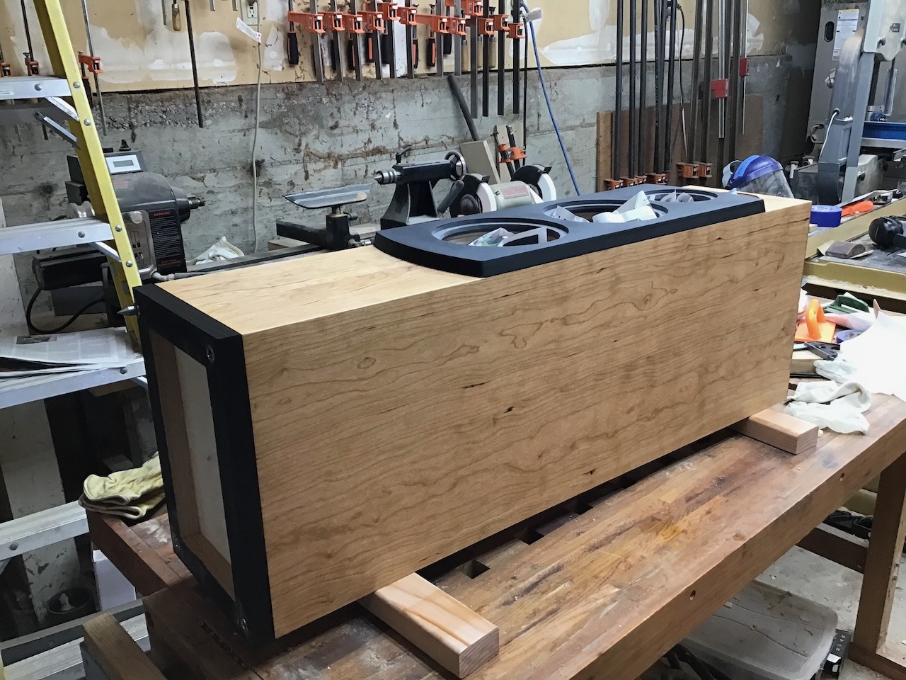

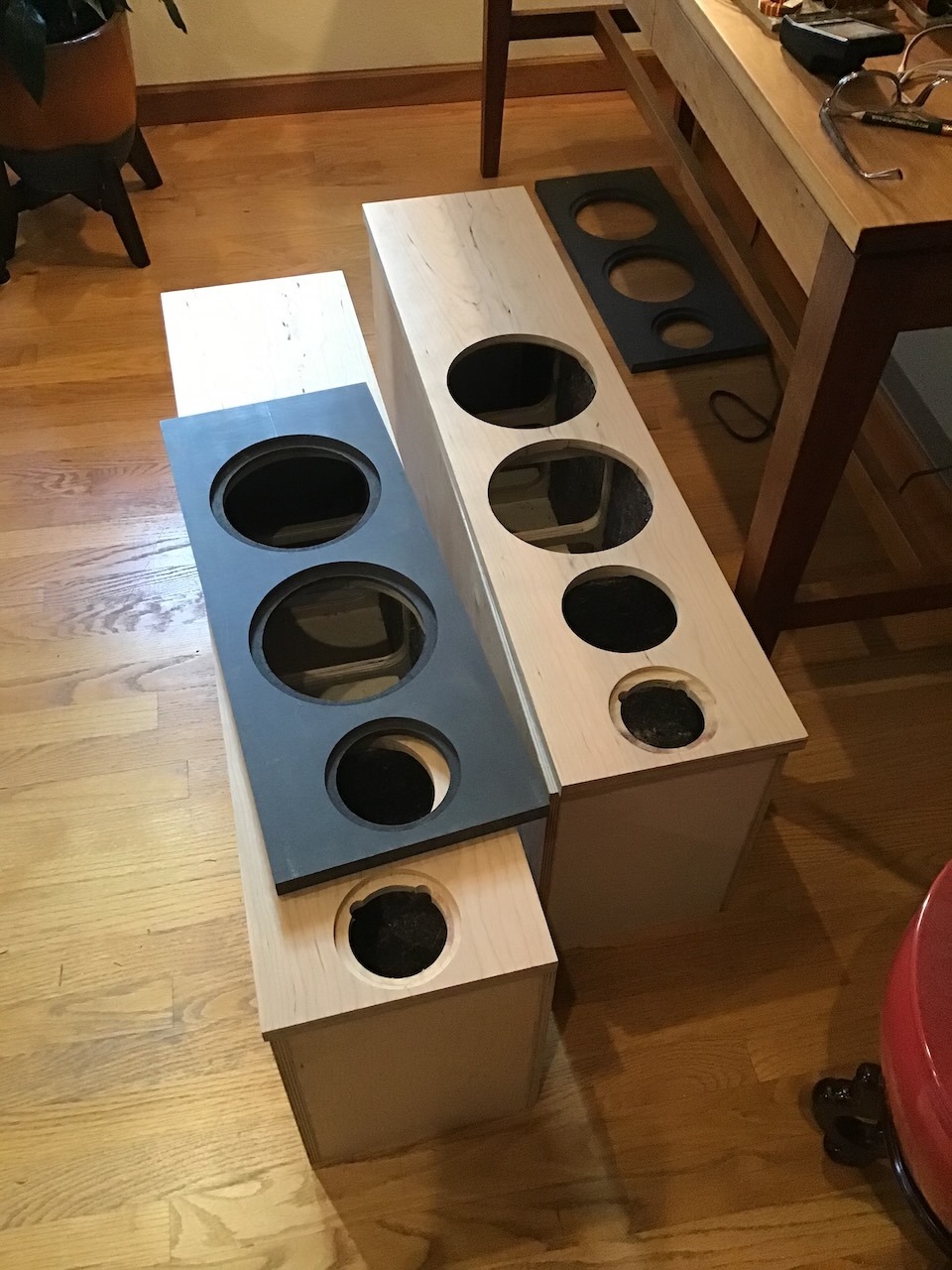

Installed the crossovers, getting the veneer glued on and coming to terms with one major disappointment. I took my shop cut veneer to a commercial woodworking place to get it sanded to thickness since I had difficulty running it through my planer. In running it through their drum sander, they feathered the edges of the veneer. I only had 1/4" of overhang waste at the most to work with so I was unable to get all the taper out. That resulted in a visible glue line on the edge.
I knew this was going to be a problem. I had to decide whether to scrap the material, eat the cost of shop time and do it over again or use as is. I decided to not let perfect be the enemy of good and use as is. These projects always start out as perfect in your mind then through attrition you end up with something between your ideal and what you can live with.
Looking forward to how they sound.

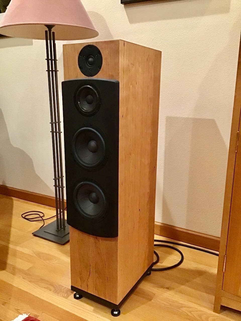

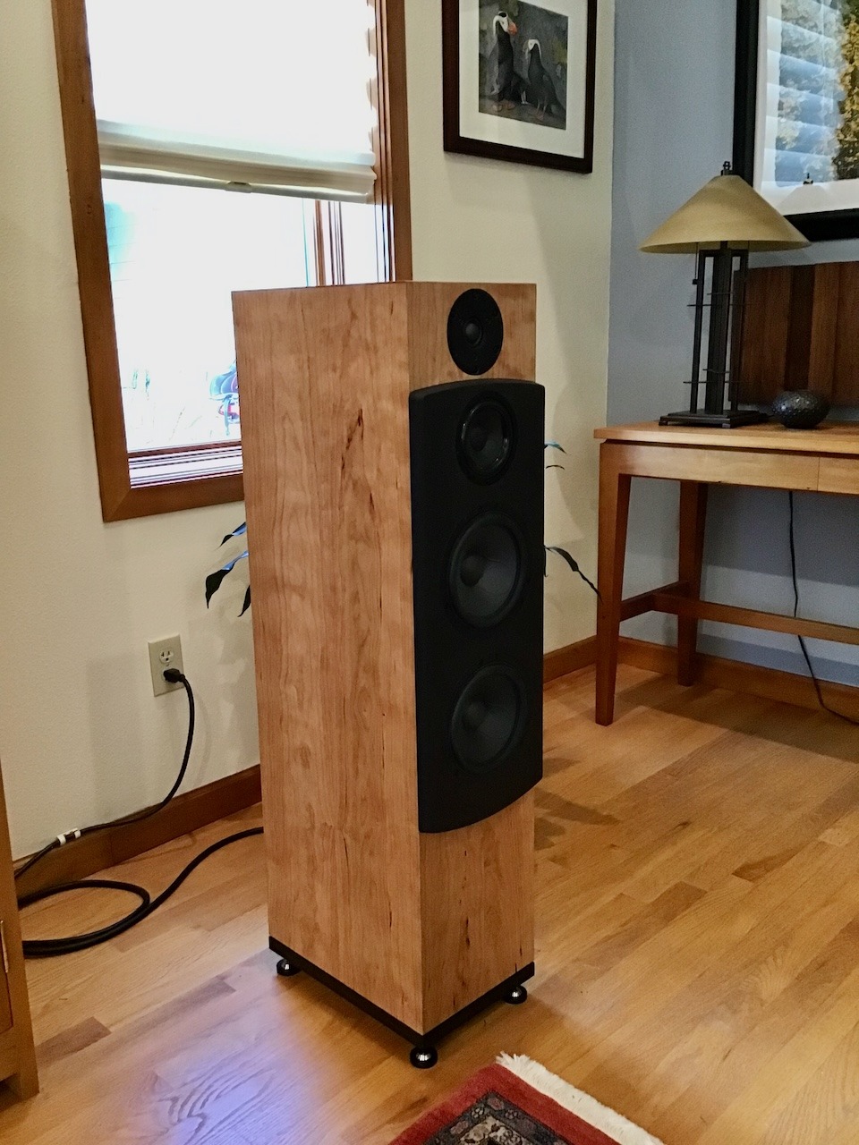

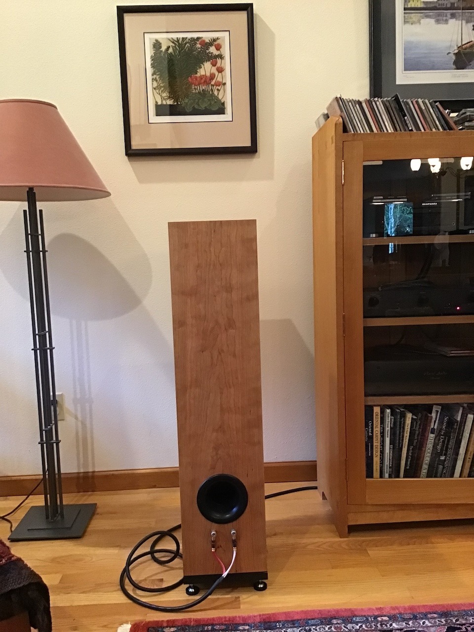

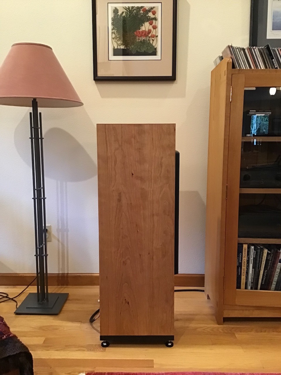

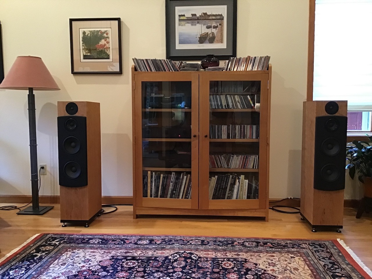

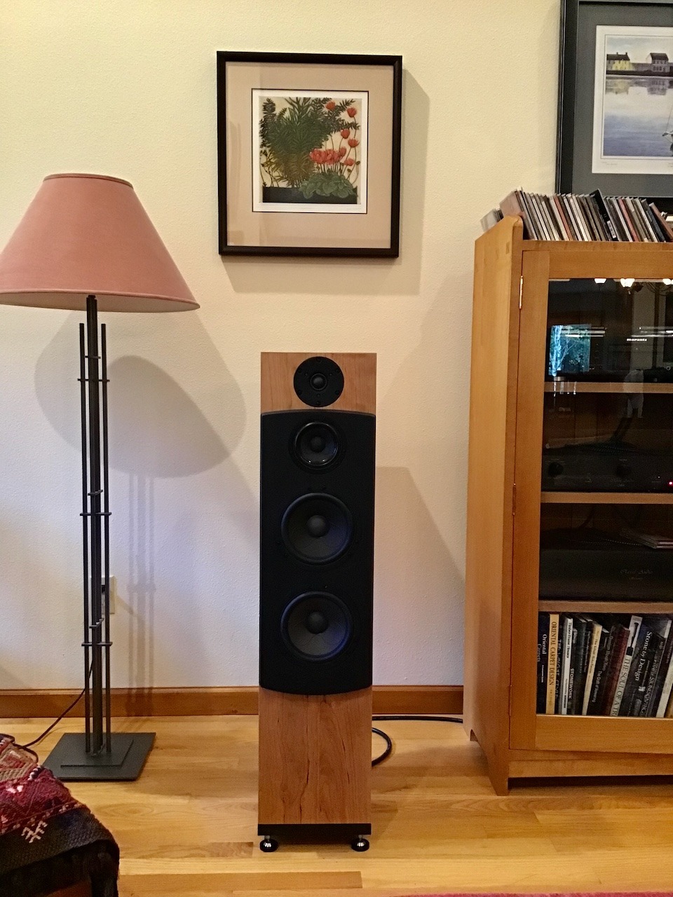

I'm working on some fine tuning but here are pictures of the finished speakers.
