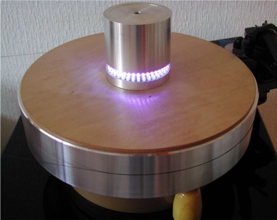

Jocko,
the this pix you posted is most probably a platter weight with built-in strobe light. The strobe dots are the leds flashing with a very short duty cycle and if the platter is at correct speed, the lighted dots seem to rest, otherwise the seem to run CW or CCW, depending on the speed being to high or too low.
The rest looks quite fancy, and i would not second to use wood as a platter mat. The only correct impedance match for vinyl is vinyl.

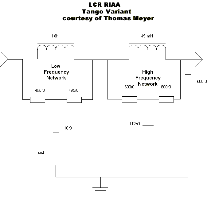

LCR RIAA:
much more expensive taste than the illuminated platter weight .
fellow Munich Triode Mafioso Thomas Mayer (vinylsavor) uses such, i guess he uses the Tango RIAA. I haven't yet fully understood why this works and works so §$%&in' good, but it does. It's magic.
Mick Maloney in Oz has an LCR phono pre that good press so Thomas' phono stage is not unique in this respect.

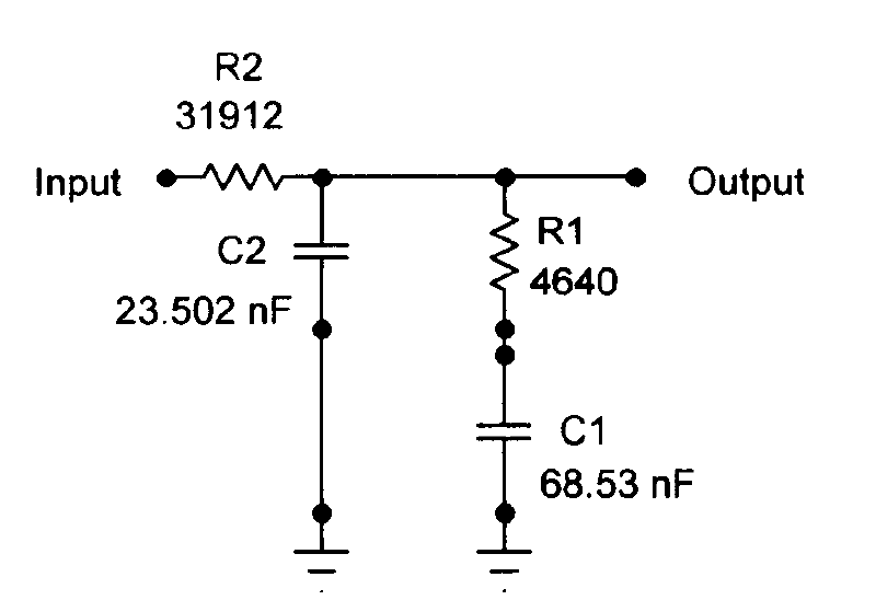

Time Constants
So how does one calculate the time constants? My DIY phono stage is a passive RIAA circuit sandwitched between an Instrumentation amp and an opamp. It only has the standard 3 time constants, swipped from the Analog Devices systems application guide. I'd like to add in the Neuman cutting head 50kHz time constant, even if it means splitting things up and putting in another gain stage. This is for solid state (opamps).

Jocko,
several people expressed concerns about hum or noise pick up in LCR EQ coils. However I've never seen any issues with this in practice. I've build LCR RIAA phonostages with the potted RIAA from Tango and also 'discrete' networks with seperate (unshielded) coils. No hum pick up, whatsoever. Also other friends of mine who built such phonostages never had problems. One of them uses homebrew coils.
Dicinger,
LCR RIAA EQ are not 'compound' they consist of two independent networks in series, one for the 318/3180 uS time constant and one for the 75 uS timeconstants. They can be tweaked separately with very little interaction. The only interaction between the two networks is due to the DC resistance of the coils. Theoretically the two timeconstants can be placed between different stages. But then you need two gain stages which are capable of driving 600 Ohms. It's also no problem to introduce the 'secret' 3.18 uS timeconstant into the 75uS part.
Regards
Thomas
Jocko,
before trying LCR EQ, I used RC networks. Split networks, as well as compound ones, similar to the one you posted. After I tried the LCR EQ the first time, I never looked back.
One of the key advantages of the LCR variant is it's constant input impedance with respect to frequency. The RC network you showed, has an input impedance which drops as the frequency increases. It's accuracy will depend on the driver stage. For example in a tube circuit, the response will change with different tubes, or with ageing tubes.

Thomas,
thank you, stand corrected, good news :)
You have probably forgotten more about forgotten more about inductors and trannies than i ever will know. However, whether LCR RIAA is compound or split is not such a vital detail for me. What its vital to me: the 4th TC, 3.18 µs. Did you try it out already? Or does your LCR network happen to have an approx. 50kHz rolloff by occasion?
