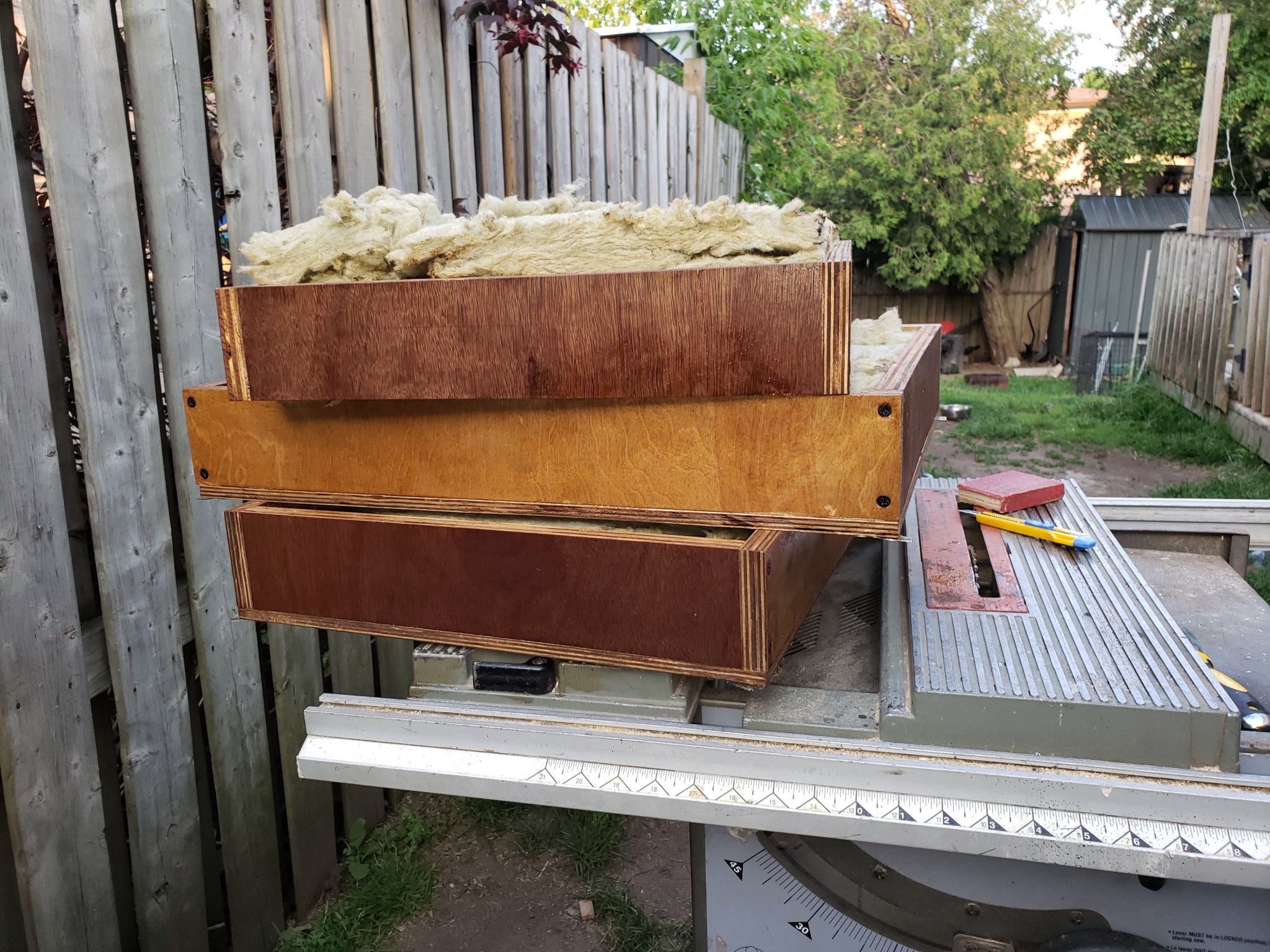

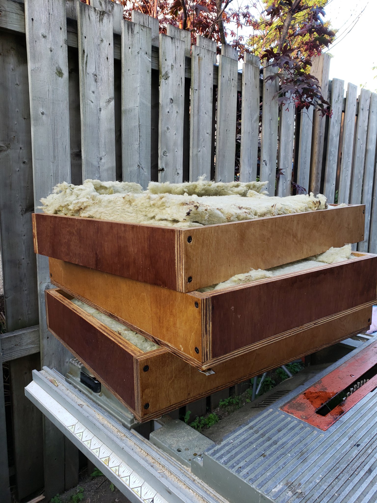

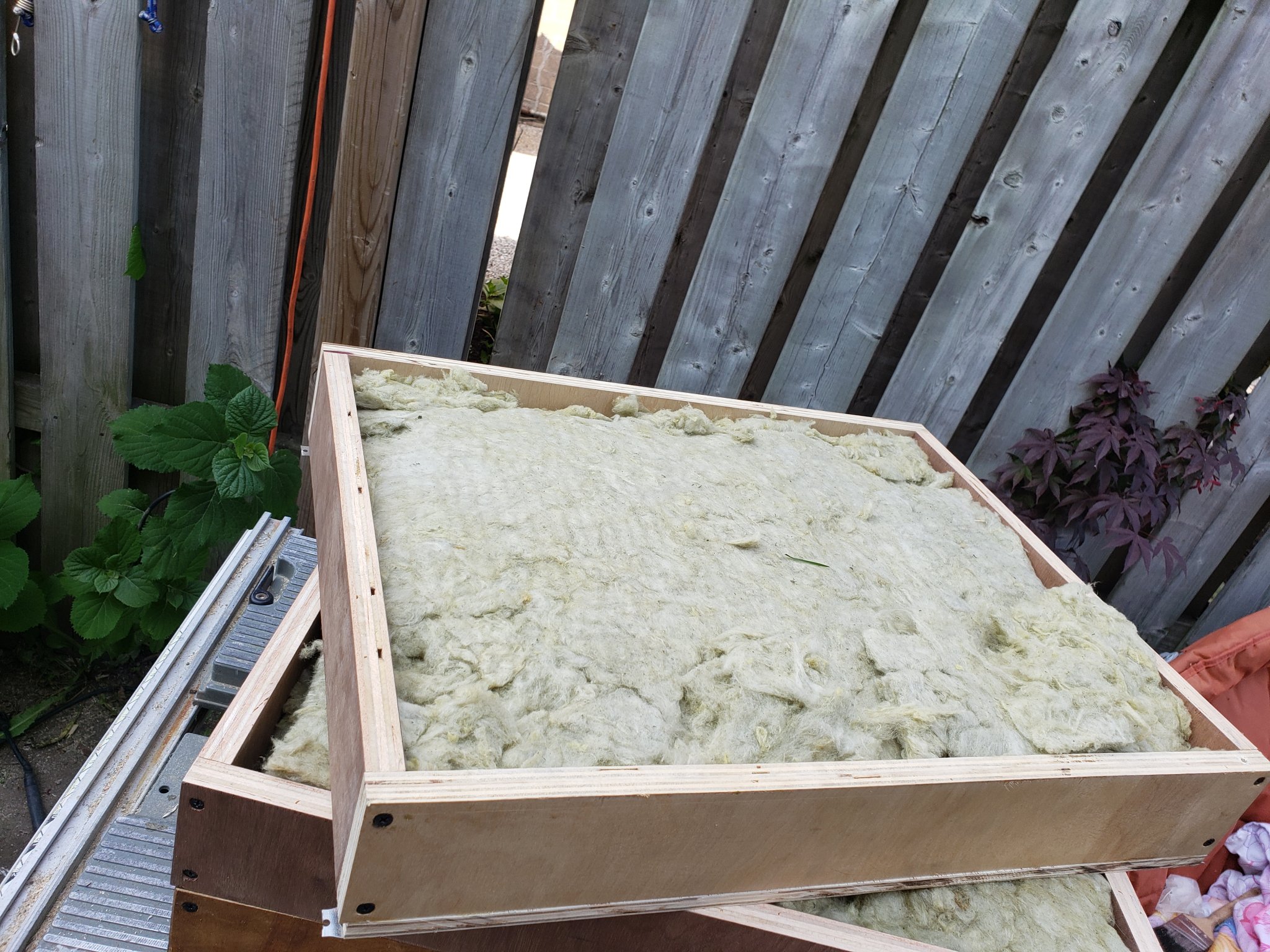

Do these look okay? They are not very deep, 3 1/2" x 16" x 24" to be exact.
I will load with a rockwool after I fix up the 1/4" back panels.
Being somewhat shallow as they are, will they be very effective with heavy rock wool behind stand mounts?
Next I am planning to make at least one larger diffuser framed the same way, also loaded with RW. Something other than skyline. 24" x 48" x D? If I were to style it the same way as the three imaged, only fashion slats in an every other pattern across the front. Questions are how wide and how widely spread apart should they be to turn that absorber into a panel that does some of both for MF & HF?

BTW that was also kind of my other thought, a panel VS no panel where sound is free to reflect is the same thing essentially. But that it would be less accurately controlled as a specific designated panel would.
At times I keep forgetting to stop thinking and just keep it simple.
Comparing mine to a similar panel only that one has double its rock wool thickness, 7". If the larger one is effective catching all of the the sound then In theory 3 1/2" depth should do a comparable job if speculated to be "too thin" by Joe the audiophile speculator . Because the sound will dissipate a second time on it's return path, after it reflects off the wall directly behind the rock wool.

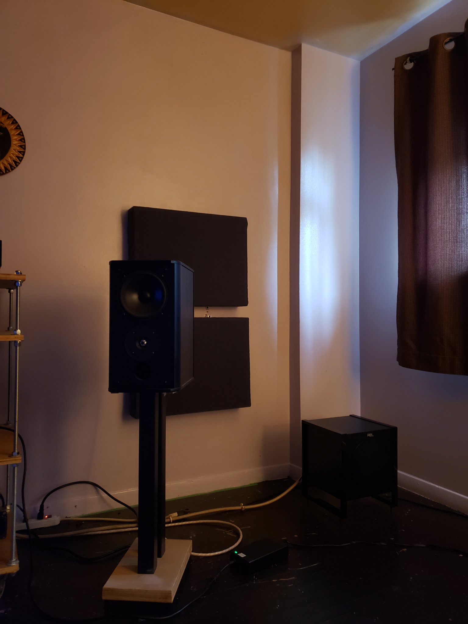

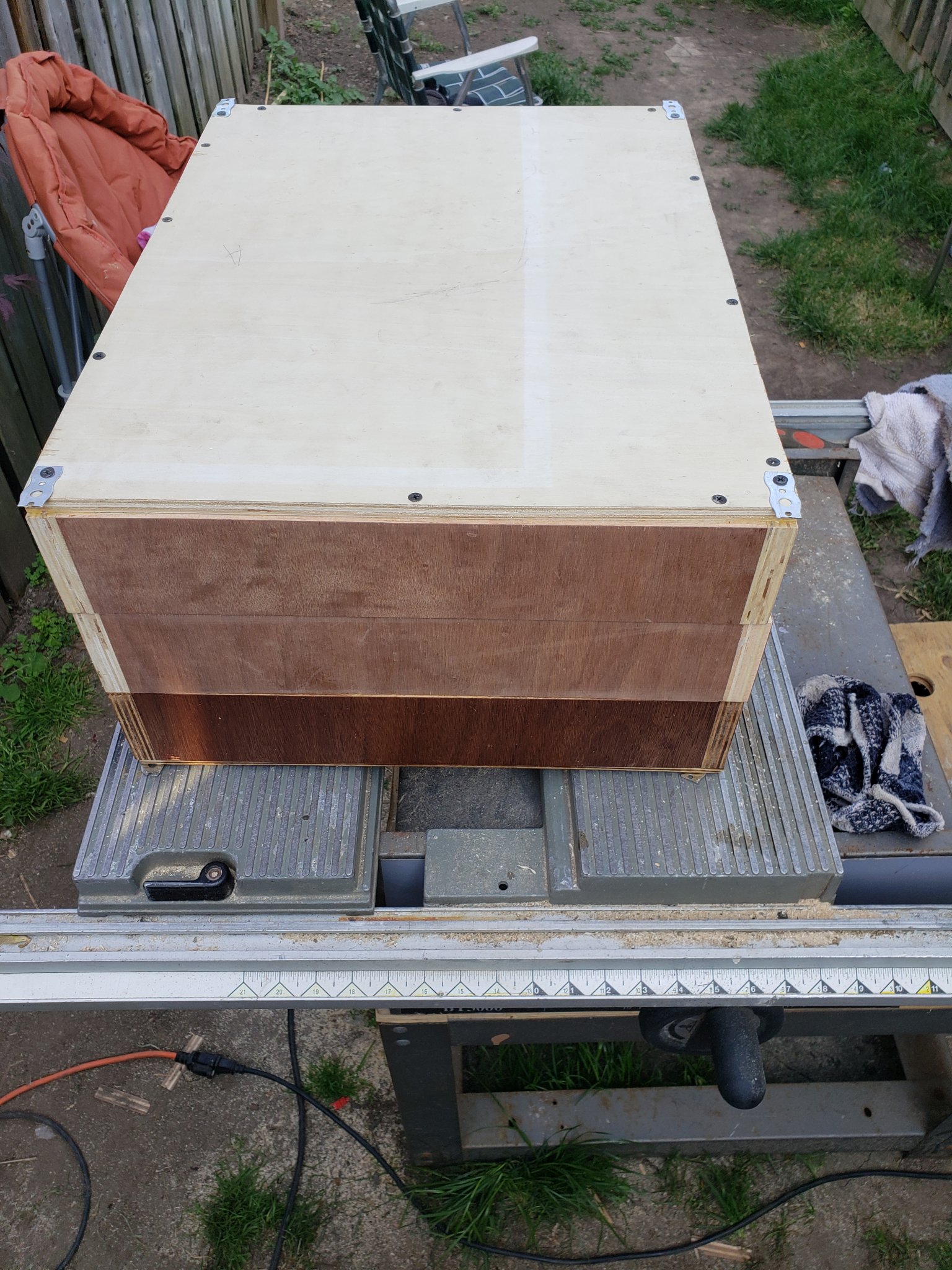

I'm going to add software. Room overhaul not quite there yet.
Instead of one panel per speaker I'm doubling them up (main longest wall.
Not top shabby. Last and final step the textiles.
Then I'll get to the large one. And may do another skyline since there easy and effectiv3.

Yep,after a fibrous read. I may go two ply and run a filter. Got to think of others health.
Always planned to cover though. Its not a full on man cave:( thinking of a large black knit. To contrast New paint and the tint of the oil. The designer in me is just screaming to get out lol.

Why have you made the frame closed back?
A way to increase panel efficiency is to only have a frame to hold absorbing material ( keeping front and back open) and to use a bit of distance between panel and wall ( in the 10cm range): it extend efficiency in freq down a bit.

I closed the back because space concerns. Thinking ill mount them tight to the wall. I believe your right to say open backs away from wall adds to there effectiveness.
I have plenty of rw and will be experimenting with a couple different design ideas. Including some portable open back panels on stands.
I made the same kind of panels out of 1x4’s and rockwool. I used ceiling panels for the backs instead of plywood or pegboard. I went to the fabric store and bought some cheap but not too offensive fabric to cover them with. I made a couple of them 24x48” and some others 16x24” and 12x24” I placed the large ones on the front wall, mediums on the side wall and back wall. I haven’t really used the small ones, they are absorbing sound in the closet. The absorbers did make a difference in the treble and upper midrange. I need to work on some diffusers for the midrange. The large panels cover down into the midrange if I have them set off the wall 4” or so. You can get the same effect simply by making more and placing them at various depths - a skyline absorber? I hear skyline absorbers work best with LED lighting 😉

I think your idea with the slats in front or over the rockwool is a great idea. That should lower the absorption frequency and may keep the top end from going dull. I don’t know of any math to help figure this out, so you may be on your own to experiment. I’ve seen many commercial products with what appear as 1/4” routed holes in birch plywood. Also, the mass, stiffness, and width of the slats would change the damping characteristics too. I need to try this.

I'll get the first three hung tomorrow. I'm just happy to have motivation to complete projects back.
Slow progress. But an obvious improvement. Even though bass resonance control is less than dire I decided Ill make a deep 10"x1 / 2" panel for sidewall immediately under medium sized window, or 2 with close to same dimensions for ceiling, suspended by cables / eye loops.
