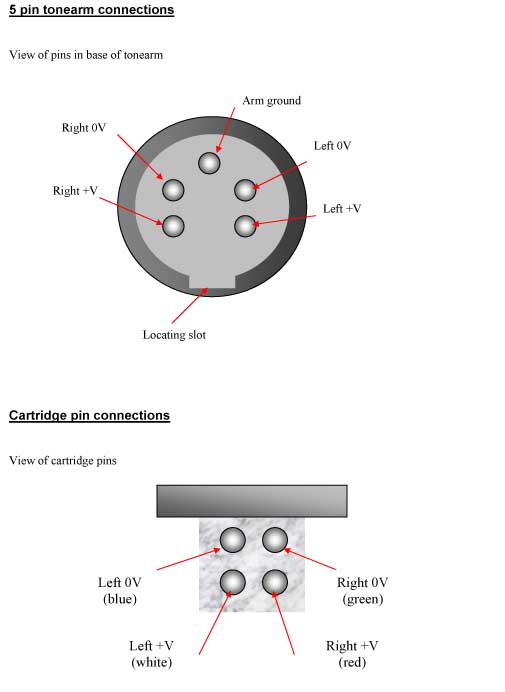

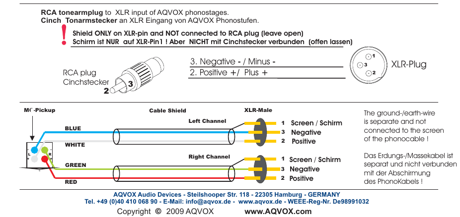

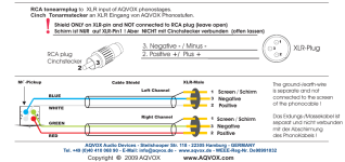

Most phono carts do not have one pin connected to the tone-arm. Otherwise the cart would be a dual "balanced" signal source. The input to the pre-amplifier with Cinch/RCA connectors is pseudo-balanced, i.e. the outer conductor is not tied to box at that point. Signal ground and case ground is joined somewhere inside the box.
The tonearm, which forms a shield for the internal four wires from the cart, is tied to the chassis of the turntable, and at some point bonded to one of the shields if an RCA cable. If not, a separate ground/chassis cable may be provided to bond against the pre-amplifier case.

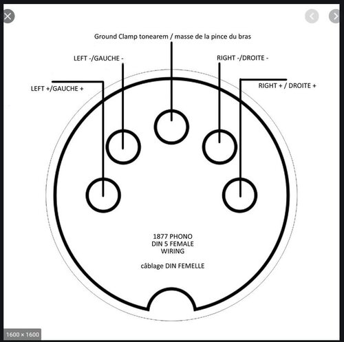

In a DIN turntable, 5 conductors are used, two for each channel and one for the shield. The shield does not carry any signal, nor should it. Typically the shield need only to be grounded at one end, usually at the pre-amplifier end.
This is to avoid ground loops. Removable head-shells have 5 pins.
The shield(s) may be connected to pin1 on a 3-pin XLR connector, or a 5-pin (or even 6-pin) XLR can be used like a 5-pin DIN.
Tying a signal conductor to a shield is not a good idea (signal currents should not be mixed with shield currents) but it should work in most cases.

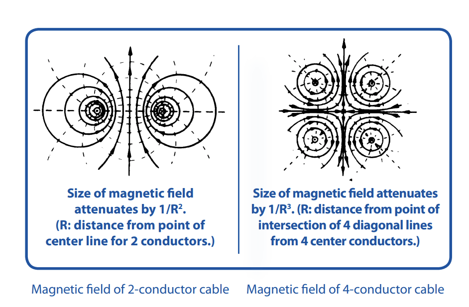

Star-quad cable, which maybe what Chat GPT suggested, is designed to cancel out magnetic fields more effectively that standard twisted pair. The geometry also gives it lower inductance. Please see pic below:
The idea with star quad is that the diagonally opposing conductors are tied together at both ends. So you end up with two signal lines (two sets of diagonally opposed pairs, normally color coded to help make clear which wires form pairs). They can be used as balanced interconnects, or with one pair as hot and the other pair as signal ground. If there is a shield it should be tied to chassis ground at the source end only.
