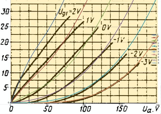

Hi Jan
You asked me what the contact voltage is.
This is a voltage caused by different materials used for different electrodes. It is typically 0.55V or so, for sure less than a volt.
It offsets the triode's Plate current curves, in same manner as there would be a voltage source connected between the grid pin and the actual grid.
To get your measurement fitted, I had to tune the contact voltage to a very unusual high value. So I suppose there's something wrong...
BR Adrian
PS: I will send you the (most probably not accurate due to this issue) spice model code in a private message, ok?

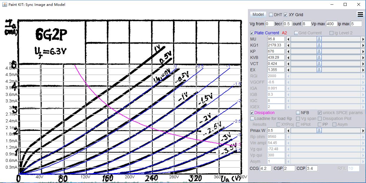

6G2P SPICE Model
Code:
**** 6G2P ******************************************
* Created on 03/02/2024 20:18 using paint_kit.jar 3.1
* www.dmitrynizh.com/tubeparams_image.htm
* Plate Curves image file:
* Data source link:
.SUBCKT 6G2P 1 2 3 ; Plate Grid Cathode
+ PARAMS: CCG=4.2P  CGP=2P CCP=3.4P RGI=2000
+ MU=95.8 KG1=2179.33 KP=676 KVB=439.29 VCT=0.424 EX=1.355
* Vp_MAX=400 Ip_MAX=5 Vg_step=0.5 Vg_start=0 Vg_count=8
* Rp=9560 Vg_ac=54.45 P_max=0.5 Vg_qui=-72.48 Vp_qui=300
* X_MIN=63 Y_MIN=187 X_SIZE=757 Y_SIZE=376 FSZ_X=1260 FSZ_Y=630 XYGrid=true
* showLoadLine=n showIp=y isDHT=n isPP=n isAsymPP=n showDissipLimit=y
* showIg1=n gridLevel2=n isInputSnapped=n
* XYProjections=n harmonicPlot=n dissipPlot=n
E1 7 0 VALUE={V(1,3)/KP*LOG(1+EXP(KP*(1/MU+(VCT+V(2,3))/SQRT(KVB+V(1,3)*V(1,3)))))}
RE1 7 0 1G  ; TO AVOID FLOATING NODES
G1 1 3 VALUE={(PWR(V(7),EX)+PWRS(V(7),EX))/KG1}
RCP 1 3 1G   ; TO AVOID FLOATING NODES
C1 2 3 {CCG} ; CATHODE-GRID
C2 2 1 {CGP} ; GRID=PLATE
C3 1 3 {CCP} ; CATHODE-PLATE
D3 5 3 DX ; POSITIVE GRID CURRENT
R1 2 5 {RGI} ; POSITIVE GRID CURRENT
.MODEL DX D(IS=1N RS=1 CJO=10PF TT=1N)
.ENDS
