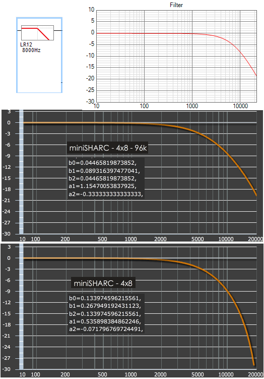

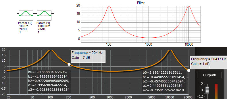

Warning about biquad coefficient copy/export. VituixCAD calculates coefficients according Excel sheet by miniDSP: All_digital_coefs_v1-20101026.zip.
That is based on bilinear transform (BLT). One problem with the BLT is frequency warping towards the Nyquist frequency. For a low-pass filter with a resonant peak the result is too steep falloff for high cut-off frequencies. Similar effects are present for other standard filter types.
Frequency response of DSP device could be different than ideal (analog) response shown in VituixCAD.
Few examples attached.

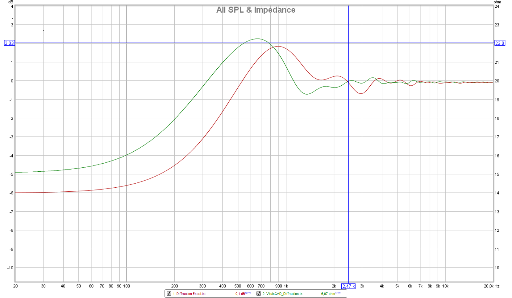

Hello Kimmo. Firstly thank you for excellent software.
I have some question. I tried modeling front baffle in diffraction application and I compared it with other software. I have found little differences, data in both, of course, the same. I attach an image.
^Different level at low frequencies is related to listening/mic distance. VituixCAD calculates to axial distance entered by user. Maximum baffle loss is less than 6 dB if distance is "normal" 2.5...3 m. You can get closer to 6 dB by entering 99999 mm to axial distance. Most of the other simulators I've tested calculate baffle loss to infinity distance regardless of entered axial distance.
Other differences cannot be explained for sure without knowing how other programs calculate. I can just guess that Excel simulator does not calculate phase response of radiator before diffraction. That probably shifts peak to higher frequency.
Generally, I don't know any accurate simulator. Diffraction process is very very complex. Simulation algorithms are usually very simple compared to real life. For example VituixCAD calculates only first order diffractions (radiator->edge->listening point) with ray theory. That gives too shallow baffle step.
Thank you for answer, i try FRD Response Blender.
