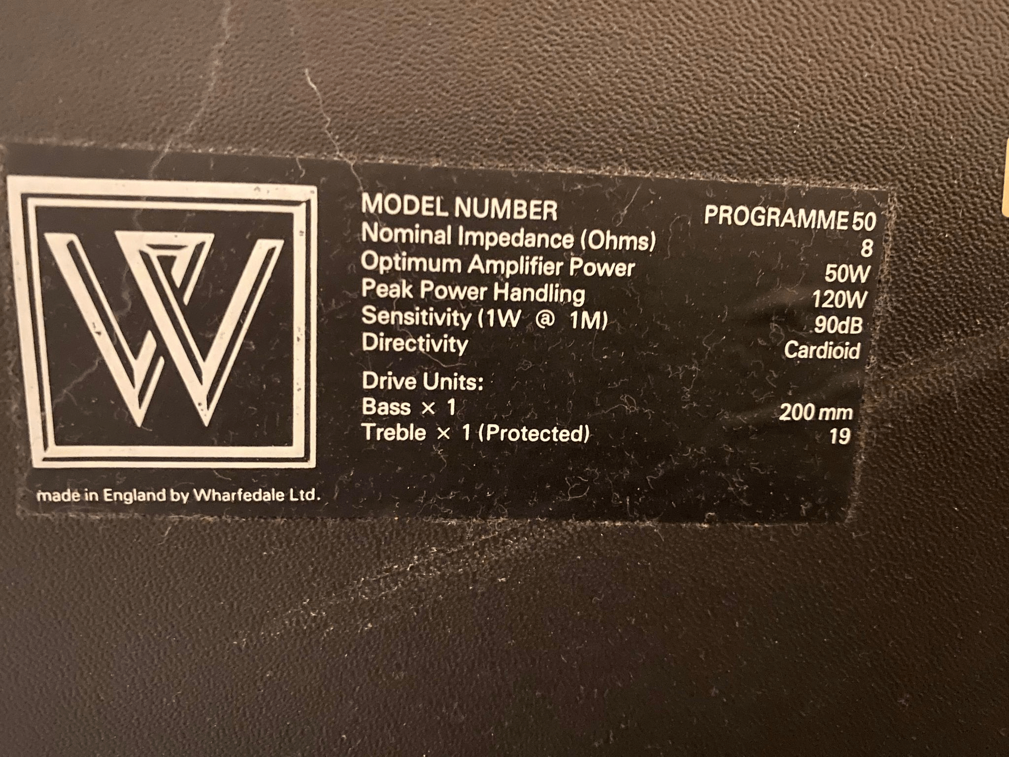

Sensitivity is 90 dB.
The Programme range was intended for commercial use, e.g. in association with a jukebox in a pub, and such speakers can lead a challenging life.

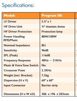

I guess all you need to know about the earlier Pro Program 50 is written in its specifications.
The speaker is intended for commercial premises where its high sensitivity can be an advantage.

Because I don't believe published specifications. Manufacturers no longer provide factual information. They're just trying to sell you stuff. You know, the 1000w amplifiers with the 80w power consumption.
I wondered if anybody had any experience with these speakers.
96dB / 5.5" woofer / 40Hz / 6 litres . . . seem too good to be true.

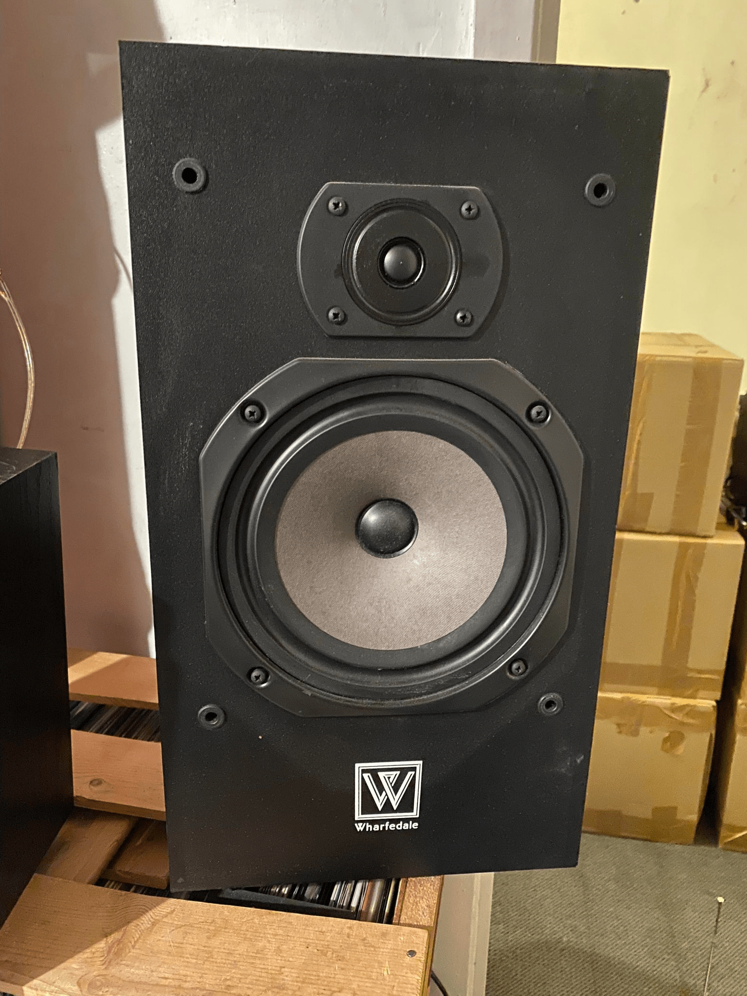

I was just adding when your above post came in that I did have pause for thought when you mentioned "bookshelf speakers".
I did think the original Wharfedale Programme 50s were a tad large for that application!
So mea culpa, I should have asked for more information at the outset.
The 96dB figure should probably be taken with a pinch of salt, particularly since it is unqualified.
Perhaps you should ask over on the PA systems forum?
However, since you've bought the speakers, you will be best placed to comment after you've compared them to a pair of domestic speakers, which are typically around 87dB.

It says...
they can be installed on the wall or ceiling flush mounted, or combined ingroups of two and four
Details like this are going to negate the baffle step, so the crossover probably doesn't compensate and that could explain some of the high sensitivity. Managing whatever baffle step occurs would be considered the job of whoever is installing them.
Furthermore, they could possibly have higher efficiency midwoofers with a higher frequency bass resonance.

I'm done with my subjective testing.
There is no bass. 40hz is beyond a distant dream for these cabinets. On the positive side, above 150hz they must me close to the claimed 96dB,
I purchased them for use as desktop satellites. On the basis you need 10x power for 2x volume, the dB achieved from a 14w input is brutal.
dB per watt, these are possibly the loudest speakers I've ever owned.
