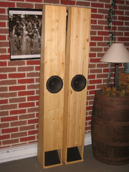

I've built three pair of Saburo's and two Sachiko's. One pair of Nagoaka D90's and a pair of Derek Walton inspired voigt pipes from solid pine.
All of them I've built from different wood and used different finishes.

However, back onto the subject of materials, which is what this thread is about. So, here's one to get things moving: I've got an increasing liking for pine, assuming it's dried / sealed properly. It's light, quite stiff & seems to be very effective for some applications I've used it for, providing you And if an audibly resonant cabinet was wanted, it also seems to add a nice mellow tone to some instruments.

Did all kinds of experimenting when I had the Fostex in it, but they sat neglected and driverless until picking up a pair of Pioneer drivers. With those in it, I've done very little experimenting as I had built the Sachiko by that time. I still have them and perhaps I'll put them back in my system and play around with them a bit more, but I'm just not a big fan of the Pioneer B20. I built them so the bottom deflector could be removed. I also played with various amounts of stuffing. Should I try choking off the vent at the bottom a bit more?
I haven't time to run a full MathCAD sim on it just now, but FWIW, I'd probably blank the whole thing off & try them with a 3in x 4in circular port (WxD). I was just wondering about the throat (i.e. the top) as from your picuture, it doesn't appear to come to a point as per the original, but seems slightly trunkated, as was popular a few years back. Or is that just than angle of the photograph fooling me?
